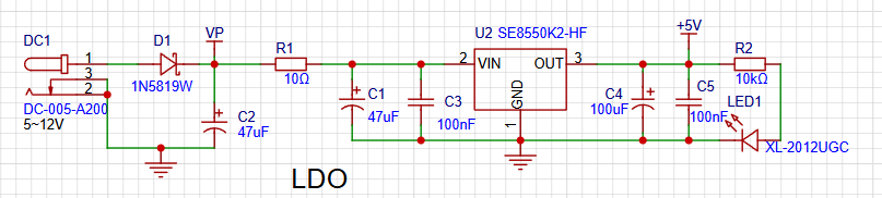

4.1 Power Supply Circuit
![WeChat image_20240825002601.png] This project uses an LDO as the power supply. Considering that most voltmeter products are used in industrial scenarios with 24V or 36V power supplies, this project chose the SE8550K2 with a maximum input voltage of up to 40V as the power supply.

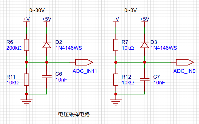

4.2 Voltage Sampling Circuit
![05761368422a4c9000a5a3c2ae00746.png] Two voltage input ranges are selectable: 0~30V and 0~3V, with the 3V range offering higher accuracy.
Both ranges use two series resistors for voltage division sampling. Since the ADC's internal reference voltage of 1.5V is used (which can be replaced),
the voltage division ratio is 1.5V/30V = 0.05. A 10KΩ resistor is chosen for voltage division sampling, so the total resistance R = 10 / 0.05 = 200KΩ. Therefore, the high-side resistance value = 200 - 10 = 190KΩ. A more common 200KΩ resistor was chosen here. The same logic applies to the 3V range.

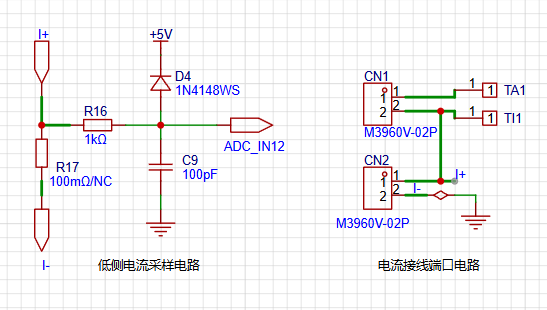

4.3 Current Sampling Circuit
![image.png] The sampling current designed for this project is 3A, and the selected sampling resistor (R0) is 100mΩ. According to the formula, 3A * 100mΩ = 300mV, 900mW. See the schematic diagram for other details.

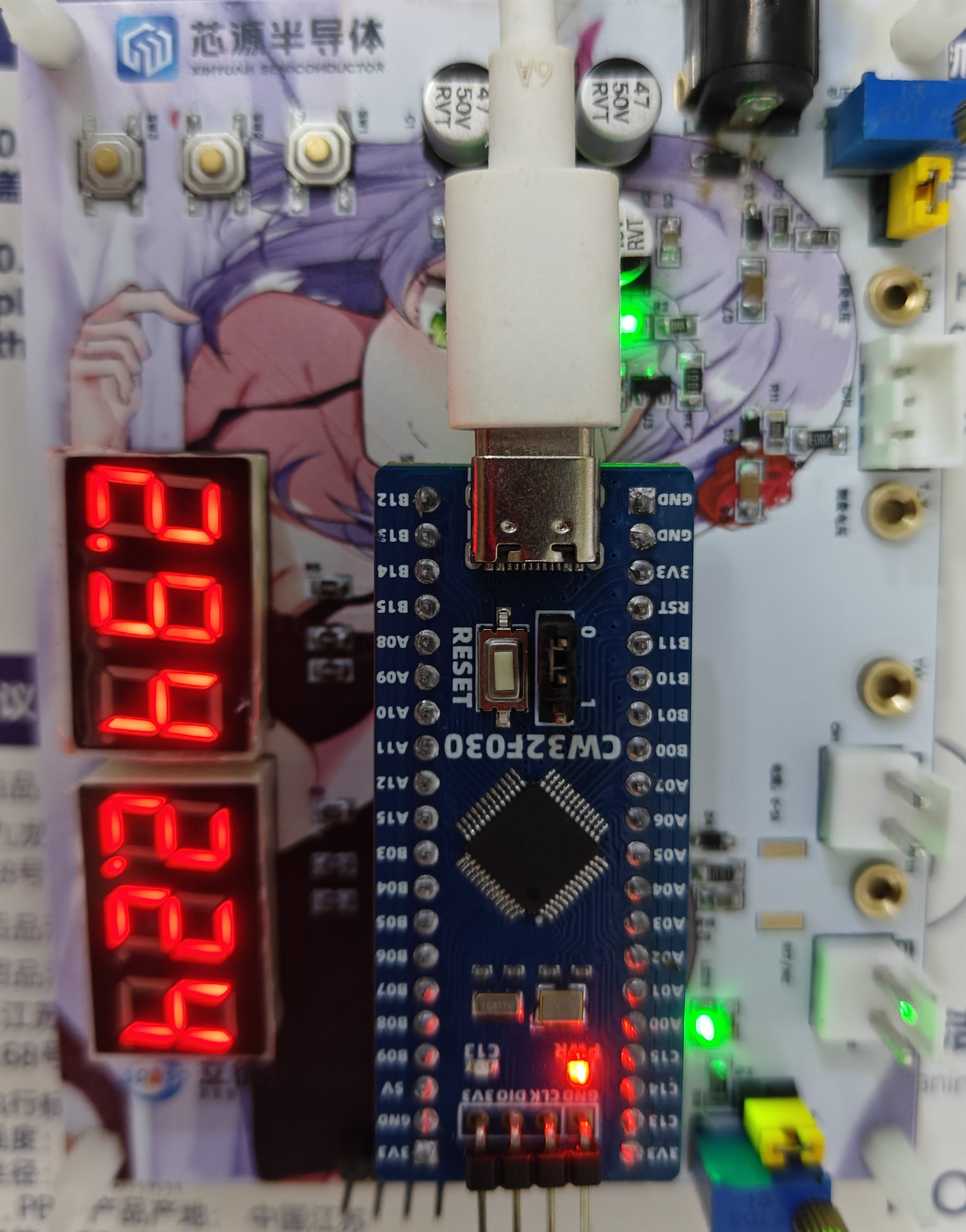

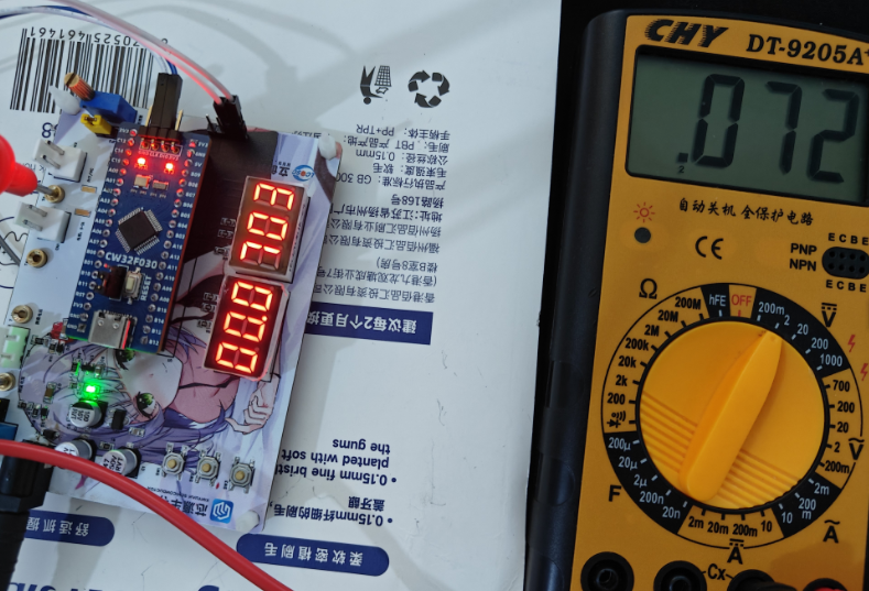

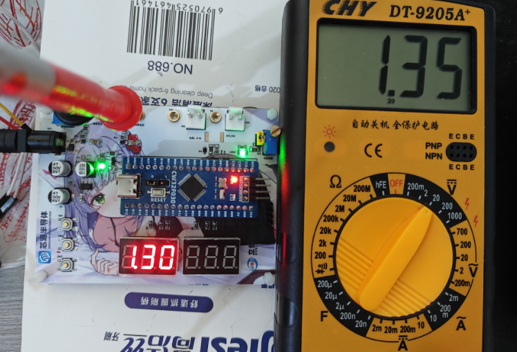

8. Finished Product Demonstration:
Simulated voltage measurement
![image.png]
Simulated current measurement
![image.png]

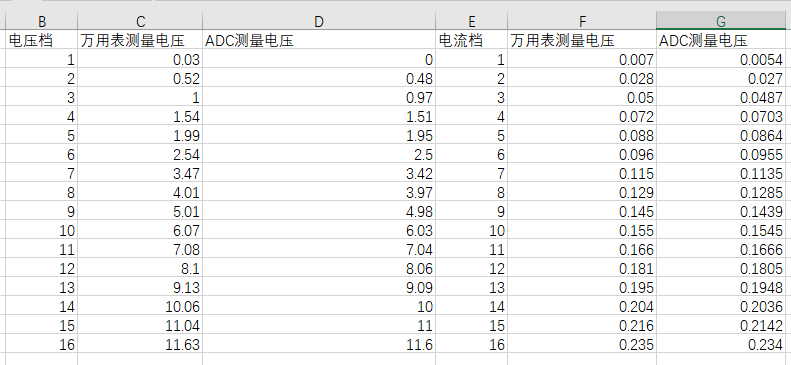

Recording table
![image.png] The results are quite close.
