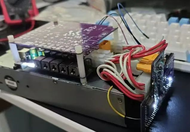

This is an intelligent Huawei server CSPS power supply board. After plugging into a Huawei server power supply, it can start to obtain 12V power.
It supports output from 5557 sockets and XT60 sockets. It supports WIFI connection for remote viewing and control
of project functions .

Manual shutdown and transistor shutdown have been verified to be usable. IIC is still under testing, but a voltage converter has been made, so theoretically there should be no problem.

All power signal lines have been brought out. I plan to add an auxiliary control to monitor the hardware PSOK and Load Monitoring (IMON) statuses (in fact, you can also use the ADC of the 8266 directly, but I think the auxiliary control shouldn't be too idle, plus the 8266 doesn't have enough pins). I also plan to further control the power relays after the power supply (for example, separately shutting down the 12V power supply for the soldering smoking machine, the 12V power supply for the soldering pen, and the 12V input for the lithium battery charging system among a group of devices). (Sir, you don't want to forget to turn off the power when you leave and have to come back, do you? (Huang Dou's humorous comment)). Alternatively, you can skip soldering the 8266 and directly use a separate board for control. All necessary lines have been brought out.
Current status:
The yellow wire is used to pull GPIO0 low. Normally it's a 3.3V pull-up, but for flashing the program, this pin requires a pull-down, so a jumper wire was added. It's strongly recommended to flash the program before soldering it onto the board. This power board has too little space. There's not enough room for many components, so there will be a power distribution board later to support powering more devices. We also plan to build a fast-charging board and stack it up to create a desktop power station.
Hardware-wise, we've implemented windowing, and all lines have been calculated to ensure current carrying capacity and prevent board burnout. The 12VSB has a maximum output of 2.5A, and the design uses a minimum 1.8mm trace width. The traces have four vias with an inner diameter of 0.4mm and an outer diameter of 0.6mm for current carrying. This is more than sufficient.

Please fully solder the window area to ensure current carrying capacity. The 12V and GND windows on the circuit board are at least 4mm narrow. Without solder, a single circuit board can only handle a maximum of 13A according to the IPC-2221 standard. However, the Huawei 460W design has a 38A output on 12V, so please be sure to add solder or solder copper strips. My
soldering station power was insufficient, resulting in poor soldering (crying). My
