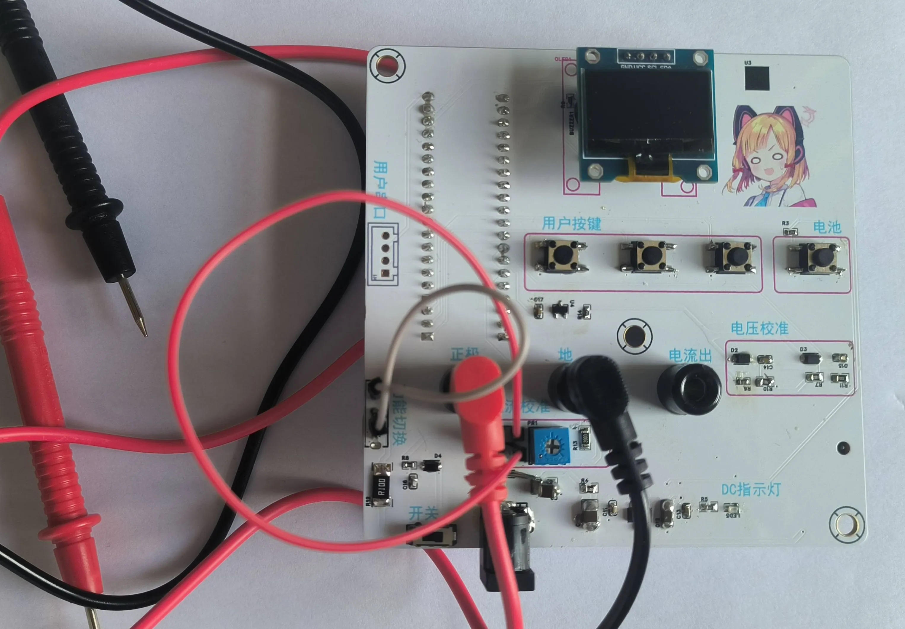

Compared to the official case, this project has the following changes:
Power Supply Design :
This project uses the LDO chip 78L05 as the DC power output and the IP5306 as the battery management chip.
Voltage and Current Range Switching
: A jumper combined with a button is used for voltage and current range switching.
Display:
A 0.96-inch OLED display is used.
