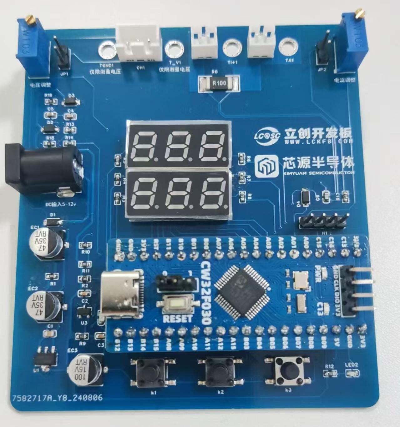

it adopts a core board plus expansion board design concept and uses plug-in components, making learning simpler and exploration more in-depth;
the core board uses the domestic Wuhan Xinyuan Semiconductor CW32 as the main controller, while also being compatible with other similar development boards; however, the CW32 has advantages.
The project is highly comprehensive and practical, and after completion, it can be used as a desktop instrument;
the project has abundant learning materials, including circuit design tutorials, PCB design, code programming learning, and training for engineers' debugging skills.

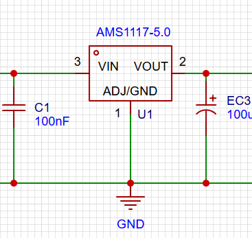

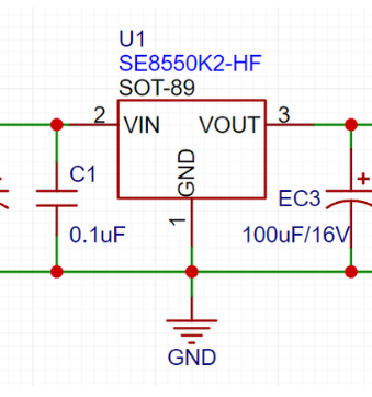

The schematic design instructions are
basically based on the tutorial, with plug-in components replaced by surface-mount components, and one LDO and one resistor modified.
I'm using the AMS1117-5.0 here, which only supports 5-12V power.

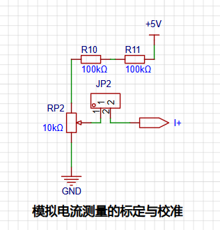

The original tutorial suggested
a 200k resistor, but I didn't have one, so I used two 100k resistors in series.

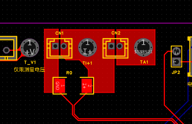

the PCB design notes
before because I was replicating other open-source projects and had only purchased the components. I only learned PCB design through this training camp, so my drawings aren't great and are just for reference.
When designing the PCB, you need to make the current measurement traces wider and larger, and the power supply lines should also be drawn wider.

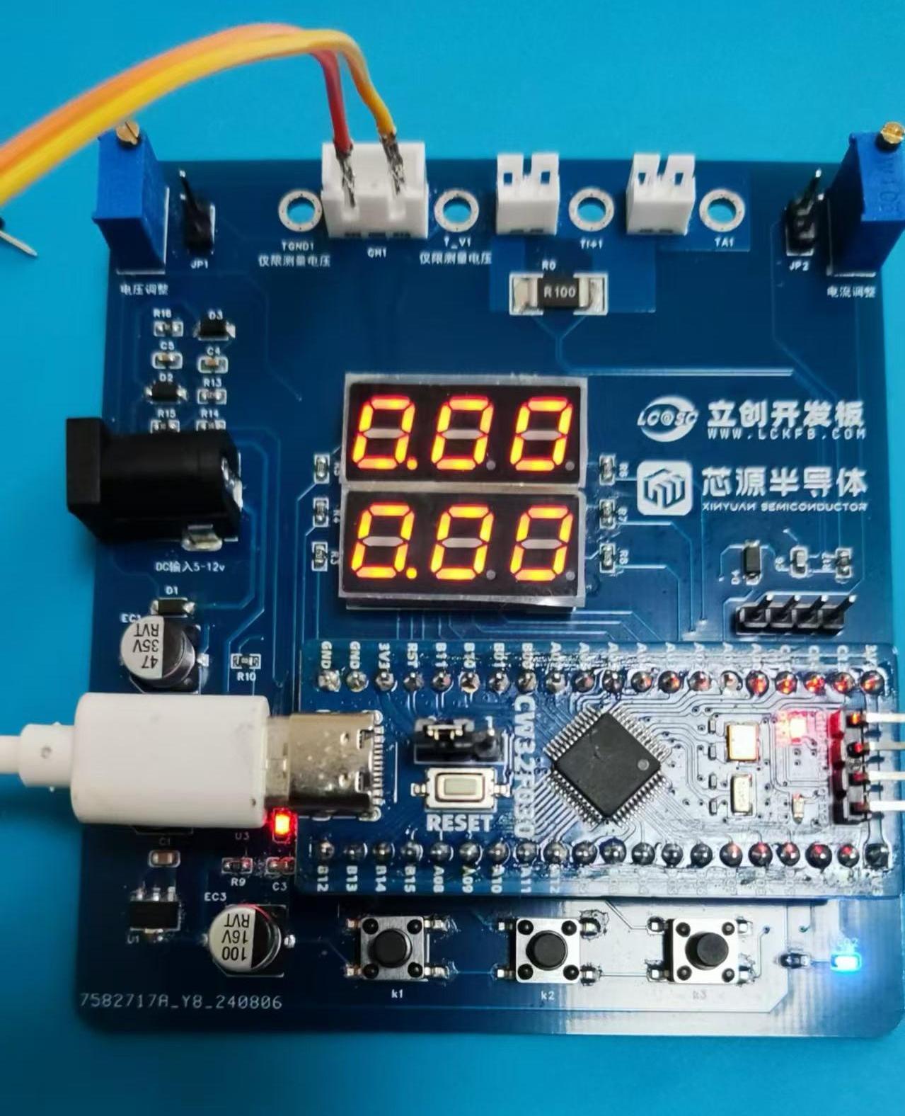

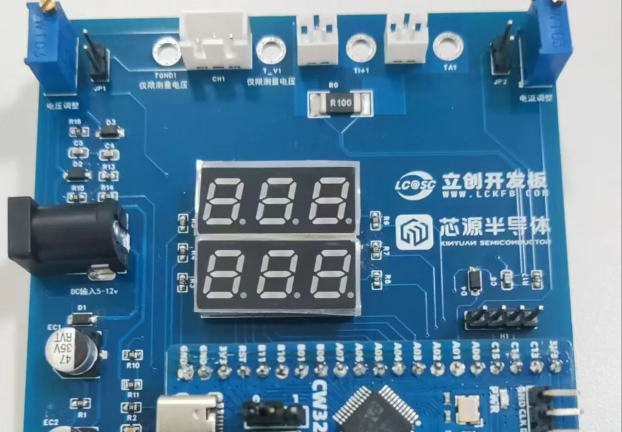

(Physical demonstration)
