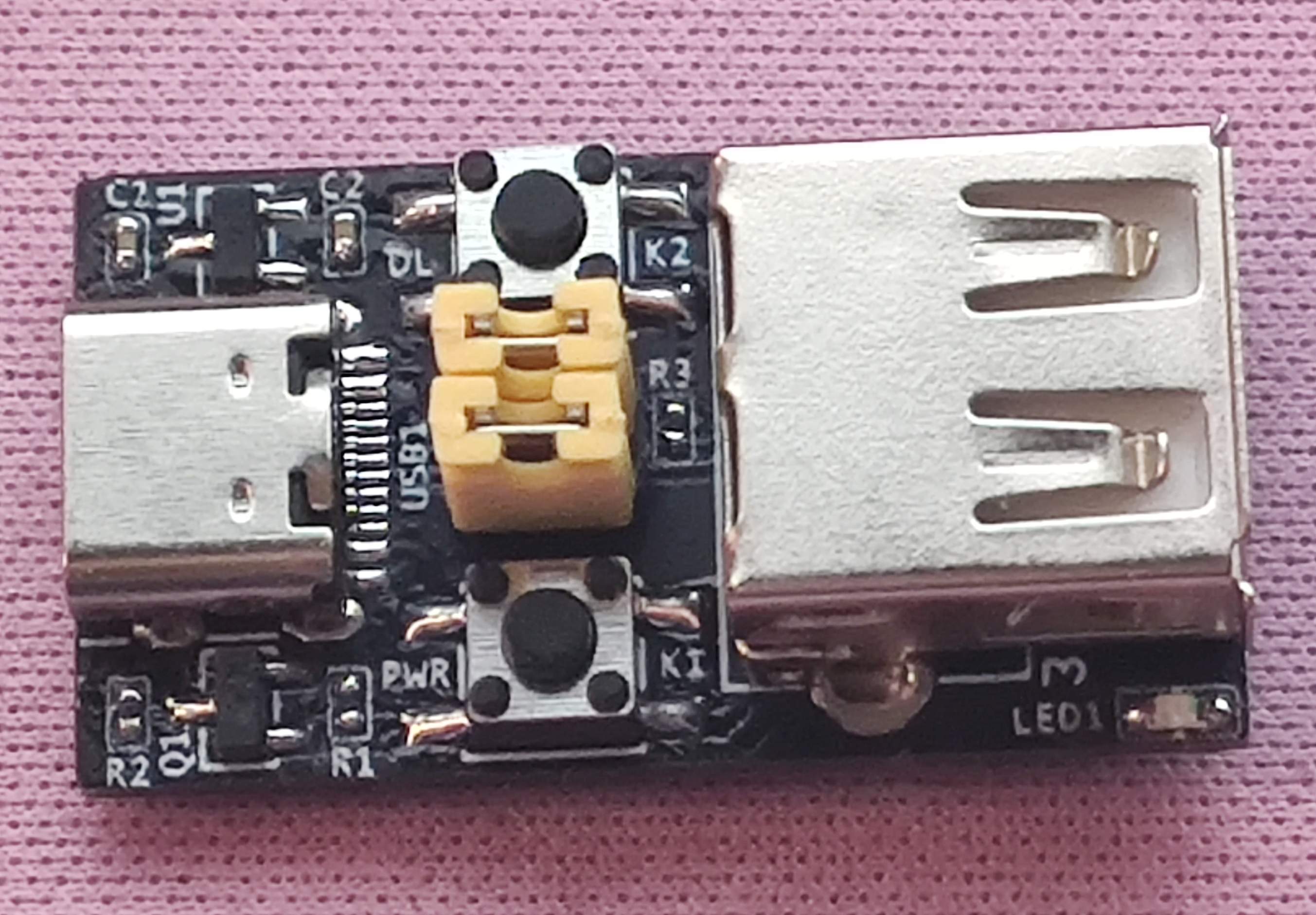

USB download CH55x operation process:
1. Press and hold the PWR and DL buttons at the same time (in no particular order).
2. Release the PWR button first, then release the DL button to enter download mode.
Unplug the jumper cap to leave the device's D+ and D- floating to be used as GPIO.
Press the PWR button to power off the device, and release it to power on again.
