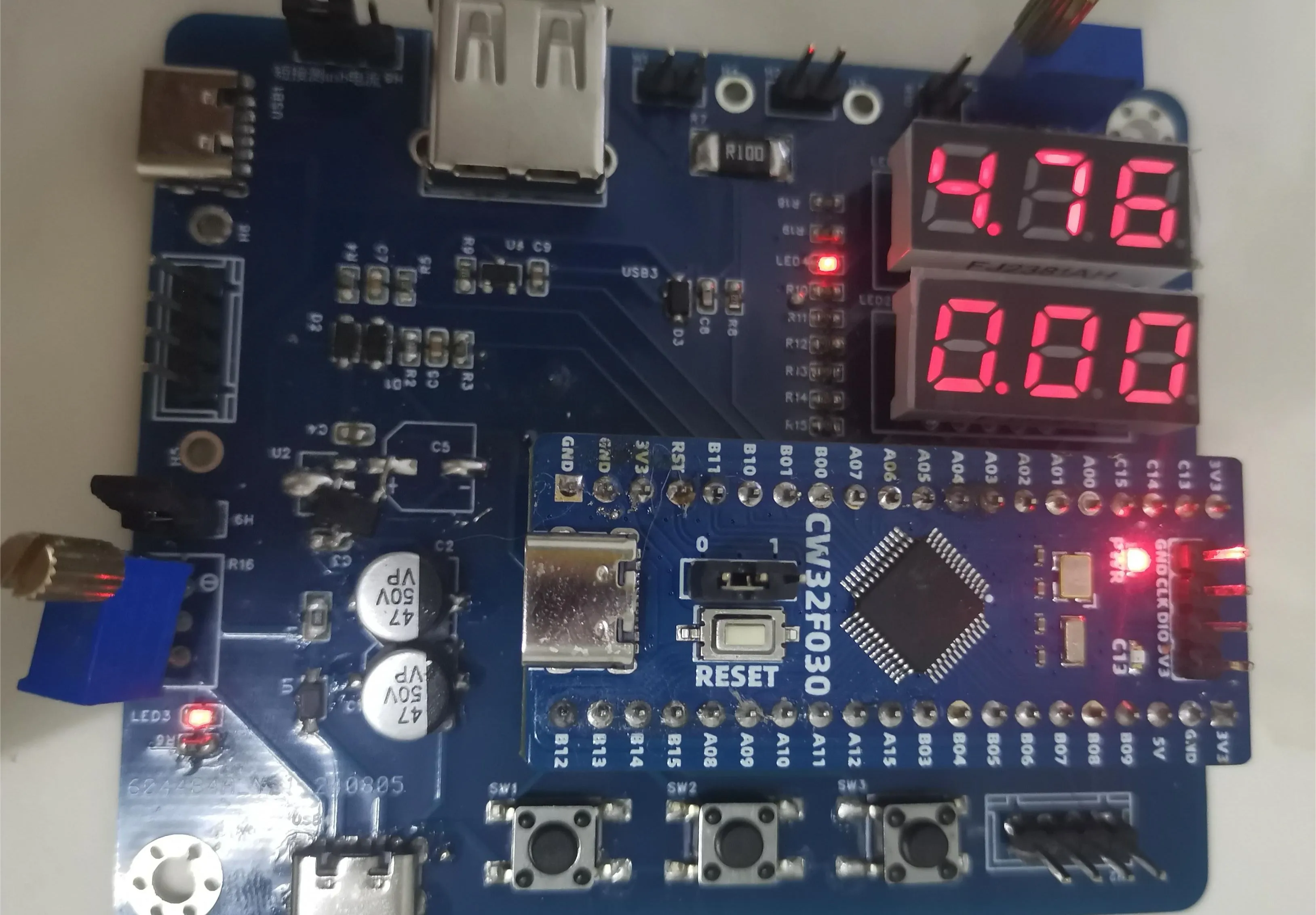

This project uses the LCSC CW32F030C8T6 development board (core board) as the main controller
and uses a digital tube to display voltage and current values.

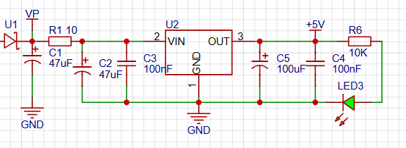

Power supply circuit:

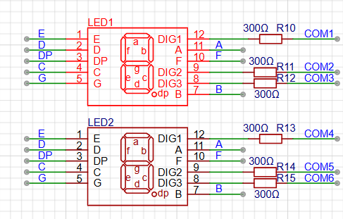

Digital tube display circuit
Software
code for digital tube display, controlling the lower 8 bits of GPIO to display on the 8-segment digital tube:
void Seg_Display(uint8_t Pos,uint8_t Num)
int i;
uint8_t Dis_Value = Seg_Table[Num];
GPIO_LowByte_Write(CW_GPIOA,Dis_Value);
switch(Pos)
case 0:
GPIO_WritePin(CW_GPIOA,GPIO_PIN_8,GPIO_Pin_RESET); //PA8,COM1
break;
case 1:
GPIO_WritePin(CW_GPIOA,GPIO_PIN_11,GPIO_Pin_RESET); //PA9,COM2
break;
case 2:
GPIO_WritePin(CW_GPIOA,GPIO_PIN_12,GPIO_Pin_RESET); //PA10,COM3
break;
case 3:
GPIO_WritePin(CW_GPIOA,GPIO_PIN_15,GPIO_Pin_RESET); //PA11,COM4
break;
case 4:
GPIO_WritePin(CW_GPIOB,GPIO_PIN_3,GPIO_Pin_RESET); //PA12,COM5
break;
case 5:
GPIO_WritePin(CW_GPIOB,GPIO_PIN_4,GPIO_Pin_RESET); //PA15,COM6
break;
default:
break;
Voltage and current acquisition:
void Volt_Cal(void)
float t,KT1;
V_Buffer = Mean_Value_Filter(Volt_Buffer,ADC_SAMPLE_SIZE);//Use mean filtering
I_Buffer = Mean_Value_Filter(Curr_Buffer,ADC_SAMPLE_SIZE); //Use mean filtering
V_Buffer = (V_Buffer * ADC_REF_VALUE >> 12) * (R2 + R1)/R1;
// Rounding
if(V_Buffer % 10 >= 5)
V_Buffer = V_Buffer / 10 + 1;
else
V_Buffer = V_Buffer / 10;
ADC_GetSqr1Result(&I_Buffer); ///Display the current acquired value
I_Buffer=I_Buffer * ADC_REF_VALUE >> 12;
/**mv =I_Buffer * ADC_REF_VALUE >> 12,
R = 100mr,
10ma = mv/R/10=mv/0.1/10 = mv
