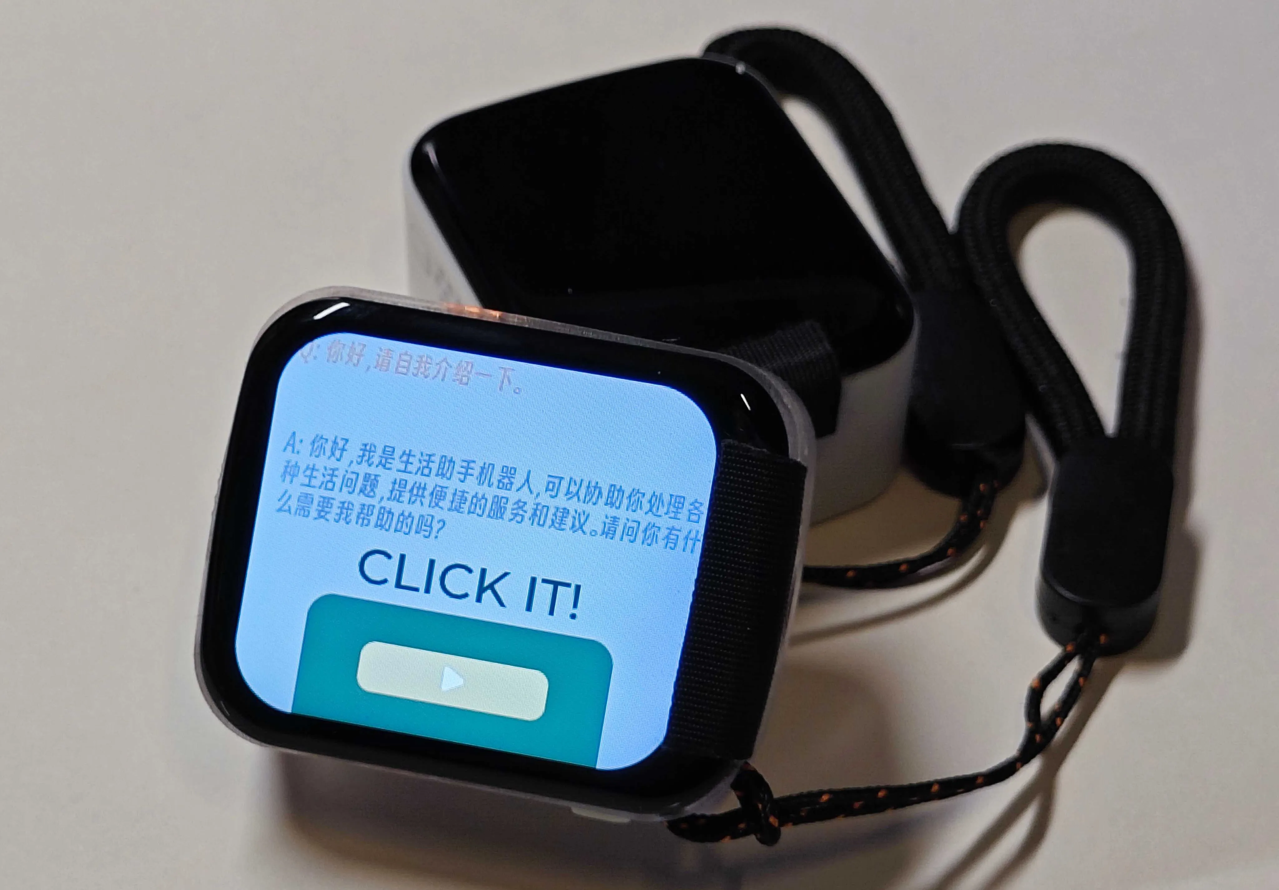

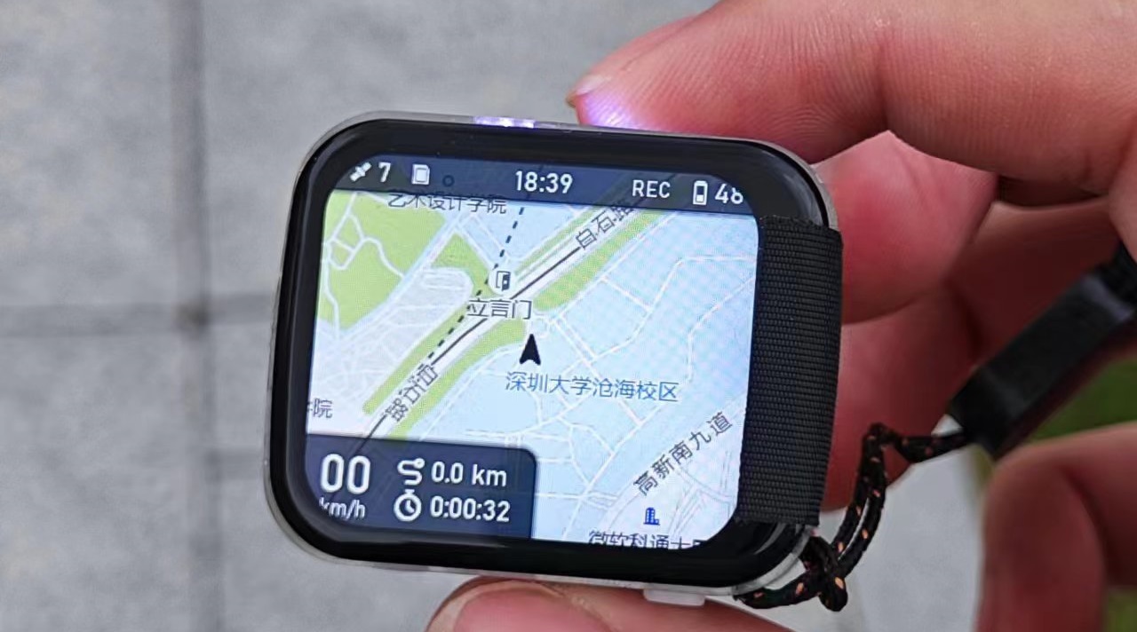

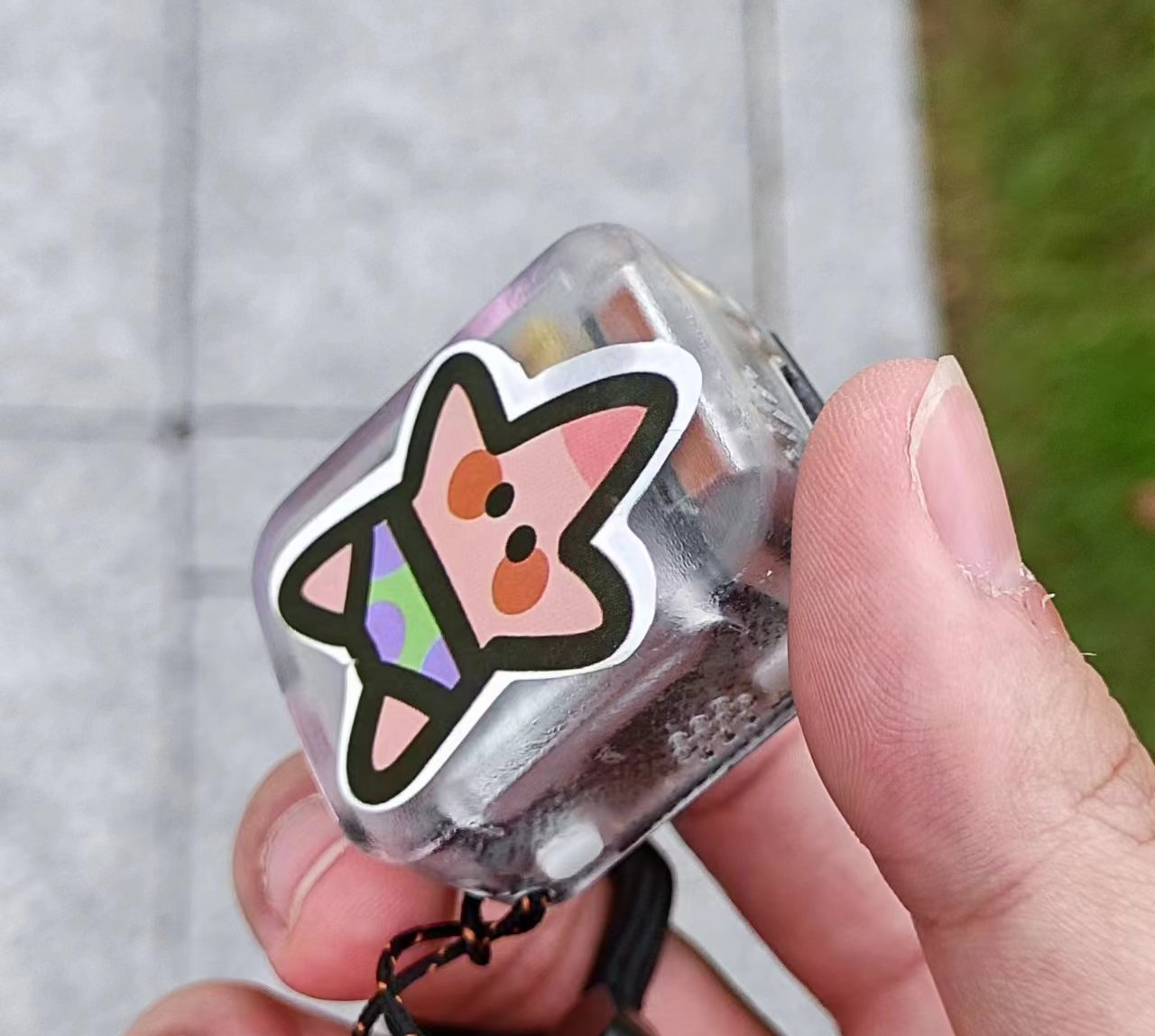

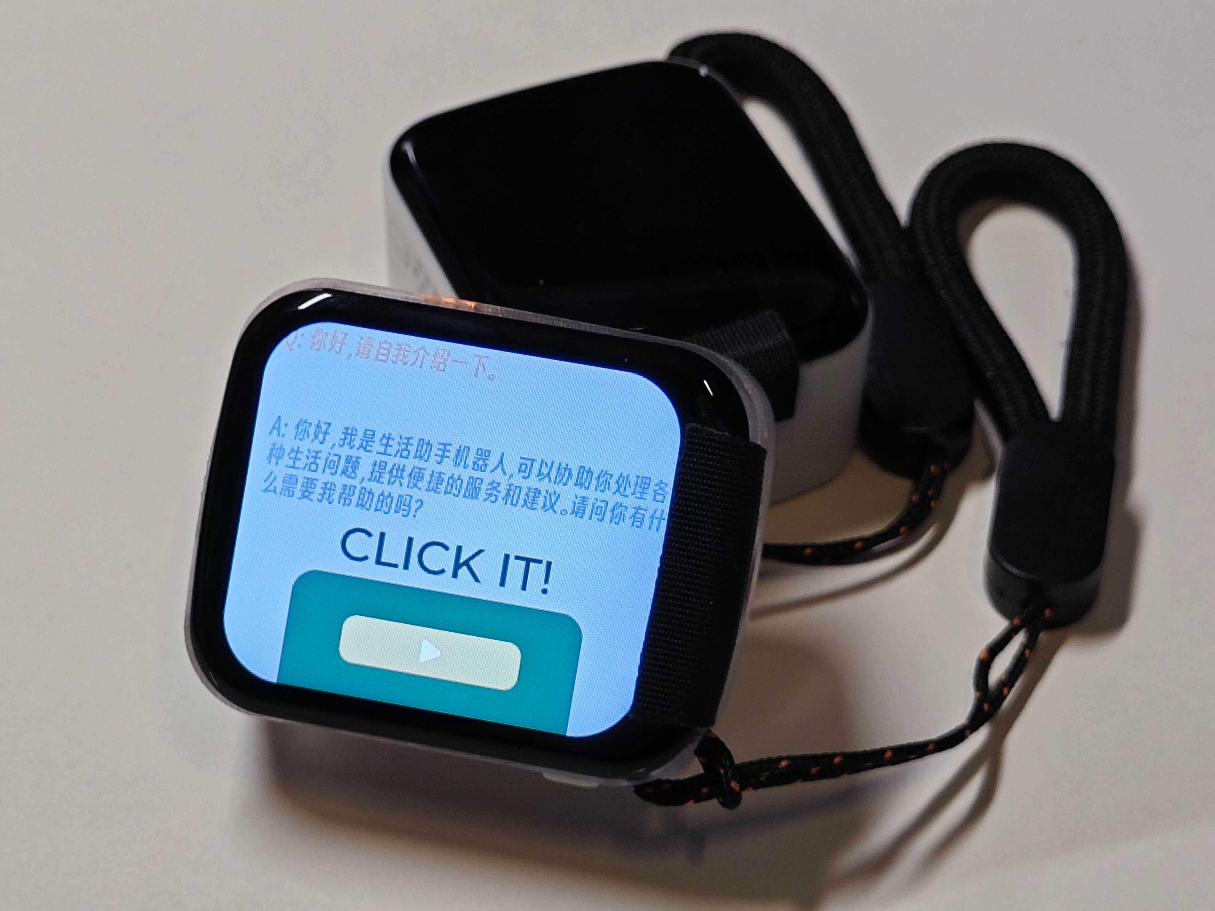

【EasyGPS】GPS locator based on ESP32S3
【EASY-GPS】
This project is based on: X-TRACK & CHAPPIE.
Author: kkl.
Video introduction: https://www.bilibili.com/video/BV1M44219745/
Github: https://github.com/ZhangKeLiang0627/EasyGPS
Hardware
configuration: Main controller: ESP32S3R8
; Screen: ST7789V 1.69-inch SPI interface 240x280 resolution;
Storage: Micro SD CARD 32GB + W25Q128JVPIQ;
Input device: Capacitive touch;
RTC: BM8563EMA;
IMU: MPU6050;
MAG: QMC5883L
; ENV: BMP280;
MIC: MSM261D4030H1CPM
; GPS: ATGM332H;
Battery: Li-ion 3.7V 603030 600mAh
; Power management: SGM4056 + SGM6036
casing: 3D printing
capability
supported; all native features of the X-TRACK project
supported; Bluetooth keyboard and mouse
supported; voice-activated smart assistant supported;
four-hour battery life (continuous operation, always-on screen)
. To be continued...
