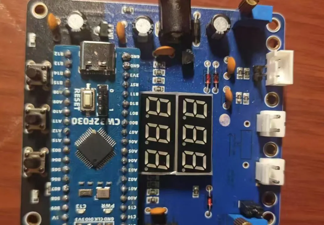

CW current and voltage meter with calibration function
Key advantages of
the CW32 in this project

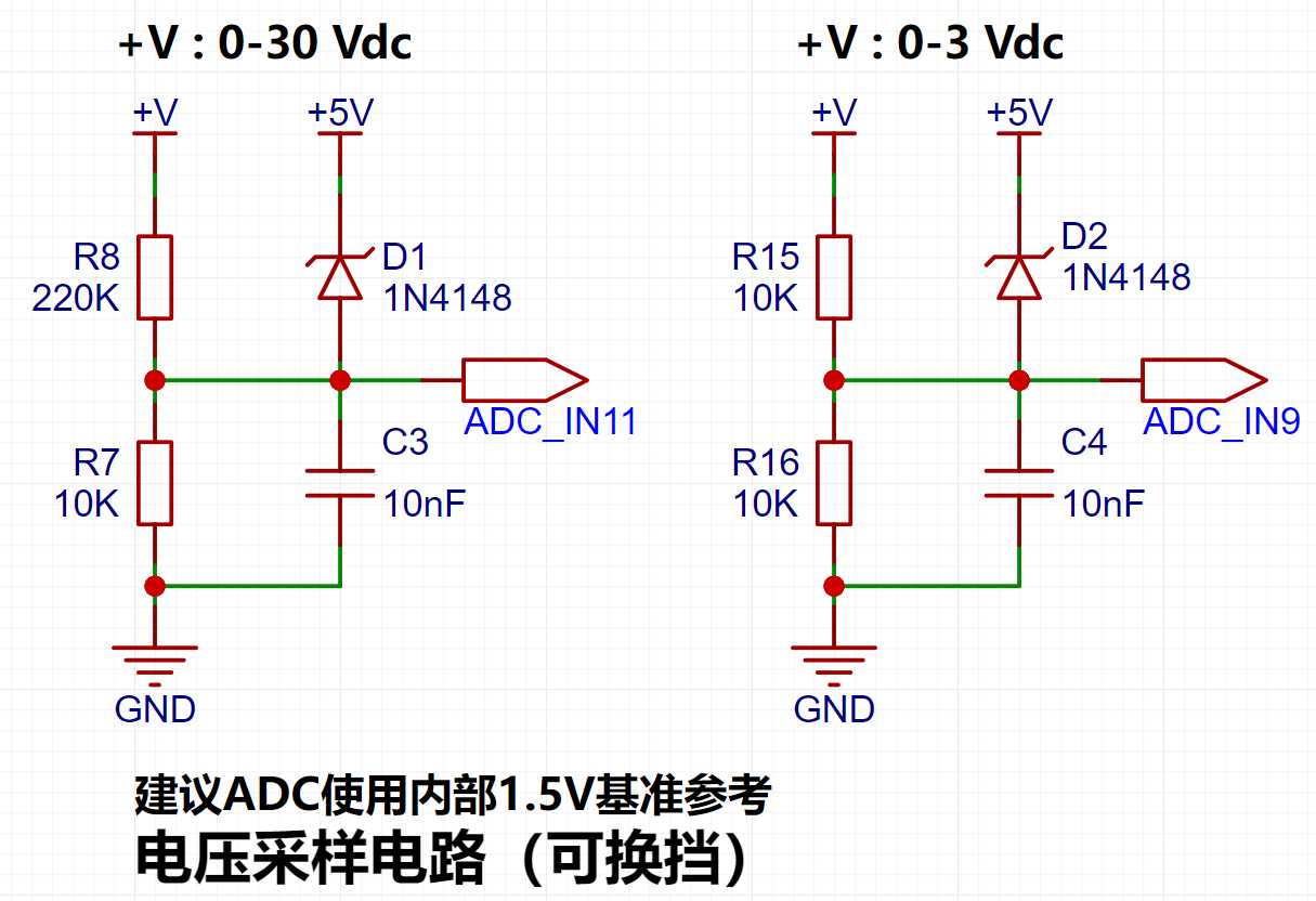

2. Voltage Sampling Circuit:
The voltage has two ranges: 0-3Vdc and 0-30Vdc.
In this project, an additional voltage sampling circuit was added. Therefore, we can discuss the significance of range switching for improving measurement accuracy. Multimeters often have multiple ranges to achieve more accurate measurements. By adjusting different ranges, the optimal measurement accuracy of the measured point within the corresponding range can be obtained.
This project requires a combination of hardware and software to achieve this function. When we first use the ADC_IN11 channel mentioned earlier to measure voltages within 30V, if the measured voltage is within 0~3V, then we use the ADC_IN9 channel for measurement. At this time, due to the reduced voltage division ratio, the measurement accuracy is greatly improved.

5. Digital Tube Display:
This project uses digital tubes as the display unit.
Two 0.28-inch three-digit common-cathode digital tubes are used as display devices. Compared to displays, digital tubes have better visibility in complex environments. Depending on the actual usage environment, smaller current-limiting resistors can be used to achieve higher brightness.
Furthermore, digital tubes have better mechanical properties and are not as easily damaged by external forces as displays. They are widely used in industrial applications requiring stability and reliability. From the perspective of learning from the development board, it is easier to learn electronic measurement principles and related development in a more targeted manner.

Five operating modes are defined. The K1 key is used to switch display modes. The K2 key sets the parameter value for the corresponding mode and saves it to FLASH. The K3 key returns to mode 0.
Mode 0: Displays normal voltage and current values ​​(the upper row of digital tubes displays the voltage value *.V or .*V automatically switching; the lower row displays the current value _.**A).
Mode 1: 5V voltage calibration value setting. (JP1 can be shorted to use the built-in voltage source for setting). The upper row of digital tubes displays 5.05. The lower row displays the current voltage value _.V or ._V. In this mode, the multimeter should be adjusted to 5.00V to measure the bit being measured. After pressing the K2 key, the current value is calibrated to a 5V voltage value.
Mode 2: 15V voltage calibration setting. (JP1 cannot be shorted) The upper row of the digital tube displays 5.15. The lower row displays the current voltage value _.V or ._V. In this mode, the multimeter should be set to 15.0V to measure the measured bit. After pressing the K2 key, the current value is calibrated to a 15V voltage value.
Mode 3: 0.5A current calibration setting. (JP2 can be shorted to use the built-in current source setting) The upper row of the digital tube displays A.0.5. The lower row displays the current current value _.**A. After pressing the K2 key, the current value is calibrated to a 0.5A current value.
Mode 4: 1.5A current calibration setting. (JP2 can be shorted to use the built-in current source setting) The upper row of the digital tube displays A.1.5. The lower row displays the current current value *.**A. After pressing the K2 key, the current value is set to 1.5A.
