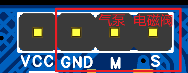

This video demonstrates how to control an air pump with a single click on Bilibili! The DIY solenoid valve module
allows you to connect the air pump and solenoid valve to the driver board using the original 1.25mm ribbon cable to complete the wiring for a single air pump.
The diagram shows the control pin wiring: a high level on the air pump (M) and a low level on the solenoid valve (S) pins turn it on and off.

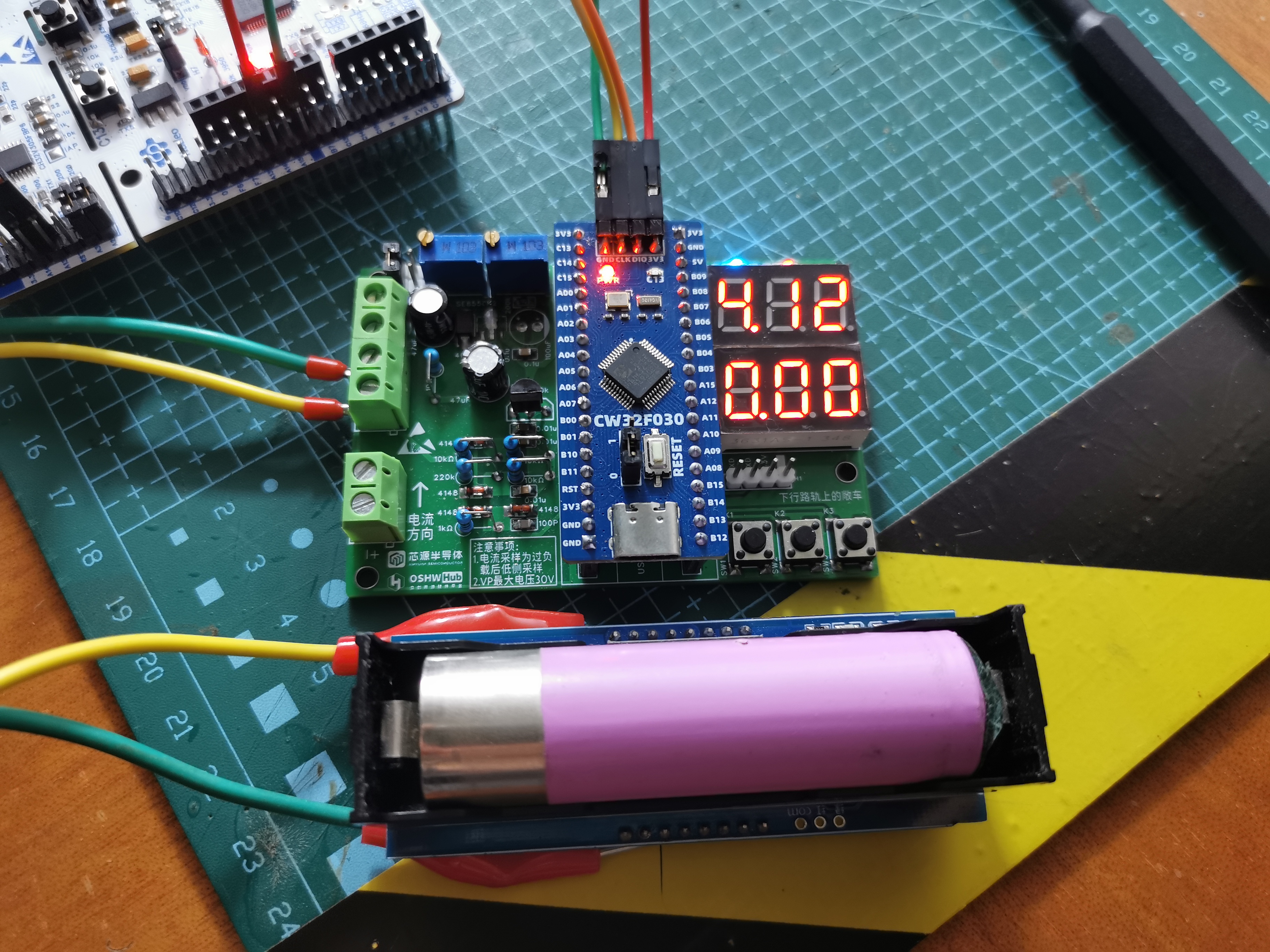

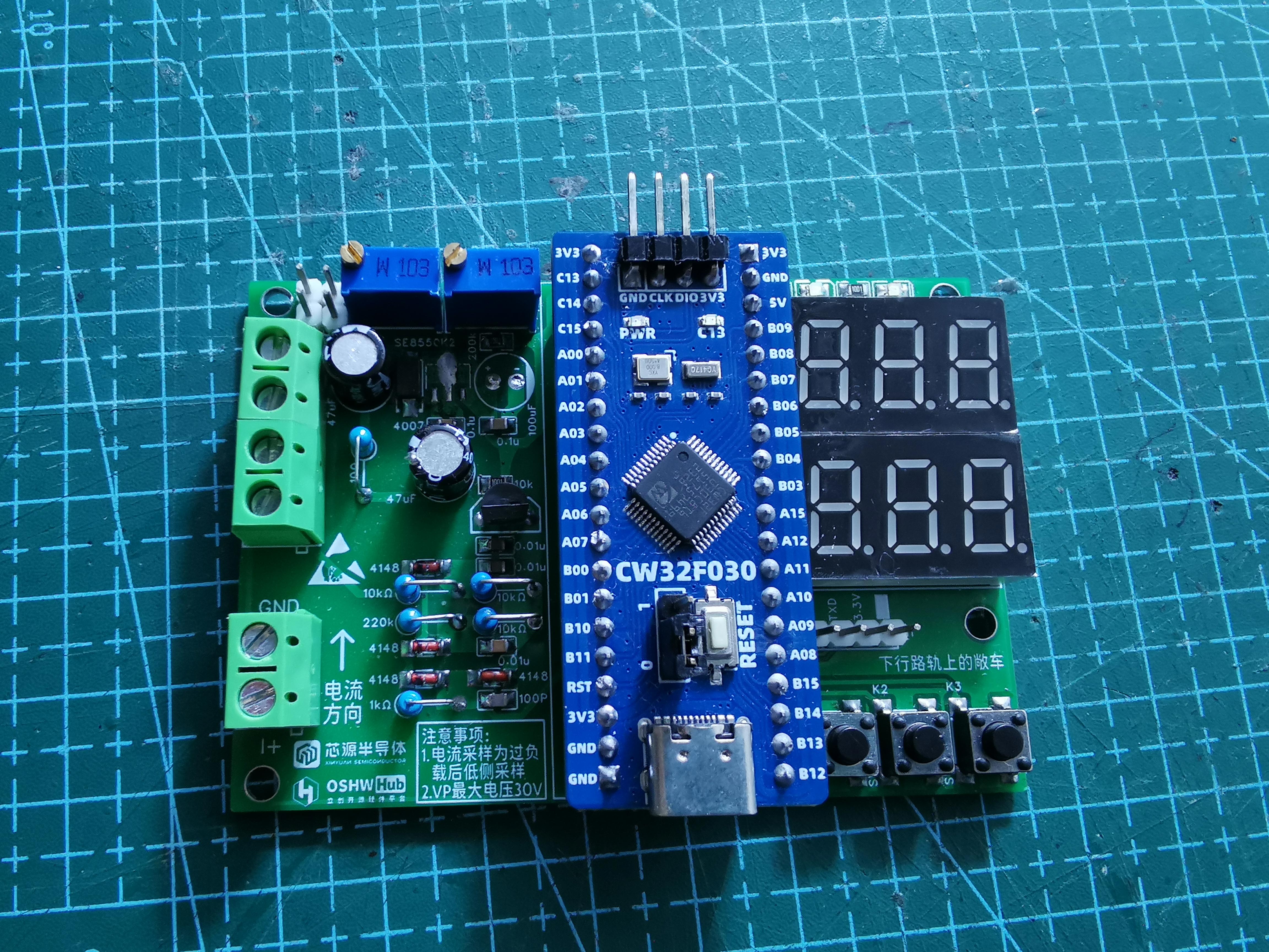

This was my first time participating in a CW32 training camp project, and I'm sharing a slightly modified version of the CW32 Geostationary Development Board digital voltmeter and ammeter expansion board.
Hello everyone, this is C70E. Today I'm bringing you a project from the CW32 voltmeter and ammeter training camp, jointly conducted by JLCPCB and Sinyuan Semiconductor. This is my second time participating in such a project organized by LCPCB EDA. Next, I'll introduce and test the board I made. For
the hardware
, the board's circuitry is based on the official hardware circuitry project, which I redraw. Of course, my PCB layout and component selection differ slightly from the official PCB layout—I placed the analog circuitry on the left side of the core board and the digital circuitry on the right side, making the layout of the analog and digital sections clearer and more understandable. I also changed the current-limiting resistor for the digital tube to segment control, resulting in more uniform brightness. In the upper left corner of the board is the power supply section, with an SE8550HF chip that powers the entire voltmeter and ammeter. The back of the board has precautions for using the board and a simple wiring diagram. The wiring diagram will help you quickly connect the circuit. The flaw in this version of the circuit is that my SE8550 outputs only 2.87 volts, which isn't even enough to light up the blue LED on the board. Due to the approaching project deadline, my workaround was to "forcefully" add a 7805 on the back to ensure the meter could function properly.

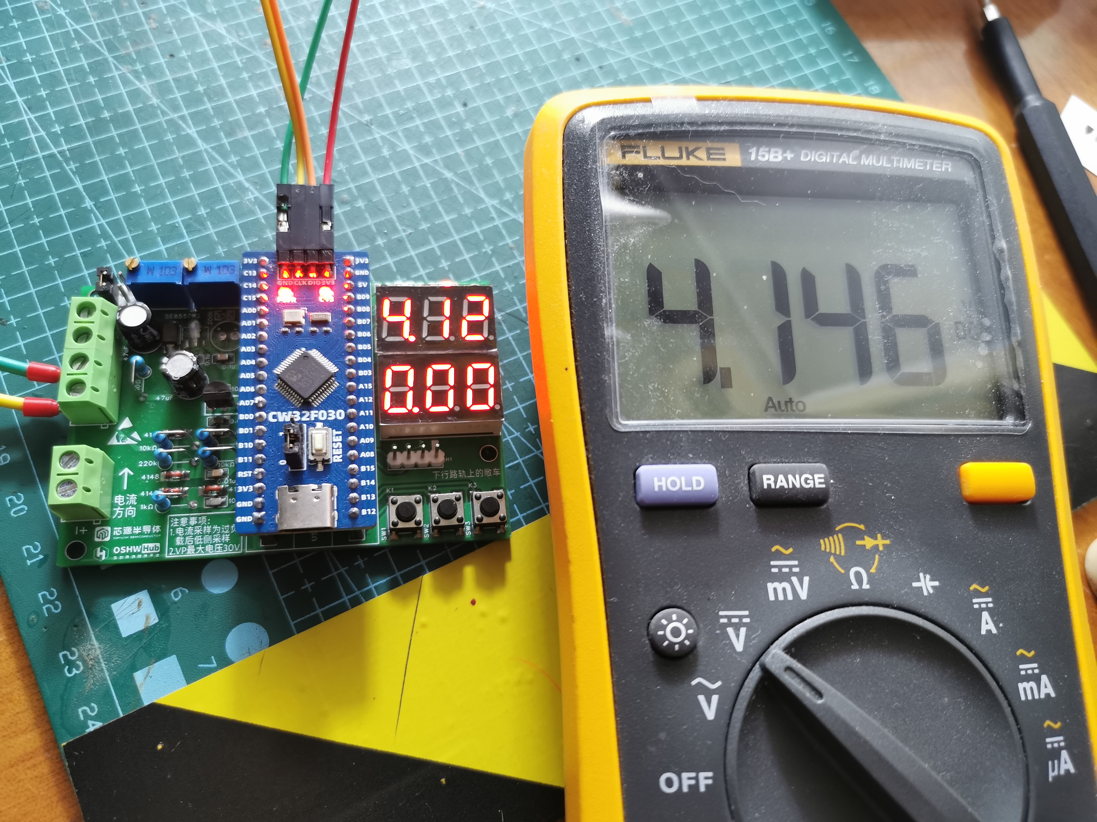

                                                                   Figure 1: Completed device photo.

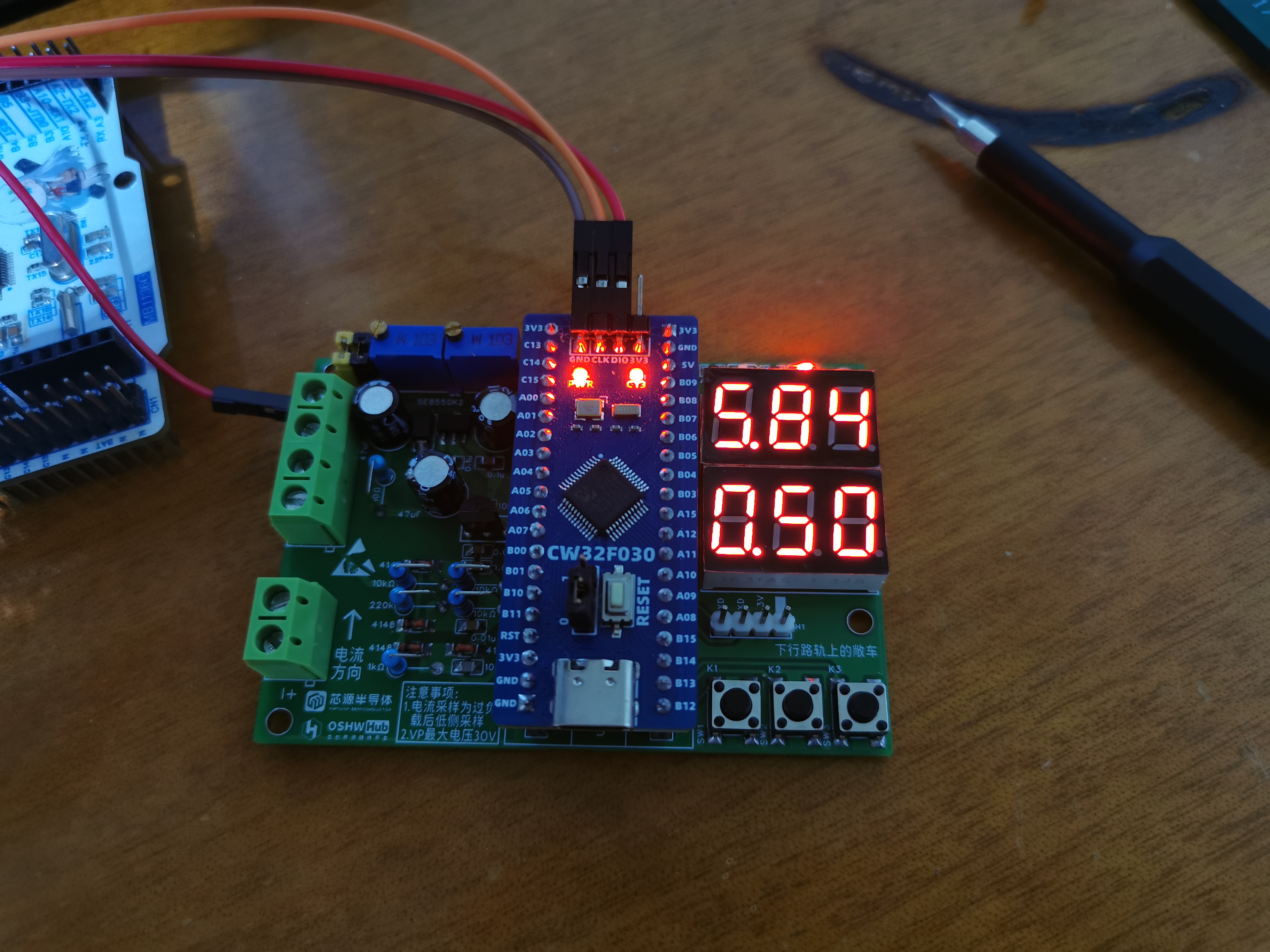

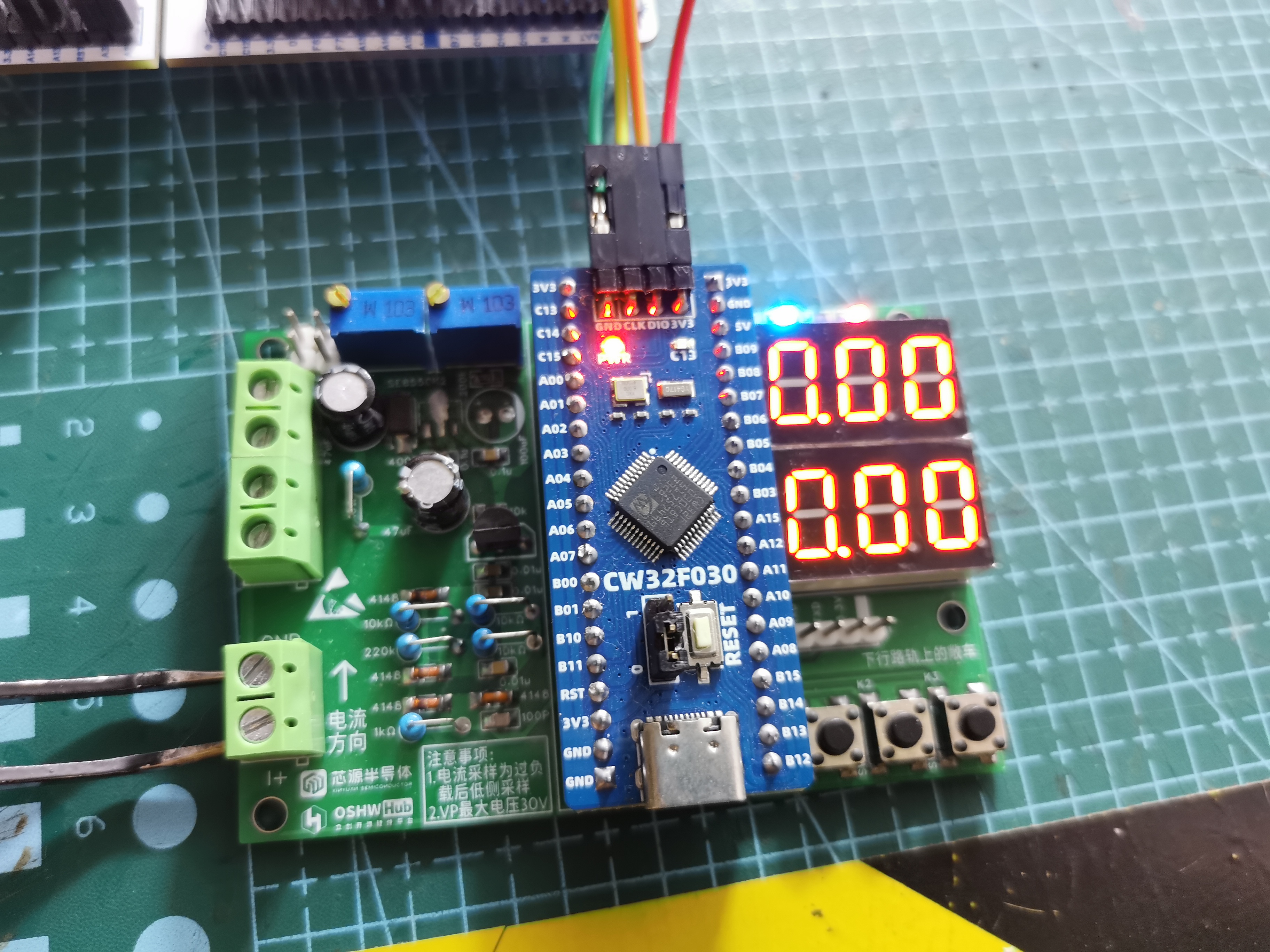

Calibration

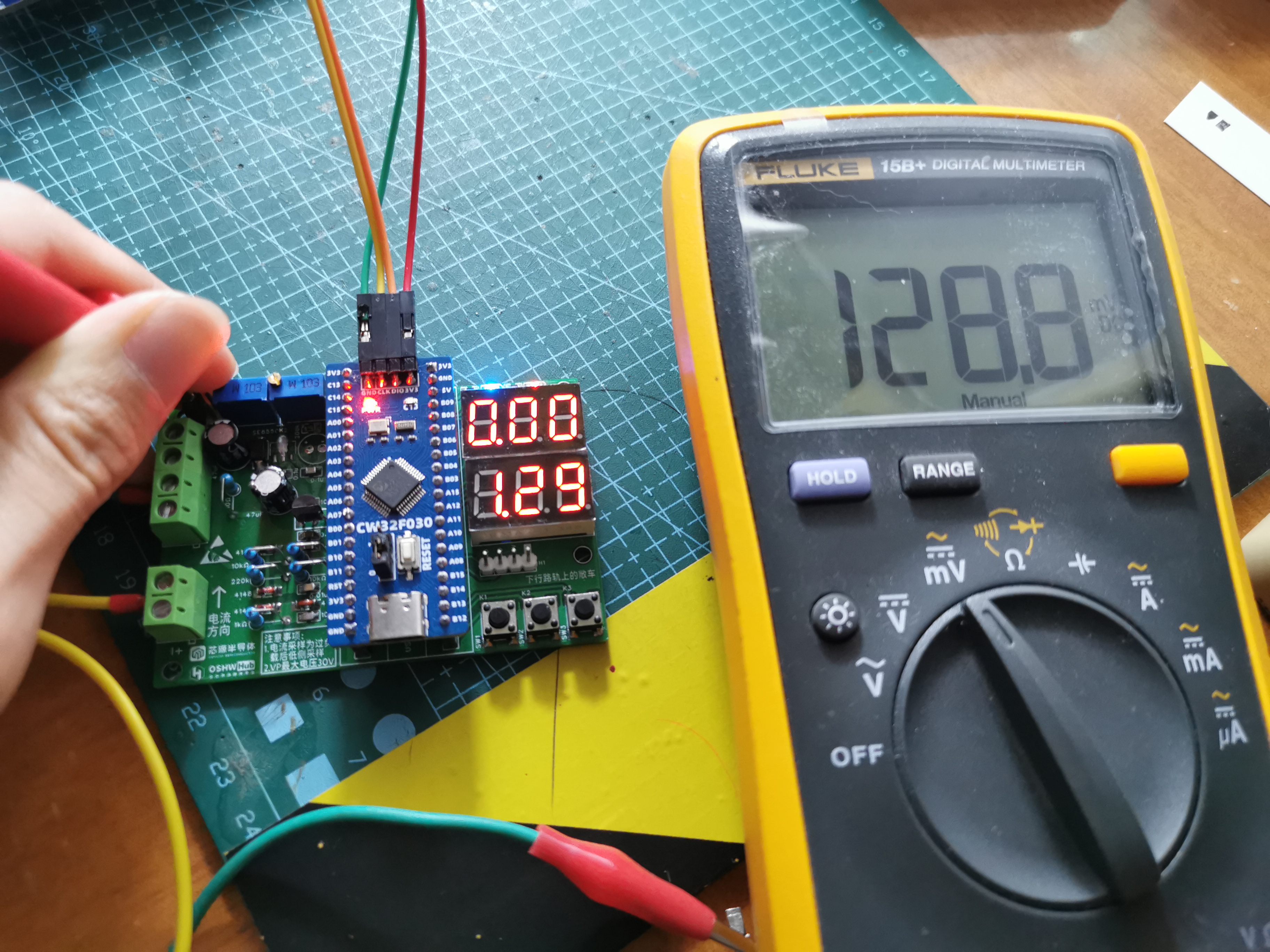

                                                               Figure 2: Calibrating the current section; the voltage section is not yet calibrated.

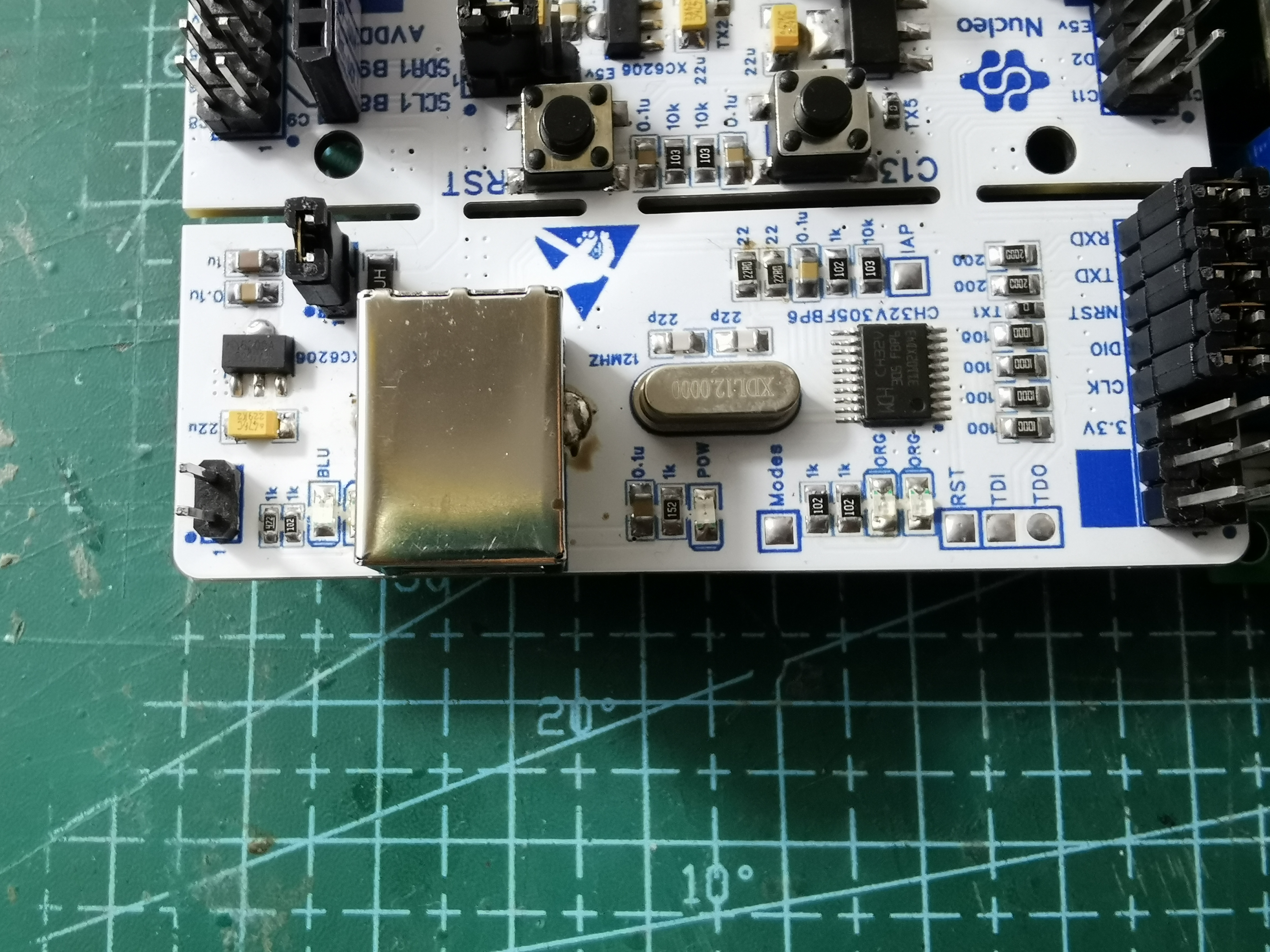

After correctly flashing the official CW32 firmware, you'll find that the meter's digital display is already lit. At this point, the meter needs to be calibrated. The calibration method is copied from the CW32 official documentation:
This example uses button operation for calibration. The specific operation method is as follows:
Define 5 working modes. The K1 key is used to switch display modes. The K2 key sets the parameter value for the corresponding mode and saves it to FLASH. The K3 key returns to mode 0.
Mode 0: Displays normal voltage and current values ​​(the upper row of digital tubes displays the voltage value *.V or .*V automatically, the lower row displays the current value _.**A).
Mode 1: 5V voltage calibration setting. The upper row of digital tubes displays 5.05. The lower row displays the current voltage value _.V or ._V. In this mode, the multimeter should be set to 5.00V to measure the measured bit. After pressing the K2 key, the current value is calibrated to 5V.
Mode 2: 15V voltage calibration setting. The upper row of digital tubes displays 5.15. The lower row displays the current voltage value _.V or ._V. In this mode, the multimeter should be set to 15.0V to measure the measured bit. After pressing the K2 key, the current value is calibrated to a 15V voltage value.
Mode 3: Current 0.5A calibration value setting. The upper row of the digital tube displays A.0.5. The lower row displays the current current value _.**A. After pressing the K2 key, the current value is calibrated to a 0.5A current value.
Mode 4: Current 1.5A calibration value setting. The upper row of the digital tube displays A.1.5. The lower row displays the current current value *.**A. After pressing the K2 key, the current value is calibrated to a 1.5A current value.
When calibrating the current using a multimeter, because the shunt resistor is 100 milliohms, when I+=0.05V=50mV, the current is 0.5A; when I+=0.15V=150mV, the current is 1.5A. This simple method can be used to calibrate the current without an actual load. Figure 3: 00 display
                                                           after calibration (dry connection).                                                                       Figures 4 & 5: Simultaneous testing with a 18650 battery and multimeter comparison. First, a voltage test was performed. The voltmeter's measuring claw was connected to an 18650 battery, and the measured voltage was 4.12V. The multimeter measured 4.146V, with minimal difference, indicating a successful test.                                                                      Figure 6: Simultaneous testing of the millivolt value on the current calibration voltage divider side of the board and comparison with the multimeter . Since no shunt resistor was connected, the current calibration circuit value measured by the multimeter was compared with the meter reading. The difference was minimal, indicating a successful test. The current display is normal. A further comparison with the multimeter shows a small error, meaning the experiment was successful. My own microcontroller programming skills are not very high; I'm quite novice. Thanks to Sinyuan Semiconductor and LCSC EDA for organizing this experimental project. I learned a lot about programming methods for instrument calibration during the process. Last year, I participated in a color silkscreen printing design competition, but I forgot to submit my project on time, which resulted in me being blacklisted. Fortunately, I contacted the event organizers and they resolved the issue, allowing me to continue the project. I would like to thank the staff at JLCPCB for organizing this event. This time, I will definitely complete the project on time and open-source it. I also hope that JLCPCB will hold more and better events in the future.   Currently, this PCB version has been verified. I also made a Nucleo board with a CW32L083 as the main controller. The upper board has a built-in LINKE. Initially, I didn't have this programmer, but I made one this time as well. It's used to program the external MCU and the onboard MCU. The current section still needs testing. After resolving all issues after the first version's testing, I will use color silkscreen printing to create a second version and update the project. Please stay tuned.                                    Figure 7: The self-made LINKE, with the lower board being a ChipSource CW32L083RCT6. Currently, the MCU part of this board is still under verification.

Digital voltage and current meter based on CW32F030C8T6 development board
In short, I'm open-sourcing an expansion board for voltage and current meters.
The digital voltmeter and ammeter based on the LCSC CW32F030C8T6 is finally finished!
Unlike ordinary multimeters, it has a calibration function. When the measurement is inaccurate, you can calibrate it. Press the user button 1 to enter the 5V calibration mode, which displays S.05.
At this time, plug in a voltmeter and turn the long-handled potentiometer to make the voltmeter display 5V. The blue text below shows the voltage that is not calibrated in the meter. If you have time, you can also calculate the error [winking emoji].
Then press the user button 2 to enter the 15V calibration mode, which displays S5.15. Turn the potentiometer to 15V and press the user button 2 again to complete the calibration. Similarly, you can also calibrate the current. Press the back button 1, which is user 3, to return to mode 0 and enter the measurement mode. This is its highlight.
Bilibili video link. I will post the Oshwhub open source and code in the comments section tomorrow.
This link is not the original version. This version adds two switches and Type-C power supply.
Below is the official documentation. If you don't want to read it, just close it.

CW3 voltage and current meter
Thanks to JLCPCB and Sinyuan Semiconductor for organizing this event, which gave me a learning opportunity. It was my first time doing a project, and I had to learn everything from scratch. This experience helped me discover many problems; only after prototyping and assembling did I realize the panel size was incorrect and the casing was a bit small.
IMG_20240821_171531IMG_20240821_161606_edit_186030889177835IMG_20240821_162206_edit_186417778848833_compressedIMG_20240821_161519_edit_185990480829777Hardware Design
1. Power Supply Circuit
image-20240821164838962: LDO (Low Dropout Linear Regulator) Selection.
This project uses an LDO as the power supply. Considering that most voltmeter products are used in industrial scenarios with 24V or 36V power supplies, the SE8550K2 with a maximum input voltage of up to 40V was selected. The main reason for not using a DC-DC step-down circuit to handle the large voltage drop is to avoid introducing DC-DC ripple interference during the design process; a secondary reason is to reduce project costs.
When designing the DC plug, attention should be paid to the inner diameter of the DC socket. Common types include DC 2.1 and DC 2.5; ensure that the power connector and DC socket are compatible.
2. ADC Sampling Circuit:
image-20240821165316046Advantages of CW32 in this Project
. Better ADC: 12-bit high-speed ADC, achieving ±1.0LSB INL 11.3ENOB, multiple Vref reference voltages... ... (STM32 only supports VDD=Vref).
Key characteristics of CW32's ADC.
image.png3. Voltage Sampling Circuit
: The voltage divider resistors in this project are 220K+10K, therefore the voltage division ratio is 22:1 (ADC_IN11).
The voltage divider resistor selection
is designed to measure the maximum voltage. For safety reasons, this project uses 30V (the actual maximum display value can be 99.9V or 100V).
The ADC reference voltage is 1.5V in this project, and this reference voltage can be configured through the program.
To reduce the power consumption of the sampling circuit, the low-side resistor (R7) is usually chosen as 10K based on experience.
Then, the high-side resistance of the voltage divider resistor can be calculated using the above parameters.
The required voltage division ratio is calculated, i.e., the ADC reference voltage. The input voltage is designed; using known parameters, 1.5V/30V = 0.05 can be calculated.
The high-side resistance is calculated as the low-side resistance/voltage division ratio; using known parameters, 10K/0.05 = 200K can be calculated.
A standard resistor is selected: a resistor slightly higher than the calculated value of 200K is chosen. We usually choose E24 series resistors; therefore, in this project, 220K, which is greater than 200K and closest to the calculated value, is selected.
4. Current Sampling Circuit
image-20240821165810878The sampling current designed for this project is 3A, and the selected sampling resistor (R0) is 100mΩ.
The selection of the sampling resistor mainly needs to consider the following aspects:
the maximum value of the pre-designed measurement current;
the voltage difference caused by the 3A current sensing resistor in this project; and
the power consumption of the current sensing resistor, which is generally not recommended to exceed 0.5V. A suitable package should be selected based on this parameter. Considering the power consumption (temperature) issue under high current, a 1W packaged metal-wound resistor was selected
. The voltage amplification factor of the current sensing resistor: No operational amplifier was used in this project to build an amplification circuit, so the factor is 1. The
current sensing resistance value can then be calculated using the above parameters. Selection:
Since no amplification circuit was used in this project, a larger sampling resistor was needed to obtain a higher measured voltage for measurement.
Considering that a larger resistor would result in a larger voltage difference and higher power consumption, a larger resistor cannot be selected indiscriminately.
A 1W packaged resistor was selected in this project, corresponding to a power rise of 1W.
Based on the above data, a 100mΩ current sensing resistor was selected in this project. According to the formula, 3A * 100mΩ = 300mV, 900mW.
