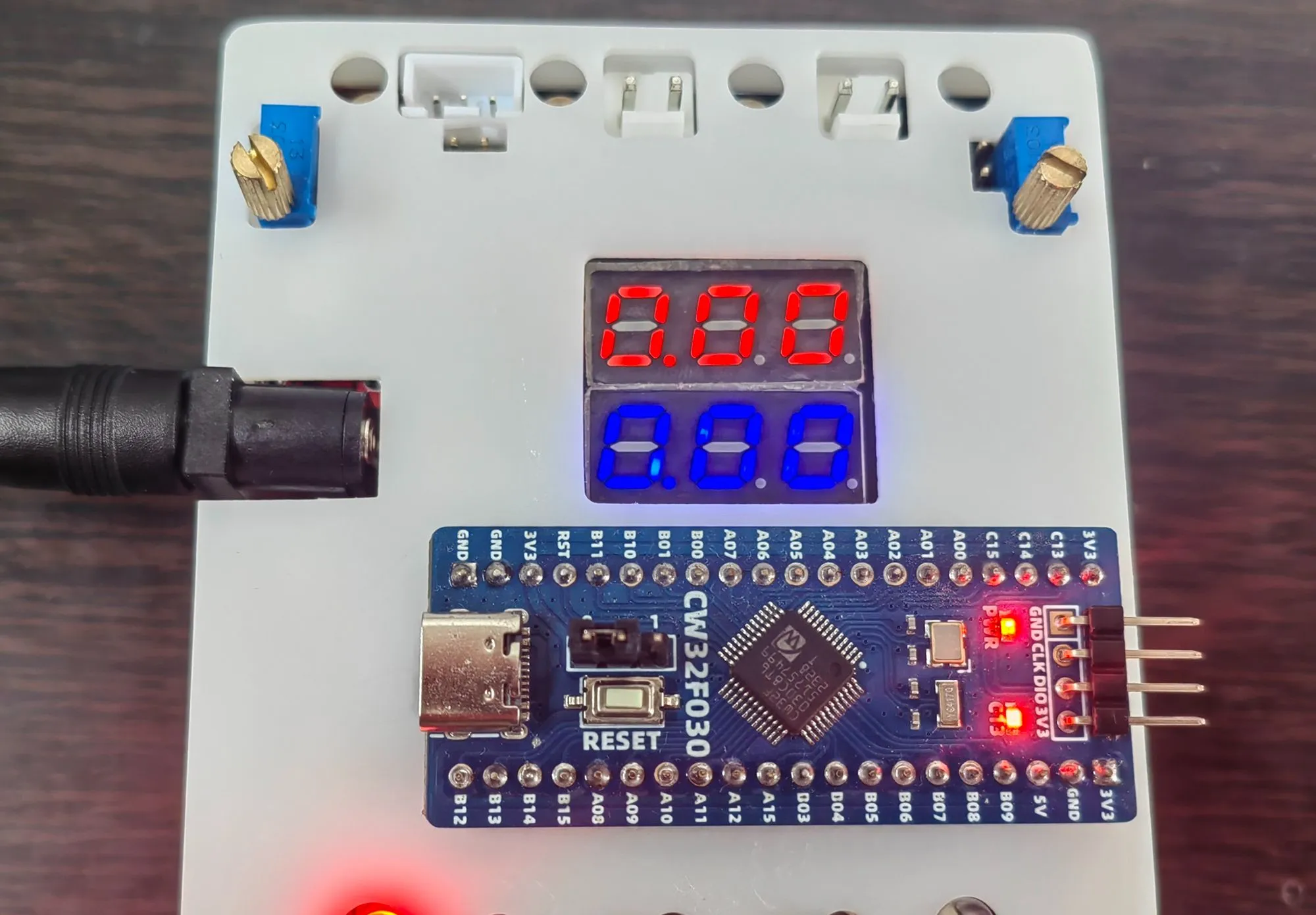

1. Describe
a simple digital voltmeter and ammeter based on the LCSC CW32 microcontroller.
It adopts a core board plus expansion board design concept, using plug-in components to simplify learning and deepen exploration.
The core board uses the domestic Wuhan Xinyuan Semiconductor CW32 as the main controller, while also being compatible with other similar development boards; however, the CW32 has advantages.
The project is highly integrated, practical, and compact, and can be used as a desktop instrument after completion.
A physical image is shown below:
