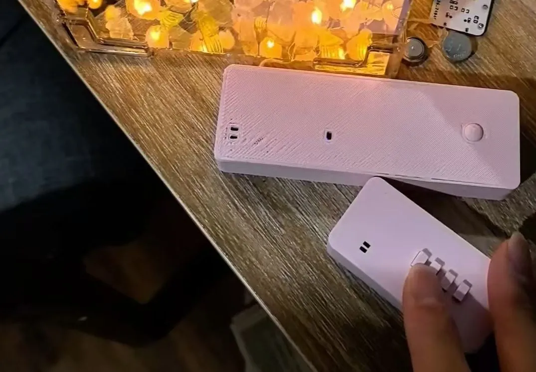

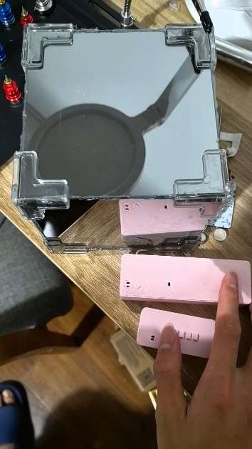

Mini wireless switch
The ESP8266 uses the ESP NOME protocol for data transmission and is controlled wirelessly via onboard buttons on a wireless remote control. The casing was designed using LCSC EDA and 3D printed. A mirror lamp, available online, was modified by adding a control board and batteries. Remote control is possible. Currently, it can control a maximum of four devices, but theoretically, with software optimization, it can control more than four devices.
