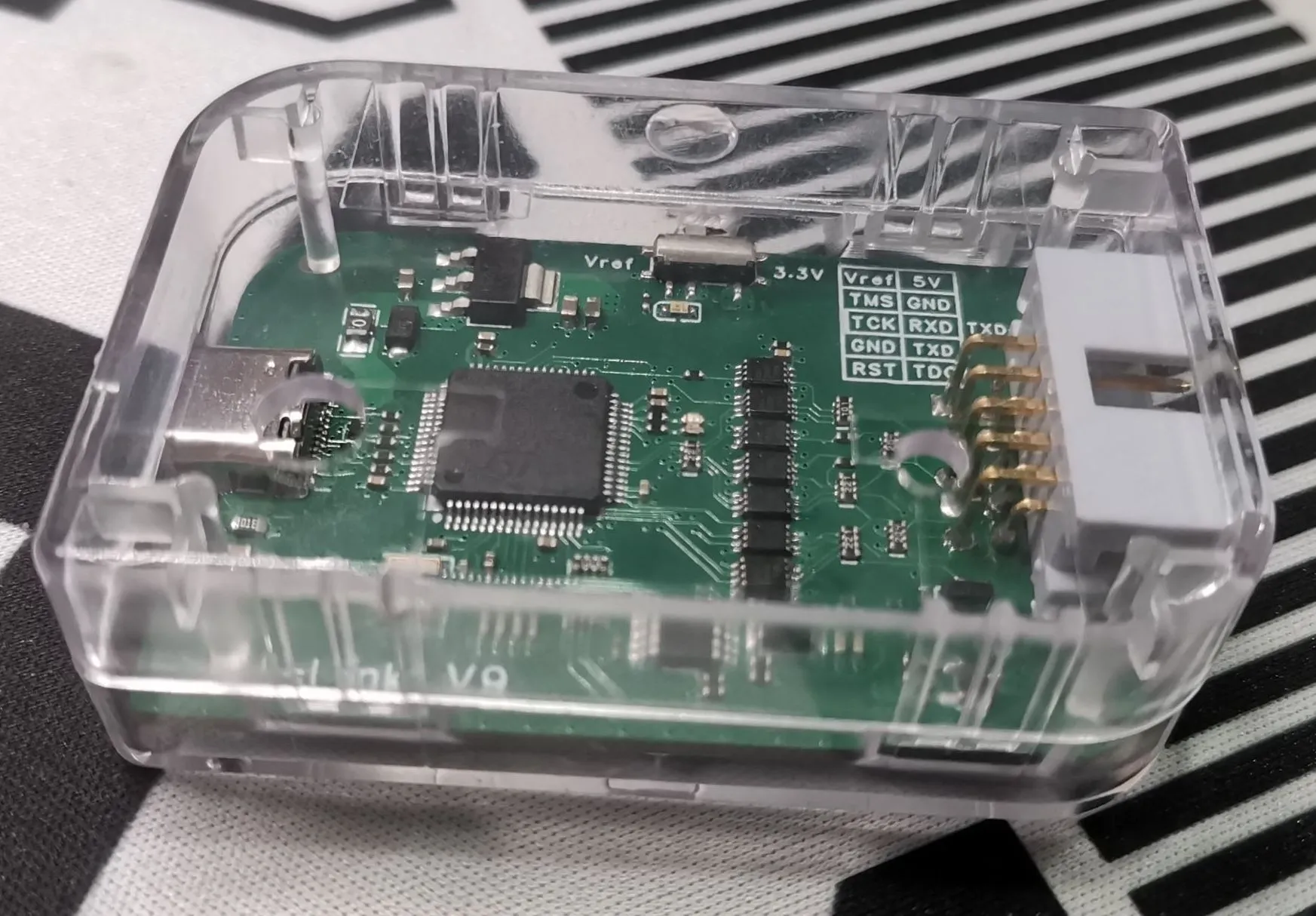

J-Link BASE V9 (Jlink V9)
Attention!!!
Select 7628 stack-up.
The project
uses a generic housing with a Type-C interface and provides a Vref/3.3V power switch (an indicator light will illuminate when switched to 3.3V).
Remove the RTCK signal cable.
Note:
Special note: H1 in the BOM is unnecessary. Purchase an 8.35mm Type-C adapter; standard ones will be slightly recessed.
The Type-C interface requires enlargement. The switch also needs additional drilling depending on the situation (if switching is infrequent, the switch can be removed; one of the case and graphics card will always need to be removed).
Download requires 1.27mm pitch probes; the adapter provides 1.27mm 2x5 and 2x7 adapters, as shown in the image.
