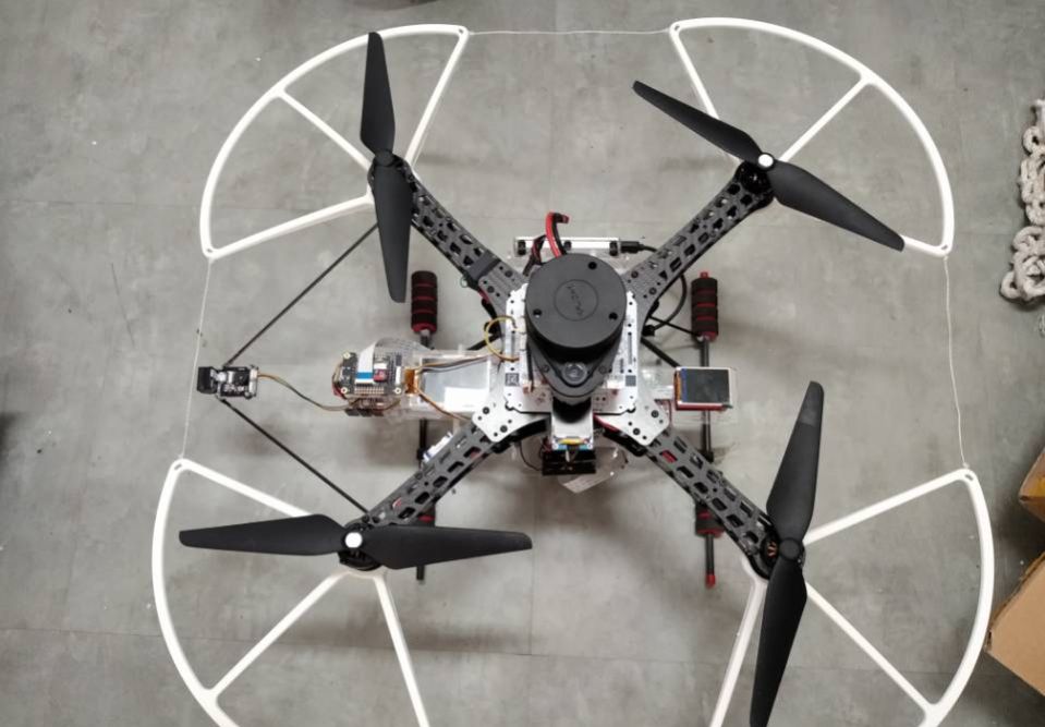

This is the third e-sports competition I have participated in. The national competition was in 2019 and the provincial competition in 2020. Although we are already seniors, the three of us still have the passion for e-sports and decided to insist on participating. After 4 days and 3 nights of hard work, we completed all the requirements of the competition, as well as the self-designed performance items, and finally won the first prize in the country, which brought a perfect end to university life. Using key technologies such as binocular visual fixed-pointing, laser radar obstacle avoidance, and OPENMV recognition, the drone can autonomously cruise when it reaches the take-off altitude, complete seeding, and return home smoothly.

With the rapid development of artificial intelligence technology, intelligent aircraft have been applied to various industries in modern production and life. One of the most successful applications is "plant protection aircraft". By giving instructions to the aircraft, the aircraft can autonomously complete complex tasks such as spraying pesticides and sowing seeds. On the one hand, it can free up human resources; on the other hand, fully automated operations can greatly improve production efficiency. This team designed and developed a plant protection quadcopter drone using the TIVA microcontroller produced by TI as the drone main control and NVIDIA's Jetson NX as the visual processor. The aircraft uses binocular cameras as a visual odometer to achieve fixed-point and cruise. It is also equipped with lidar and optical flow modules to assist the drone in positioning, and uses K210 and OPENMV for target detection. The laser pointer is used to simulate "seeding". The aircraft can realize many functions such as automatic cruise, fixed-point "seeding", target detection, obstacle avoidance, and barcode recognition.

of the transistor drive circuit of each peripheral module . ![Picture 9.png] ## Since the UAV distribution board has many modules, pay attention to the influence of the power supply current. ![Picture 10.png] # Physical display ! [98C69DAB6B72B6FAE76FE341F242B3B5.jpg] Attached is the video link of the debugging process: [Plant Protection Aircraft](https://www.bilibili.com/video/BV16r4y1D7oF/) # Use of drones for assembly of the work 450 frame, equipped with 10-inch propellers and 30A ESC. The main structure uses a carbon fiber body, with acrylic materials as auxiliary materials. From top to bottom are lidar, flight control, NX processor, K210 processor and camera, with barcode recognition modules and binocular cameras on both sides. The overall height is about 50cm. #Programming ## System block diagram ![Picture 11.png] ## Overall flow of UAV system control ![Picture 12.png] ## Flight control program flow ![Picture 13.png] The UAV system is complex and must be passed The tick timer simulates task scheduling to accurately execute each task. After testing, it is easy to debug and the effect is excellent. ## Design algorithm ### Quad-rotor attitude calculation ![image.png] ### Low-pass filtering algorithm ![image.png] ### The core of the visual odometry (VIO) algorithm is visual inertial fusion, which is IMU estimation The pose sequence is aligned with the pose sequence estimated by the camera to estimate the true scale of the camera trajectory. Moreover, the IMU can well predict the pose of the image frame and the position of the feature points at the previous moment in the next frame image, improving the matching speed of the feature tracking algorithm and the robustness of the algorithm to cope with rapid rotation. Finally, the gravity vector provided by the accelerometer in the IMU Convert the estimated position into the world coordinate system required for actual navigation. #Implementation ## Model training and testing plan: Build YOLOV2 network on PC, train the data set, and deploy it to K210 for detecting point "A" and take-off and landing points. Test results: The model training loss function is as shown in the figure: ![Picture 14.png] Analysis: The loss functions of both the training set and the test set can be reduced to less than 0.05, and the recognition accuracy is high. ## Path planning test plan: The drone uses the visual odometry to obtain the position coordinates at each moment, cruises based on the prior knowledge of the map, K210 finds the take-off and landing points and "A" point, OPENMV identifies the "seeding area" and "non-sowing area" "Sowing Area", the laser radar looks for the pole, the LED flashes after scanning the code, and finally returns to home based on VIO. The schematic diagram of cruise is as follows. The solid line represents the laser pointer flashing, and the dotted line represents the laser pointer turning off. ![Picture 15.png] Test results: The positioning error of the UAV based on the VIO system is less than 5cm, and the target detection accuracy is above 0.7. Barcodes can be accurately scanned from a distance of 30cm from the pole. The return error of the drone is within 10cm. Analysis: Using multi-sensor data fusion, the solution design is reasonable and can meet the question requirements. # Summary The entire competition process is not smooth sailing. Try various solutions to choose the best one. The whole process is a process of continuous learning. The clever use of visual odometry, lidar-assisted obstacle avoidance, the combination of deep learning methods and traditional visual methods, and the flexible application of innovative methods finally fulfilled all the requirements of the question and added additional functions as appropriate. I believe that the plans and experiences gained in this process will also be of great help to future drone research and study. Apply theory to practice, and then to development and application, so as to truly apply what you have learned.
