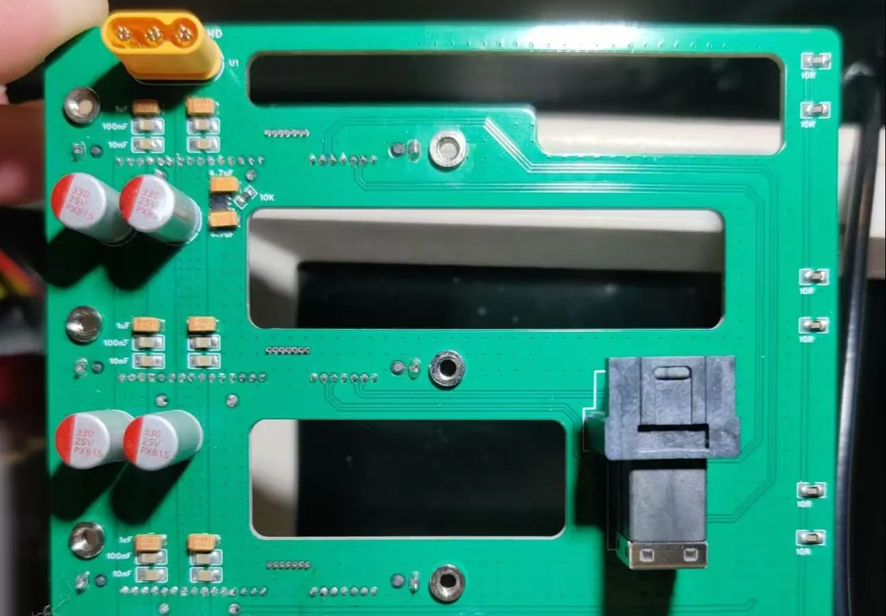

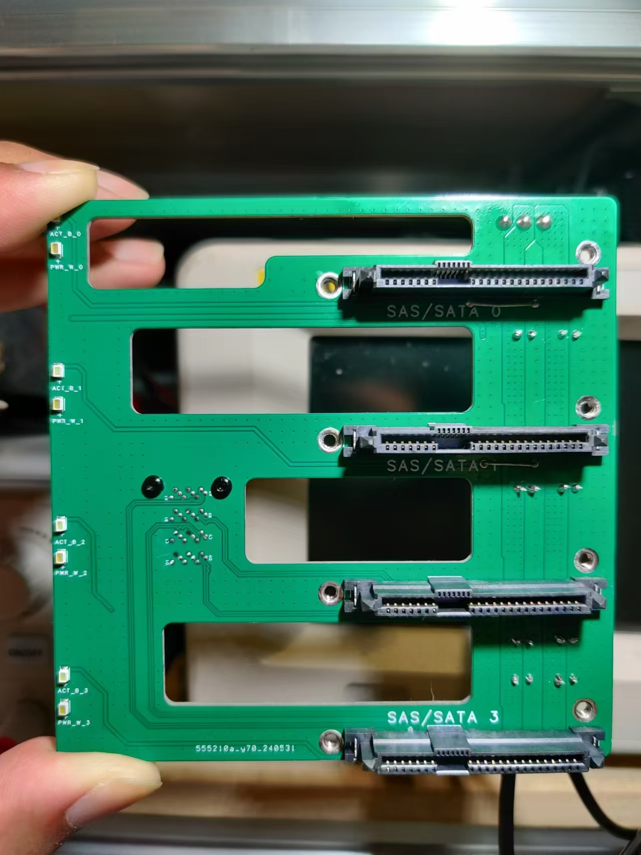

The backplane's
main function is to split an 8643 into four SAS (SATA compatible) interfaces, with read/write LEDs already brought out. Another is a power indicator light.
Some are 2-layer boards, and some are 4-layer boards; they are basically based on the same schematic, with differences mainly in layout and LED indicator positions. The "8643_3.5x4_Dell Hard Drive Bracket_V3" has read/write indicator light jumpers, which can be soldered separately as needed.
The PCB designations are
as follows: those marked with "Verification" are from earlier verification phases and are not recommended.
Designations like "2.5*4" represent 4-bay 2.5-inch hard drives
; "2.5*6" represents 6-bay 2.5-inch hard drives (SATA direct output)
; and "3.5*4" represents 4-bay 3.5-inch hard drives. Designations
with "Huawei V5 Hard Drive Bracket" or "Dell Hard Drive Bracket" indicate the compatible hard drive bracket. LED indicator lights
on the PCBs indicate 12V step-down to 5V DC-DC modules, none of which have been verified. (I recommend another DC-DC module project.)
Originally, I planned to integrate the DC-DC module onto the backplane and verified this, but considering module heat dissipation and the heat generated by SAS hard drives, later modifications eliminated the DC-DC module. All
designs
except the power board have been verified.

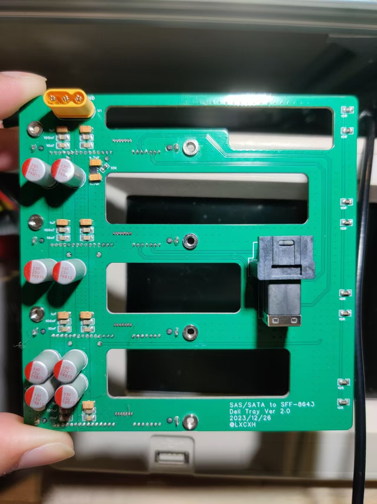

The following images are actual PCB layouts for the "8643_3.5x4_Dell Hard Drive Enclosure_V3".
We recommend using the "8643_3.5x4_Dell Hard Drive Enclosure_V3", "8643_3.5x4_Huawei V5 Hard Drive Enclosure", and "SATA_2.5x6_Huawei V5 Hard Drive Enclosure".

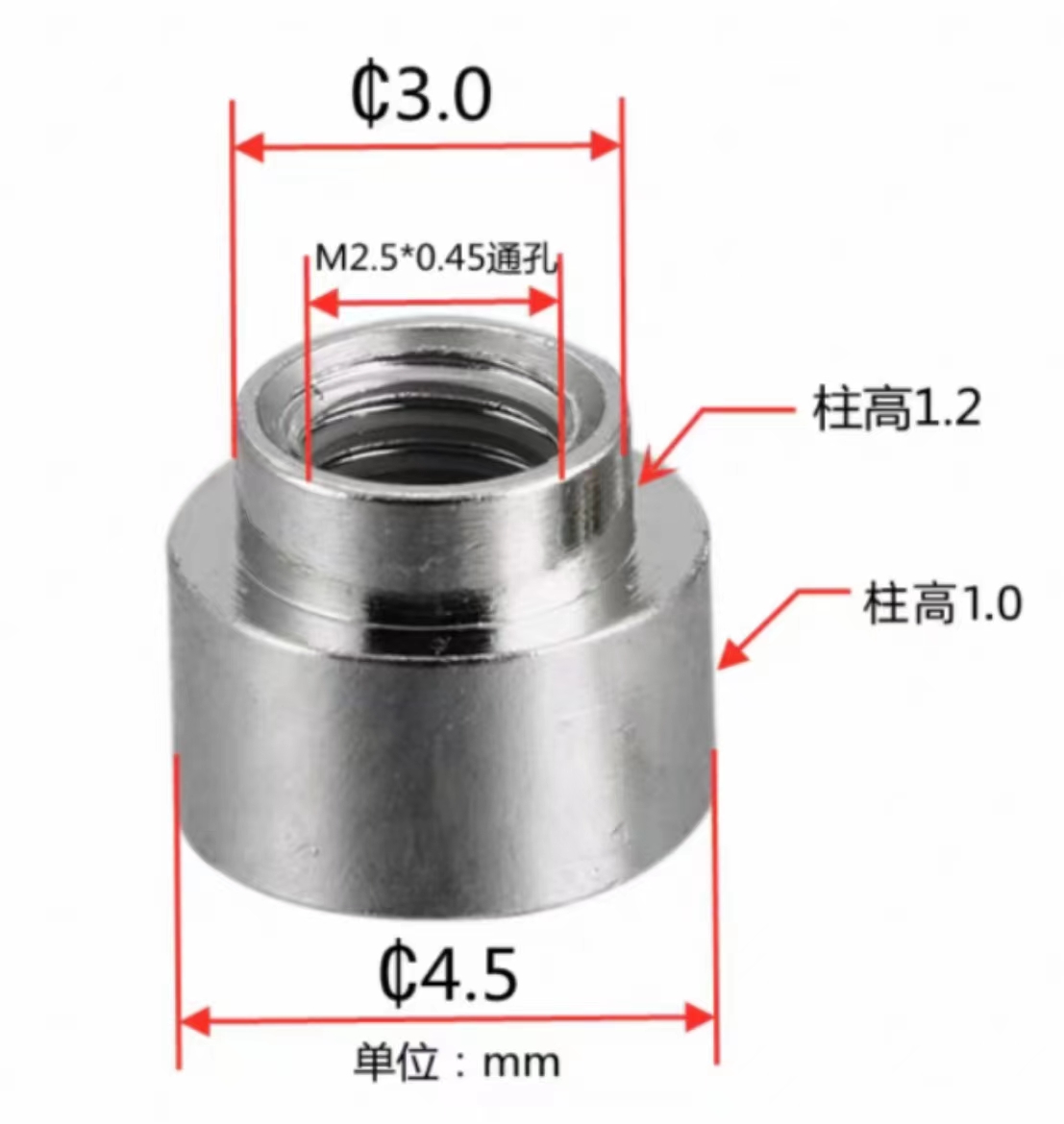

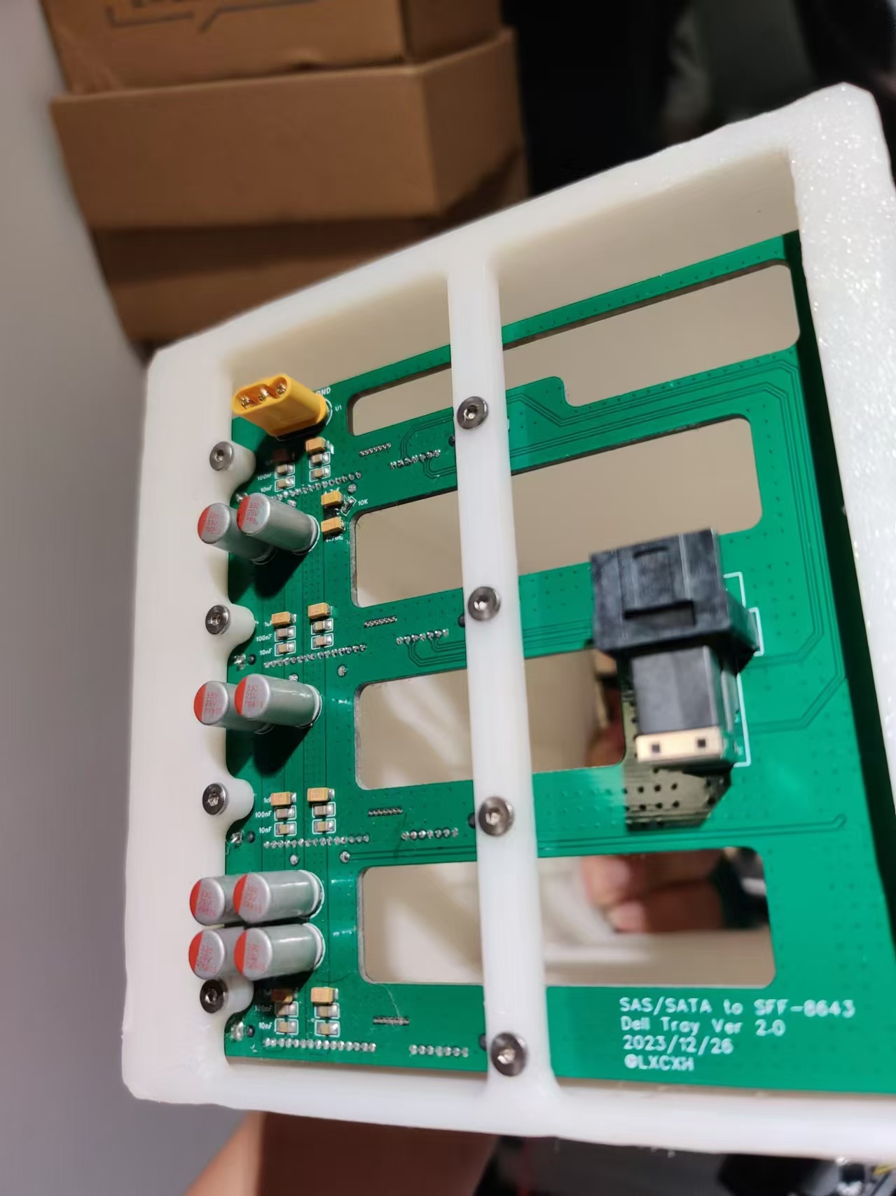

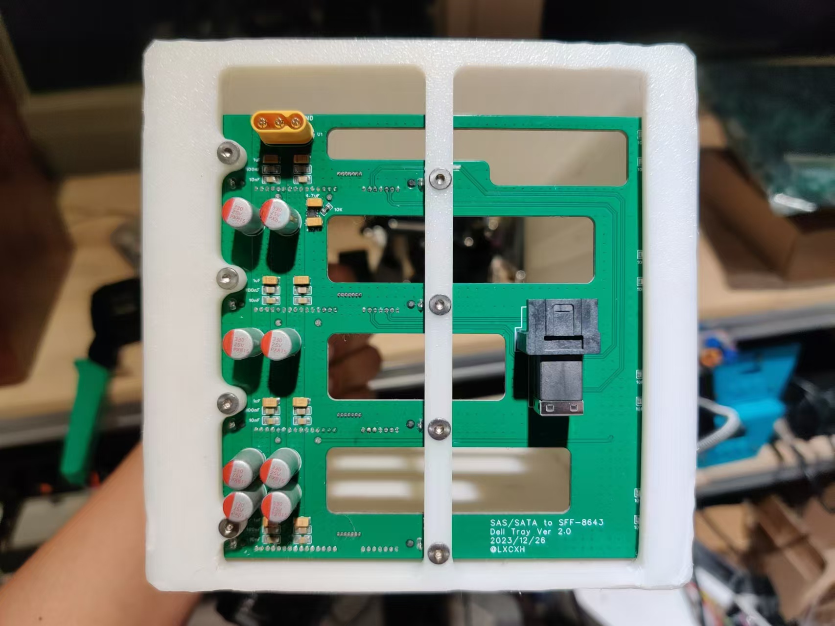

The "8643_3.5x4_Dell Hard Drive Cage_V3" uses M2.5x4.5x1+3.0x1.2 solder nuts for its 8 mounting holes. The boss and SAS interface face the same direction. The hard drive
cage design files
for the three recommended PCBs have been uploaded. ABS printing is recommended. ---
Added a direct-insertion enclosure design file in July 2024, suitable for the "8643_3.5x4_Dell Hard Drive Cage_V3" PCB file, modified from [QNAS4](【Ultra-mini QNAS4 Bay NAS Chassis 3D Printing FDM】 https://www.bilibili.com/video/BV1Kg411z7EG/?share_source=copy_web&vd_source=d9ae15399e57a07dece7b346f766d793) hard drive cage, all verified. --- August 2024
