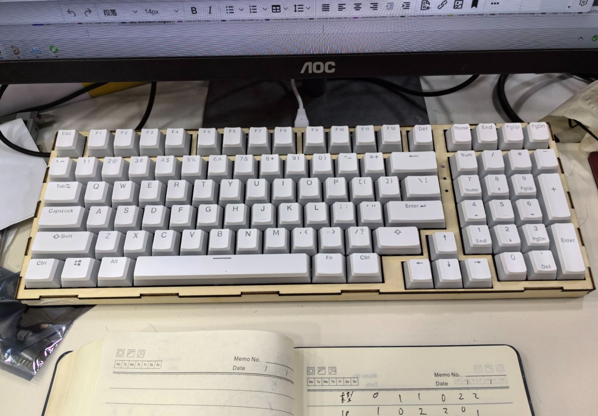

98-key high-speed USB keyboard, 8000Hz polling rate, 10 yuan main control chip
Key parameters: USB 2.0 HS protocol, 8000Hz polling rate, 250µs trigger latency, 2ms release latency.

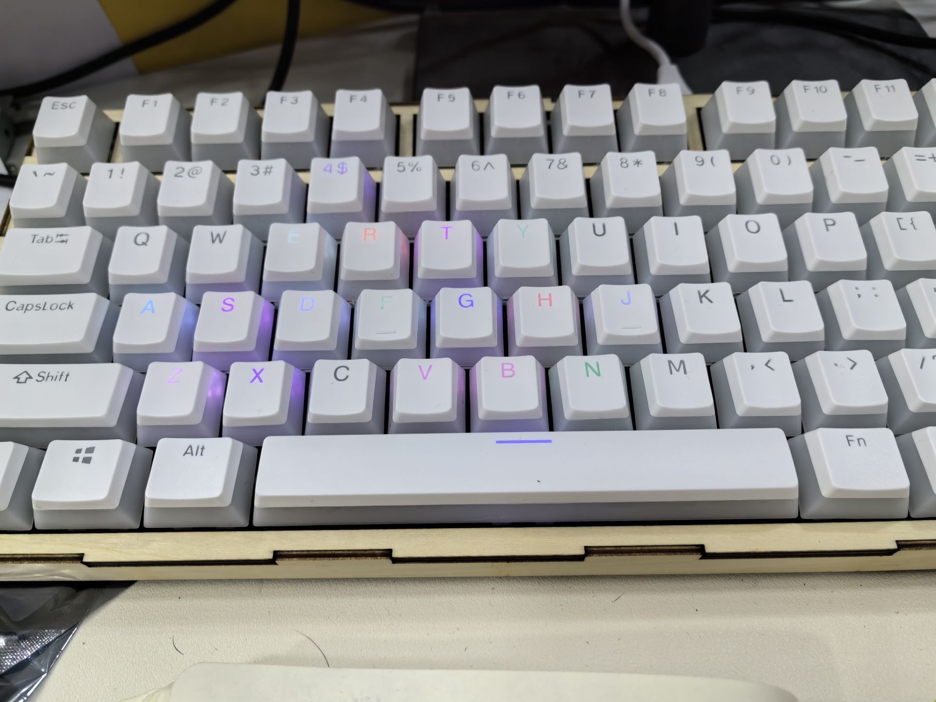

The CH32V305FBP6's ports are almost fully utilized. The SPI interface is used to read button scan signals, and the UART is used to send LED data. Since the start and stop bit levels of the UART are exactly opposite to the control signals of the WS2182, an inverter was added.

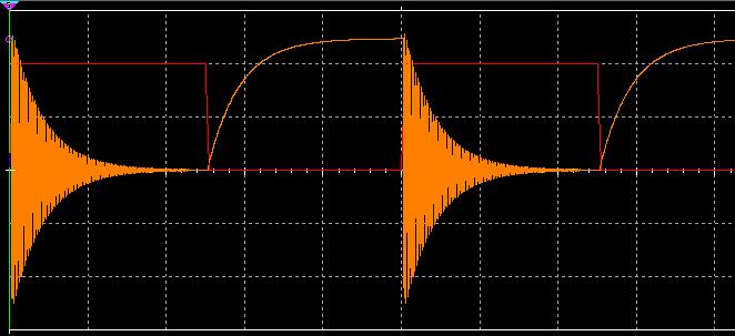

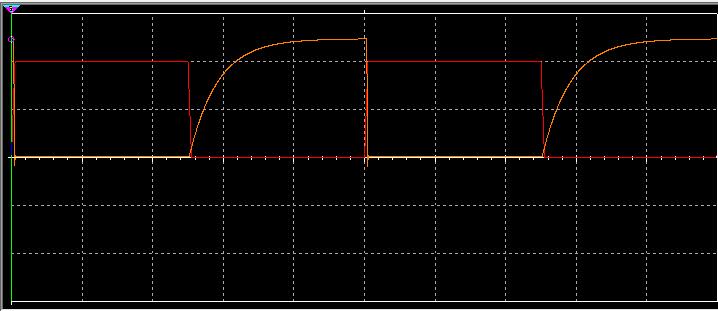

Each button has a 120Ω resistor in series to eliminate signal oscillation and improve signal quality.
Without the resistor, the circuit would ring due to parasitic inductance/capacitance at the moment of conduction.
The 120Ω resistor in series significantly improves signal quality
and the current lighting effect. The randomly colored RGB

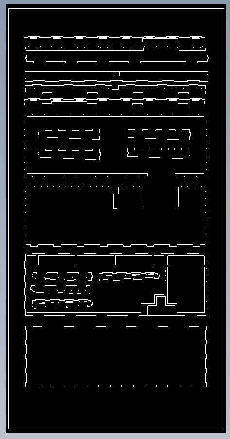

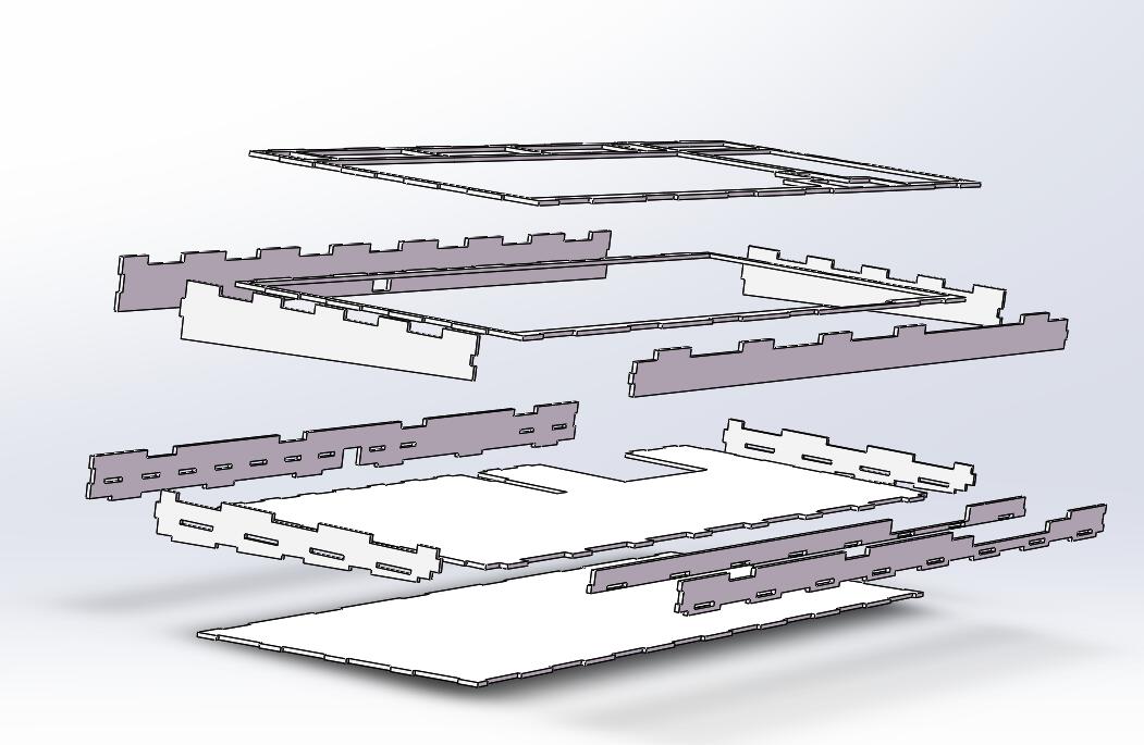

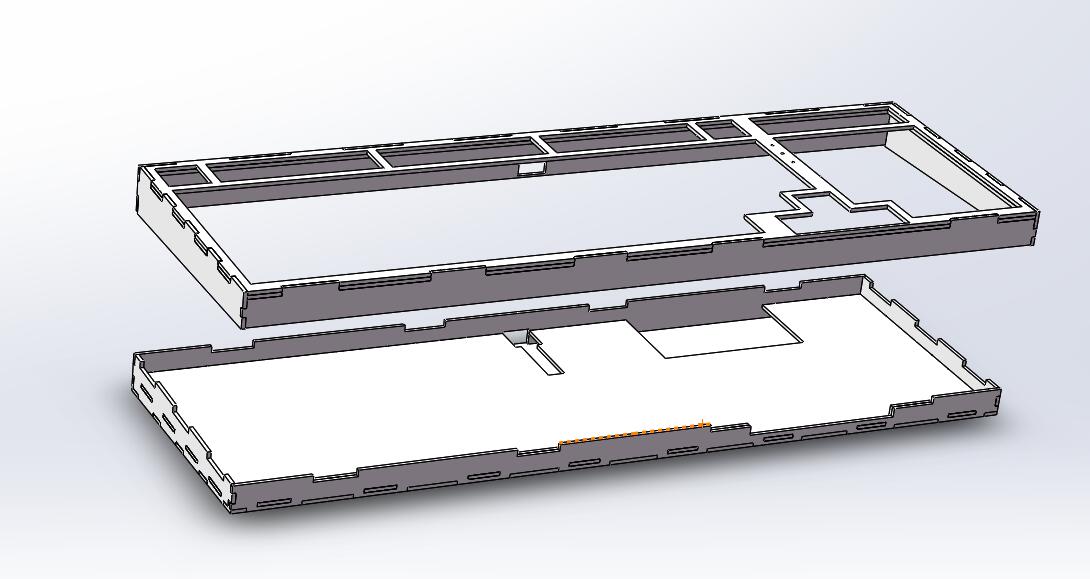

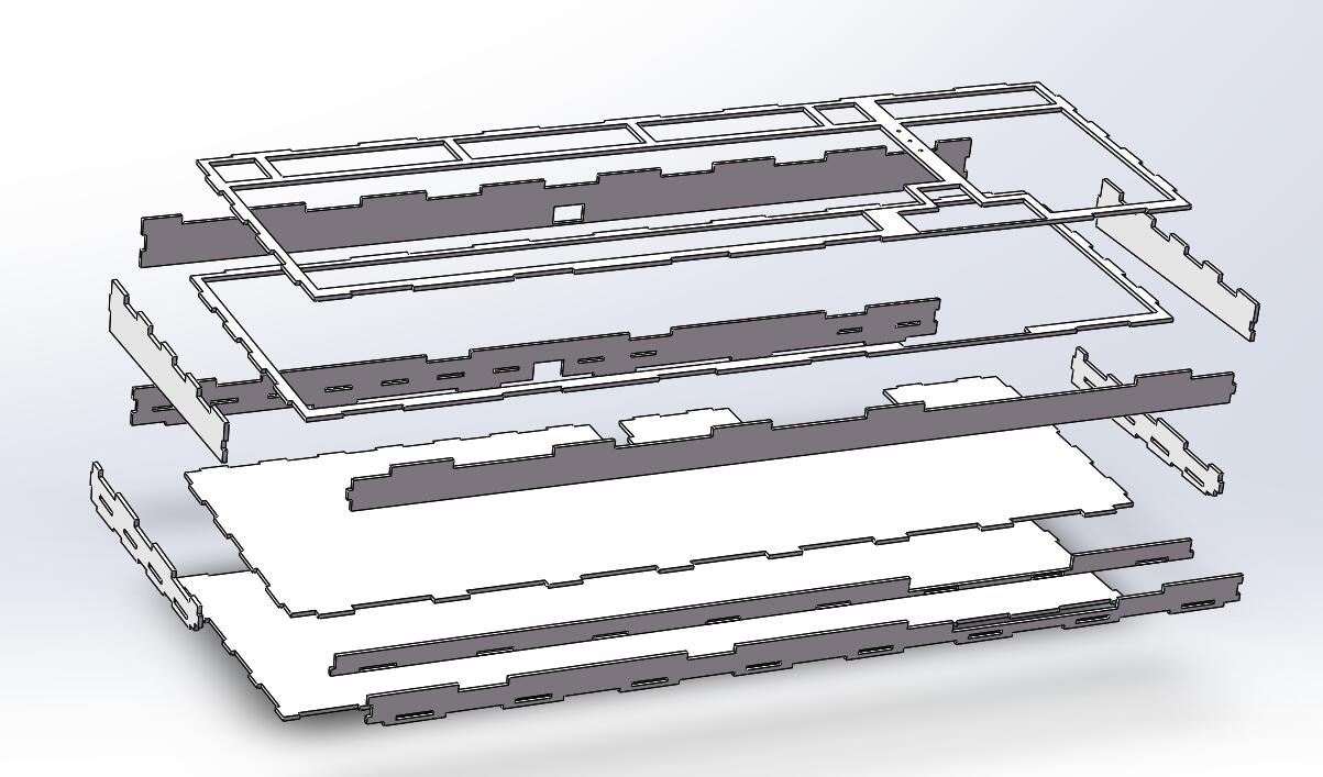

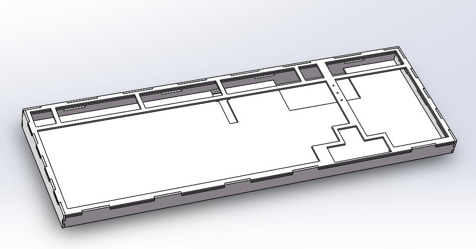

casing is made of 2mm thick basswood, cut and assembled. A set of 450*880mm can be directly cut, costing approximately 40 yuan.

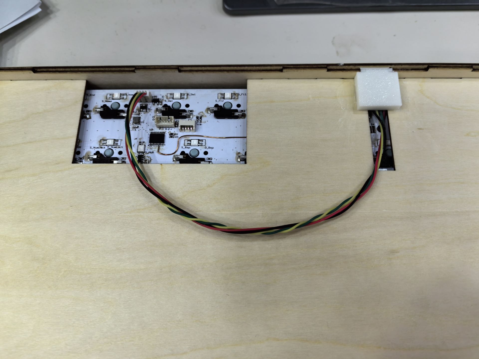

The PCB and positioning board are fixed with 2mm double-through copper pillars and screws.
The copper pillars are M2*5 (outer diameter 3.2mm), and the screws are M2*3.
The USB connection uses a separate small board, fixed with a 3D-printed base
(the flying wires were damaged during debugging, please ignore them).
