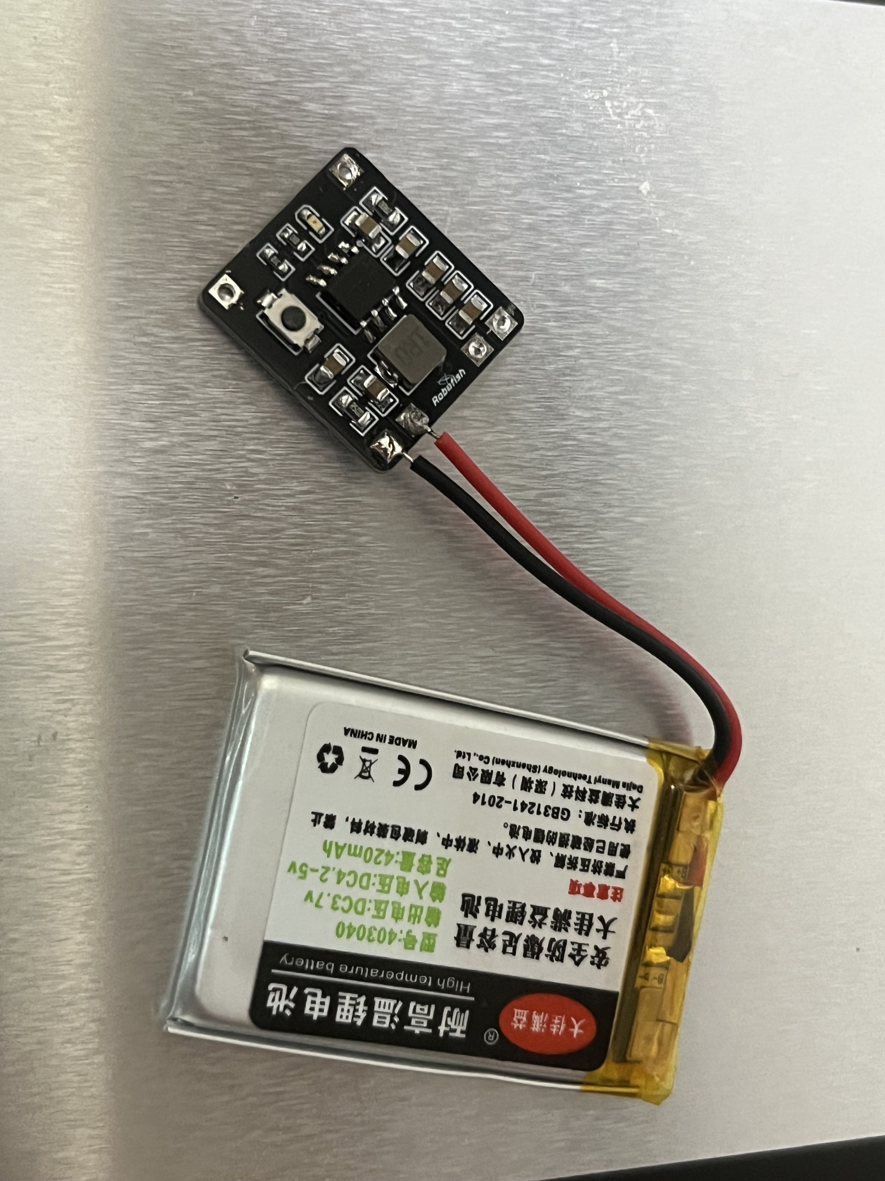

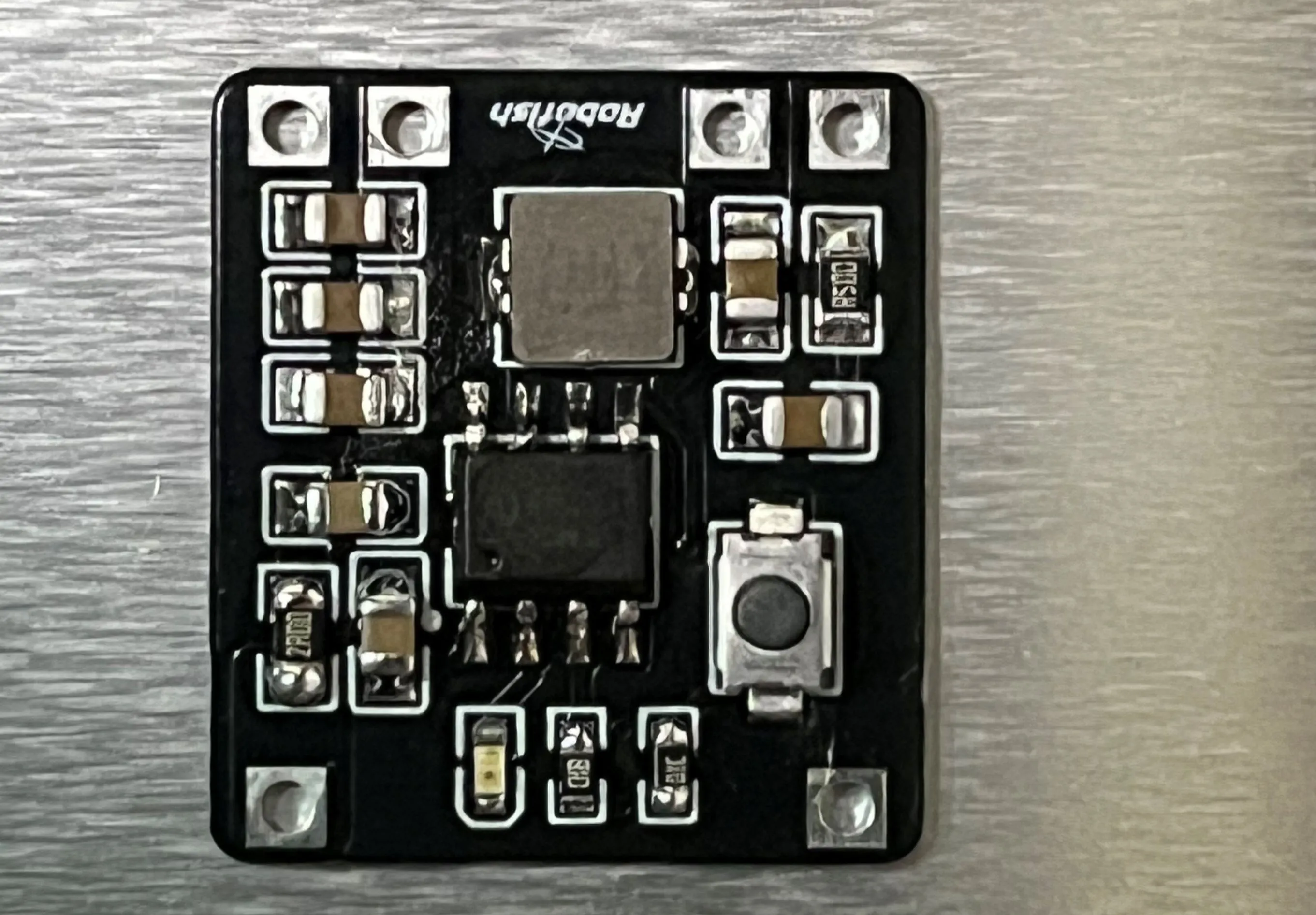

Project Description:
This surface-mount lithium battery charging and discharging integrated circuit was created for future design of other boards. It's a stable and high-quality power module that facilitates subsequent design processes.
Instructions for Use:

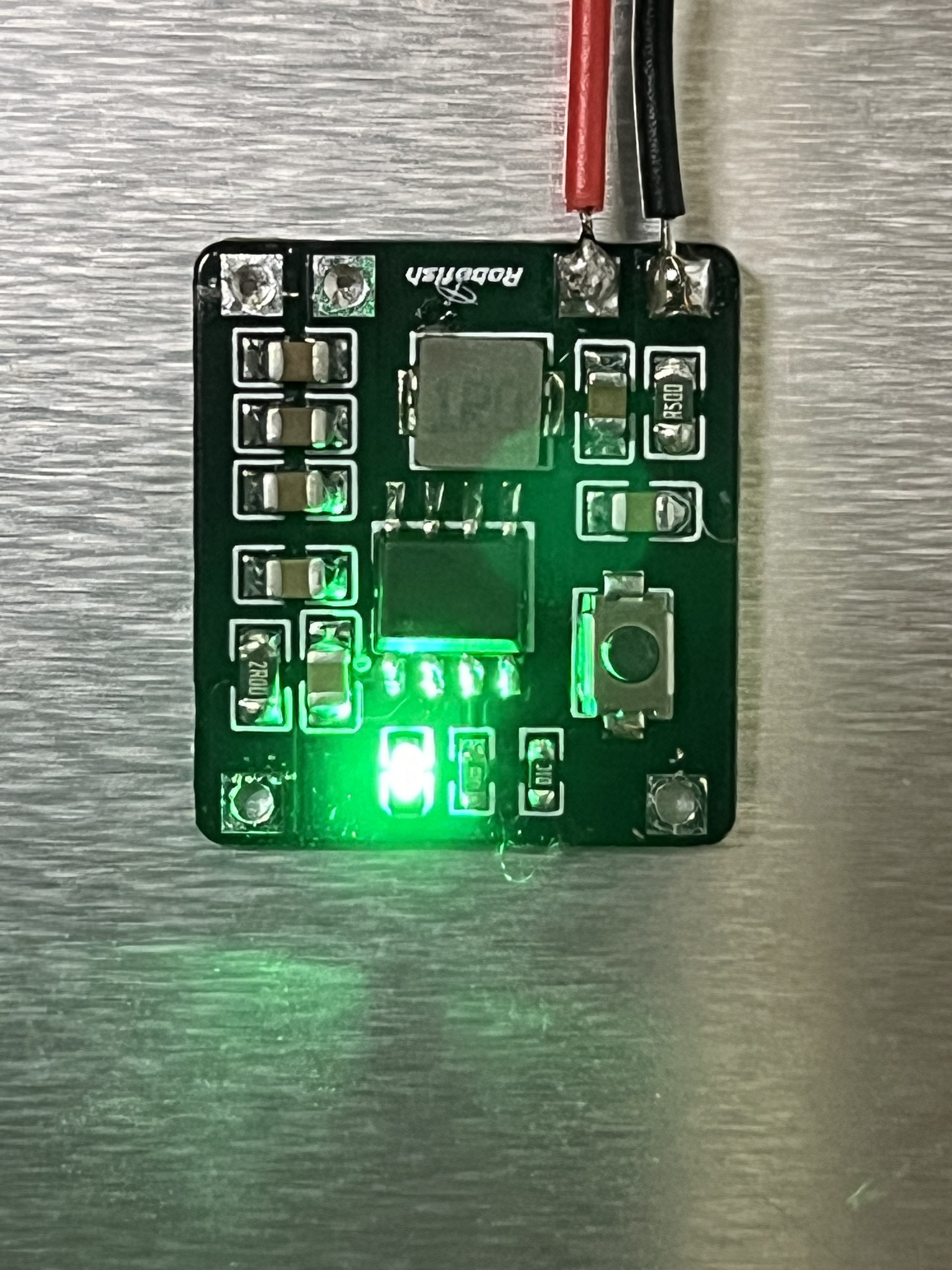

After connecting the battery, press the button to start 5V output; the LED will light up. (Note: Output is not initiated by default when the battery is connected; it only starts after the button is pressed.) Double-click to stop output; the LED will turn off.
When connected to 5V, the LED will flash, indicating charging. The LED will remain constant, indicating the battery is fully charged or not connected. (The LED will not remain off after the module is powered by 5V.) Product Showcase:
