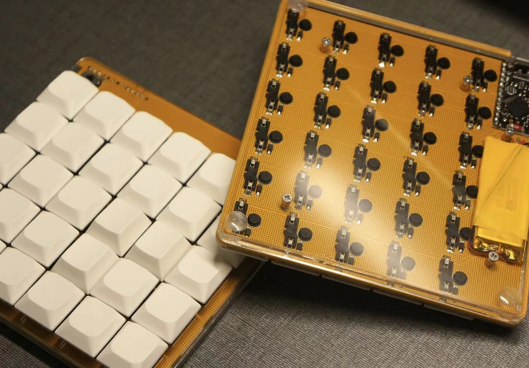

60-row split keyboard, KMK dual-mode solution
The development board I chose is NRFMicro (from an unknown tech seller on Taobao, it's cheap).
KMK is based on Circuit Python firmware. Download the corresponding Nice Nano firmware from the official website, install it into the bootloader, and once the development board recognizes it as storage, install the corresponding left and right-hand code.
参考设计图片
