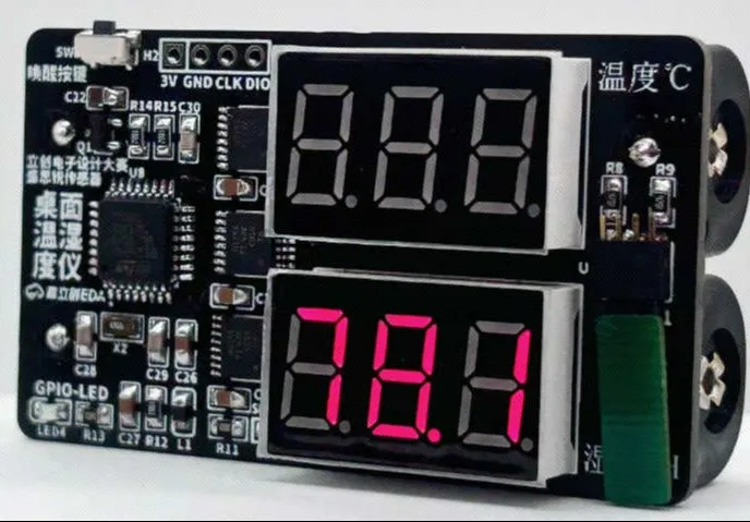

  desktop temperature and humidity meter uses an SHT40 microcontroller to detect indoor temperature and humidity. Data is displayed using two 3-digit common-cathode LED displays. It is powered by two AA batteries and remains in sleep mode when not in use. The estimated lifespan is 6 months.
  The project uses the STM32G030K6T6 chip as the main control chip. This chip uses an ARM-Cortex-M0+ core with a maximum frequency of 64MHz, 32KB of Flash and 8KB of SRAM, and operates between 2.0V and 3.6V, which is more than sufficient for a desktop temperature and humidity meter.
  All code in this project is generated using STM32CubeMx software, which is simple and easy to use.
Considering
  that most students learning this project are beginners and have limited experience with the G0 series, and that online resources for the G0 series are less abundant than for the traditional C8T6, STM32CubeMx software is used directly for basic code generation and configuration. The graphical interface reduces learning time and allows for quick start-up. The STM32CubeMx
