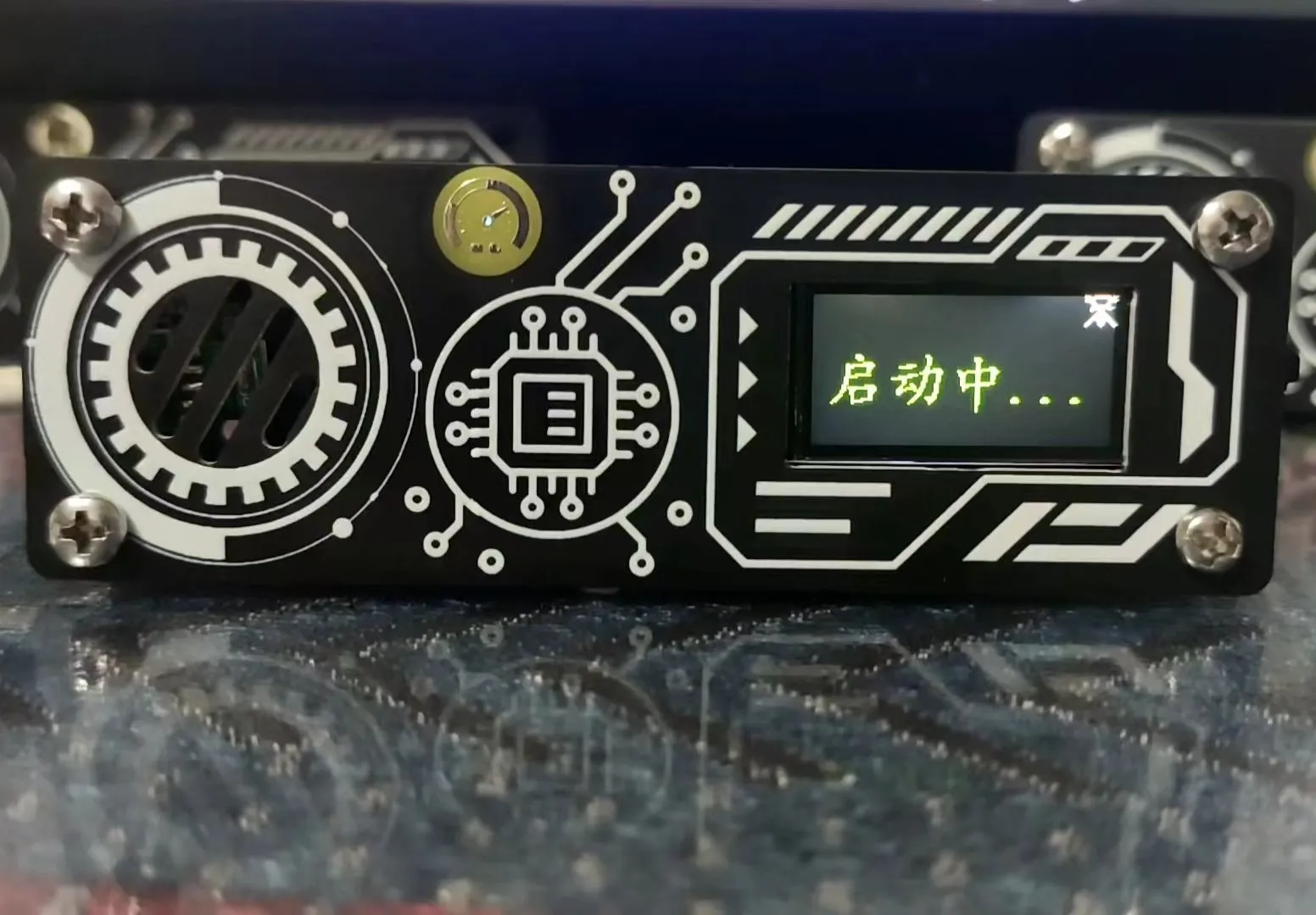

 1. Project Function Introduction:
0.96-inch TFT color screen desktop thermometer and hygrometer + network time synchronization clock + stopwatch + multi-color breathing light.
Micropython programming, [even beginners can complete it in a day].

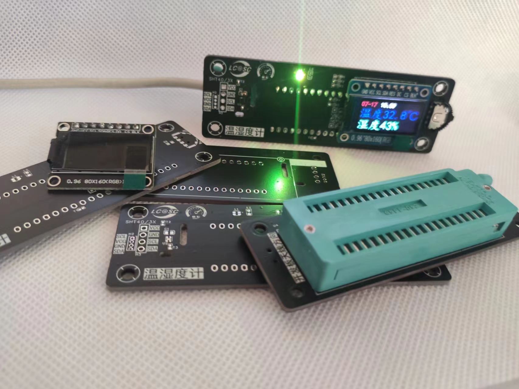

4. Hardware:
Minimum of only 2 surface mount resistors and 0 LEDs (using monochrome LEDs, no need for selector switches; for simple button functions, consider using the boot button on the development board).
Everything else is through-hole, even beginners can handle the soldering.

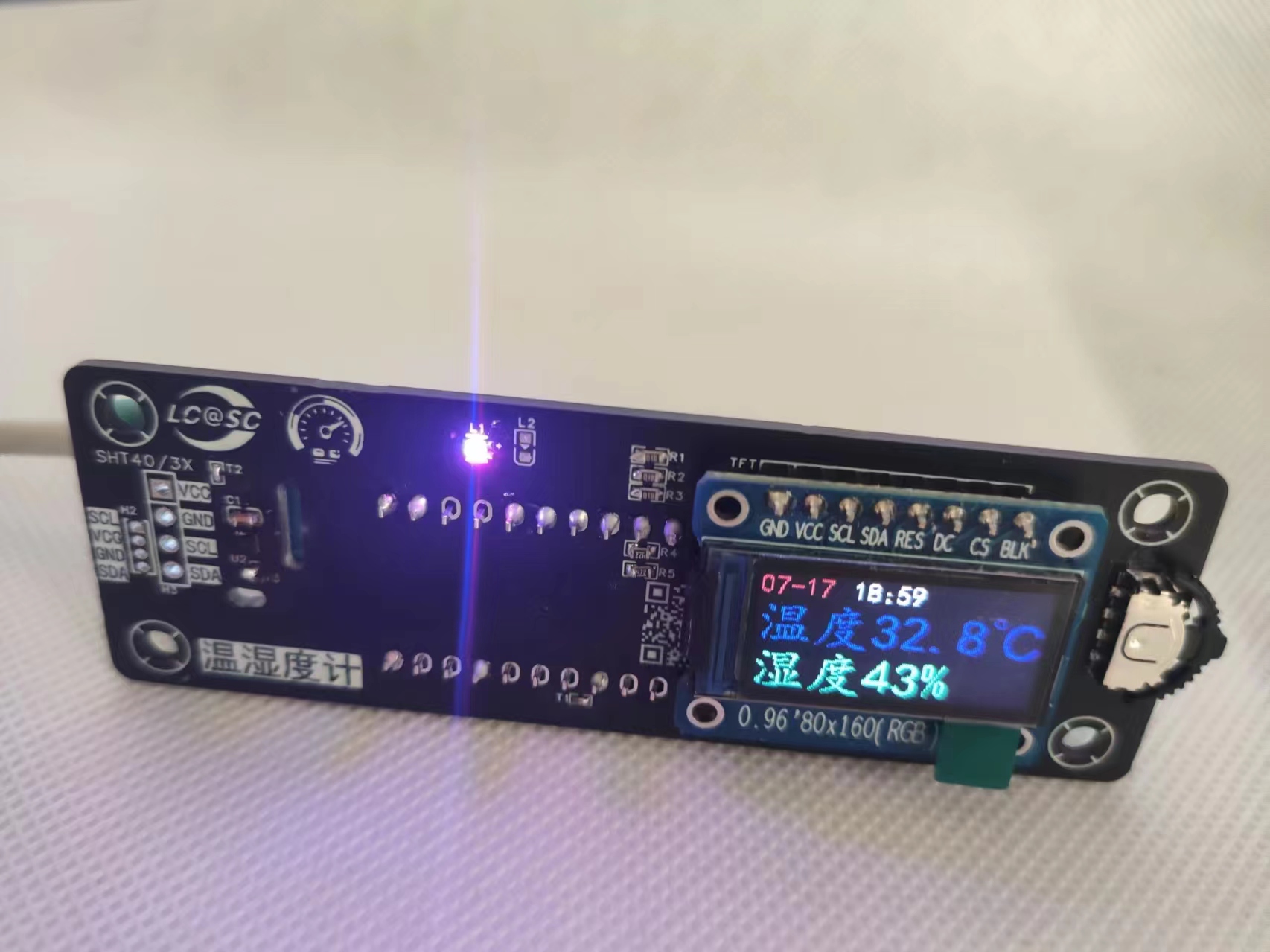

Uses a 0.96-inch TFT screen to drive the ST7735s, can connect to SHT40/3x temperature and humidity sensors. If you are confident in your hand strength, you can also try soldering the sensor directly.
The tri-color LED allows for various color breathing lights; the four-pin, two-position selector switch makes selection/switching easy.
It supports the ESP32-C3 classic version and LCSC ESP32-S3 development board, so you'll never have to worry about what to do with the development board again.
Already mastered the temperature and humidity meter? Want to use the development board for other things? Sure! The locking socket design allows for one-click disassembly and assembly of the development board, ensuring reuse and preventing waste.

1. There is an open-source driver for the ST7735 display. It took me two days to debug this. The display bit width of the screen and this driver are not completely compatible. You need to adjust and modify it yourself. Your 0.96 TFT screen may be different from mine, so you need to modify it yourself. I have encountered problems such as screen flickering, italic text, incomplete display, and incorrect colors. Don't panic if you encounter problems; I have basically solved them for you.
2. When the font is shrunk, some strokes are not fully displayed. Therefore, I used two font libraries, T16 and T32. The two fonts are completely identical, only the default font size is different. When shrunk, the strokes may not be fully displayed. When enlarged, the font granularity is large. So use the large font library for larger displays, and the small one... I'm too lazy to repeat myself.
3. The code and firmware are based on the classic ESP32C3 development board. Theoretically, it can also be used with the LCSC ESP32S3 development board, but this has not been verified. There may be some perplexing issues that you'll have to resolve yourself. Firmware development is also not underway – time is limited and we can't afford to waste any more time.
4. The H2 interface is the sensor module interface sponsored by LCSC for this event, H3 is the Taobao universal module interface, and U2 is the SHT40 sensor. Using just one is sufficient. However, a minor bug (not a bug in the traditional sense) occurred during the design: the wiring sequence was inconsistent between the components and modules (as shown on the silkscreen). The components need to be reversed in the code, but this shouldn't affect the overall design. When using components, it's recommended to remove the copper plating around the components and the heat sink. However, components are difficult to solder, so modules are recommended.
