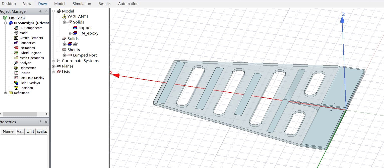

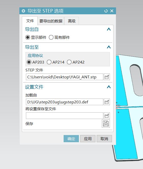

Antenna Design Step 1:

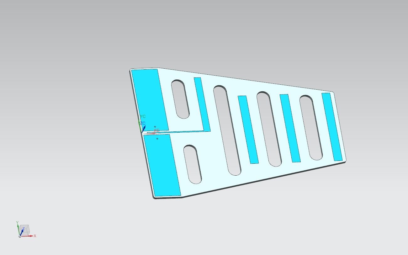

Let's draw a diagram first, like this:
Then export it in STP format, like this:

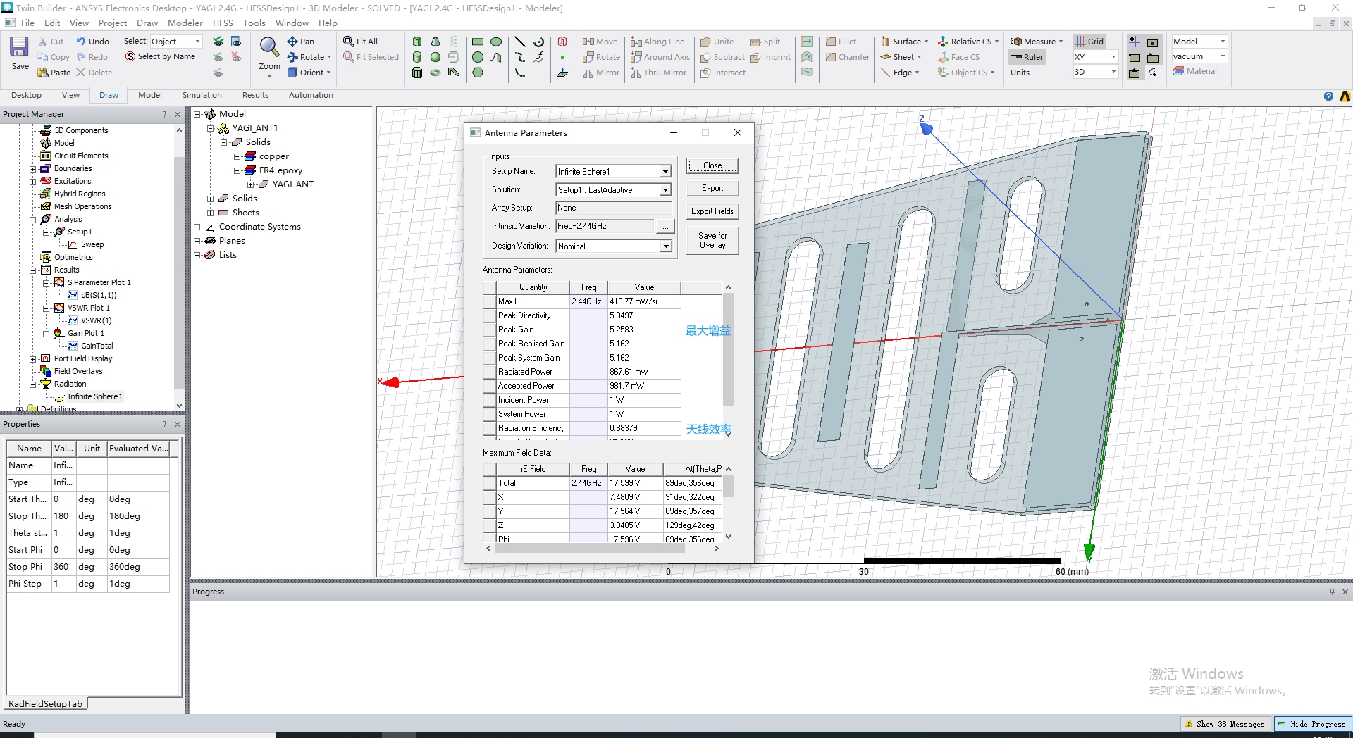

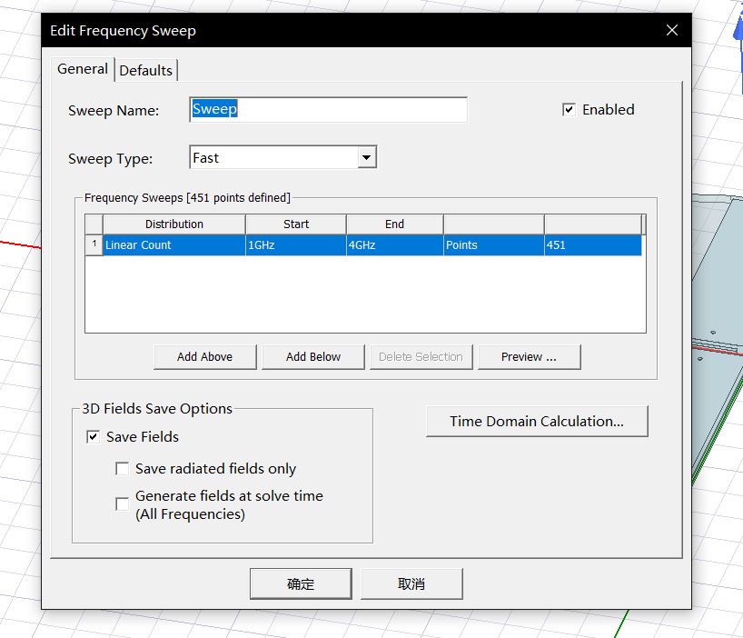

Then open HFSS, import the STP, and make sure to set the material and airbox, and don't forget to
set the solution mode and frequency range
for the feed point. The long simulation process begins...

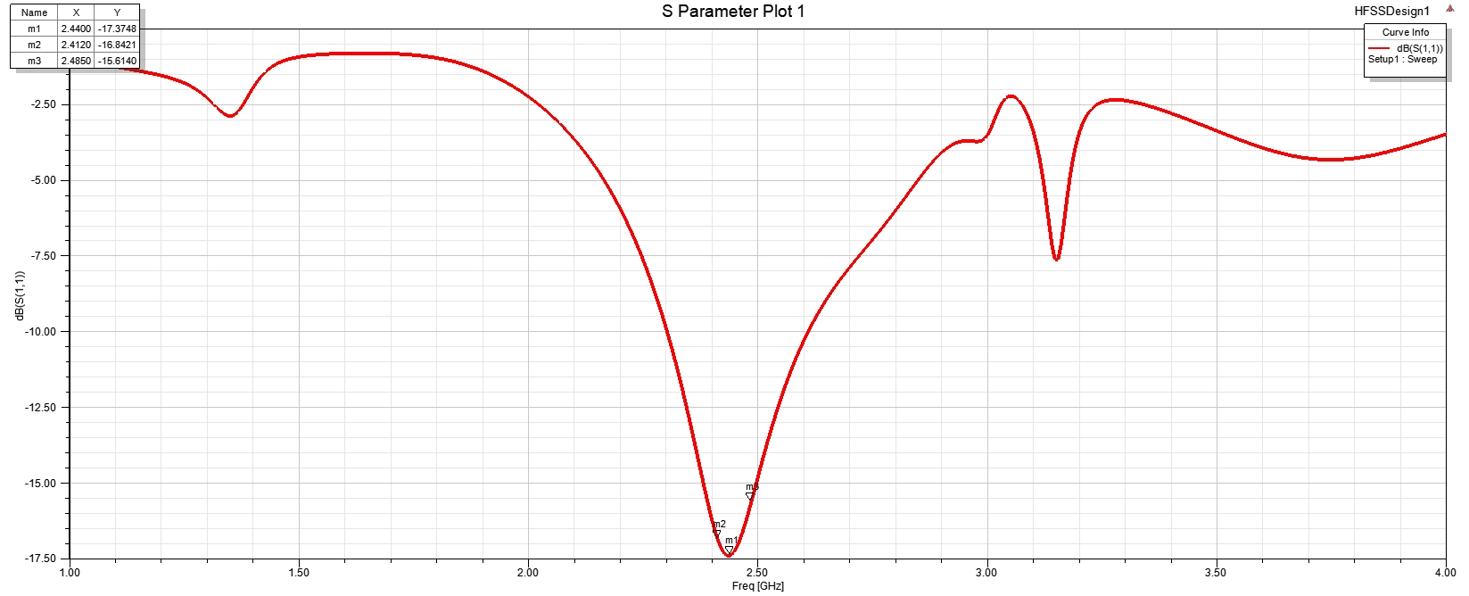

Then the simulation is complete. Here are the results

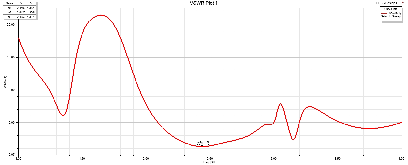

: S11 parameters:
VSWR parameters:

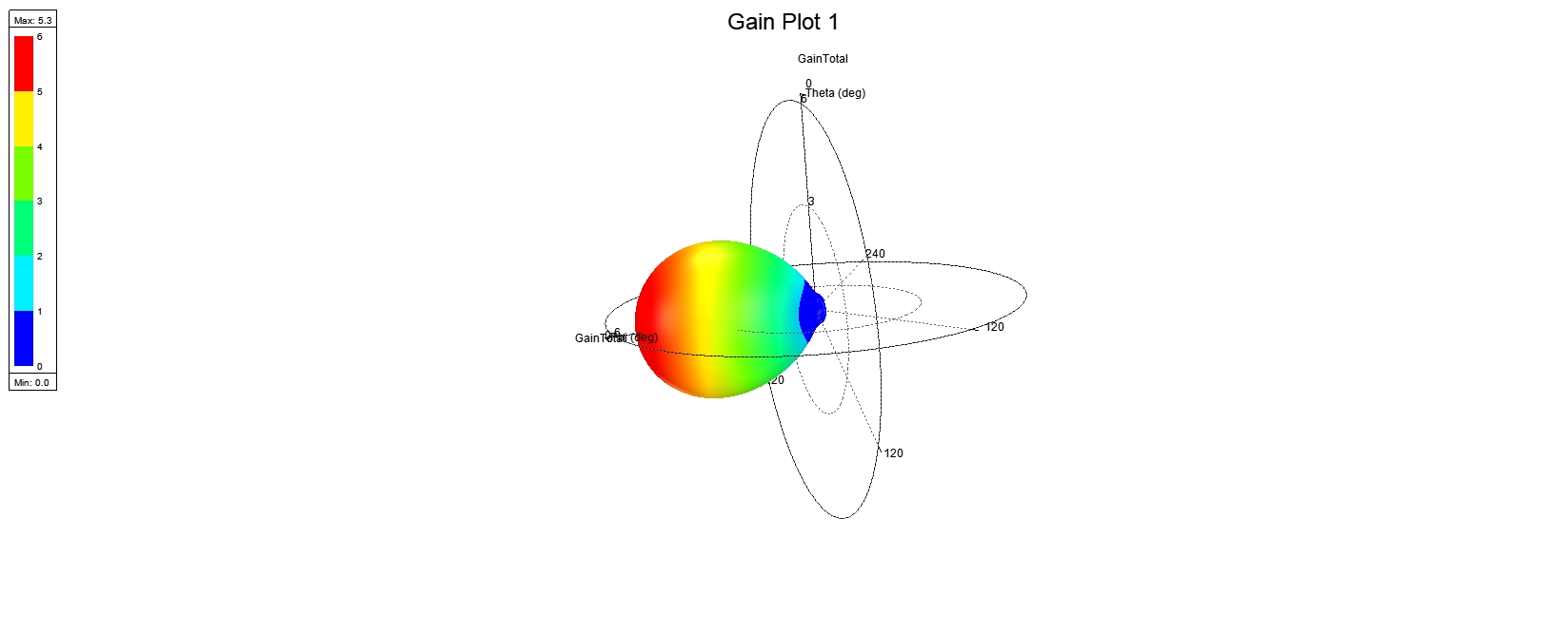

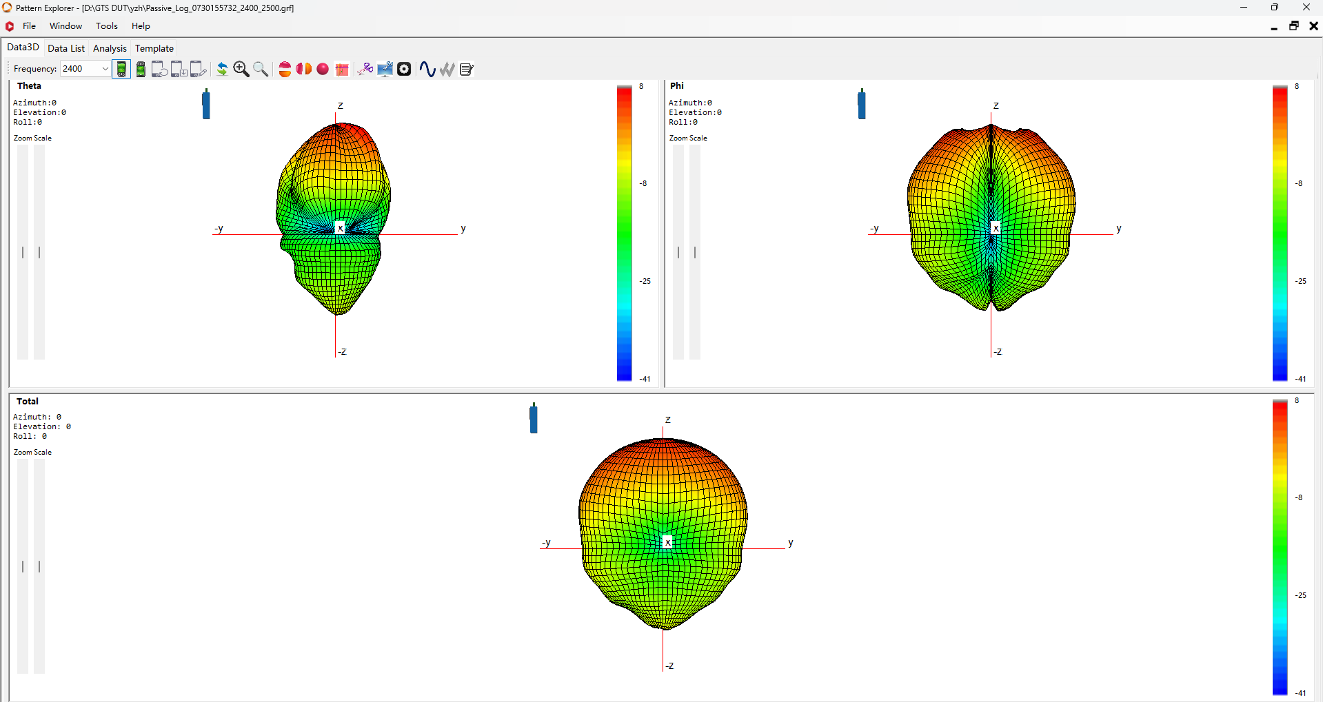

3D gain pattern:
Maximum gain and antenna efficiency:

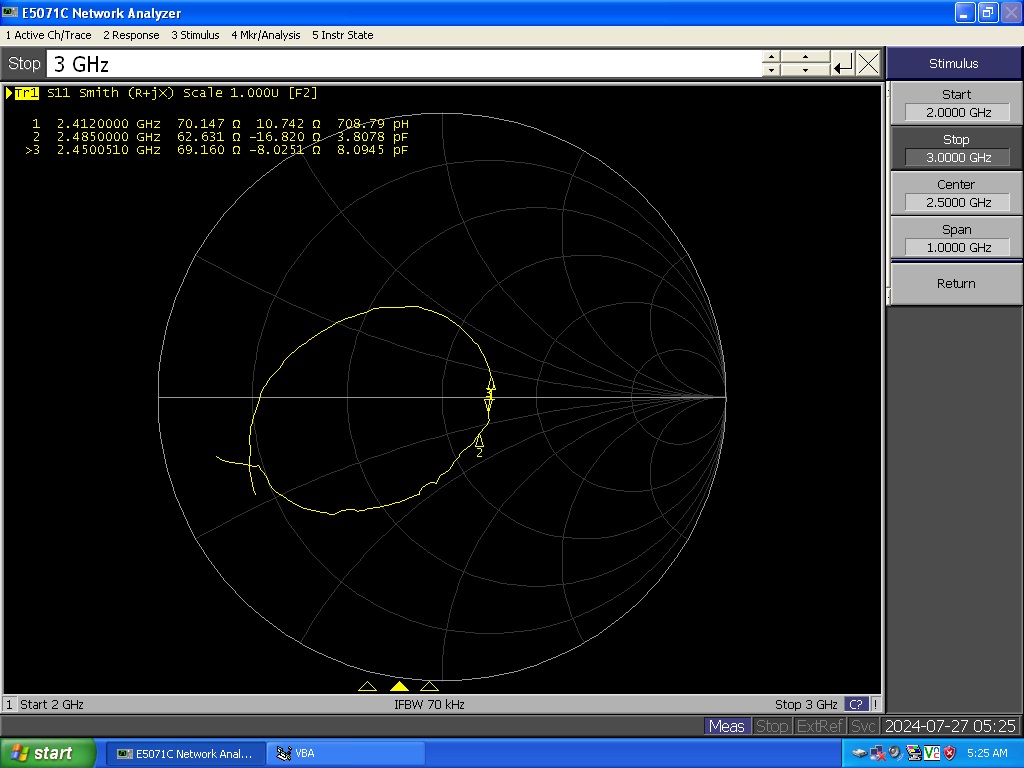

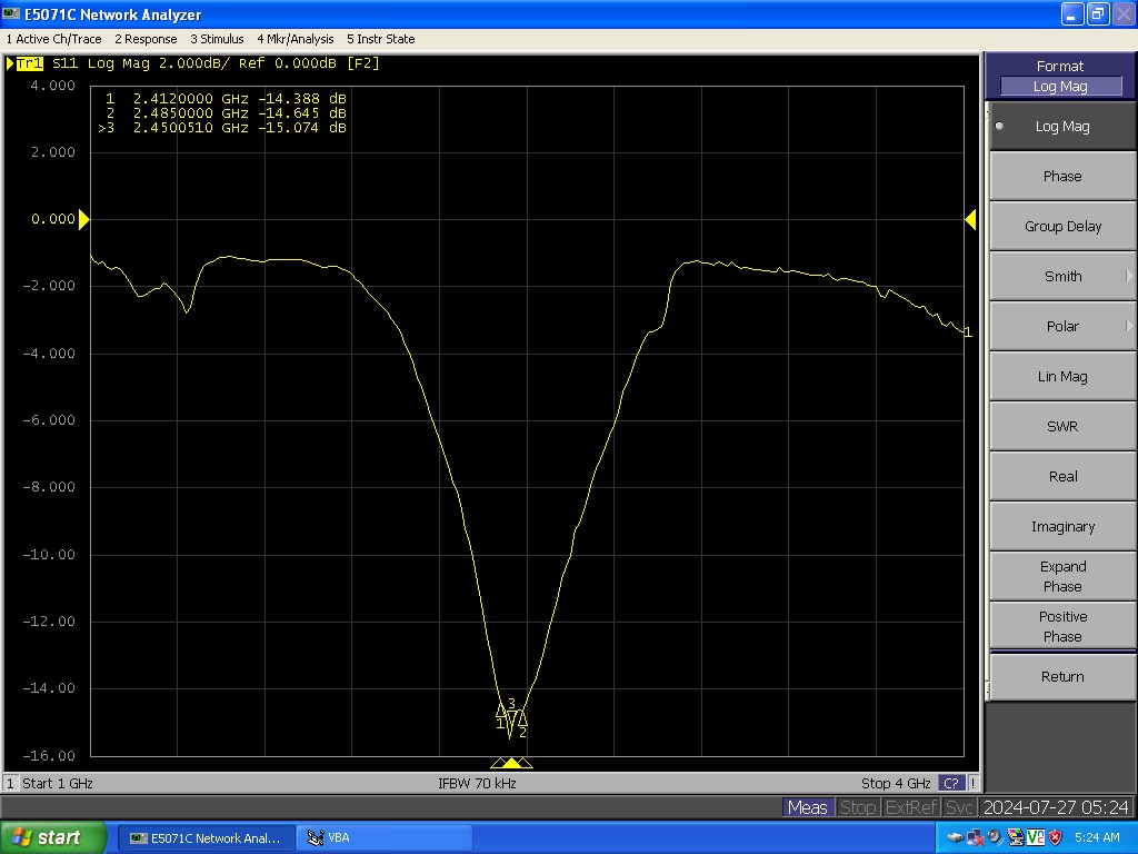

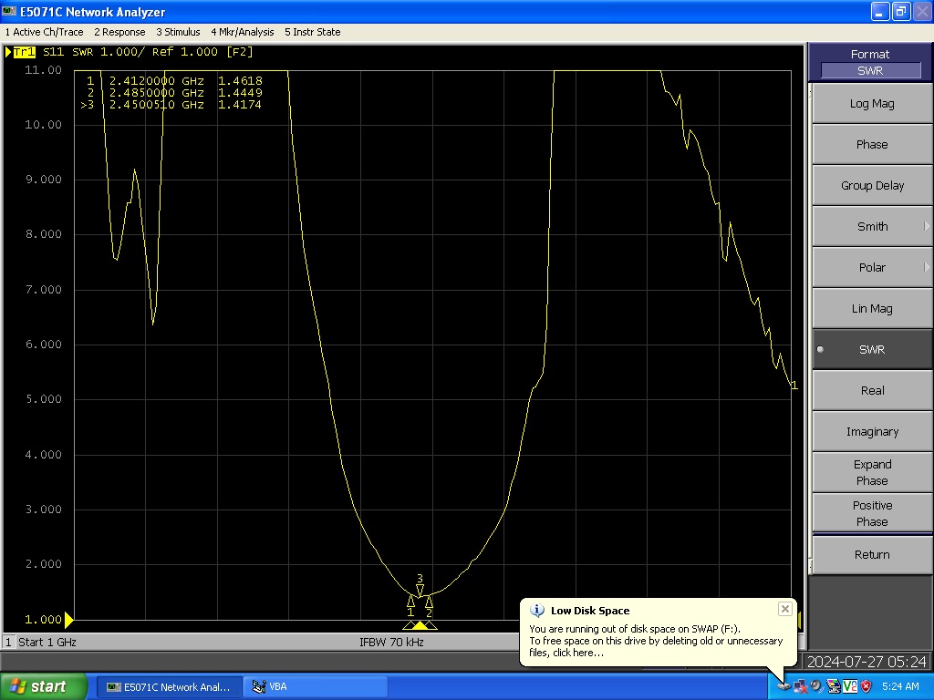

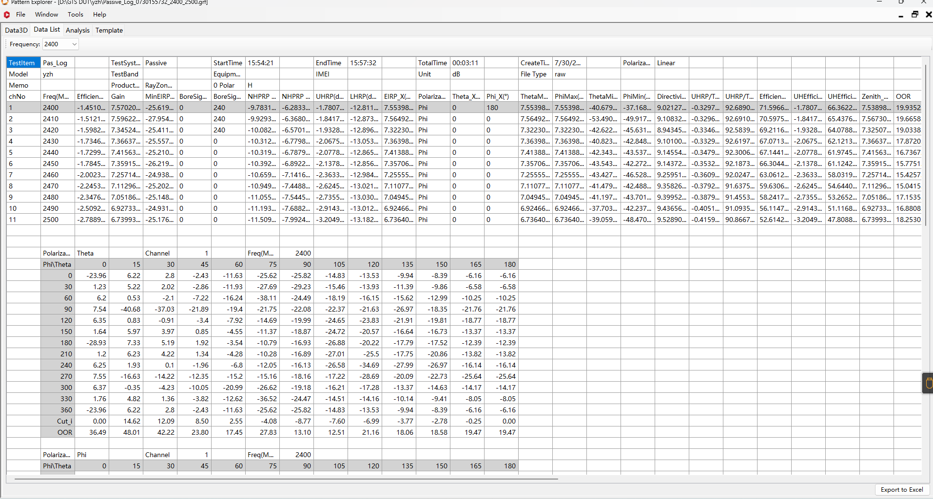

Using the Agilent E5071C network analyzer, the actual test results are as follows:
S11 parameters:
VSWR parameters:
Smith chart:
Did you think we stopped at network analysis?
NO!

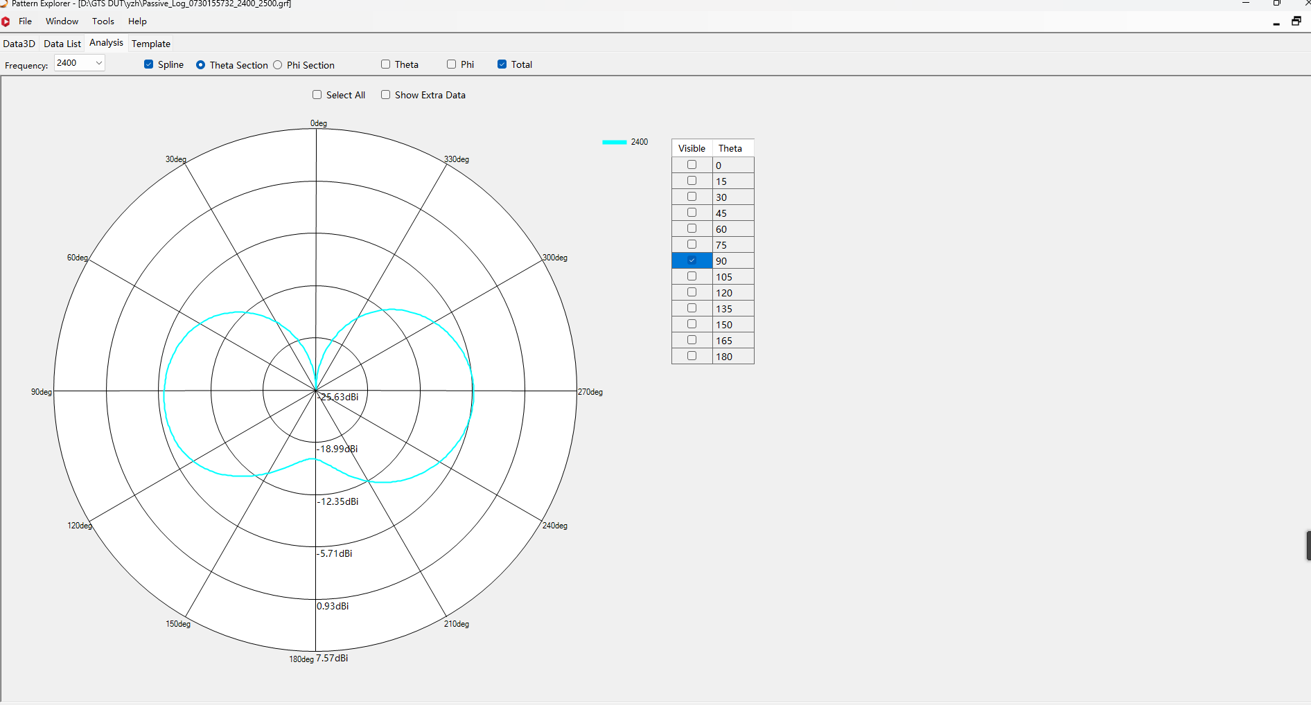

Next, please welcome our heavyweight guest – the microwave anechoic chamber.
Through anechoic chamber testing, we can conclude that:
1. The maximum gain point is at 2.41 GHz, with a gain of 7.59 dBi, better than the simulation results.
2. The in-band flatness between 2.41 GHz and 2.48 GHz is 0.54 dB, meeting expectations.
3. The antenna efficiency is 70% at 2.41 GHz and 58% at 2.48 GHz, lower than the simulation results.

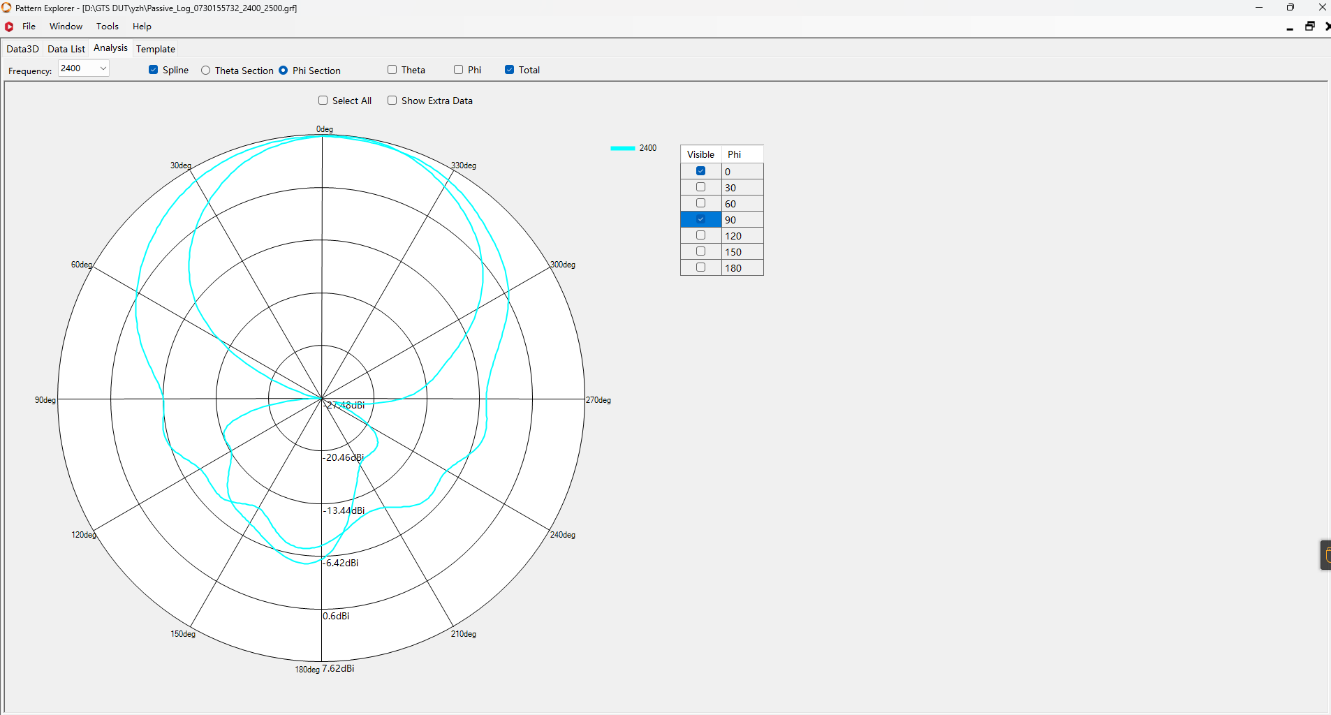

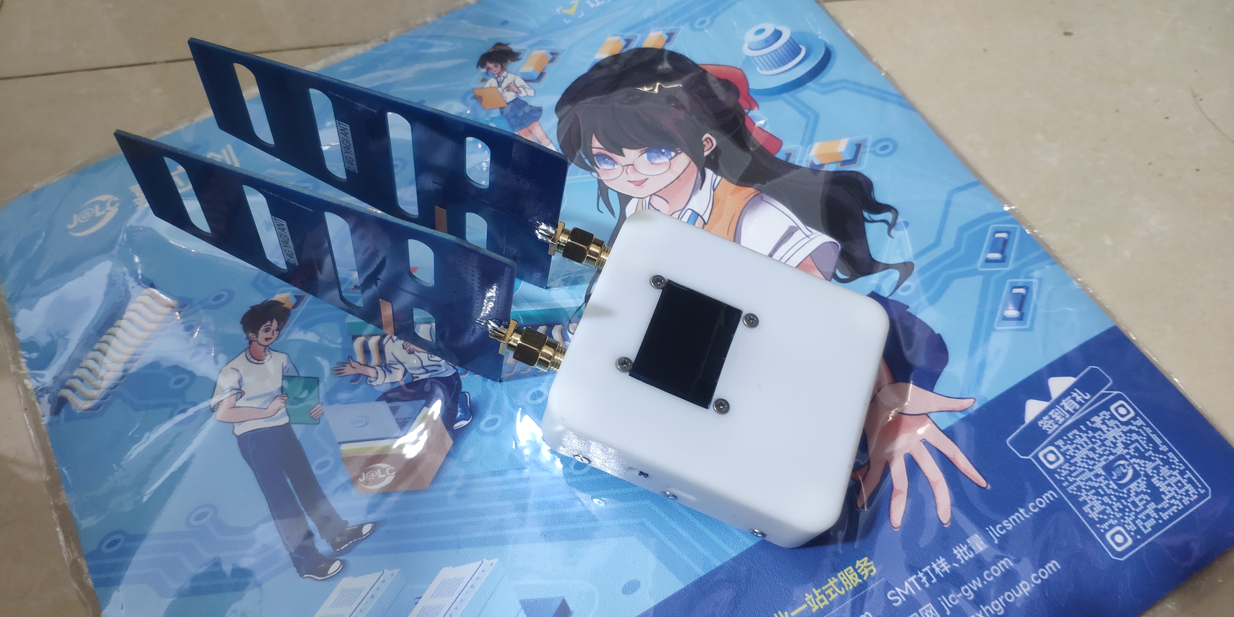

E-plane test results:
H-plane test results:
Three-dimensional gain direction test diagram:
