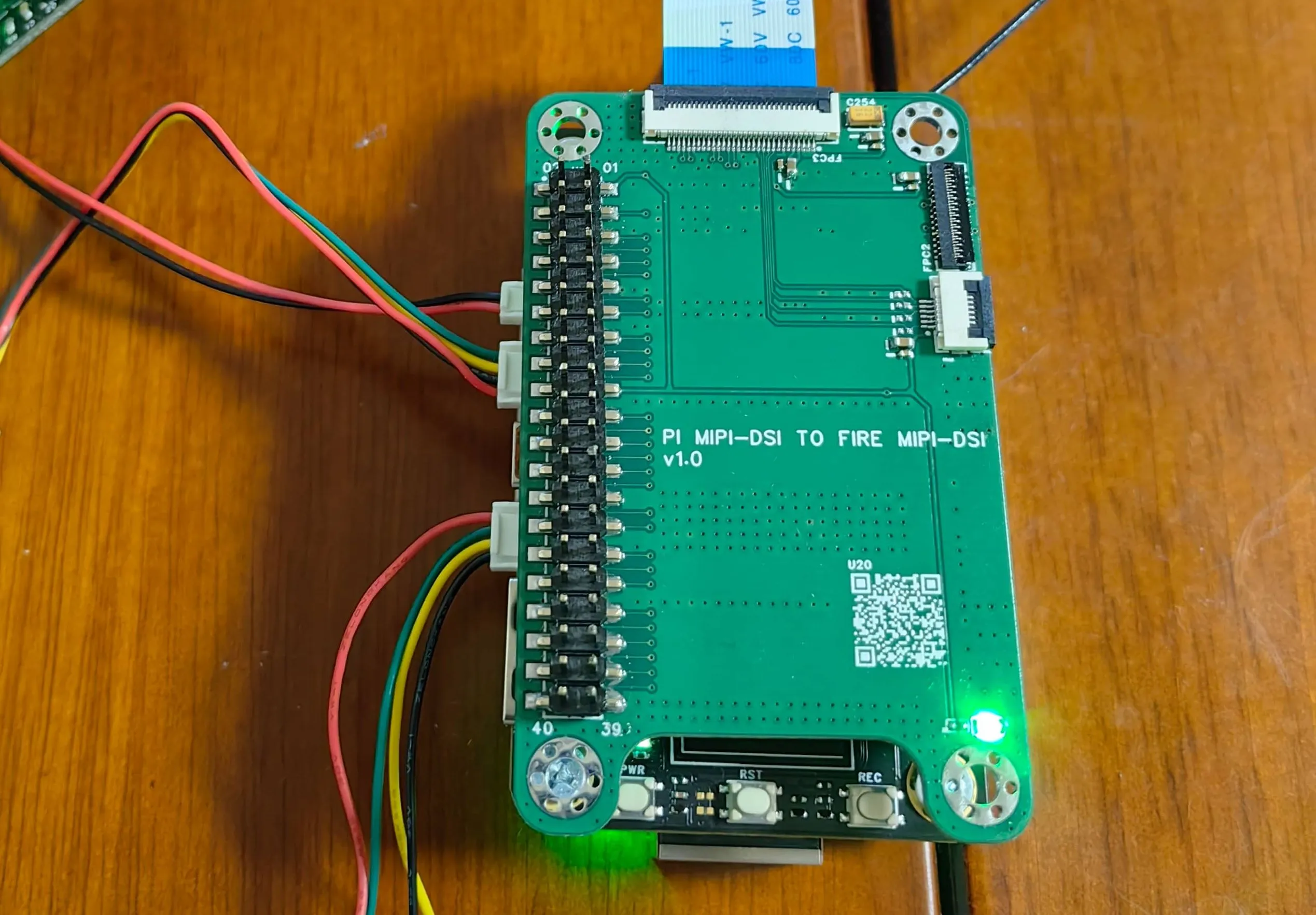

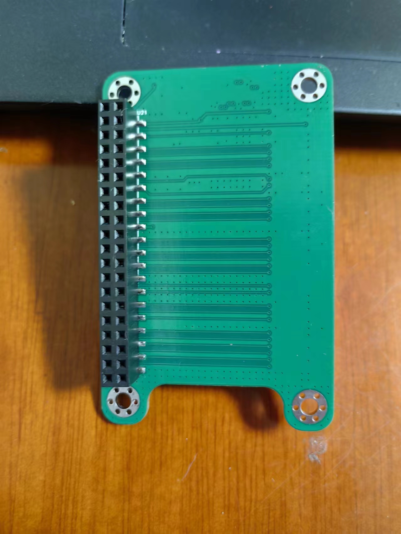

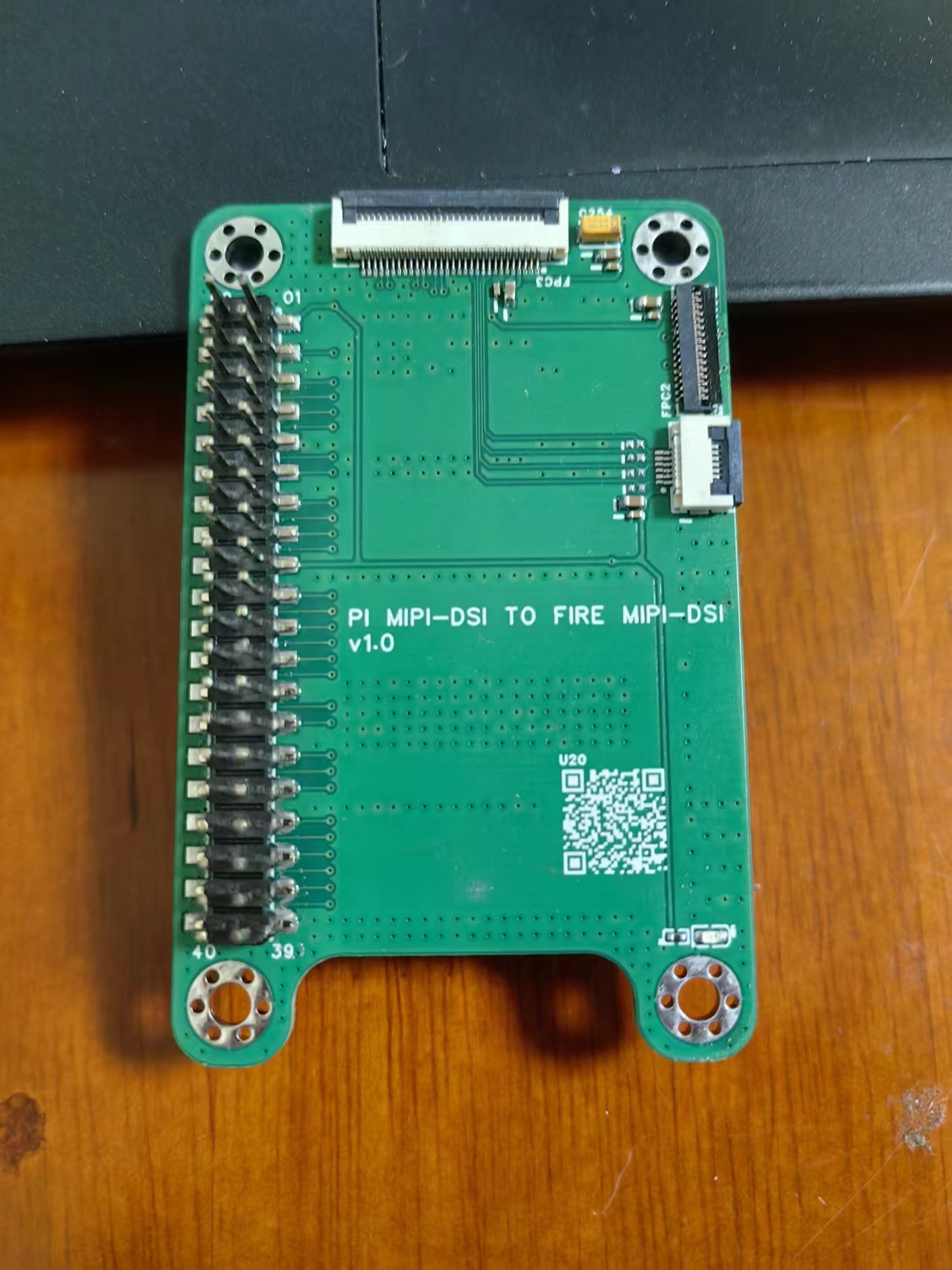

Taishan School MIPI-DSI to Wildfire Line Sequence
Notes on the actual product:
1. Impedance control: JLC04161H-7628, ±20%
2. Heating table 150-200℃, hot air gun 350℃, 183℃ medium-temperature soldering 3. Be careful not to solder
the bottom sockets crookedly, otherwise the screw holes may not align. Note: The ribbon cable has not yet arrived, so testing is not possible; verification is pending.
