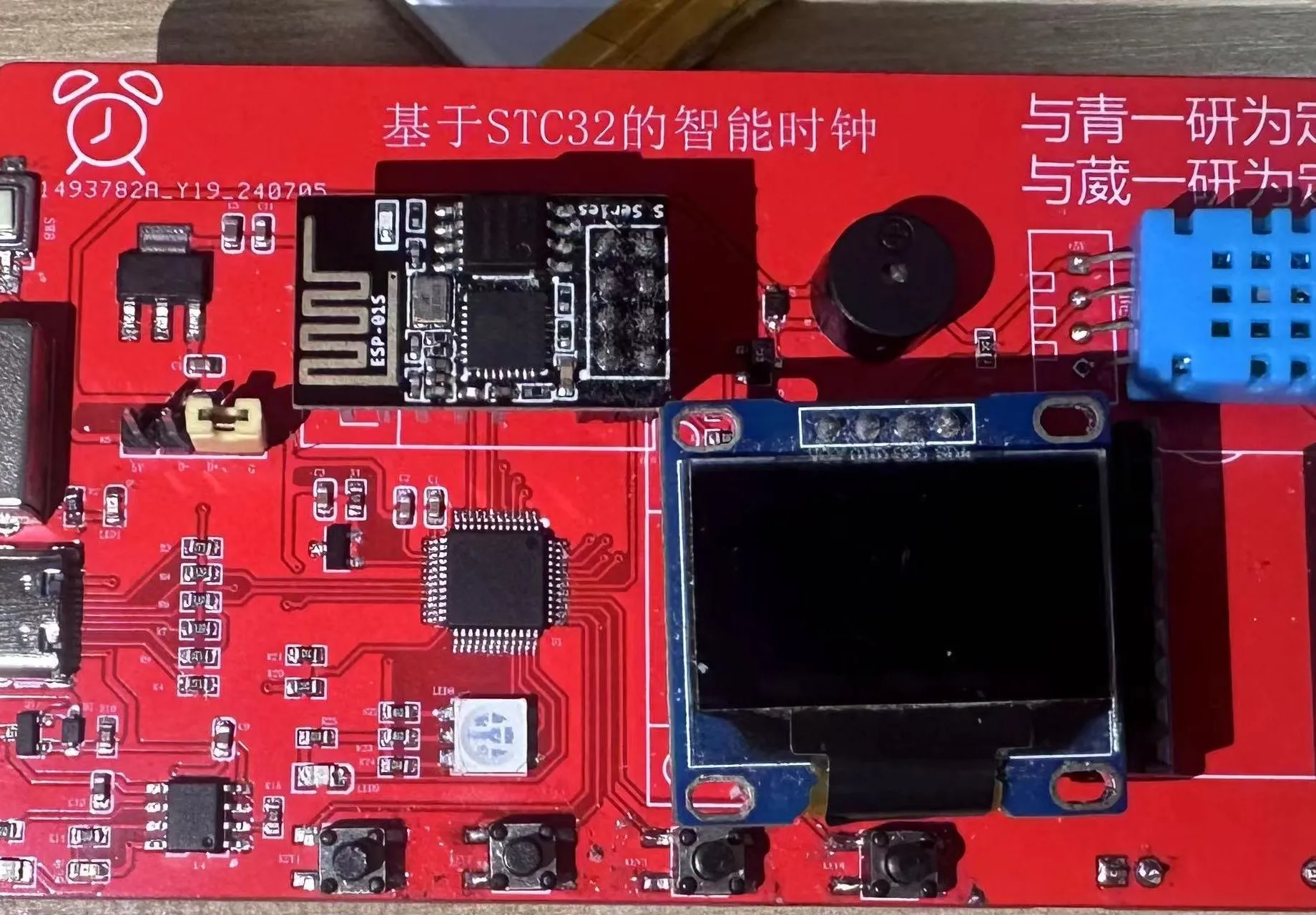

Smart Clock Based on STC32 Microcontroller
1. Schematic Design

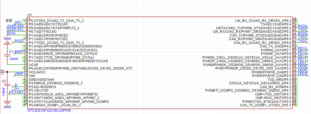

 (1) The main control circuit design
  uses STC32G12K128 as the main control chip. The working voltage is 1.9V~5.5V. It has a high-speed 32-bit 8051 core, which is more than 70 times faster than the traditional 8051. It also has 49 interrupt sources, 4 interrupt priority levels, 5 16-bit timers, 4 high-speed serial ports, 2 sets of advanced PWM functions, etc. It also supports direct USB programming without the need for a programmer, which can provide great convenience.

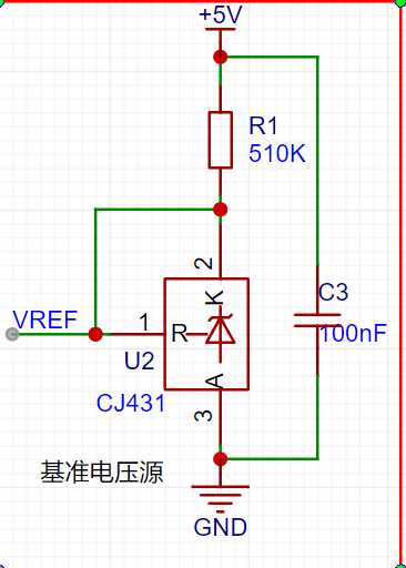

According to the chip's datasheet, a filter capacitor needs to be added at VCC. A capacitor also needs to be connected to the UCAP pin. The Vref pin must not be left floating. It is the pin of the external reference power supply of the ADC. It must be connected to either VCC or an external reference power supply. In this project, it is connected to an external reference power supply, as shown in the figure below. A 2.5V reference power supply is provided by CJ431.

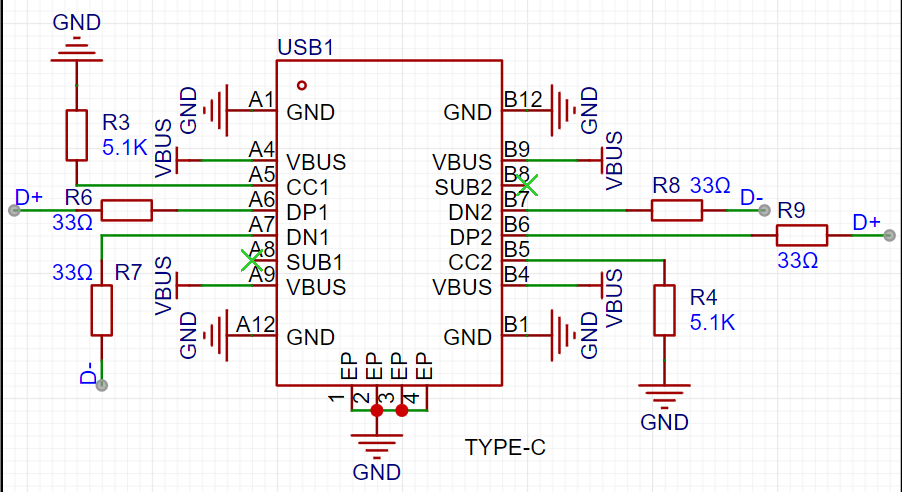

(2) Power supply circuit design:
  In this project, TYPE-C is used for voltage power supply and USB download can be performed directly as shown in the figure below. Note that a TYPE-C with data transmission capability must be used, otherwise the download will not be possible. CC1 and CC2 cannot be left floating.

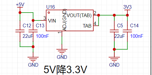

(3) Step-down circuit design:
  In this project, a 3.3V power supply is required, so we need a step-down circuit as shown in the figure below. An LDO is used for step-down. Capacitors are required at the input and output, as stated in the datasheet.

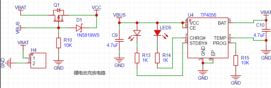

(4) Power switching circuit and lithium battery charging circuit design:
  In this project, TYPE-C or lithium battery can be used for power supply. The figure below shows a classic power switching circuit. When TYPE-C is used for power supply, the MOSFET will be cut off, and TYPE-C will supply power and charge the battery. When no external power supply is connected, the MOSFET will be turned on and the battery will supply power.

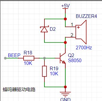

(5) Buzzer drive circuit:
  In this project, a buzzer is used as the sound source for the alarm clock. A passive buzzer is used, and a transistor is used to amplify the current to drive the buzzer.

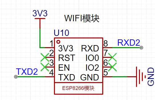

(6) The WIFI module design
  uses the ESP8266 module to connect to the serial port 2 of the STC32 microcontroller to obtain network time and weather.

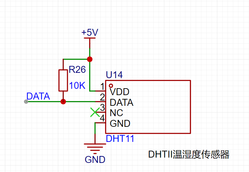

(7) The temperature and humidity sensor circuit design
  uses the DHT11 temperature and humidity sensor to read temperature and humidity. Because it uses single bus timing, the data line needs to be pulled high when idle, so a pull-up resistor is used in the circuit.

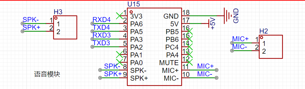

(8) The voice recognition module circuit design
  uses the Tianwen ASR-PRO module to recognize and broadcast voice.
(9) The OLED circuit design
  uses an OLED screen to display the interface.

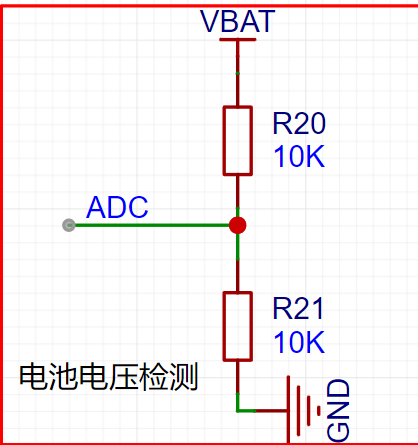

(10) The battery voltage detection circuit design
  uses the ADC reference voltage of 2.5V in this project. The external power supply and battery power supply are both greater than 2.5V, so two 10K resistors are used to divide the voltage to half of the original voltage. Then, the measured data is doubled in the code to obtain the measured voltage.

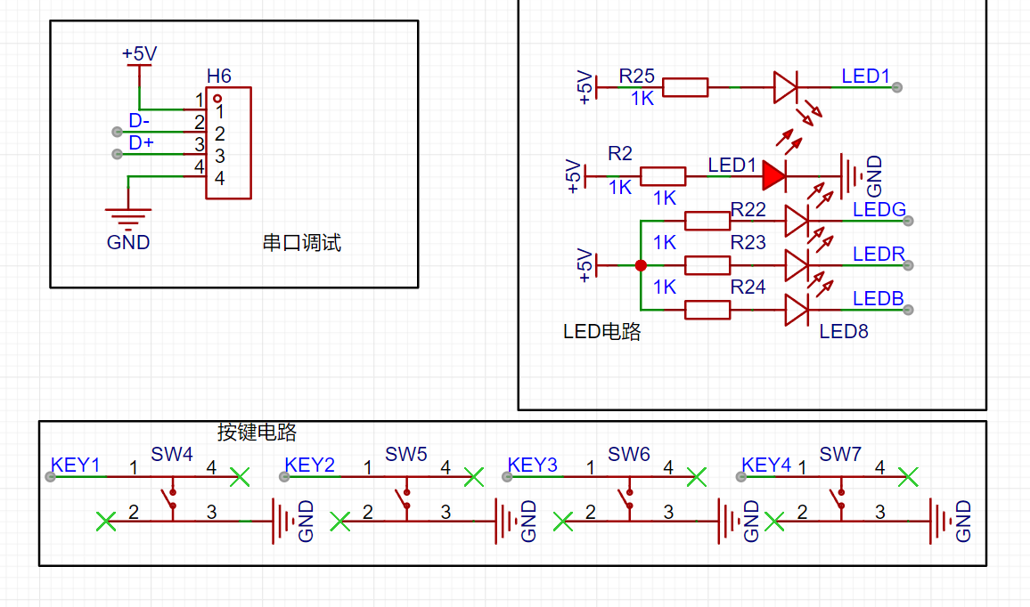

The following circuits are the debugging circuit, button circuit, and LED circuit. RGB lights are used to display multiple colors, which will look better.

The video demonstrates setting the network time and alarm clock, as well as temperature and humidity detection.
