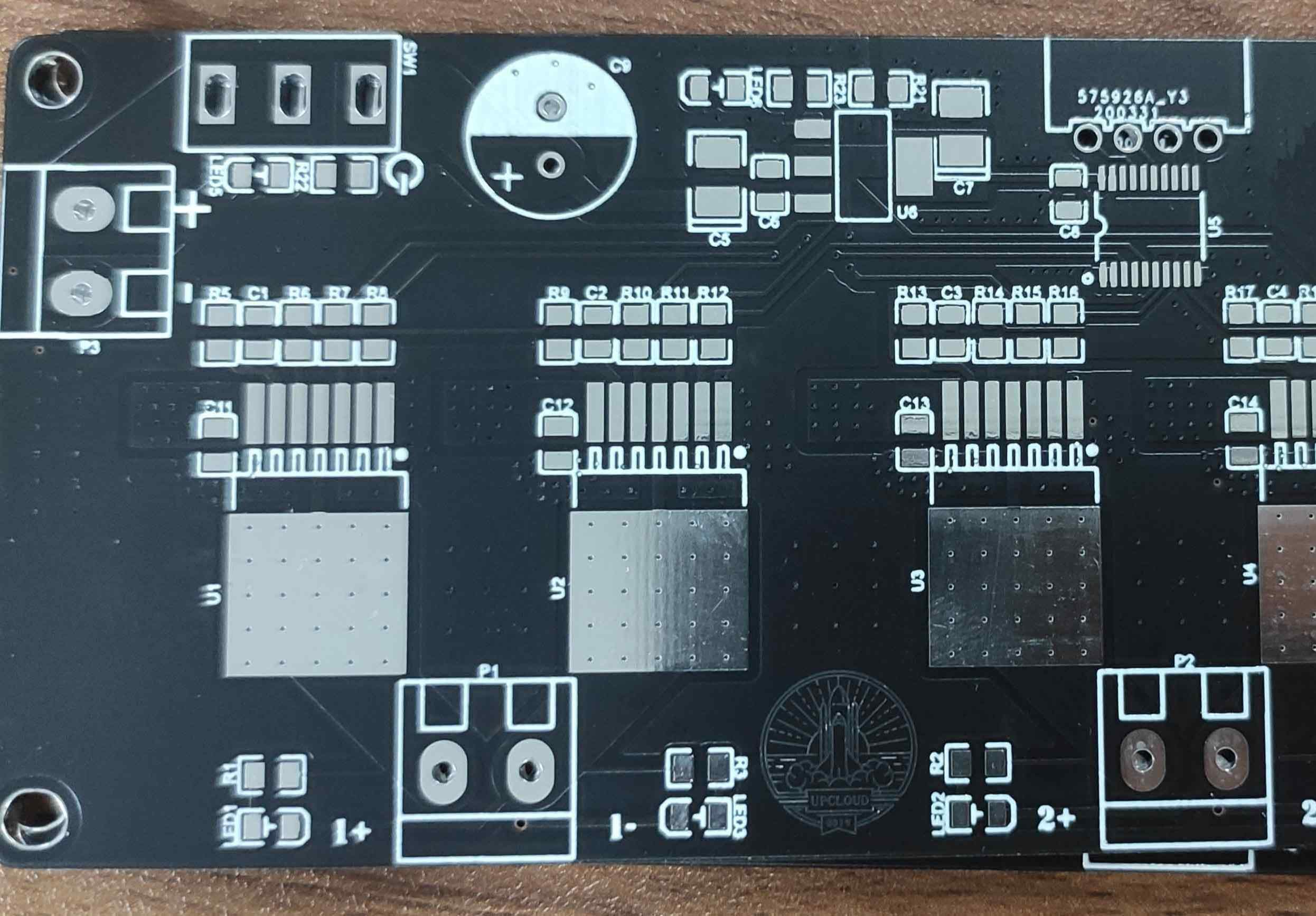

BTN8982 dual high current motor driver
This project uses 4 integrated half-bridge driver chips BTN8982 from Infineon, which is sufficient to meet various DC motor drive needs.
Features:
  • Threshold drive current 72A
  • Supports driving voltage up to 40V
  • 4-way PWM driver
  • The enable pin is lead out and can be manually jumpered
    10.09 update
  • Remove the enable jumper and all chips are enabled by default.
  • Change PCB layout and routing to make it more suitable for high current applications
