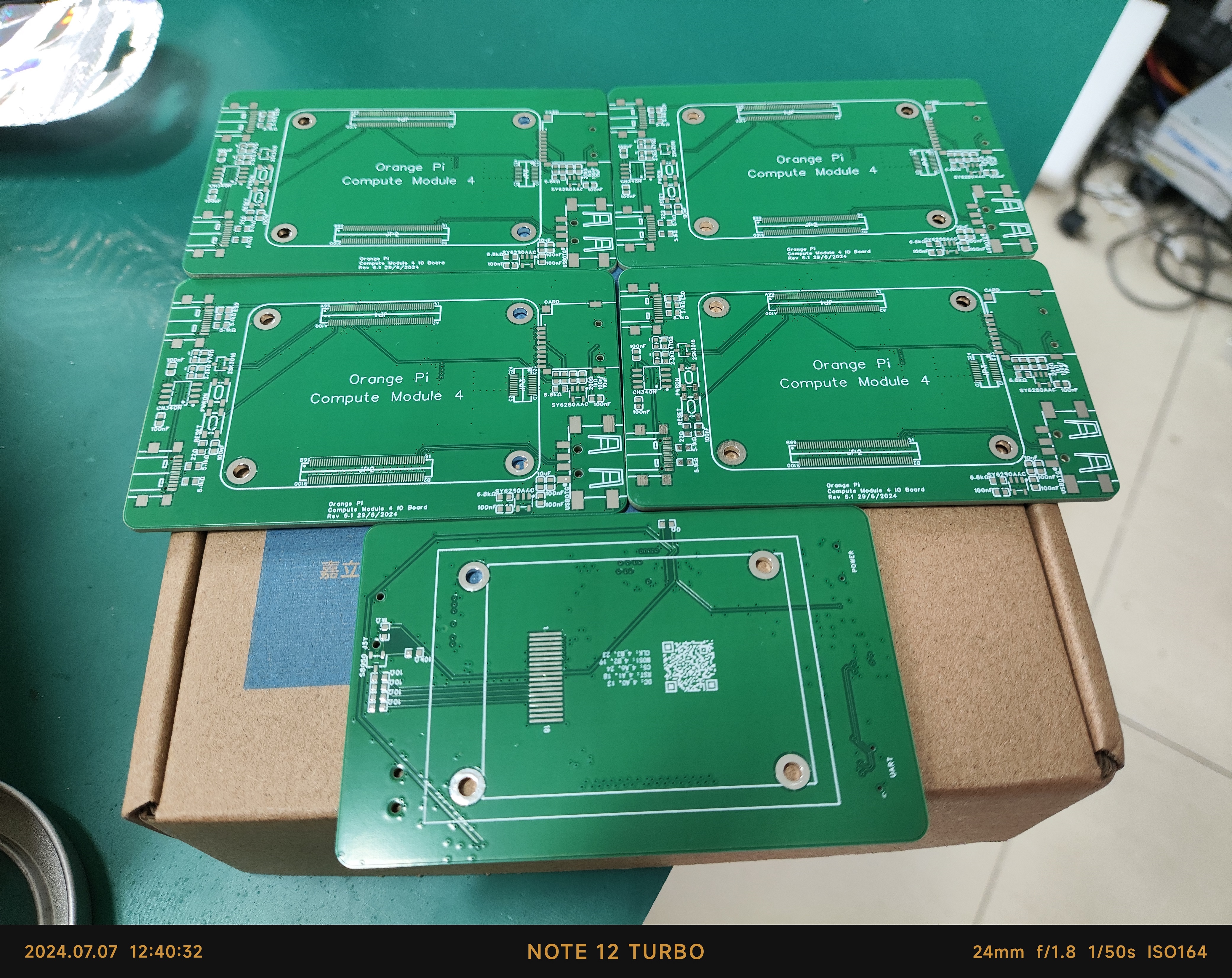

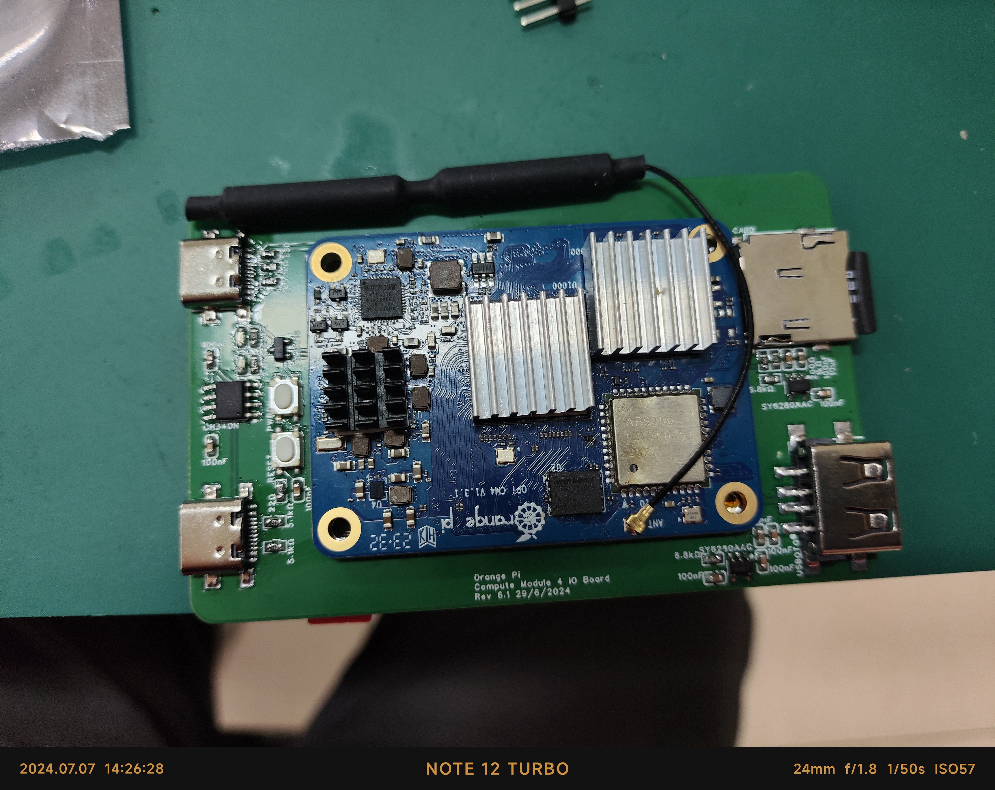

Linux Card based on Orange Pie CM4

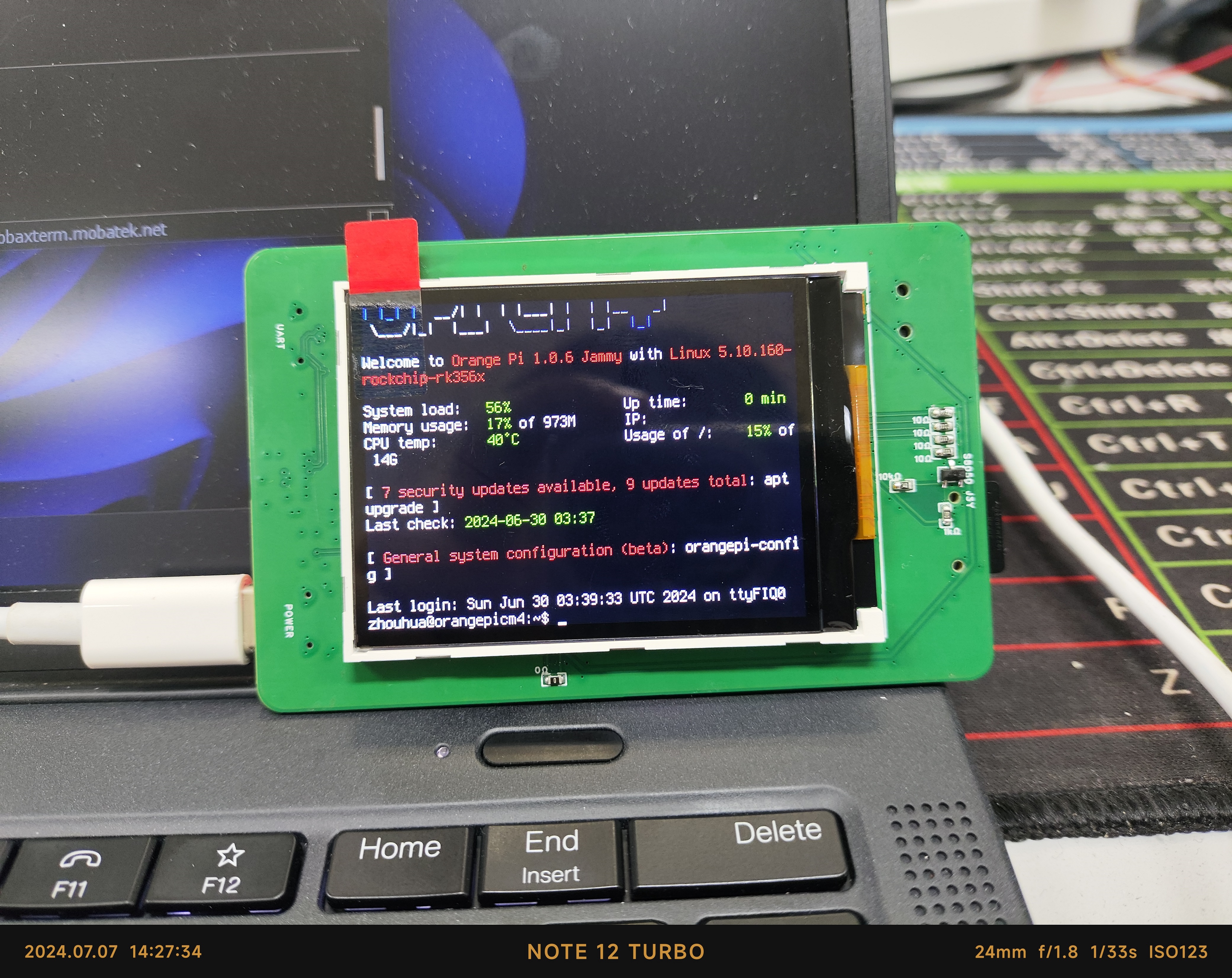

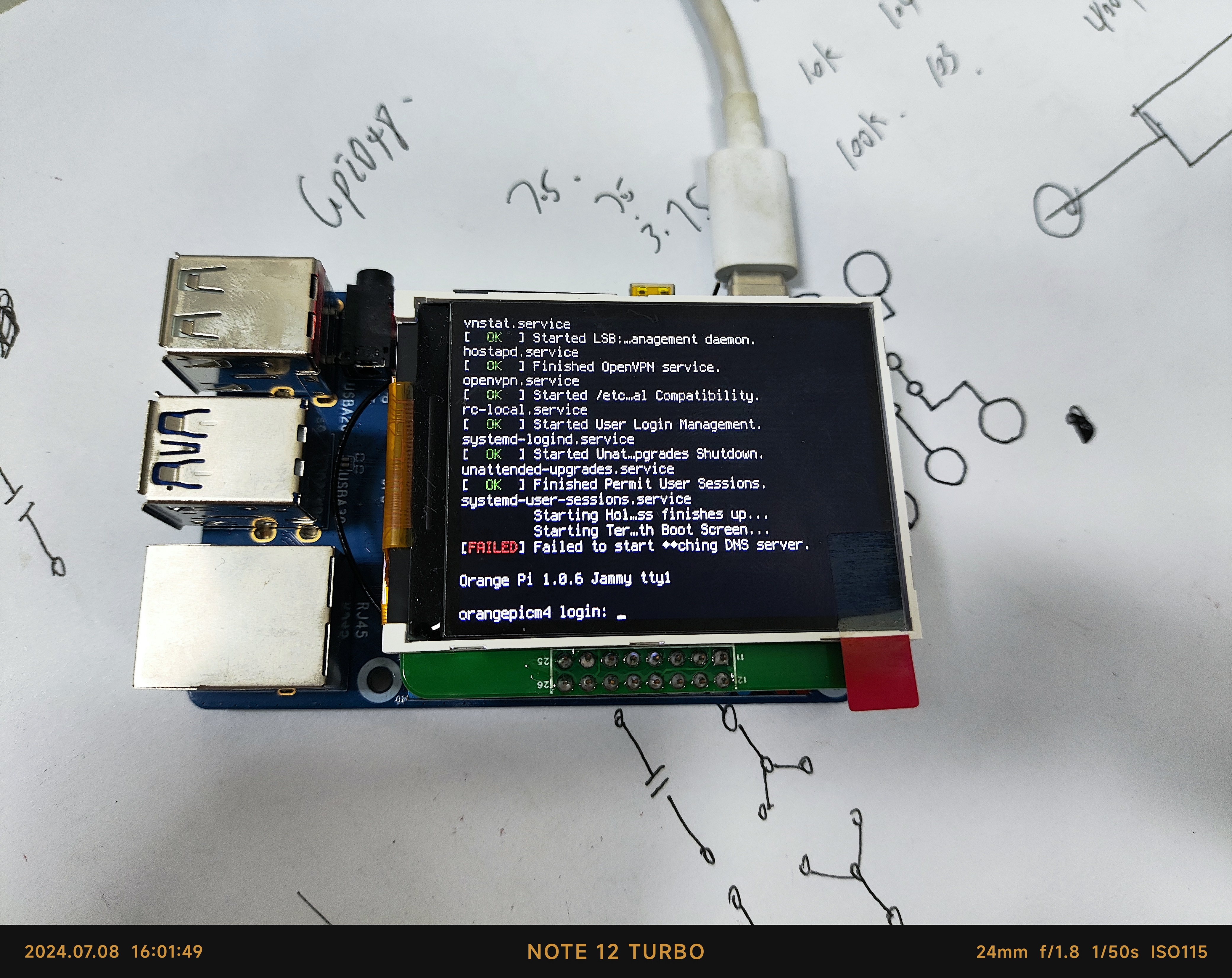

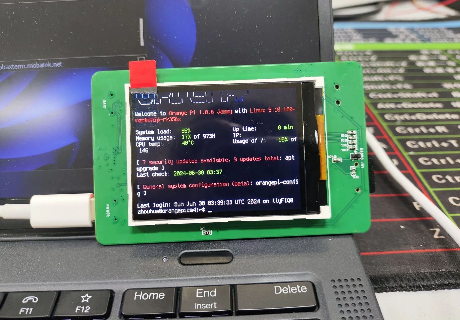

The board is a credit card-sized Orange Pie CM4 baseboard with an onboard CH340N serial port, USB OTG, TF card slot, and a 2.4-inch 240*320 TFT screen. The driver chip is ILI9341, and it uses TinyDrm driver.
![IMG_20240707_124032.jpg] ![IMG_20240707_142628.jpg] ![IMG_20240707_142734.jpg] The screen uses an 18P soldering model:
![Screenshot_2024-07-07-15-20-05-931_com.taobao.taobao-edit.jpg] How to drive it:

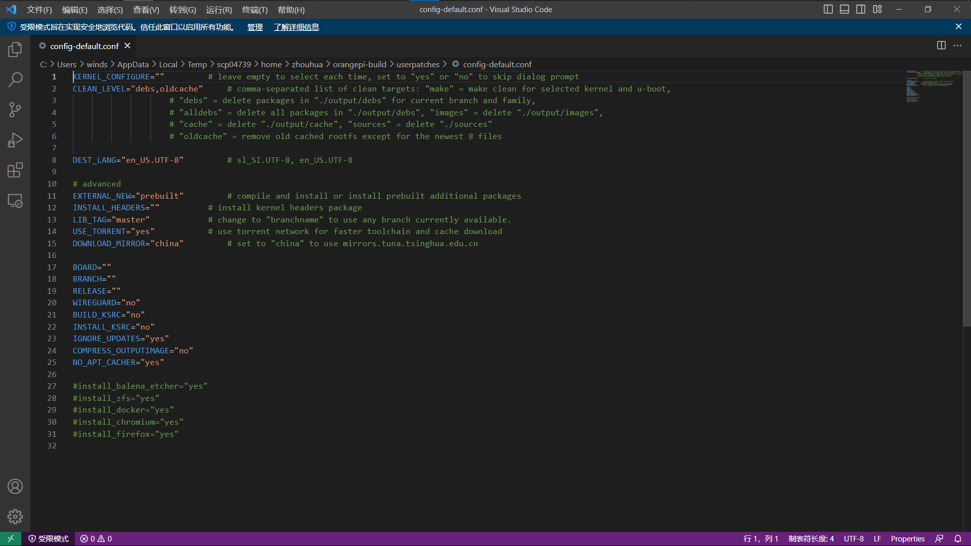

First, modify config-default.conf under orangepi-build/userpatches, changing IGNORE_UPDATES="" to IGNORE_UPDATES="yes"

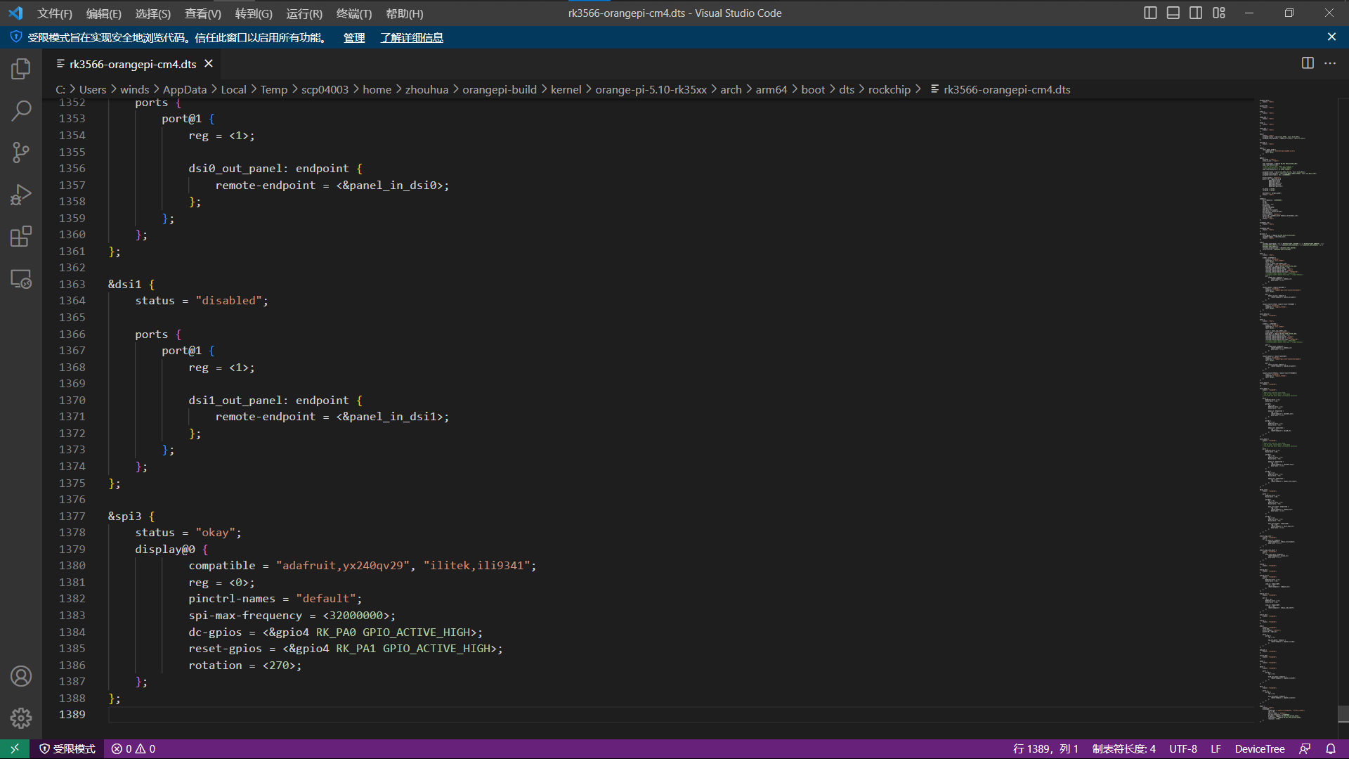

![jzgx.png] Then modify the file orangepi-build/kernel/orange-pi-5.10-rk35xx/arch/arm64/boot/dts/rockchip/rk3566-orangepi-cm4.dts, adding
`&spi3` to the end. {
status = "okay";
display@0 {
compatible = "adafruit,yx240qv29", "ilitek,ili9341";
reg = ;
pinctrl-names = "default";
spi-max-frequency = ;
dc-gpios = ;
reset-gpios = ;
rotation = ;

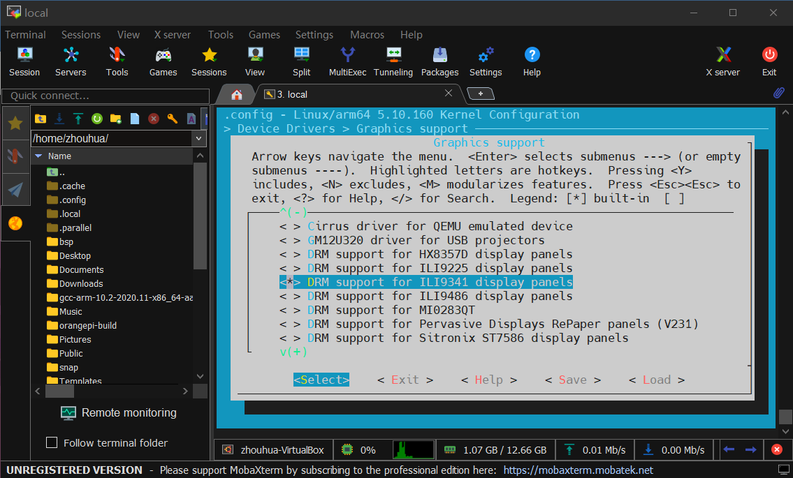

![sbs.png] When compiling the kernel, check "DRM support for ILI9341 display panels" under Device Drivers > Graphics support
![qyqd.png] Then update the kernel according to the manual and it will be usable.

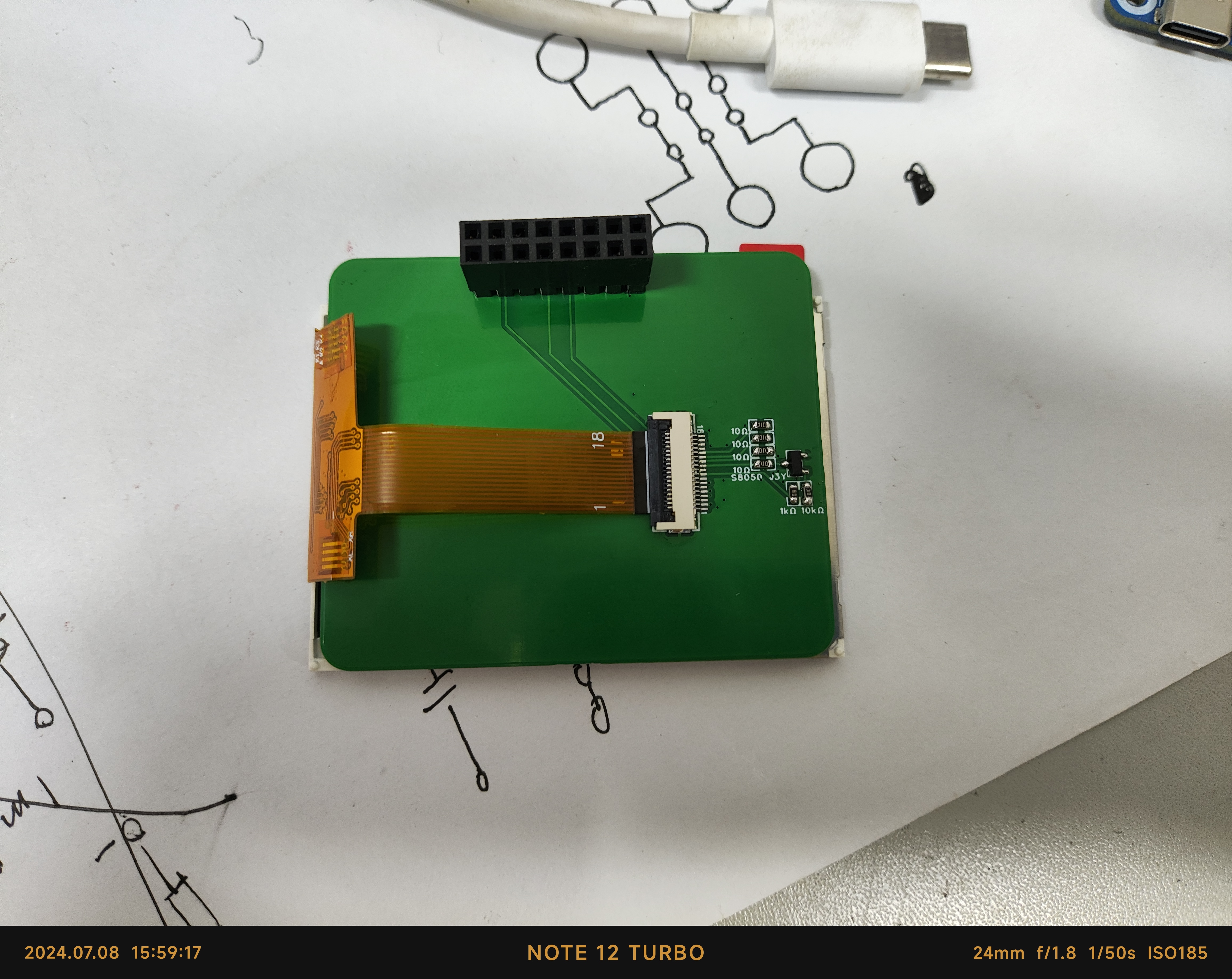

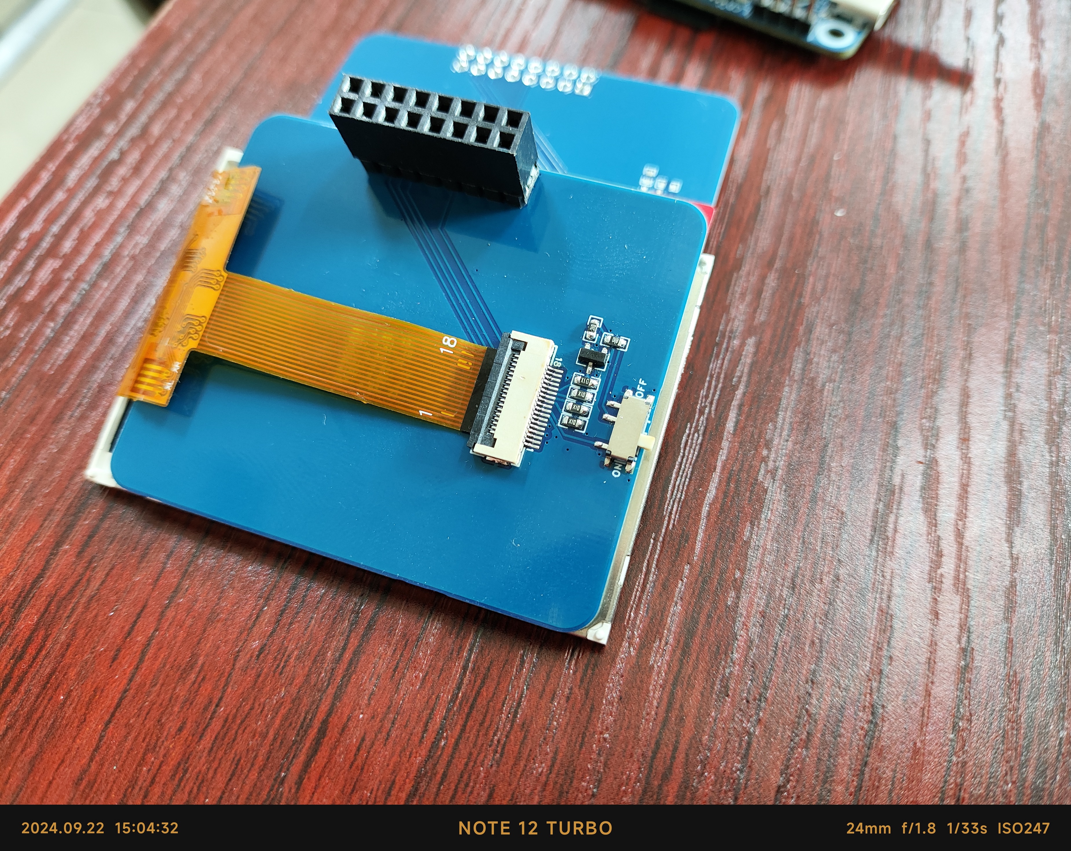

7.20 Update: A separate LCD module has been added, which can be directly plugged into GPIO

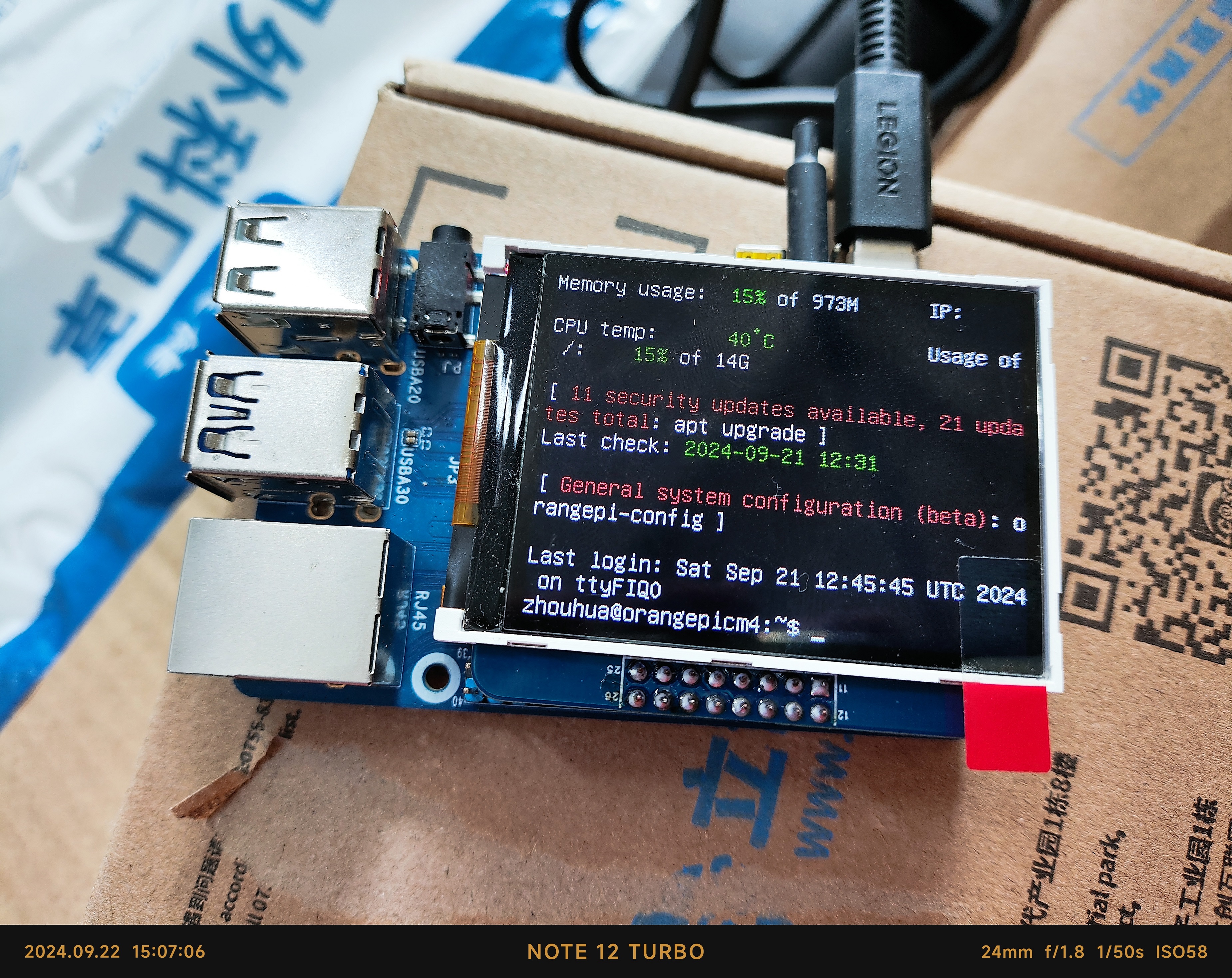

![IMG_20240708_155917.jpg] ![IMG_20240708_160149.jpg] Update 9.22: Added a backlight control switch for the separate LCD module
! ![IMG_20240922_150432.jpg] ![IMG_20240922_150706.jpg]
