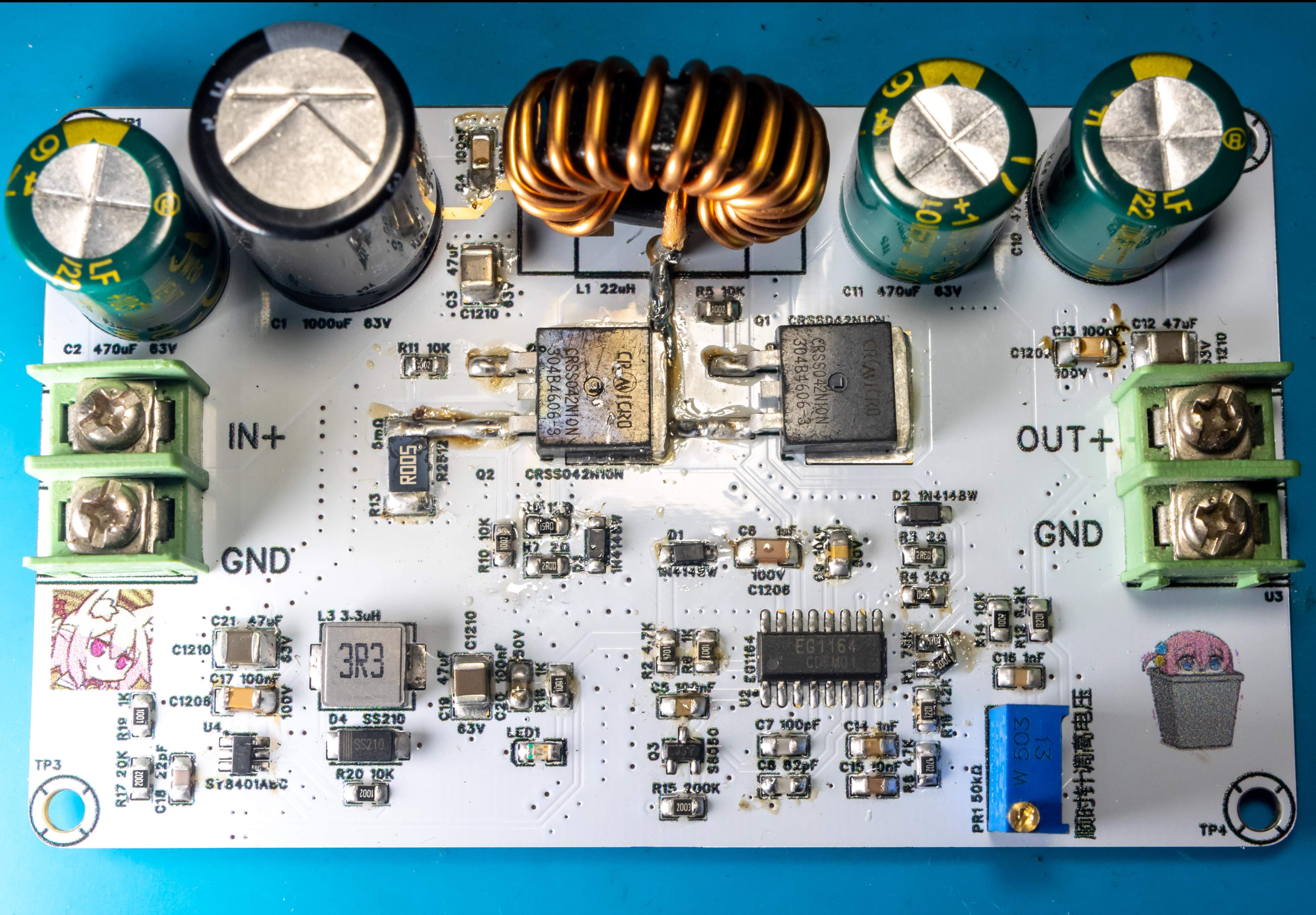

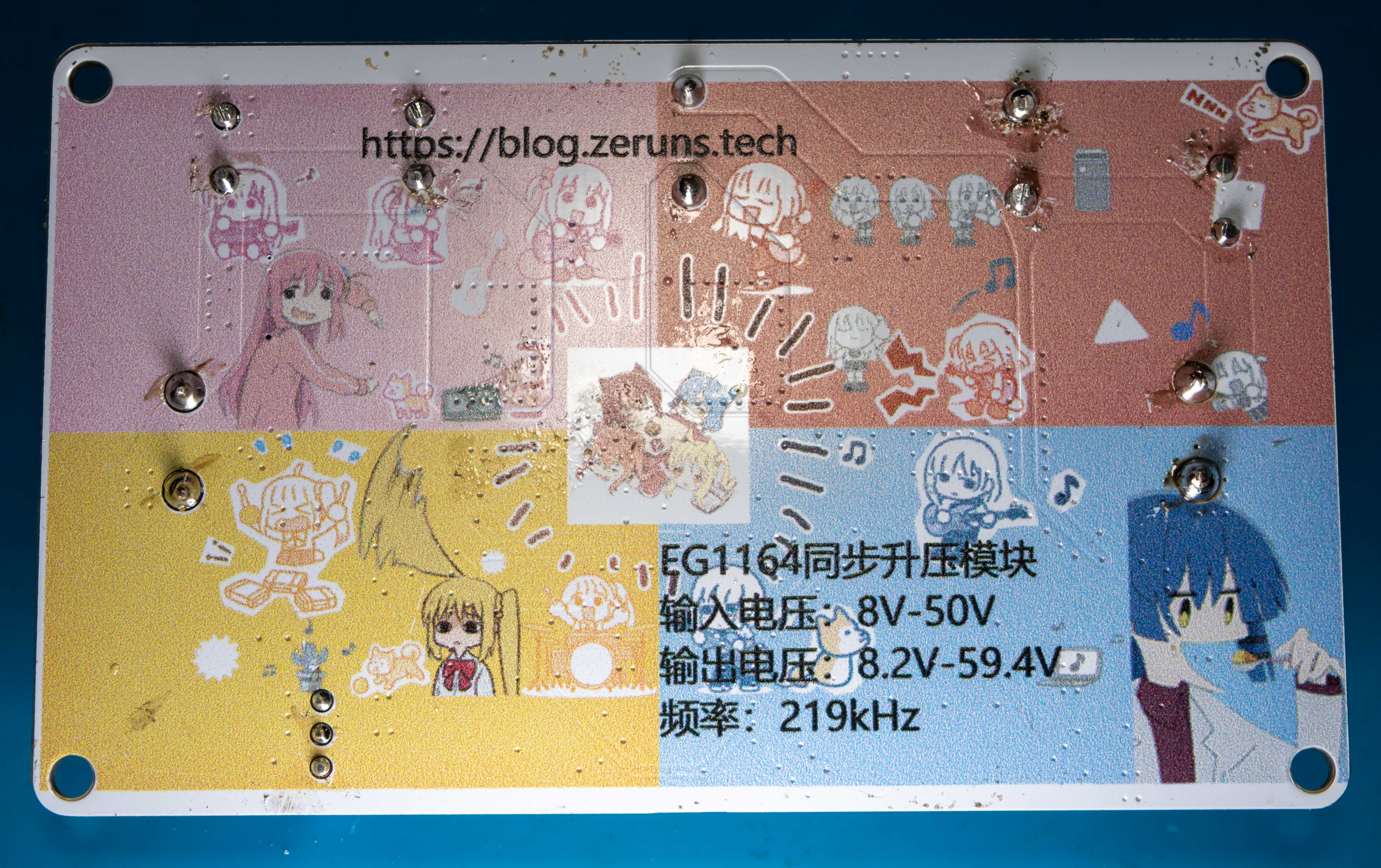

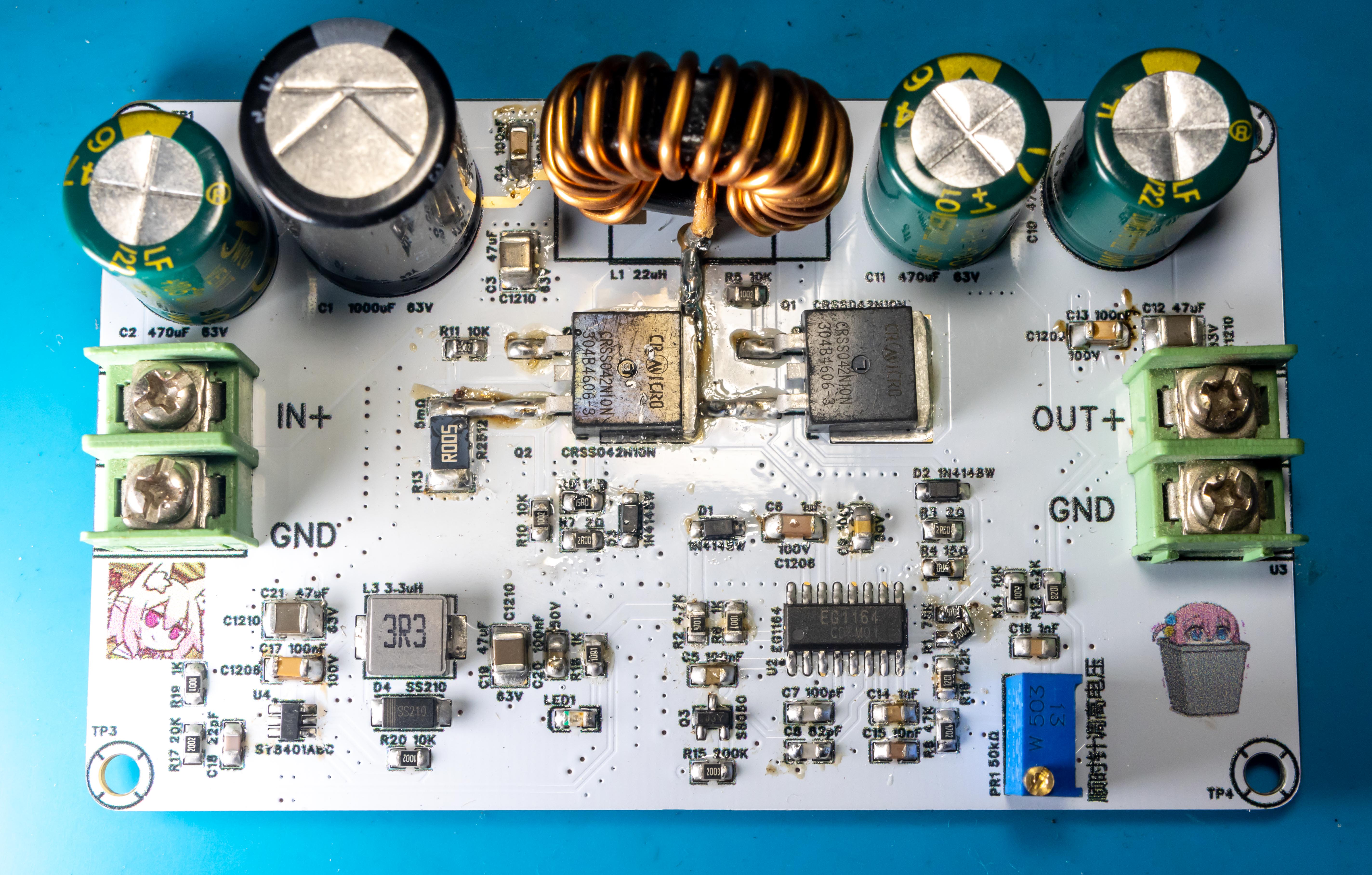

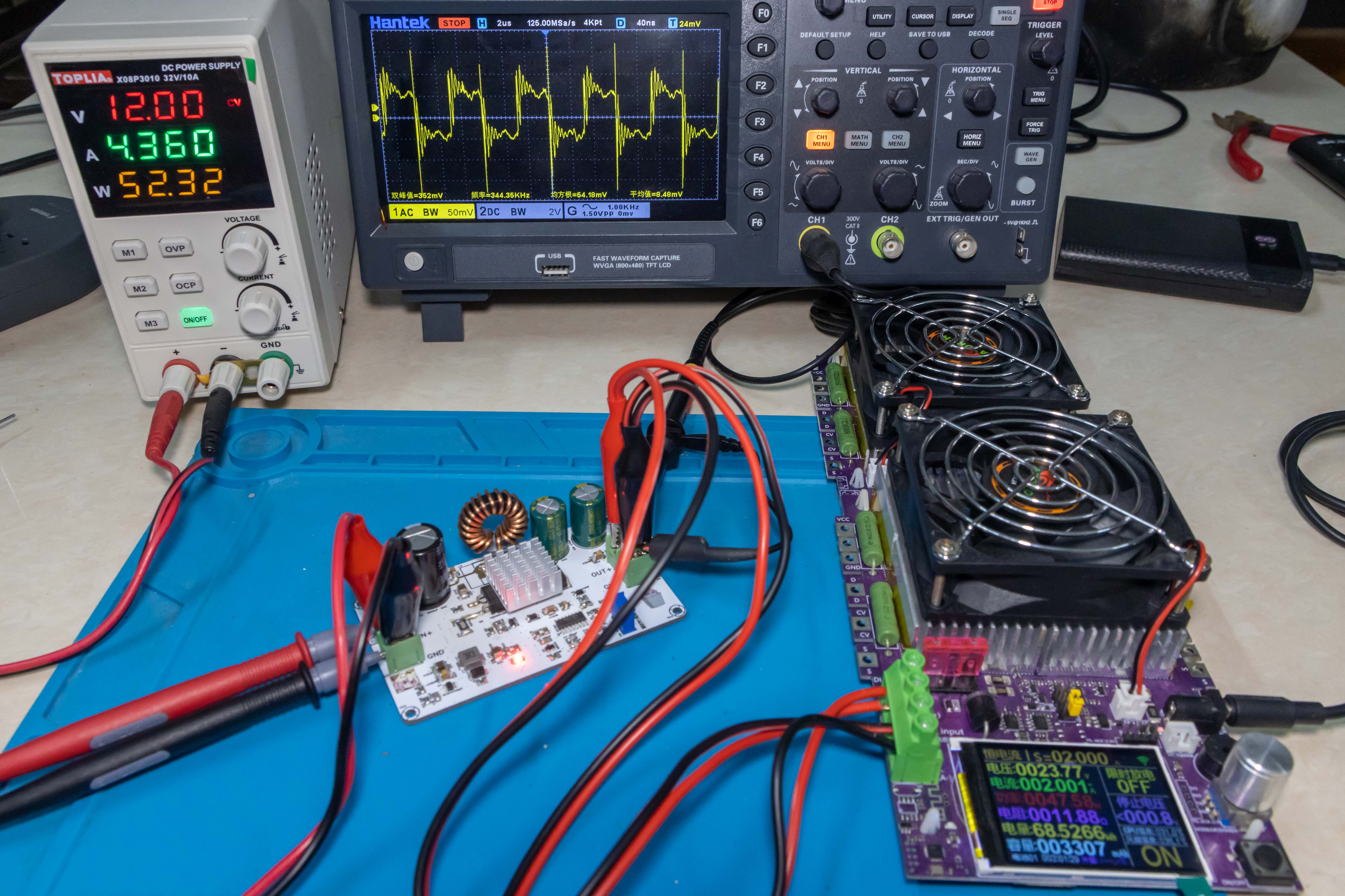

I got a free color silkscreen printing coupon from JLCPCB and quickly designed a board to try it out; this is my first time using color silkscreen printing.
Because my testing equipment is limited (both the power supply and load are maximum 300W), I can't test higher power outputs. This board should be able to handle 400-500W or more without problems.
I'm a beginner, so it might not be very well done. Experts, please leave any suggestions in the comments section so we can all learn from each other.

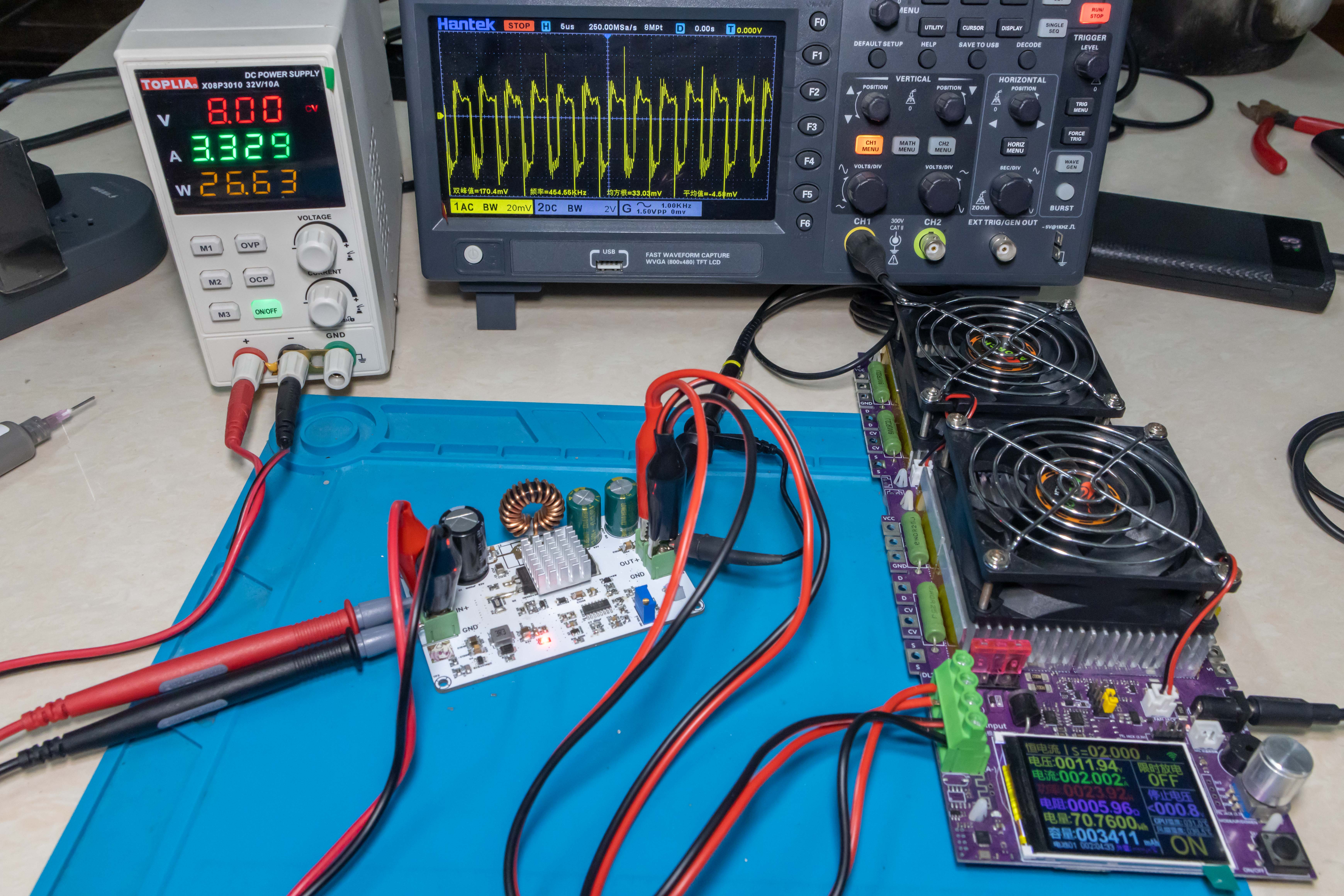

Test Data
and Equipment:
Tuolia Adjustable Power Supply X08P3010: https://blog.zeruns.tech/archives/698.html
Hantai DSO2D15 Desktop Oscilloscope: https://blog.zeruns.tech/archives/652.html
Juwei Electronics Load: https://s.click.taobao.com/TPZCHAu
VC86E Multimeter: https://s.click.taobao.com/9P9CHAu

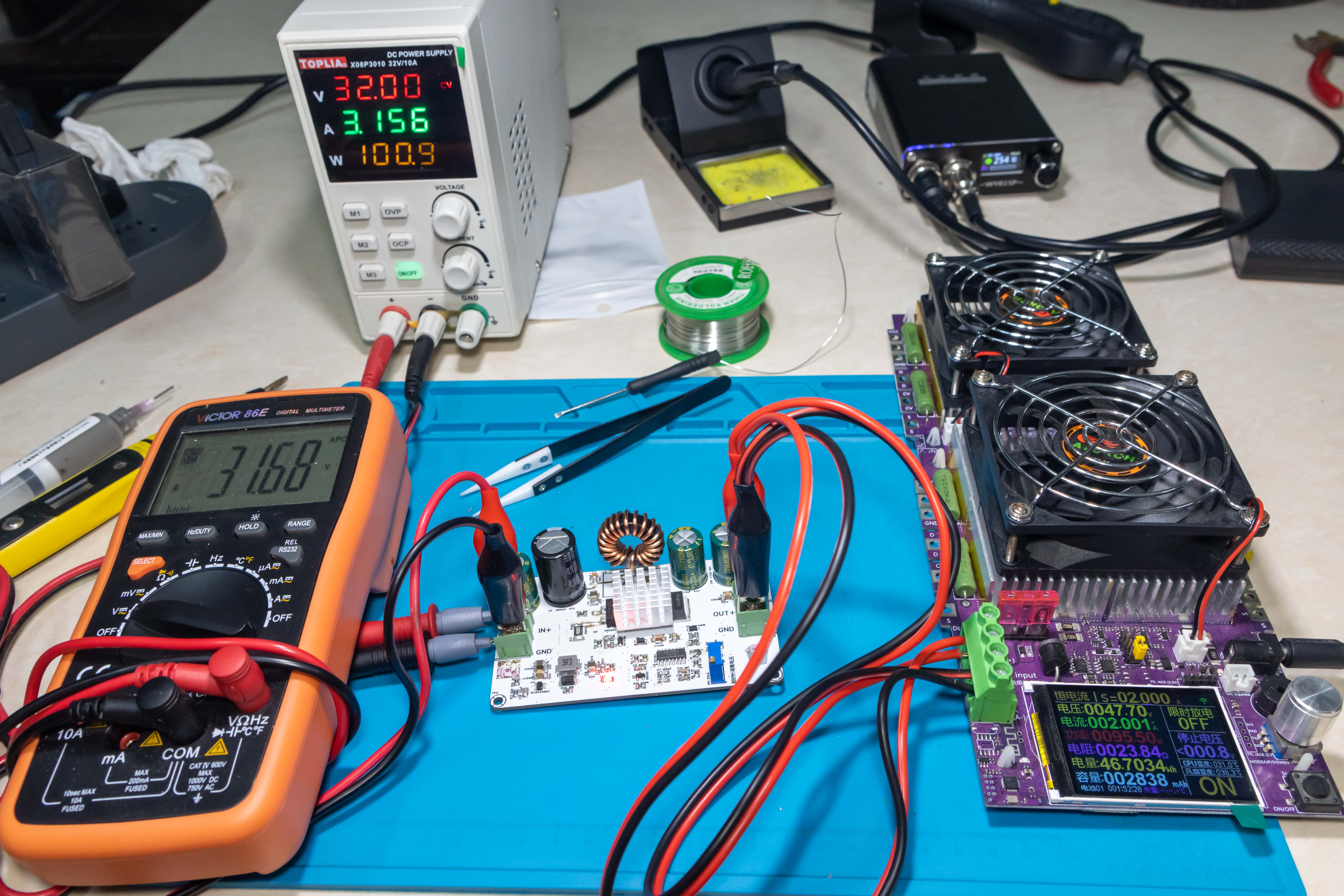

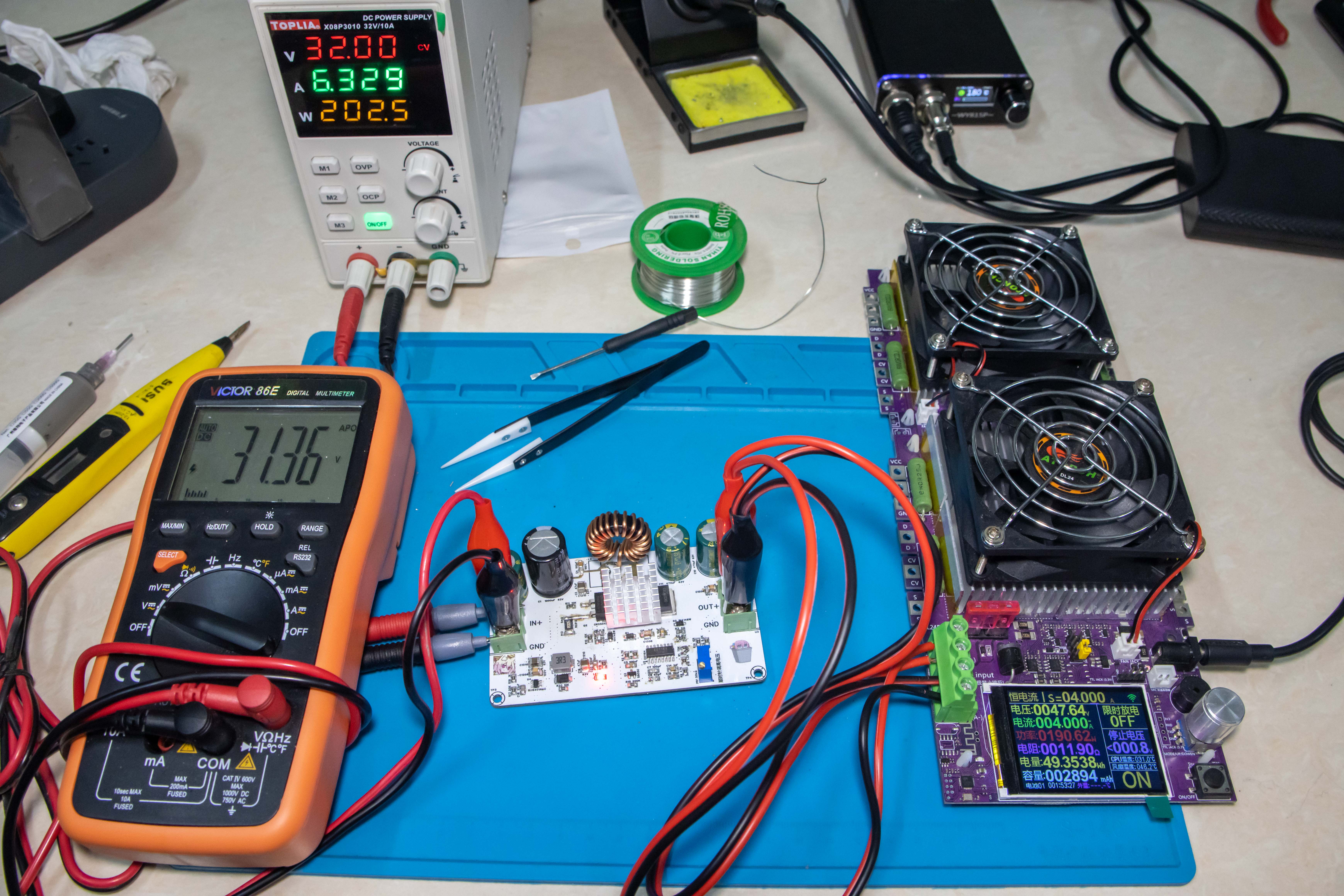

Output Load Test:

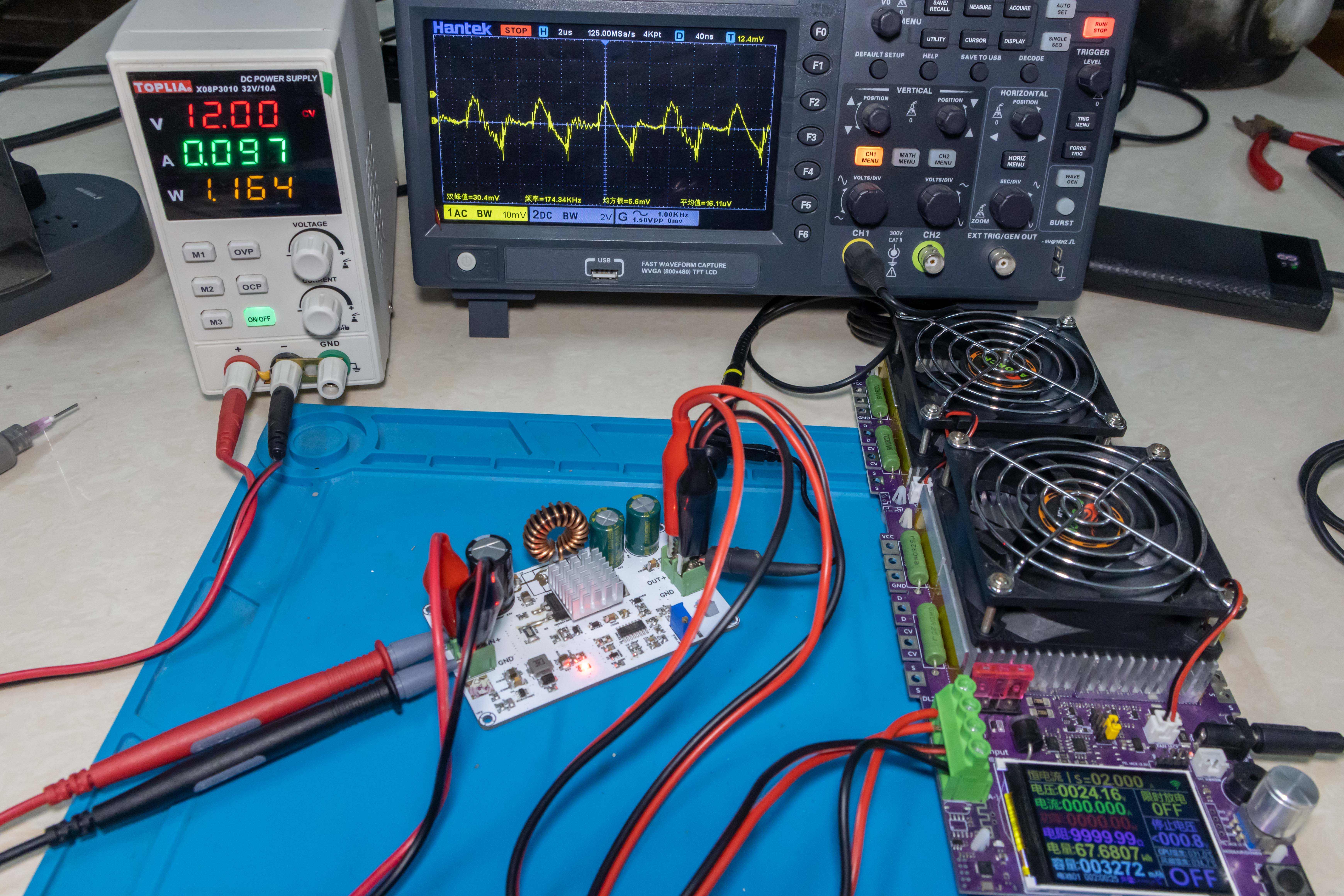

With an input of 12V and an output of 36.6V, the no-load current is 0.11A and the no-load power is 1.32W.

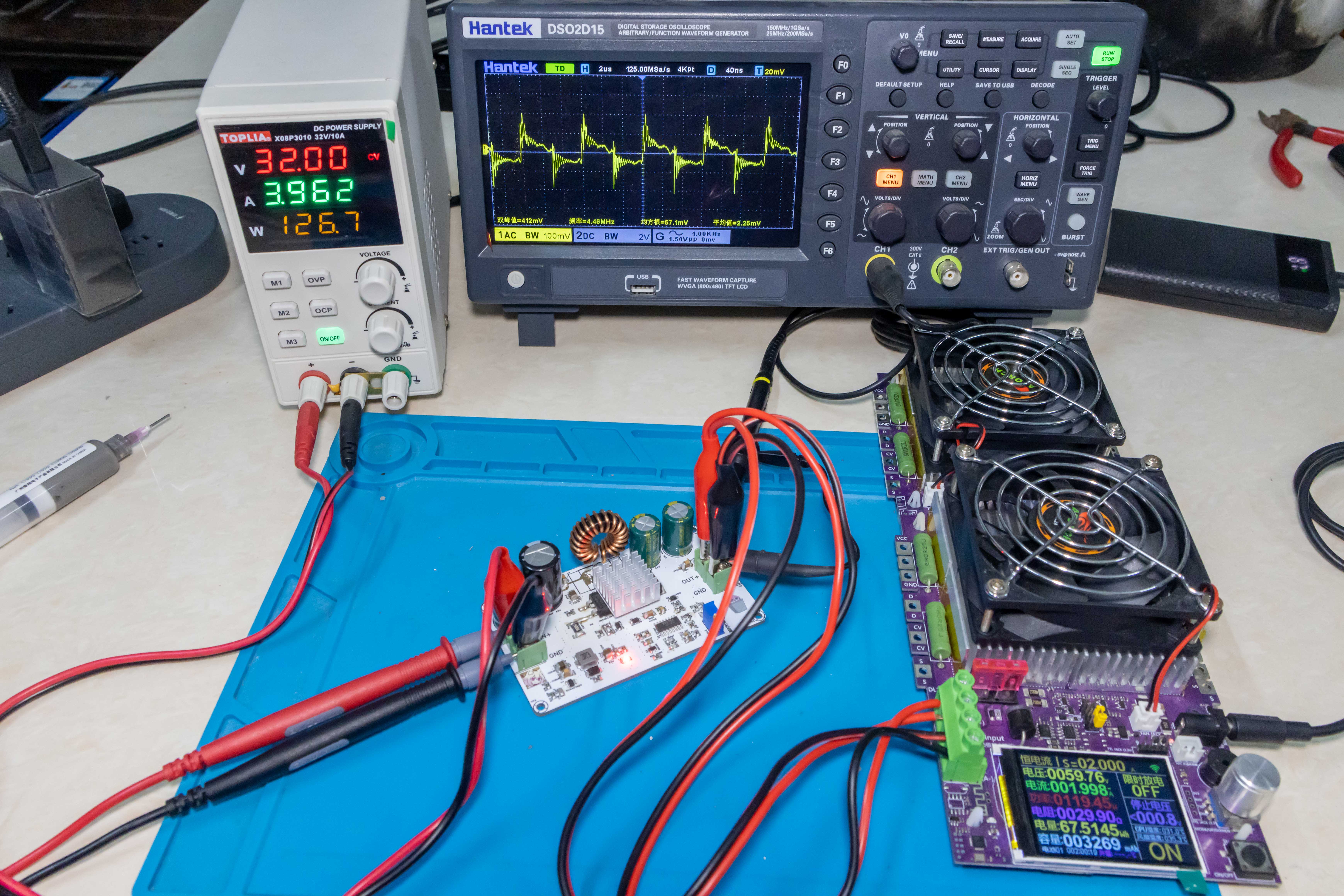

Different input/output voltage differences and different output currents will affect efficiency.

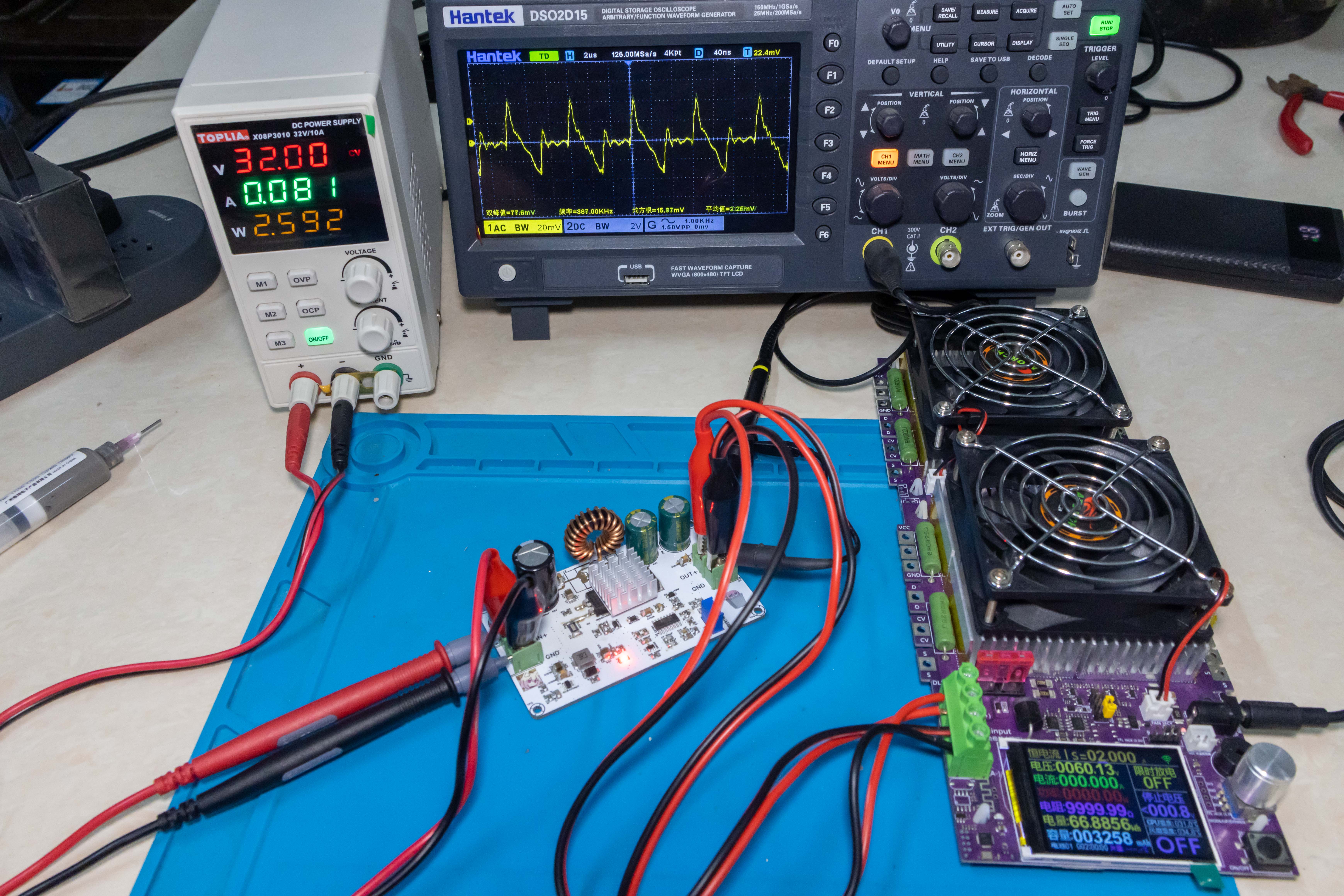

The ripple test
method below is incorrect. The correct method should be to use a grounding ring to reduce grounding loops, and also to measure the output capacitor terminals. I simply connected it directly to the output terminals to avoid this, so the output ripple measured below may be too high.
With an input of 32V and an output of 60V under no-load, the peak-to-peak ripple is approximately 77mV. With an input of 32V and
an output of 60V at 2A, the peak-to-peak ripple is approximately 412mV. With an
input of 12V and an output of 24V under no-load, the peak-to-peak ripple is approximately 30mV.
With an input of 12V and an output of 24V 2A, the peak-to-peak ripple value is approximately 350mV.
With an input of 8V and an output of 12V 2A, the peak-to-peak ripple value is approximately 170mV.

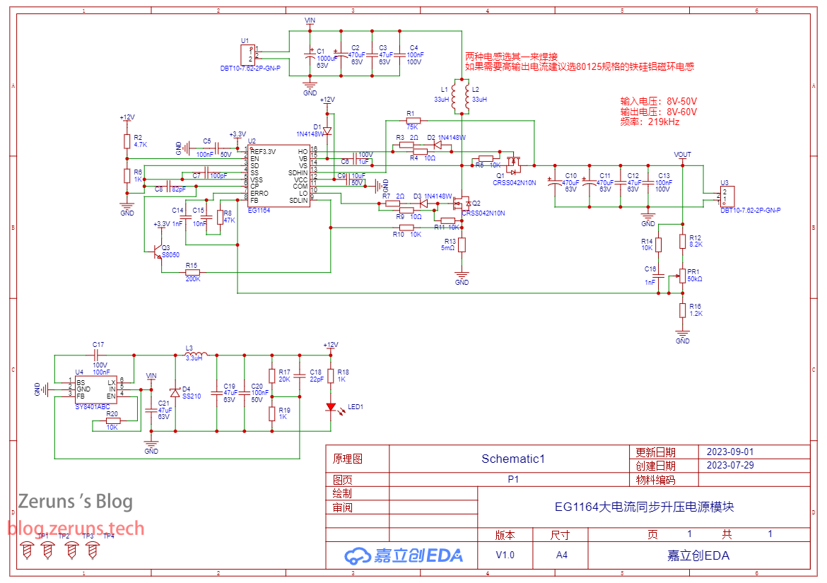

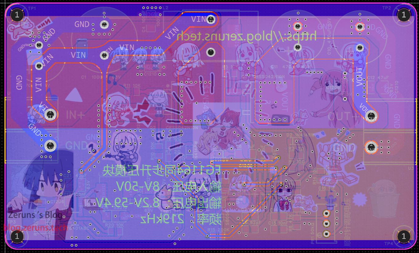

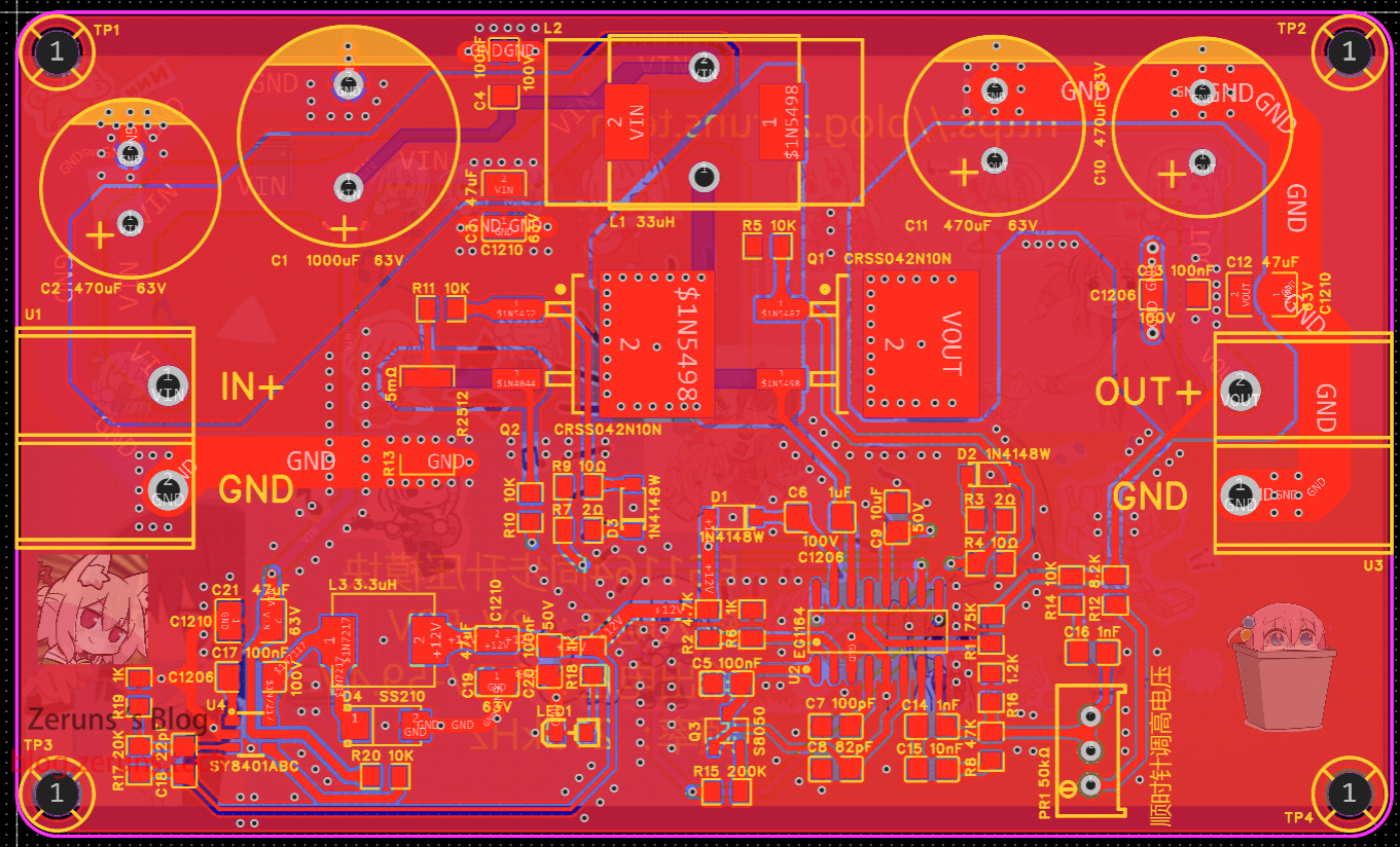

Schematic and PCB
diagrams
: Top layer:
Bottom layer:
