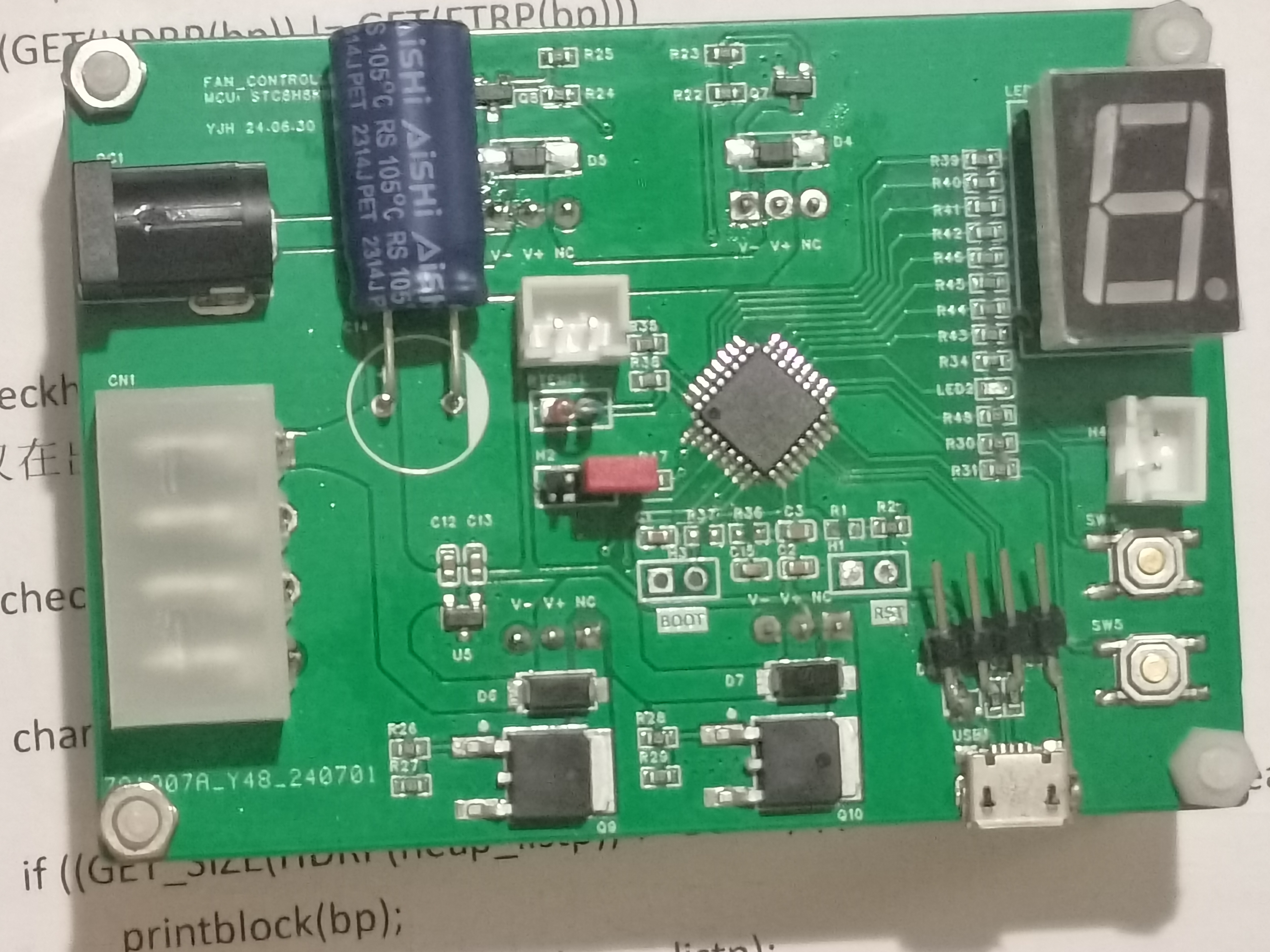

First,
let's build a PWM speed control system for a cooling fan around an STC8H8K64U microcontroller that supports 5V power. It's specifically designed for inexpensive 12V 3-pin cooling fans because I can't afford 4-pin fans with temperature control. Two connectors are dedicated to low-current 3cm/4cm cooling fans, and two connectors allow for slightly higher-power case fans. High-powered fans are out of the question.
This project supports manual speed control for both fans, or automatic speed adjustment based on the NTC sensor. It has already been tested on a computer, using the large 4-pin connector of the power supply to drive two 4cm fans, and they spin. The noise is significantly reduced when the heatsink is at low temperatures compared to full speed. Before powering on, you can set the mode to manual or automatic using jumpers. The digital tube can display the manual mode setting or the temperature of the MOS heatsink and fan speed in automatic mode.
Temperature values ​​have a certain margin of error and are for principle verification only. For accurate results, please further refine the program according to the datasheet.
II. Precautions:
The PCB has several bugs, but these are minor and do not affect use if they can be resolved with jumper wires or simple adjustments. After repair, it has been verified to be working correctly; please see the Bilibili video.
Due to my computer system issues, USB programming was not possible; therefore, an external header was used with an automatic programmer to program via serial port.
The diode at the original USB interface must be removed.
The fan pin definitions on the front of the PCB (chip side) are reversed; please delete them during prototyping.
The silkscreen markings for the BOOT and RESET pins appear to be reversed, but these pins are not needed with an automatic programmer.
Temperature measurement results are for principle verification only; the least squares fitting results have a significant error.
Other bugs need further investigation.
I've been too busy lately to do a second prototyping. During use, please note:
Select automatic mode (unconnected) or manual mode (connect jumper cap) via H2.
Please connect an NTC thermistor to the RTEMP port to measure the temperature of the motherboard MOSFET heatsink.
An external button can be connected to the H4 interface for future manual control. This feature is yet to be added.
Currently, it supports dual-fan temperature-controlled cooling (two 4cm fans). The two fan connectors at the bottom are temporarily reserved for future use in chassis temperature-controlled cooling.
The PWM repetition frequency of the fans may need to be adjusted based on the actual fans. The microcontroller's main frequency is configured at 24MHz.
If possible, an automatic programmer can be purchased to eliminate the need for manual power-on/off during programming.
Why isn't the PWM code for the two fans below written? Because there's no money to buy a chassis at the moment...

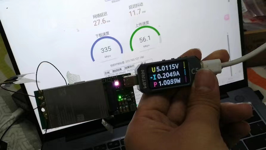

FM350-GL 5G Module to USB Adapter Board [USB 3.0 Verified]
FM350-GL 5G module to USB adapter board, supports USB 2.0/USB 3.0, single nano-SIM.
USB 3.0 only supports one side. Inserting it correctly activates USB 3.0, while inserting it incorrectly activates USB 2.0. The LED color changes depending on the orientation (pinkish-purple for USB 3, yellow for USB 2) . Make sure you insert the correct LED when wiring the circuit board; the first draft is unusable.

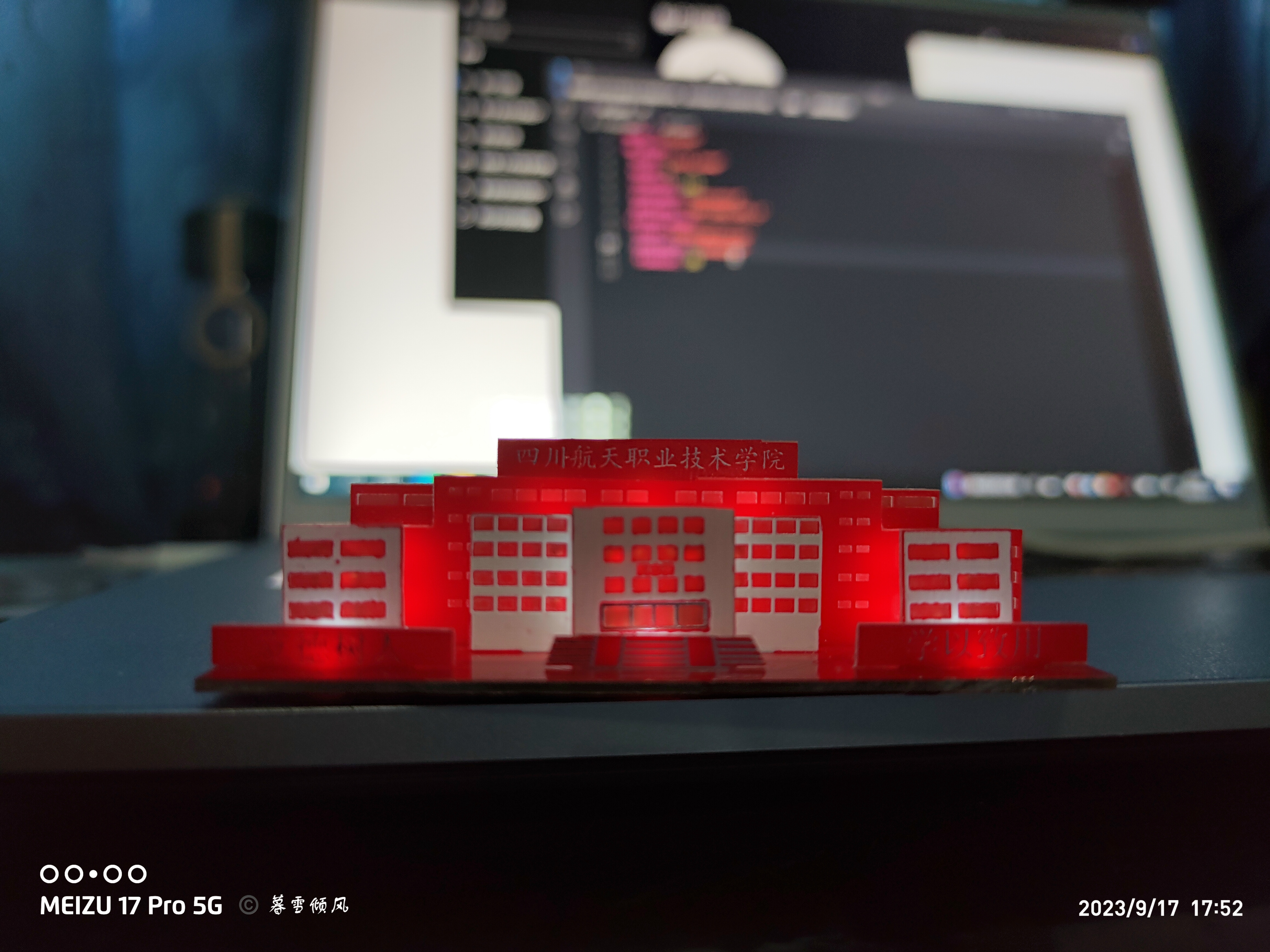

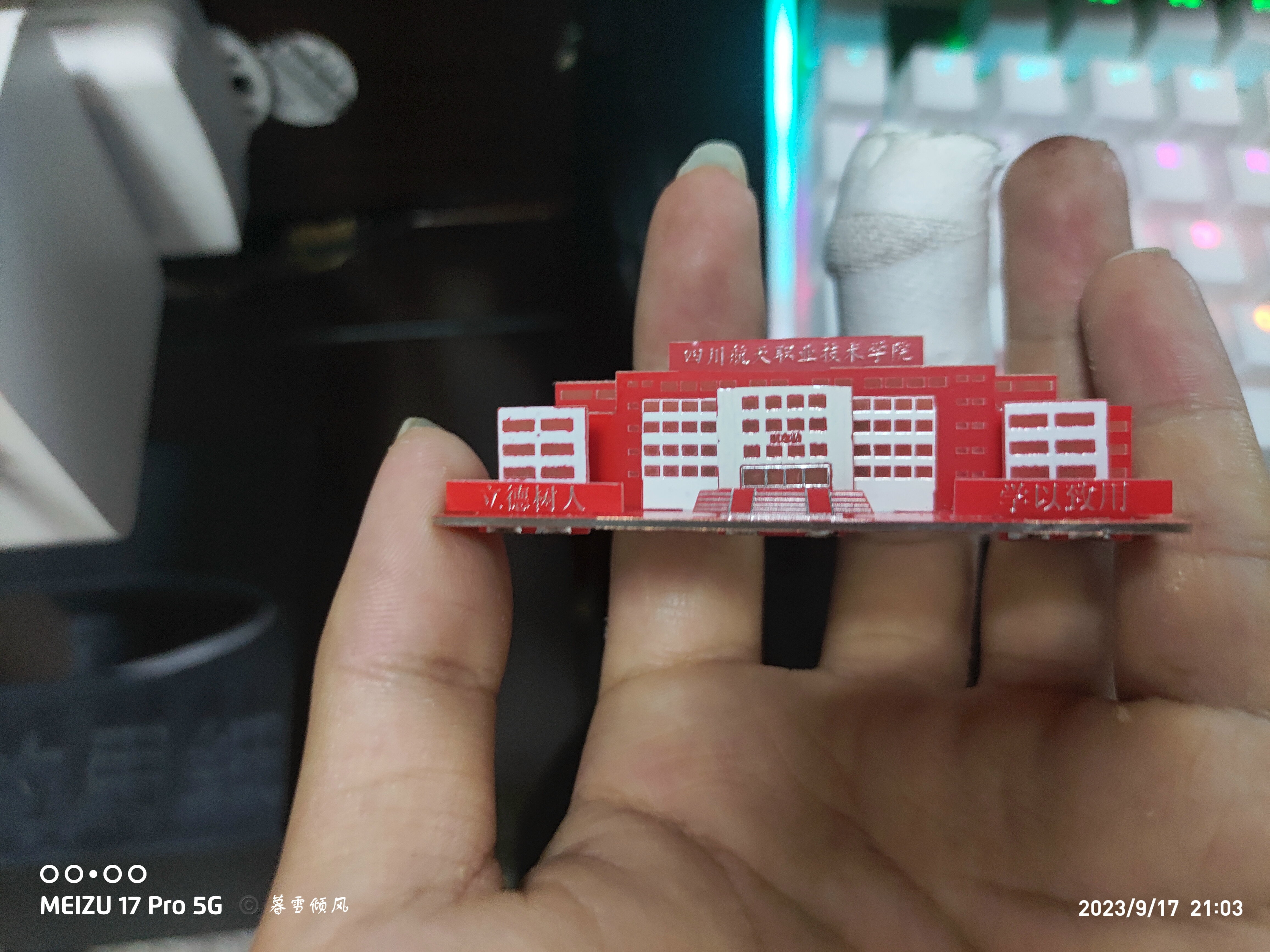

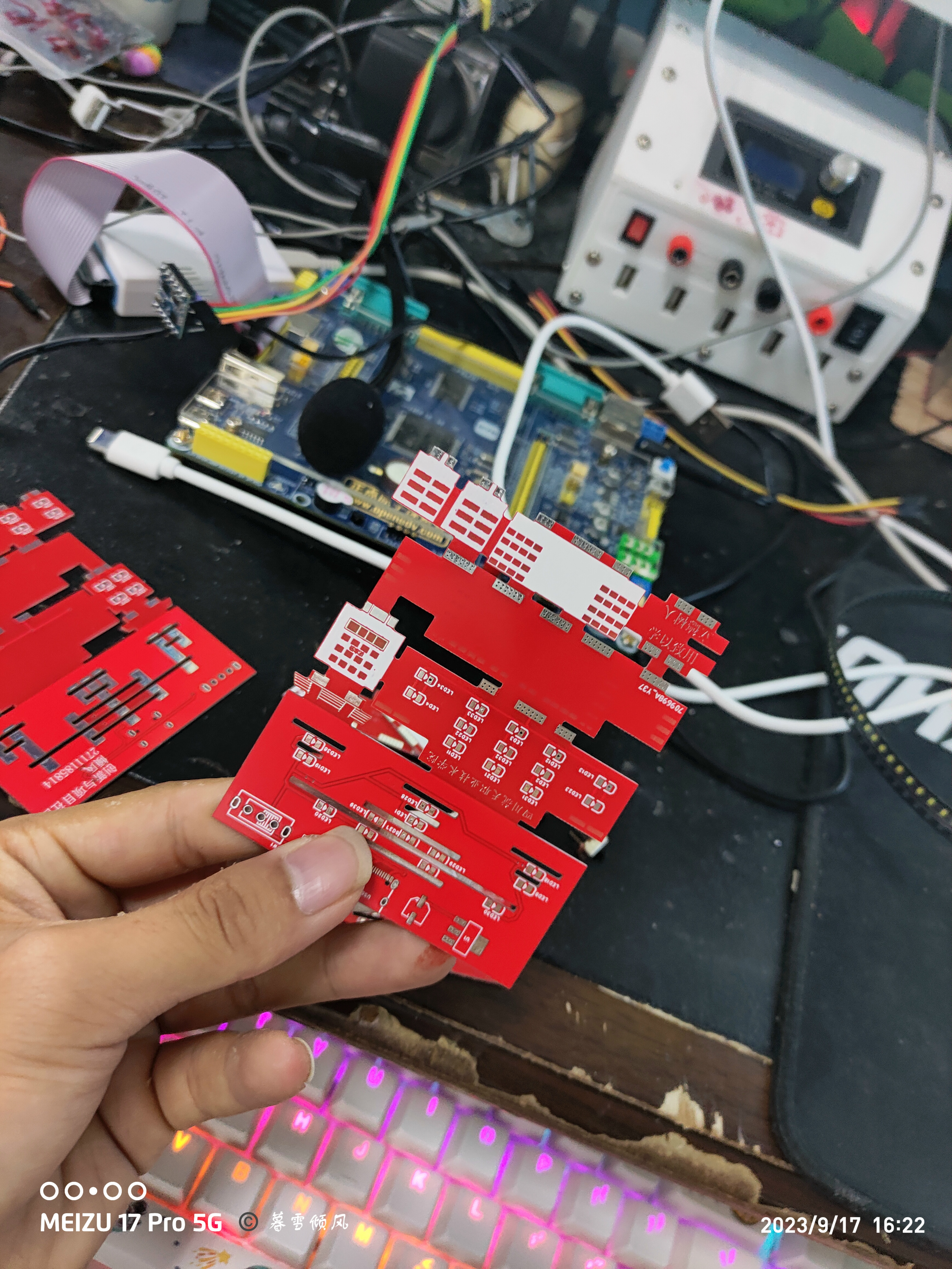

3D Illuminated Puzzle of Sichuan Aerospace Vocational and Technical College

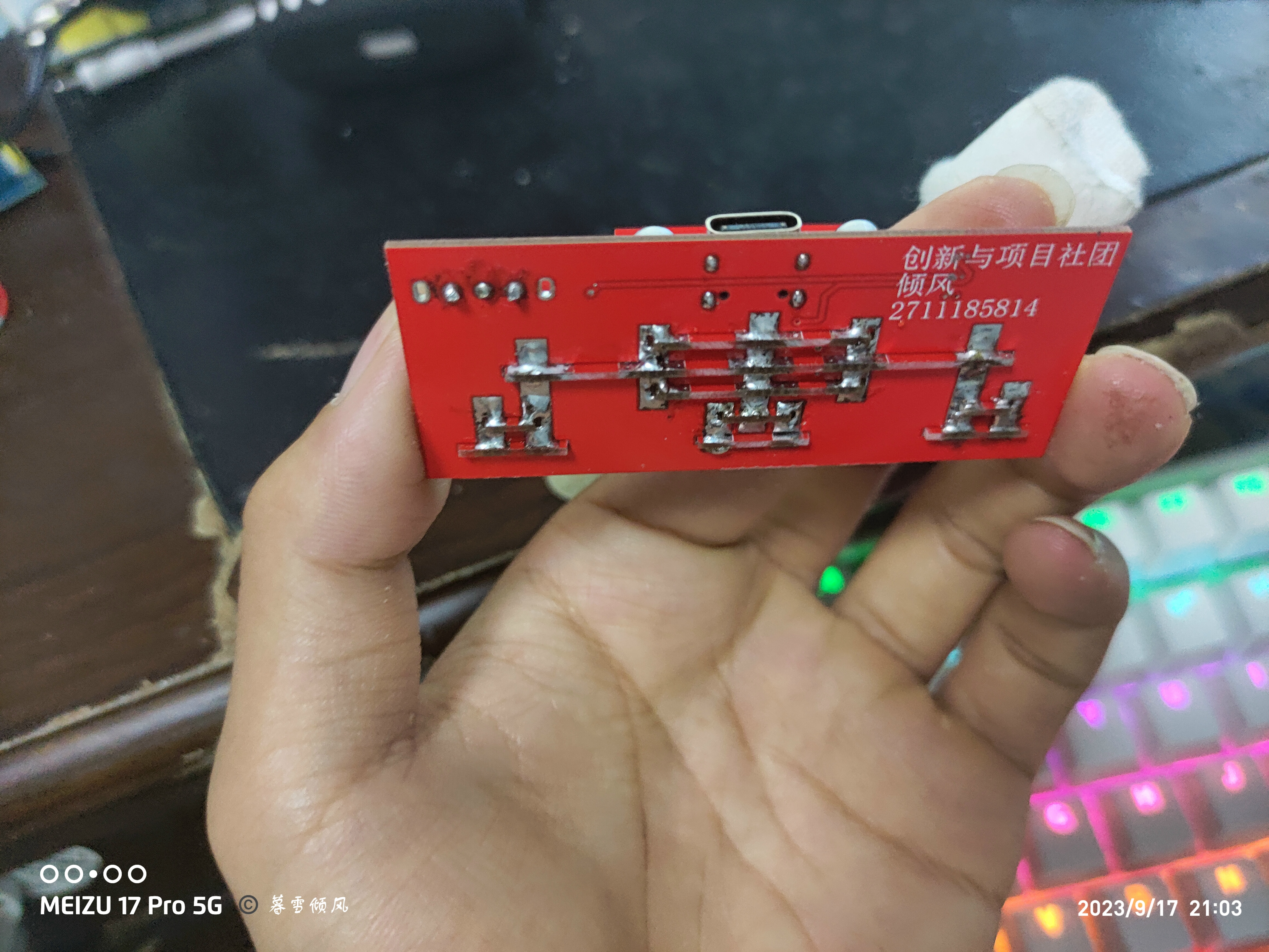

After receiving the 3D illuminated jigsaw puzzle from Sichuan Aerospace Vocational and Technical College, it needs to be cut.
Each part
has solder pads that need to be soldered.
used a self-made heating table and solder paste for surface mount soldering. Pay attention to the positive and negative directions of the LEDs during soldering. Here's
a preview of the finished product:
this is the top,
this is the bottom, note the order of the different board layers.
Finally, here's the overall view.
Below is the effect after turning on the lights.
