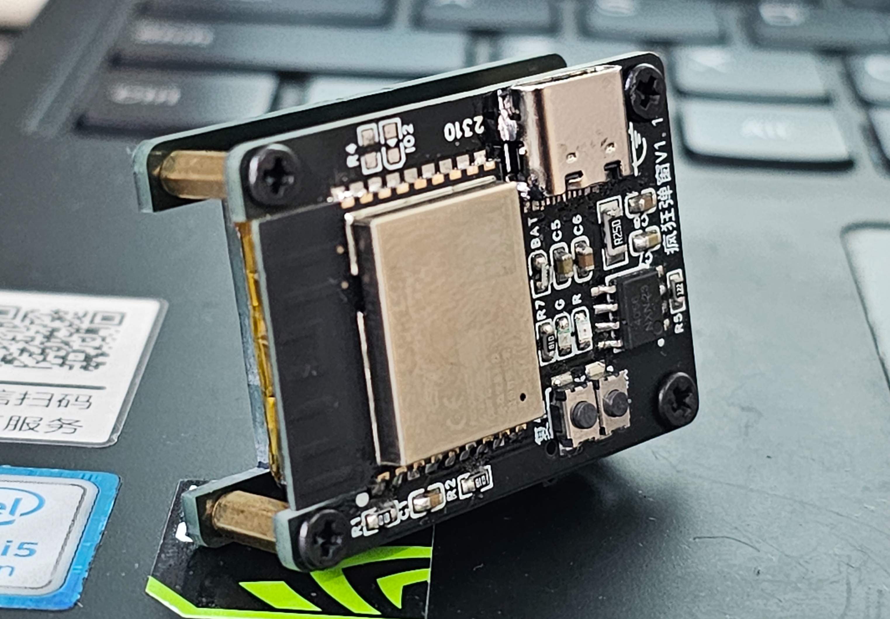

Uploading via VS Code
requires the latest version. Please visit:
https://oshwhub.com/qusenberg/feng-kuang-dan-chuang-pro
. For maximum power, add the following source code below `BLEDevice:init("Airpords69)"`: `
esp_ble_tx_power_set(ESP_BLE_PWR_TYPE_AD V, ESP_PWR_LVL_P21);
esp_ble_tx_power_set(ESP_BLE_PWR_TYPE_SC AN, ESP_PWR_LVL_P21);
esp_ble_tx_power_set(ESP_BLE_PWR_TYPE_DEF AULT, ESP_PWR_LVL_P21);
` Effective distance ≥ 3m.

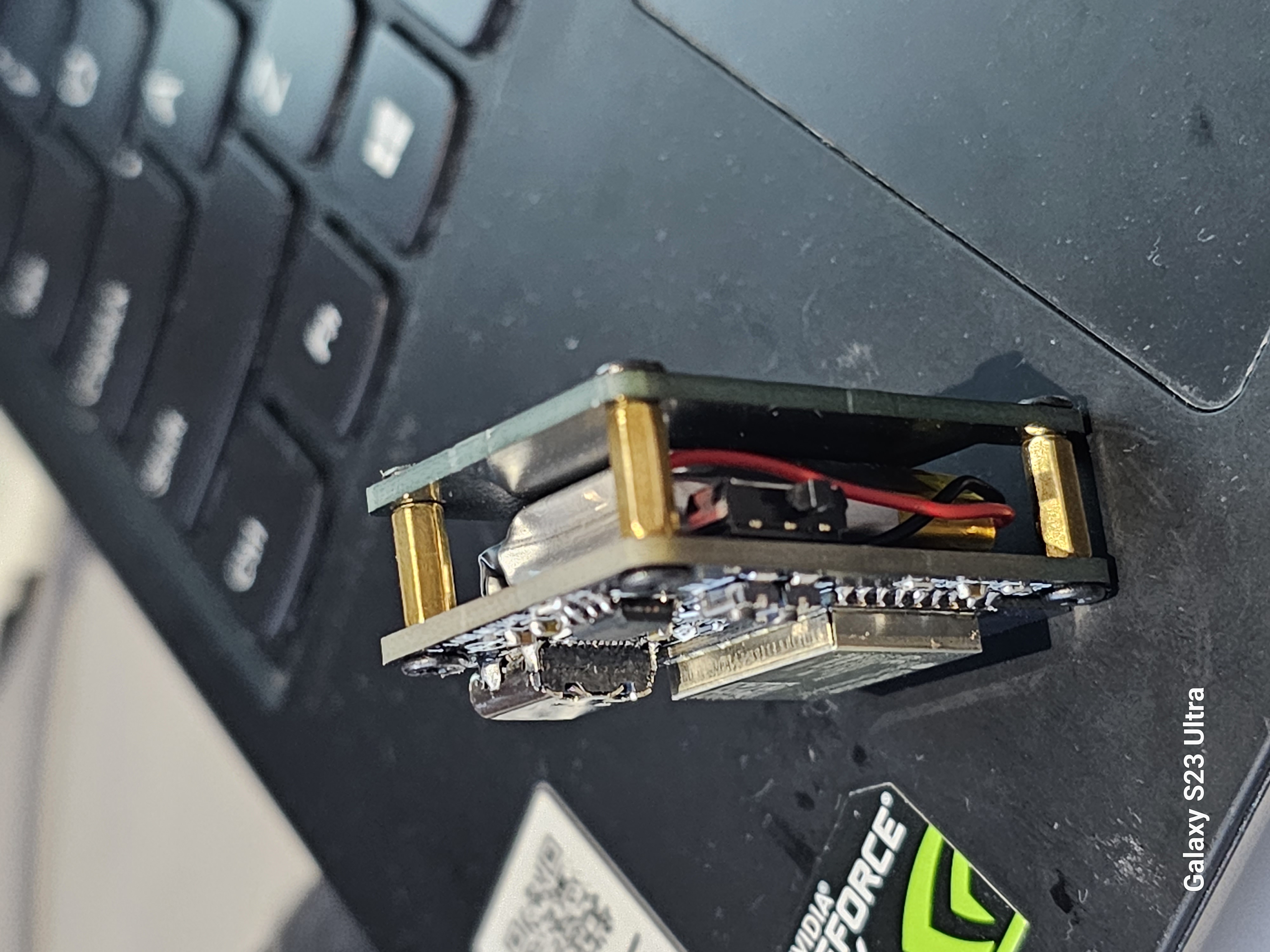

Materials:
1) Thickness, width, and length 70, 20, 25mm; Battery - 300mA (antenna version is 150mA);
2) Copper pillars M2*8 (4 pieces), M2 screws (8 pieces).
3) 3M double-sided tape for fixing the battery

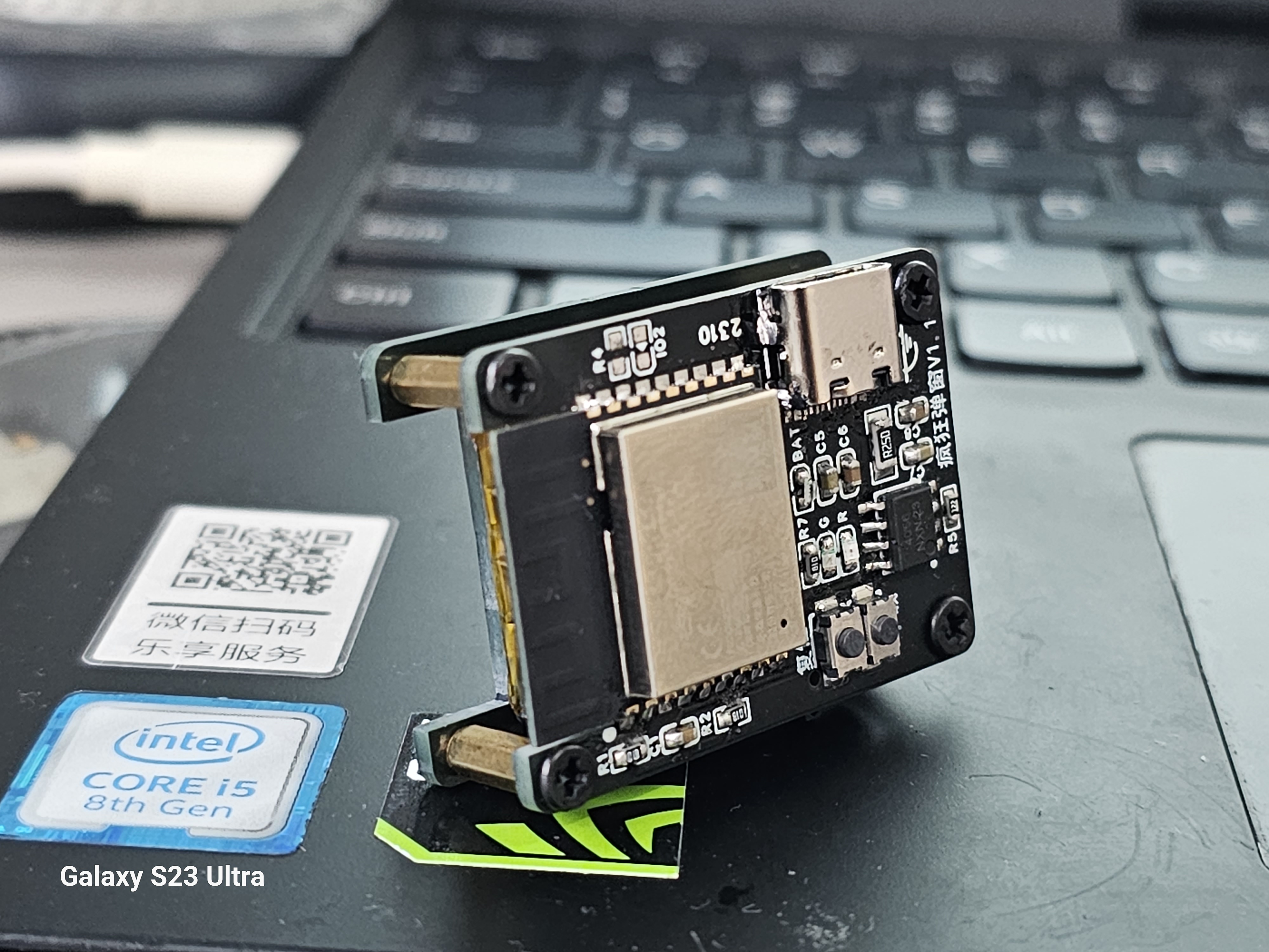

V1.0 (October 18, 2023):
1) Simplified the size of the ESP32 development board, and added a battery management module later for easy portability without external power supply;
V1.1 (October 23, 2023) :
1) Changed ESP32 S3 to ESP C3 to reduce cost;
2) Added a power switch (forgot to mention, oops!);
V1.2 (October 24, 2023): 1
) Circuit fine-tuning;
V1.3 (November 4, 2023):
1) Added a step-down voltage regulator chip to solve the problem of program download failure without battery installation (useless); 2
) Added battery pads;
3) Circuit adjustments;

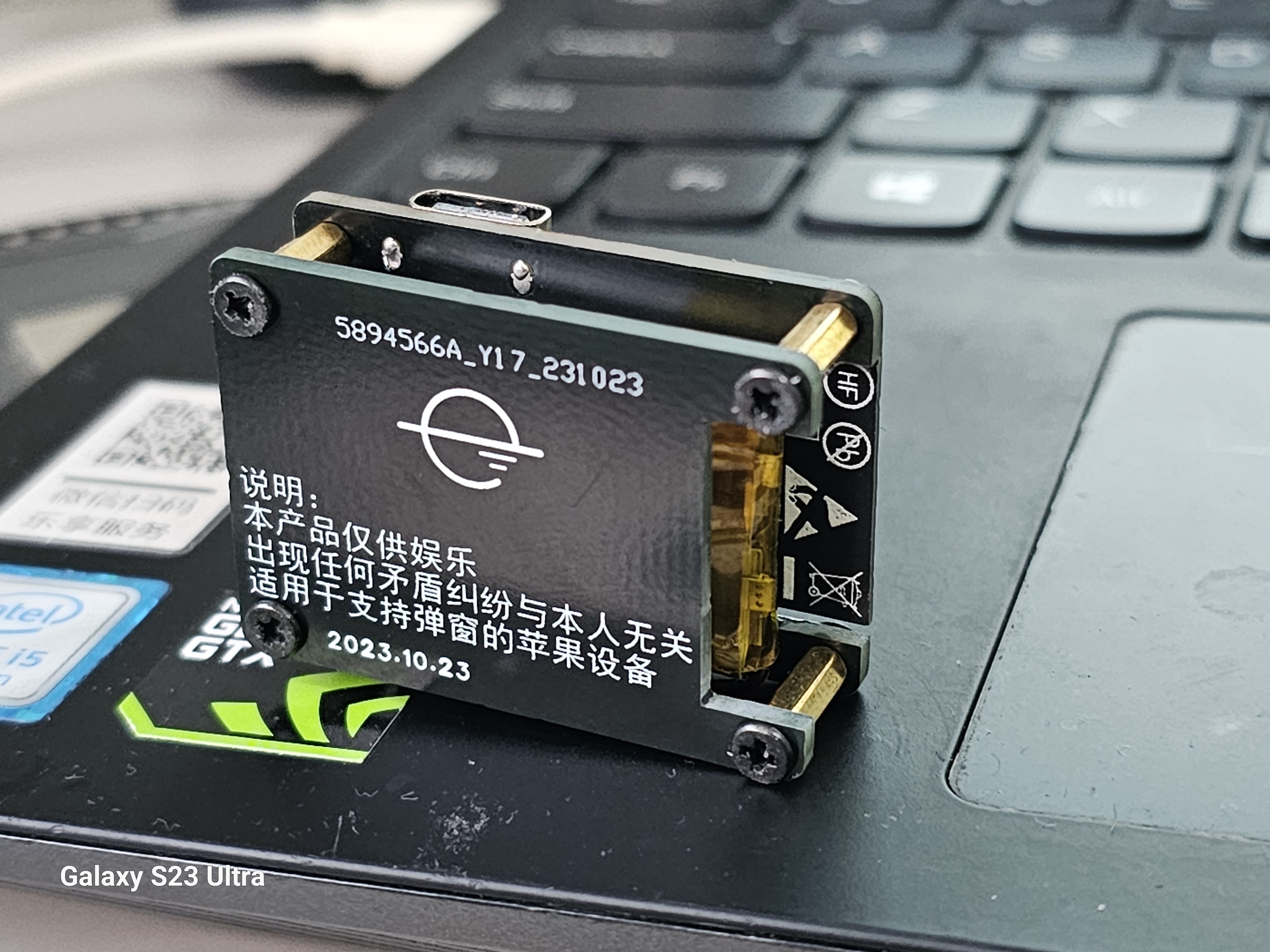

) NC: Non-Commercial (optional ) ND: No Derivatives SA: ShareAlike  Attribution BY. Anyone using your work must give appropriate attribution, provide a link to the corresponding CC license, and indicate whether modifications were made (to the original work). Non-Commercial Use NC. Others may not use your work for commercial purposes. No Derivatives ND. If someone remixes, transforms, or creates based on your work, they may not distribute the modified work. ShareAlike SA. If someone remixes, transforms, or creates based on your work, they must distribute the modified work under the same license as the original. Note: This product is for entertainment purposes only. Any disputes arising from it are not the responsibility of the user. Compatible with Apple devices that support pop-ups.
