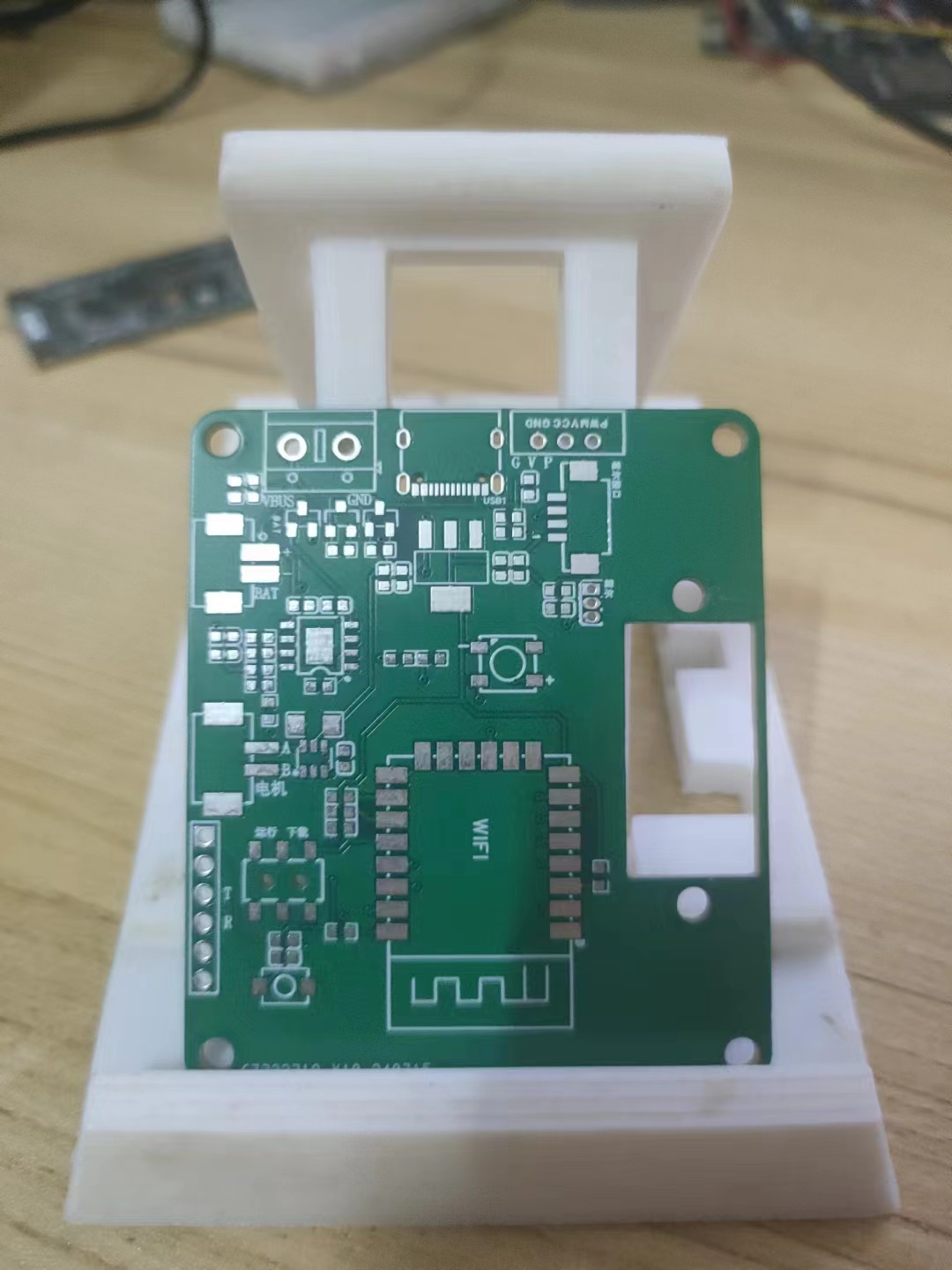

A simple and effective remote door opening module based on ESP8266, perfect for rental properties.
This project is a remote door opening module for old-fashioned anti-theft locks in rental apartments. It uses a simple and straightforward door opening solution, solving my frequent hassle of forgetting my keys and having to ask the landlord for them. It's primarily based on Blinker's IoT solution (mainly free). Blinker features include: Blinker documentation center.
The module uses a simple door opening solution made from a cheap second-hand lever motor and a cable tie (available on Taobao for a few dollars). (The module also has an SG90 servo motor interface; you can design your own).

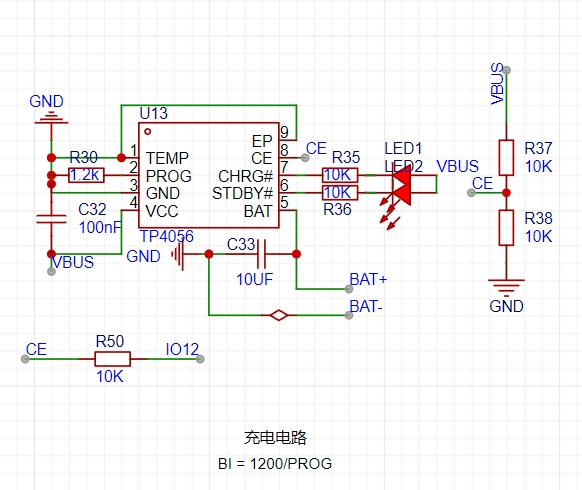

1. It has an automatic dual power supply function, switching between USB power and battery. The main power is USB, and the secondary power is battery. This mainly handles unexpected USB power failures or outages. (Even during a power outage and without internet access, you can use your phone's hotspot to connect to the module and open the door). In addition to the Type-C data cable power interface, the USB power interface also has a screw-type interface to prevent issues with insufficient cable length; you can use a spare 5V 1A charger and data cable for power. Power consumption: Standby current is 24mA to 43mA, and the average power consumption is 0.17W. Further optimization of the ESP8266's power consumption can achieve even lower power consumption.
2. It features an automatic battery charging circuit using the commonly used TP4056. The charging enable pin is pulled down by default, preventing charging upon power-up; however, a pull-up IO pin can be configured for charging. The ESP8266's ADC measures the battery voltage, and automatic charging thresholds and manual charging initiation can be set.

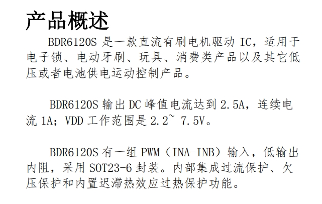

3. It supports an H-bridge motor driver IC, with sufficient power to drive most brushed motors. It supports forward/reverse rotation, braking, and PWM speed control (this IC is often offered with special discounts on the LCSC online store).
4. A Hall sensor interface is provided, allowing external Hall sensors to be connected to the edge of the door, with magnets placed on the door frame to detect the door's open/closed status. (Any Hall sensor will do, as long as it doesn't have a latching function)
(The Hall sensor function has been verified, but I didn't place it on the edge of the door; I only verified it on the onboard Hall sensor)
5. Essential RGB, with a reserved WS2812 RGB; (Unused function, under development, I don't know what it's used for)
6. Detect USB power supply status and notify the client promptly upon power failure;
7. Serial port download interface, download running status switch, reset button;
8. The software is not yet complete; only basic functions have been verified;

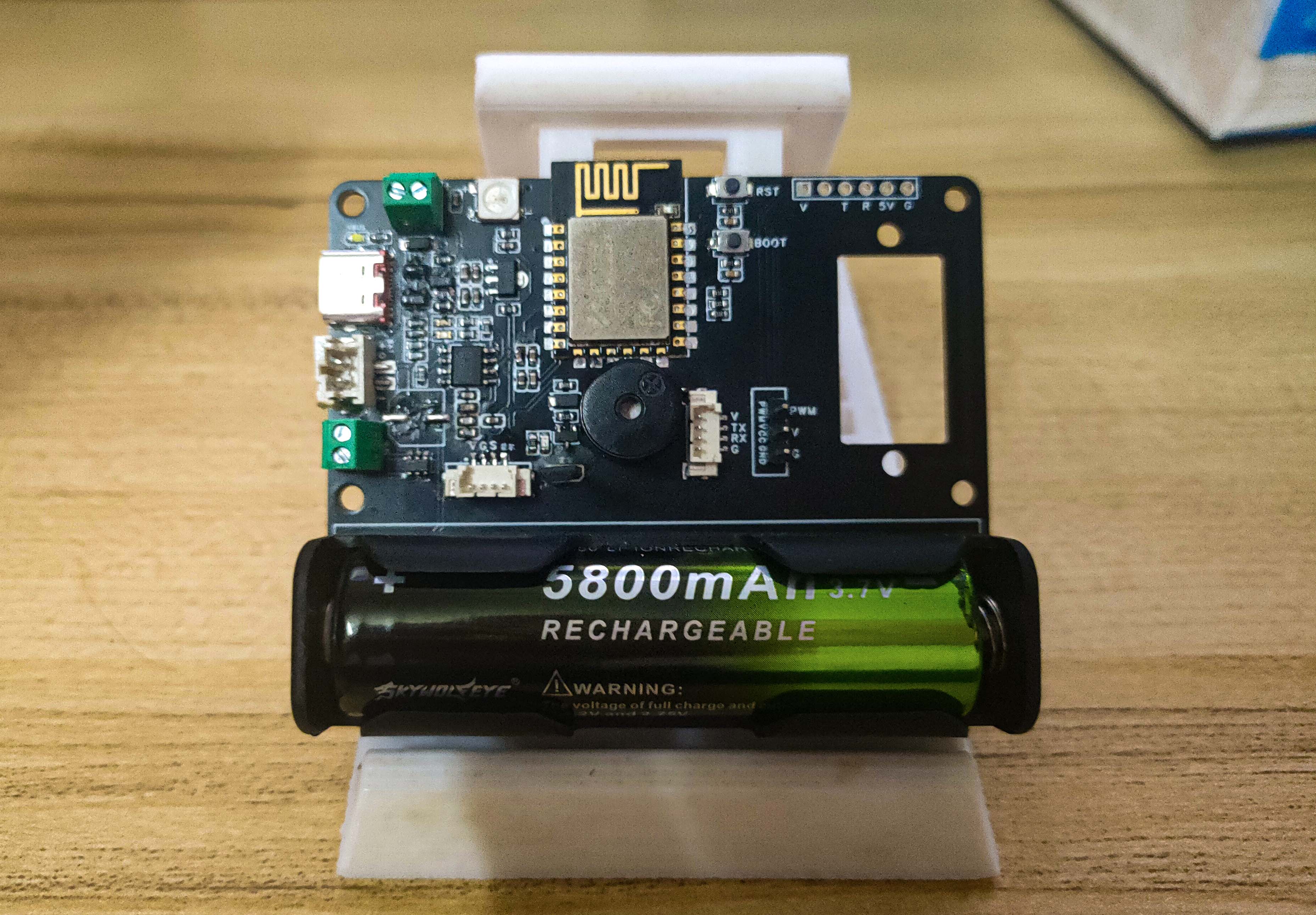

The above is the V1 version description
V2 version has been boarded and functions have been verified......

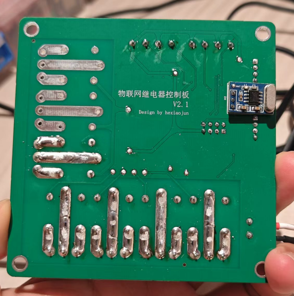

IoT relay control board
This module uses an STC chip as the main controller, integrating four ADC inputs and seven relays. It supports serial communication control and direct control via ESP01S. It also supports RS433 remote control.
Version 1.1 --> 2.1
adds support for 433 remote control module (SYN480R) .
Version 1.0 --> 1.1 updates include
optimized wiring between some components
, upgraded 3.3V power supply, improved power supply capability for ESP01
, firmware optimization, and support for DHT11 connection .
1. Power
Supply: Minimum voltage 12V, maximum 80V
. 2. Design:
Integrated 4-channel ADC input with 10K pull-down resistors for connecting NTC and other sensors.
Integrated 7-channel relays, allowing selection of normally open and normally closed connections.
Relay control and ADC data reading via serial communication.
Integrated ESP01S docking station for direct internet access.
UART1 and ESP01S cannot be used simultaneously; only one can be used.
3. Firmware:
Firmware is not open source
and lacks a reset button; a flashing program must be connected before powering on.
Firmware is downloaded via UART0.

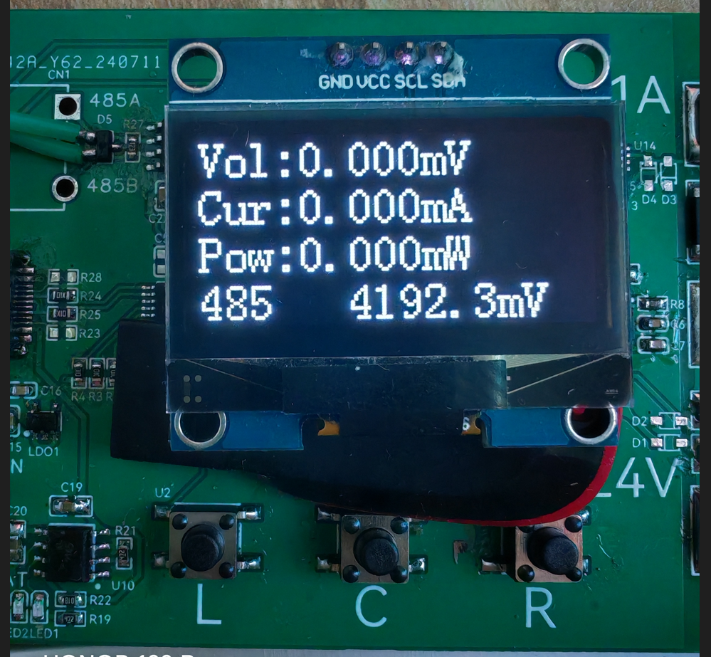

DC voltage and current meter
This is a DC voltage and current meter designed based on the STC8H microcontroller and BH45B1225. It overcomes the limitation of ordinary multimeters that lack data output (Modbus), and can simultaneously measure voltage and current and calculate power. It is compact and battery powered.
0. Introduction:
The initial design purpose was to facilitate continuous current and voltage testing and output recording to a computer. The main goal was to facilitate development and testing.
Regarding accuracy, the system consists of two parts: a sampling front-end and a back-end processing unit
. The sampling front-end is extremely rudimentary, mainly for functional verification, and there is still considerable room for optimization (when floating, the current range has a baseline but fluctuates; the voltage range has a baseline and is relatively stable; the zero-value can be set separately via the Modbus interface).
The back-end uses the BH45B1225, mainly because it is easy to purchase, reasonably priced, and has a continuously adjustable PGA (1~128).
1. Measurement Parameters
: Measurable DC voltage ≤24V, DC current ≤1A (resistance voltage divider 1:101, current sampling resistor is 10mR).
In the code, the voltage range using 8 times the PGA can measure 2500/8 = 312.5mV, and the current range using 128 times the PGA can measure 2500/128 = 19.53125mV.
Combining the above measurement ranges with the voltage divider or sampling resistor, the actual voltage input range is ≤31V, and the current input range is ≤1.9A.
The voltage resolution is approximately 0.12mV (currently there is no range division mechanism, calibration is troublesome), and the current resolution has not yet been tested with instruments.
2. Function Introduction: 1.
485 Mode ("485" is displayed in the lower left corner of the screen; long press "L" to switch to this interface; this is the default interface after power-on).
In this mode, the screen displays... The first mode displays voltage, current, "instantaneous" power, and battery voltage, with an approximate update frequency of 3Hz.
External devices can access the device's time, measured values, calibration parameters, etc., via a 485 interface based on the Modbus protocol.
This mode is suitable for simple voltage and current testing or for use in embedded user devices.
2. Log Mode (displayed in the lower left corner of the screen; long press "C" to switch to this interface).
In this mode, the screen sequentially displays voltage, current, "instantaneous" power, and battery voltage, with an approximate update frequency of 3Hz.
External devices actively report time and measured values ​​to the 485 port, with an approximate update frequency of 1Hz (reporting format is CSV, convenient for serial port to receive files and form tables).
This mode is suitable for simple voltage and current testing, or for recording voltage and current values ​​to a computer.
3. Settings Mode (displayed at the bottom of the screen) (Press and hold "R" to switch to this interface)
In this mode, the screen displays the voltage calibration value (default 101.000), current calibration value (default 100.000), and battery voltage calibration value (default 5.700)
in sequence. External devices can access the device time, measured values, calibration parameters, etc., via the 485 interface based on the Modbus protocol.
In this interface, you can also use the "RTC Time Synchronization" function in the STC programming software to calibrate the time (tested successfully using stcai-isp-v6.94H).
Let me briefly explain the calibration values. The voltage and battery voltage calibration values ​​are easy to understand. Regarding the current, I'll briefly explain that
the default 100.000 is derived when the sampling resistor is 10mR, but for some reason, when I actually tested the resistor, it only carried 1A of current. The voltage drop across the resistor was measured to be over 12mV,
so I simply reduced the calibration value by about 1.2 times and then fine-tuned it. The final value of 80.989 was found to be acceptable.
Therefore, the calibration value should be adjusted according to the actual resistor size during fabrication.
3.
The Modbus register table is attached, along with a simple user guide.
In Log reporting mode, Modbus commands are not responded to. It is recommended to open the serial port software first, check "Save to file," and then switch to Log mode to avoid losing the CSV header.
When programming, press the "L" button before powering on the chip. The device to be programmed will then appear in the programming software. Programming parameters are in the attached file. (The attached
file contains "ReceivedTofile-COM24-2024_7_21_17-56-47") - "copy.CSV" contains the device's serial port output to the file in Log mode. The measurement object is a lithium battery (not the lithium battery that powers the device; please pay special attention here).
During testing, please note that the 485 pin is not isolated, and the device's power supply should not be introduced into the measurement circuit. When measuring above 24V, pay special attention to electrical sparks; safety first.

The OLED refresh part uses analog IIC, and for convenience, it uses full-screen refresh, so the above frequencies all use the modifier "approximately".
Regarding the accuracy part, I used 1% conventional resistors in my tests. I feel that the voltage range is okay
, but the current range is not suitable. Regarding the code part, this is my first time using an STC microcontroller, and the code I wrote is really, well, hard to describe. I won't open source it to embarrass myself. If you encounter any problems during the replication, please feel free to give me feedback. In terms of
hardware, I am only a novice and know that there is still a lot of room for improvement. Please give me more guidance.
The measurement reference in the picture is when the air conditioner is on, and the measurement reference in the video is when the air conditioner is off. The temperature drift is quite obvious.
Later, temperature compensation and low temperature drift resistors need to be added. The voltage also needs to be measured in different ranges. The current detection part probably needs to be redesigned, otherwise there is not much meaning to the replication.' After using the STC8H
