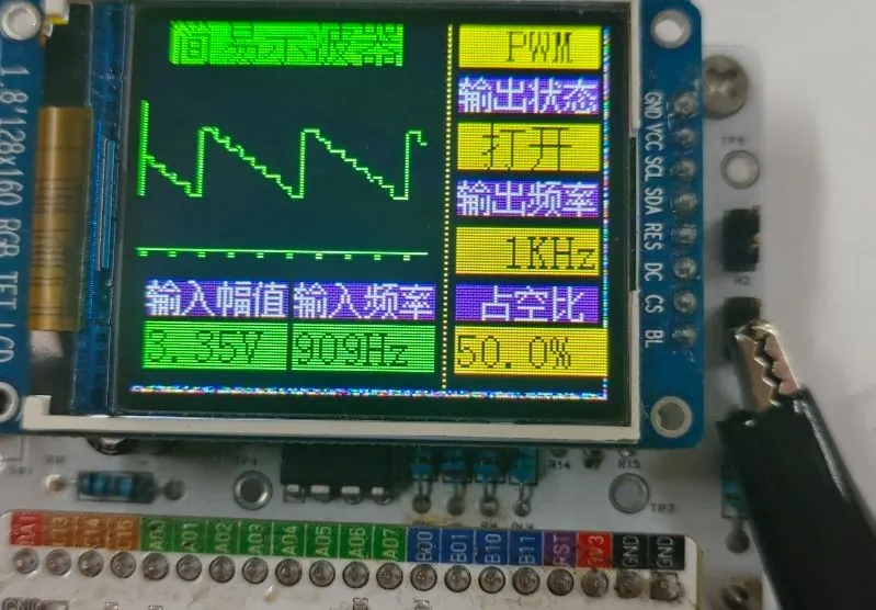

#Bootcamp# Building an Oscilloscope 6713356A based on GD32
 The power supply
for this project uses the GD32 minimum system board as its core, which has an onboard 5V to 3.3V step-down circuit. Therefore, only a 5V power input circuit needs to be designed when designing the expansion board. Following the official training camp, the mainstream Type-C interface was selected. The front-end analog circuit uses a TL074 dual operational amplifier, powered by +5V and -5V. The -5V voltage is generated by an XD7660 chip. Because a diode is connected at the output for protection circuitry, and the diode has a fixed voltage drop, the output voltage is between -4V and -5V.
