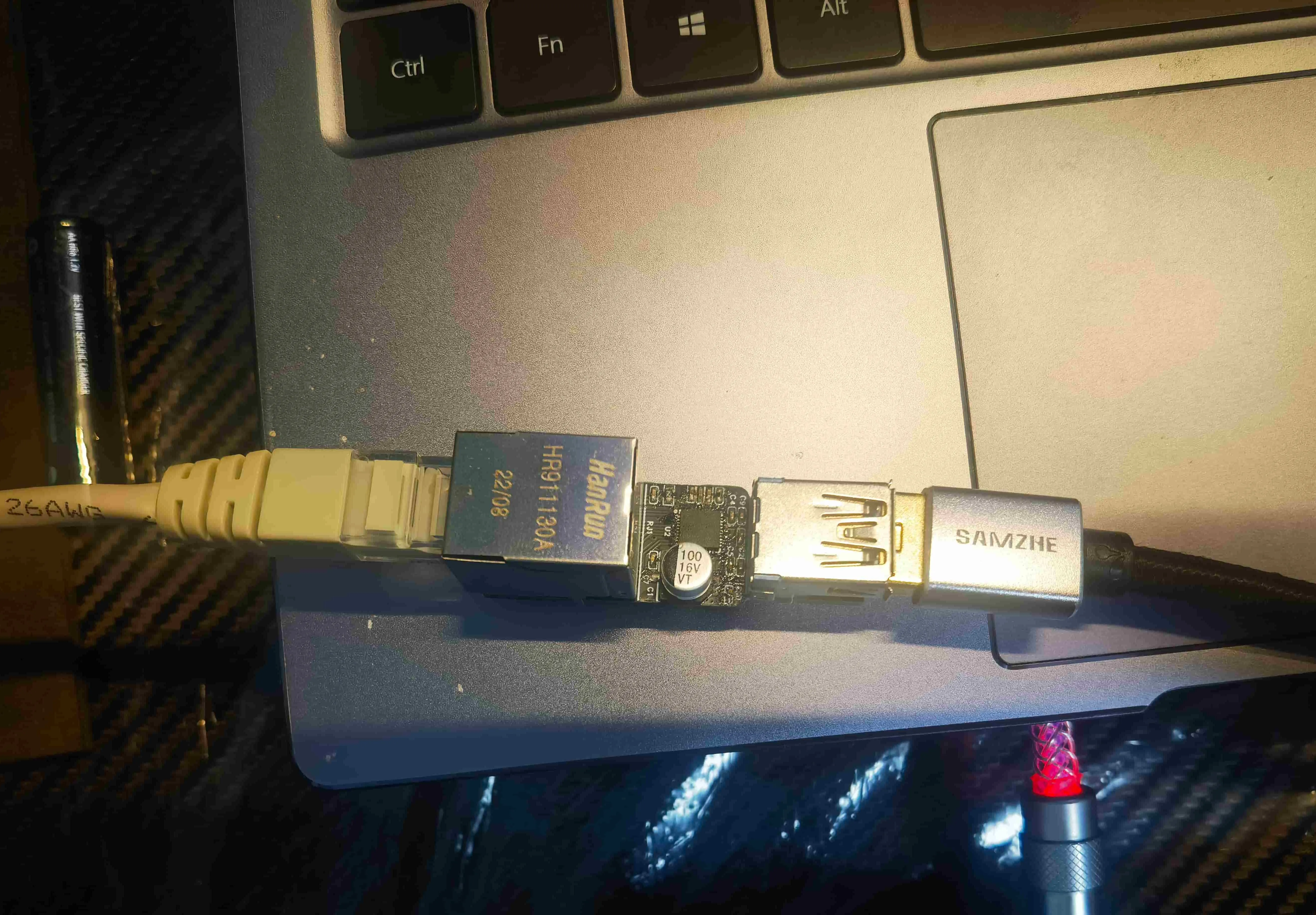

USB 3.0-A Gigabit Ethernet Adapter
Implemented based on the RTL8153B, it supports 10M/100M/1000M networks and primarily supports USB 2.0/USB 3.0-A ports.
For personal use, the cost of a single module is approximately 30 RMB.
It will generate some heat when running at full speed, but it's still within acceptable limits.
The board outline CAD file is uploaded; other interfaces (Type-C, etc.) can be replaced based on this.
Instructions/Tutorials:
1. This is a pure hardware module and does not require programming. If your computer doesn't respond or your device manager shows drivers with exclamation marks, please download the attached driver and install the corresponding driver for your system.
2. Regarding the solution for a MAC address of 0: (Actually, MAC address 0 can still be used) Use the attached tool, realtek_usb_lan_tool. Open it, plug it in, and it will automatically recognize the network card. After recognition, set the MAC address, and select EFUSE for model select. Note that EFUSE can only be modified once, so please modify it carefully! See the attached document for detailed instructions on using the tool; there are many references available, so I won't go into detail here.
Testing status:
Tested using iperf.
