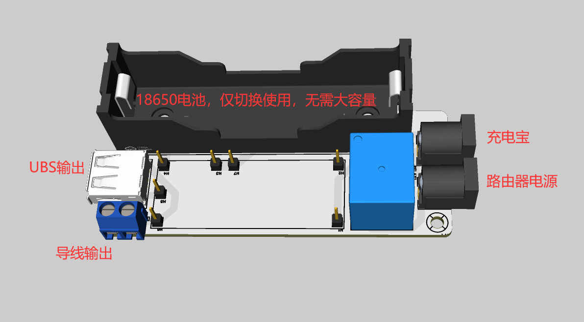

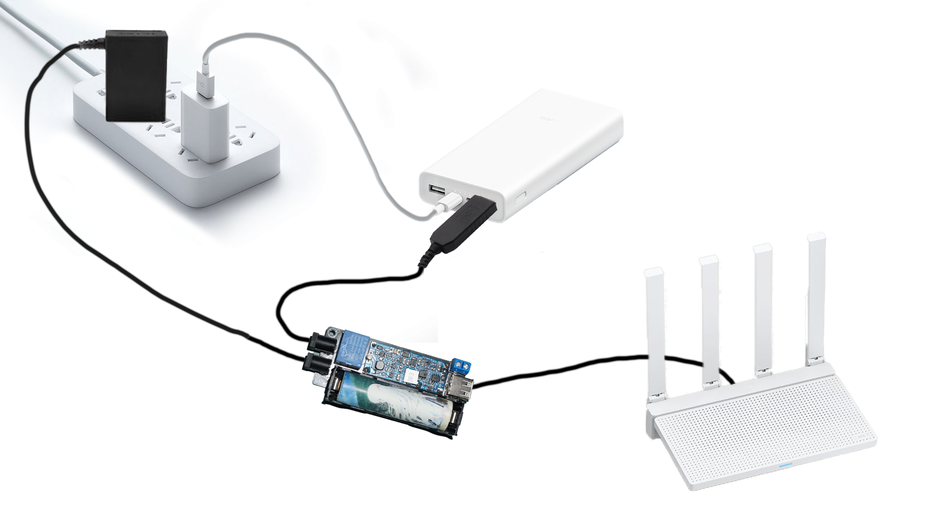

10 yuan), but the disadvantage is that the power bank needs to wait a few seconds to switch. The power
bank is plugged in to charge during the day, but its output is connected to this module. After the power outage at night, the relay switches to power from the power bank, but the power bank needs 5-10 seconds to switch. Use an 18650 battery to replace it. This battery doesn't need to be high quality; a cheap one from Pinduoduo (around 2-3 yuan with free shipping) will do. After the power bank switches, use the power bank to power the module.
Note!

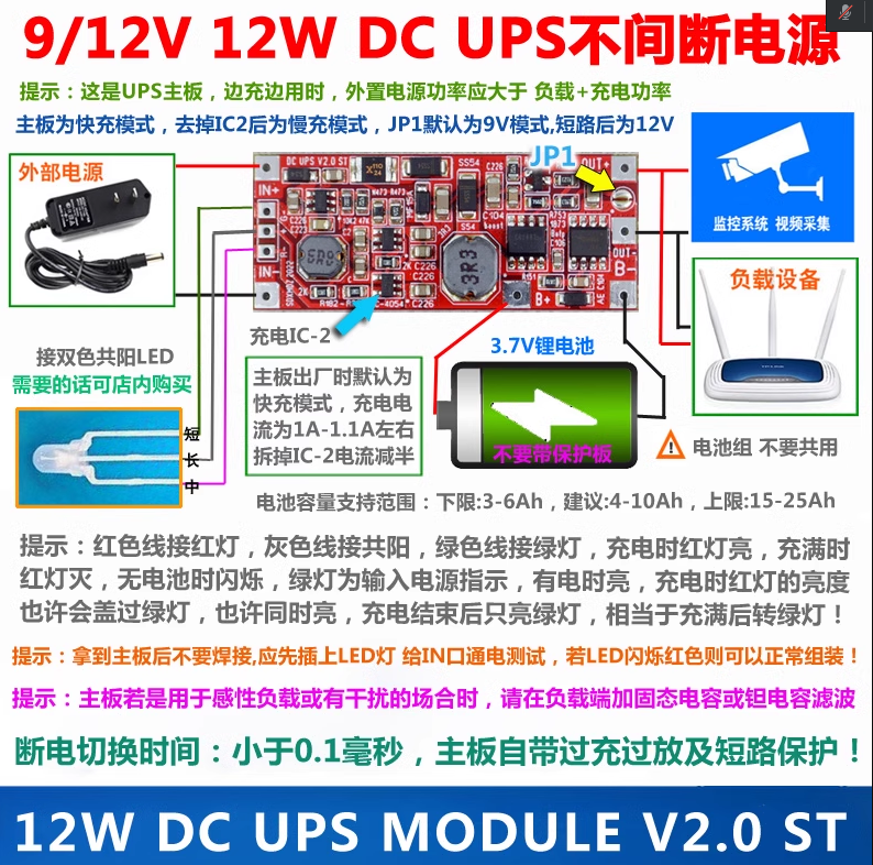

① Some routers are 9V, but the BOM list shows a 12V relay. If the router is 9V, select 9V when choosing the relay.
② This assumes you already have a USB 12V boost cable. This cable is not listed in the BOM. If you don't have it, please purchase it separately. (If your power bank can output 12V, a decoy cable is preferable.)
③ Some routers (such as Xiaomi) do not have a 5.5V DC port; you will need to purchase the corresponding cable or adapter.
④ This UPS motherboard only supports 3.7-4.2V batteries. When purchasing batteries and battery boxes, be sure to avoid buying batteries and battery boxes connected in series!
⑤ For the voltage display, please buy one with a range of 0-100V, covering 3.7-4.2V. Do not buy those with a range of 4-30V.

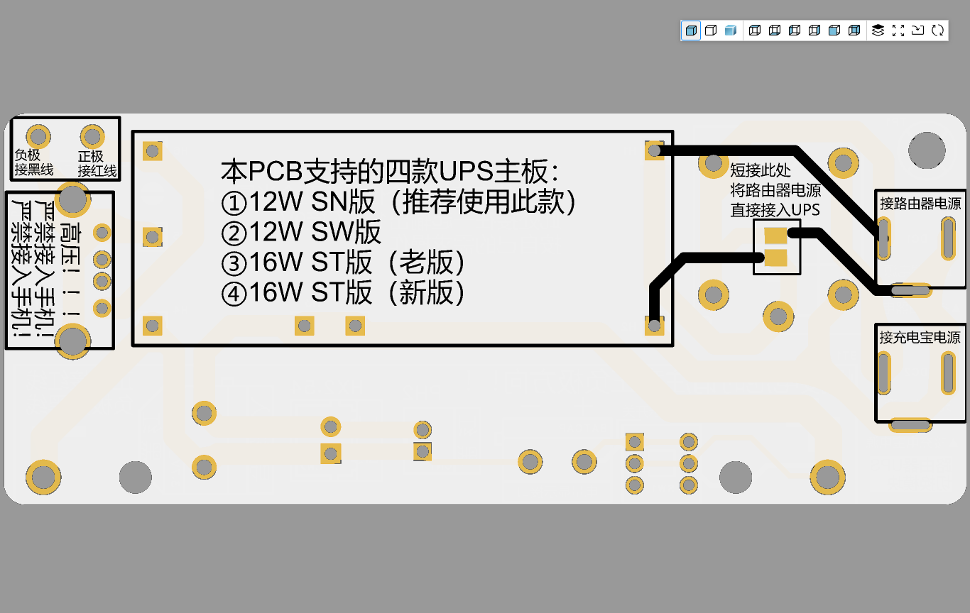

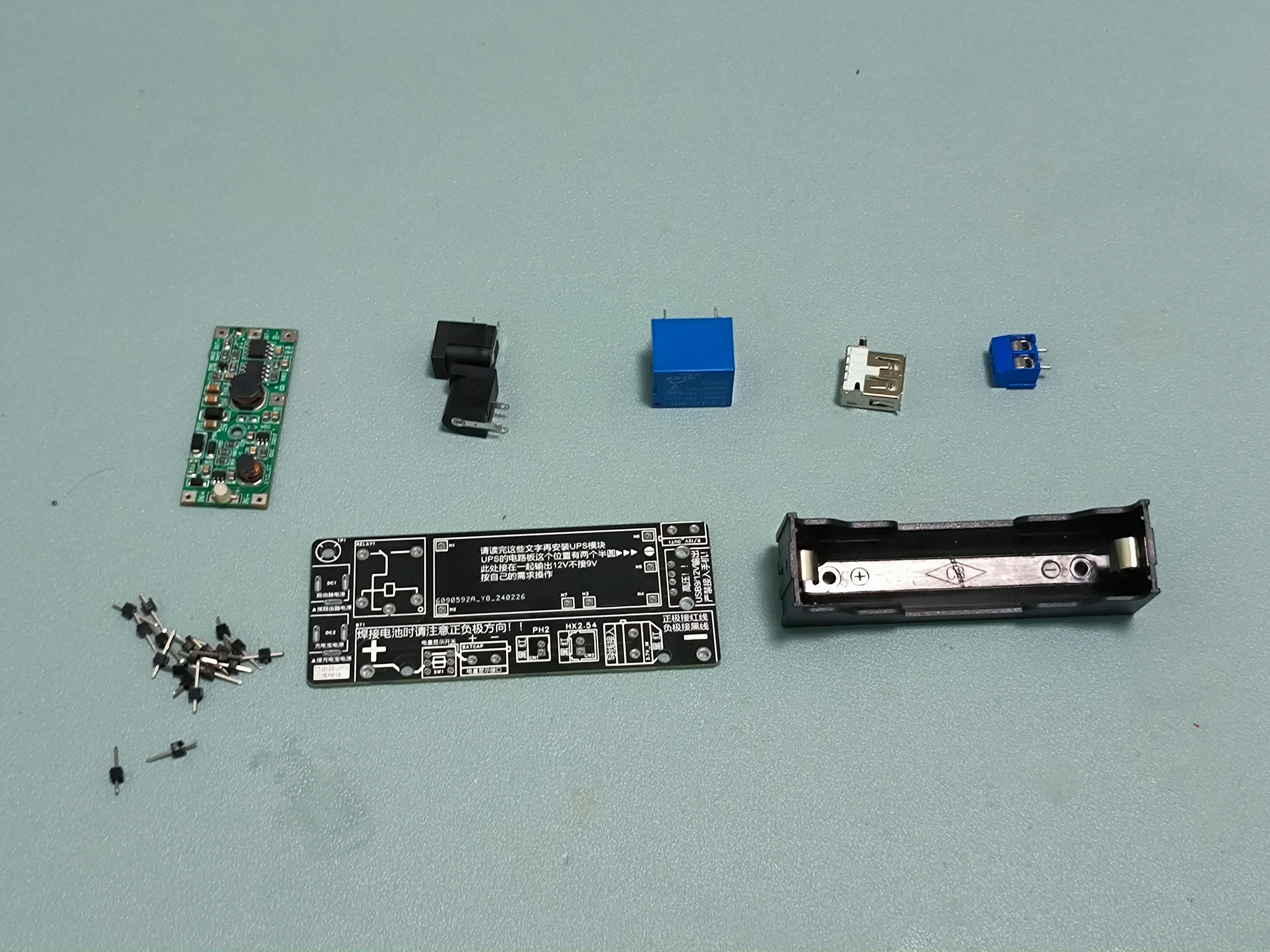

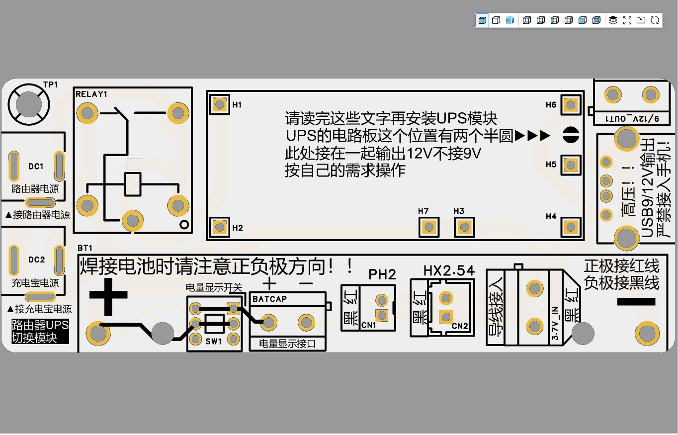

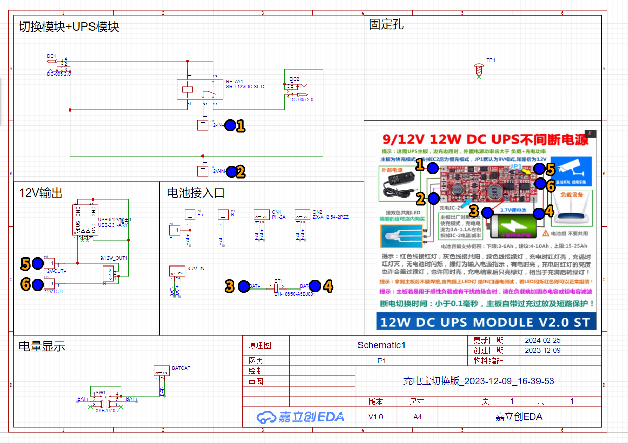

Please refer to the BOM parts in the attached table for
the schematic diagram:

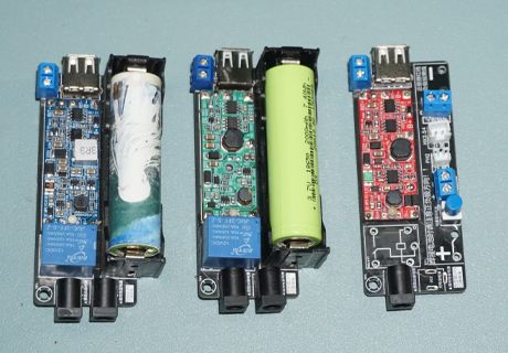

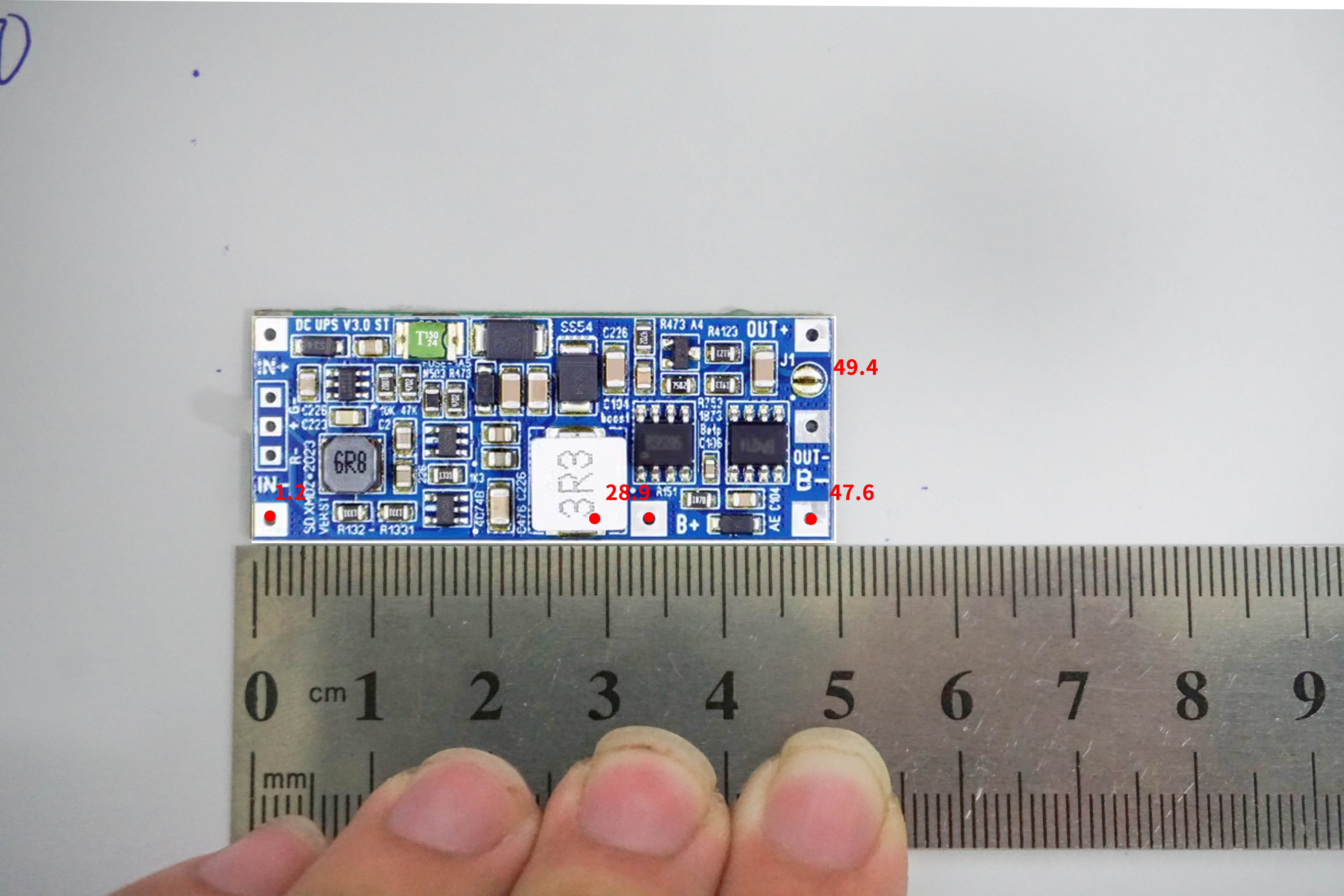

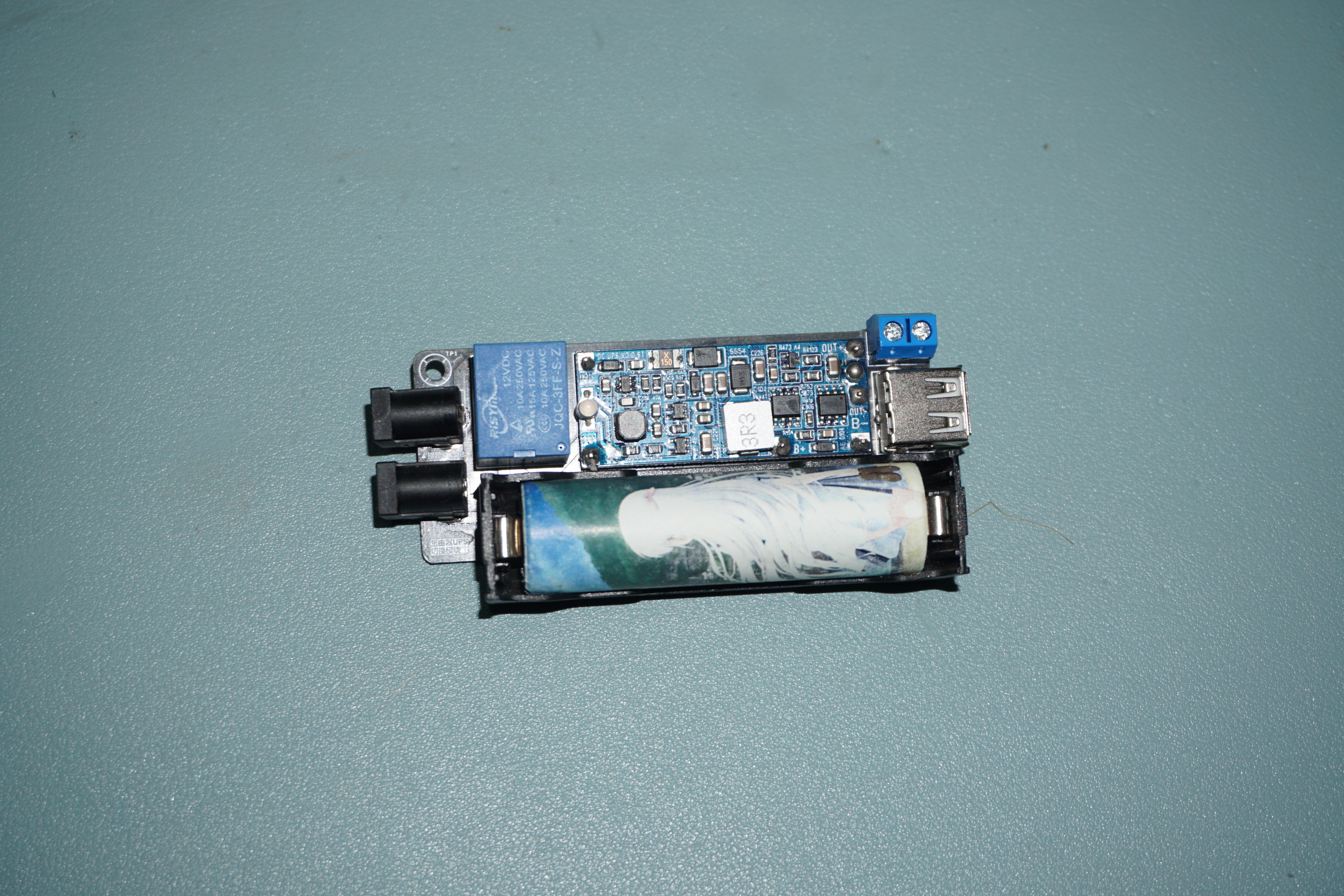

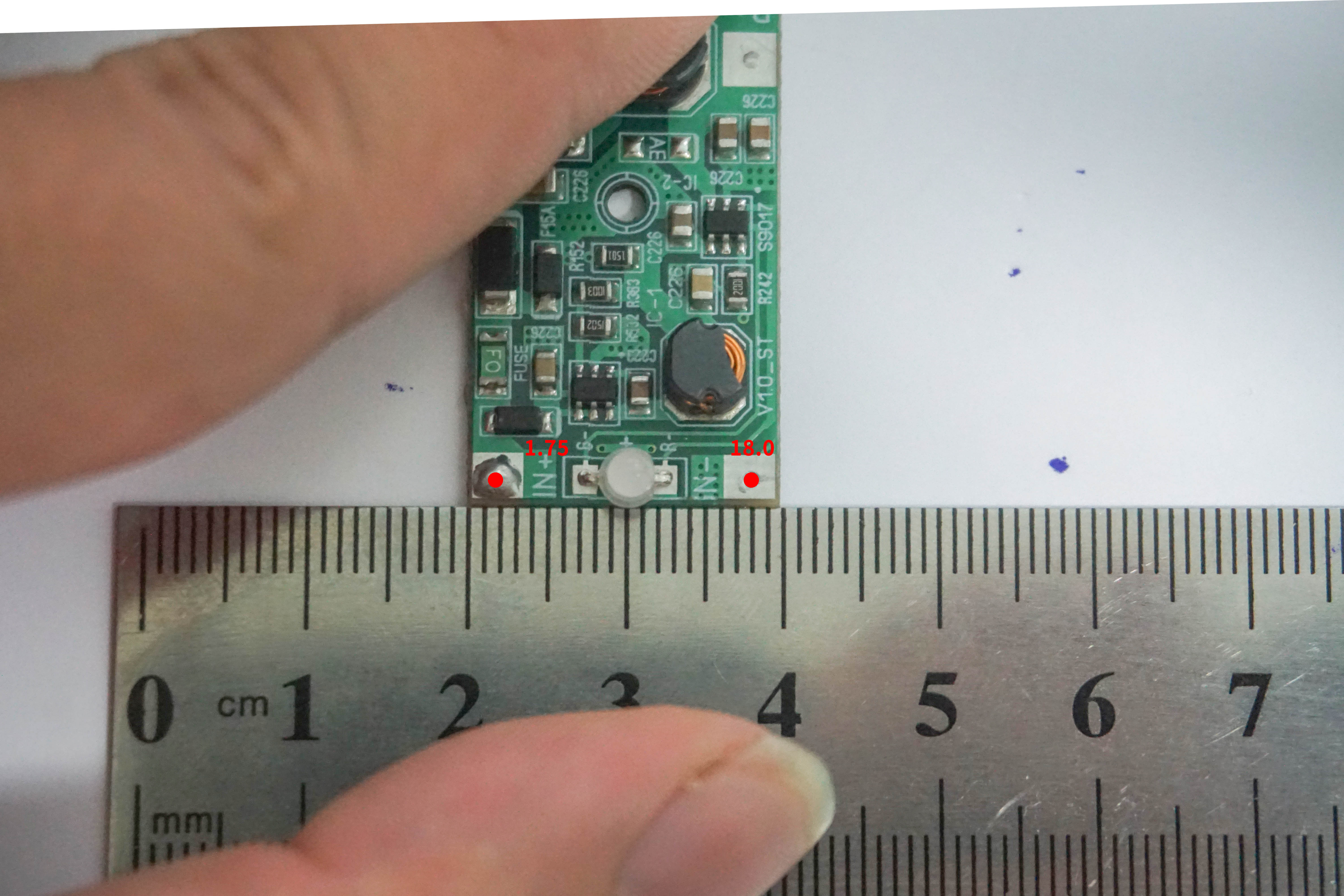

UPS Module Introduction (Purchased Finished Product):
Dimensions:
PCB Appearance:
Actual Photo:

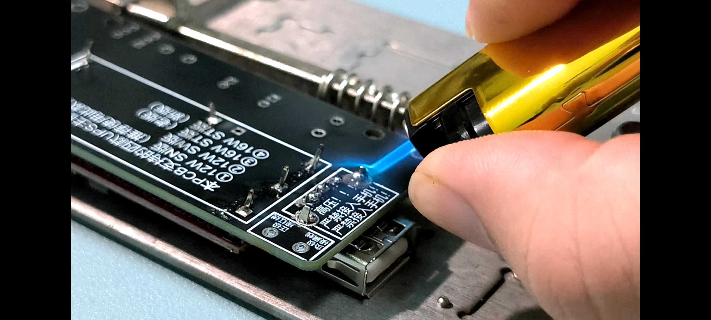

Connection Method:
In the image below, the connection between the power bank and the UPS switching board is a boost cable or decoy cable, not a regular USB to DC 5V converter!

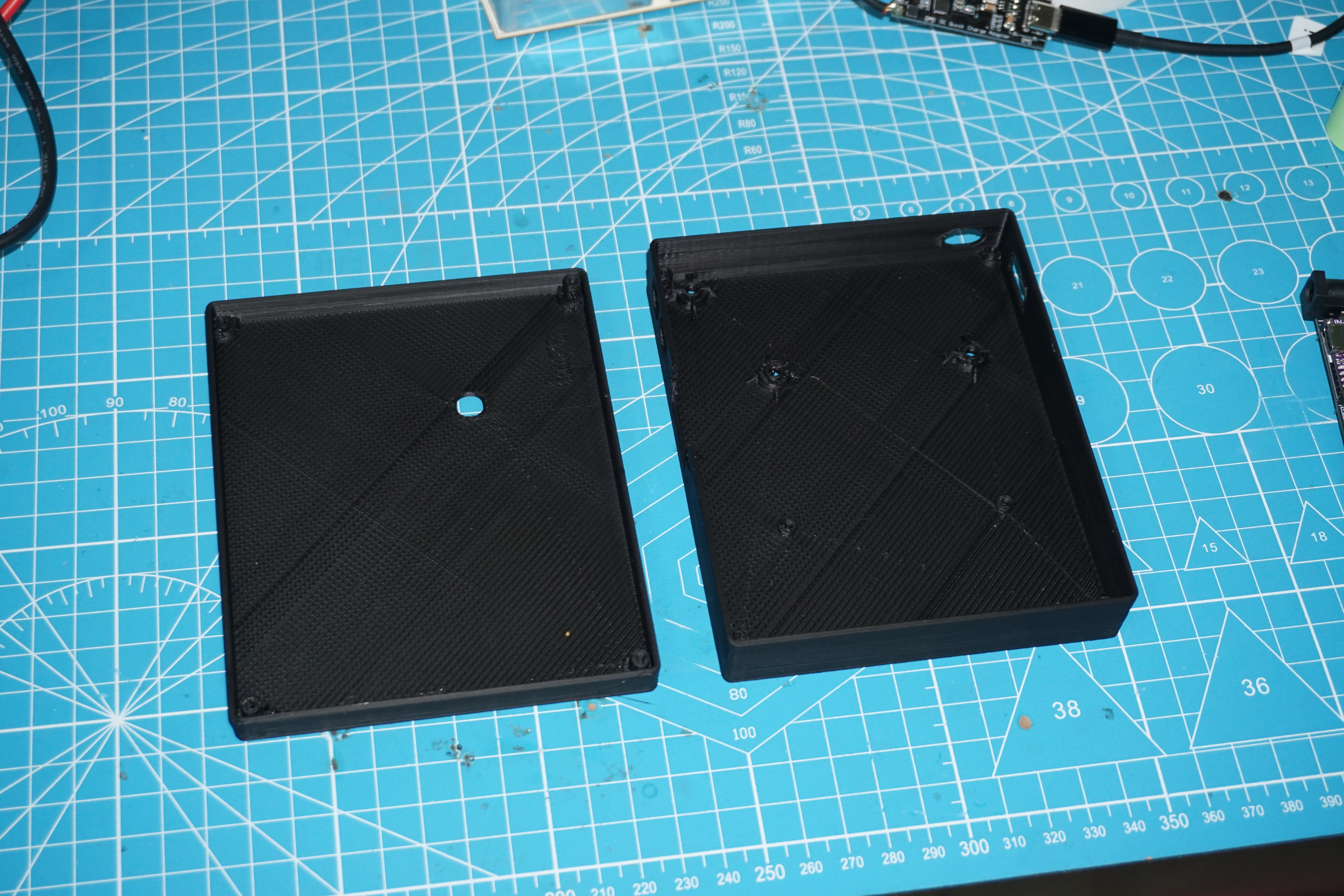

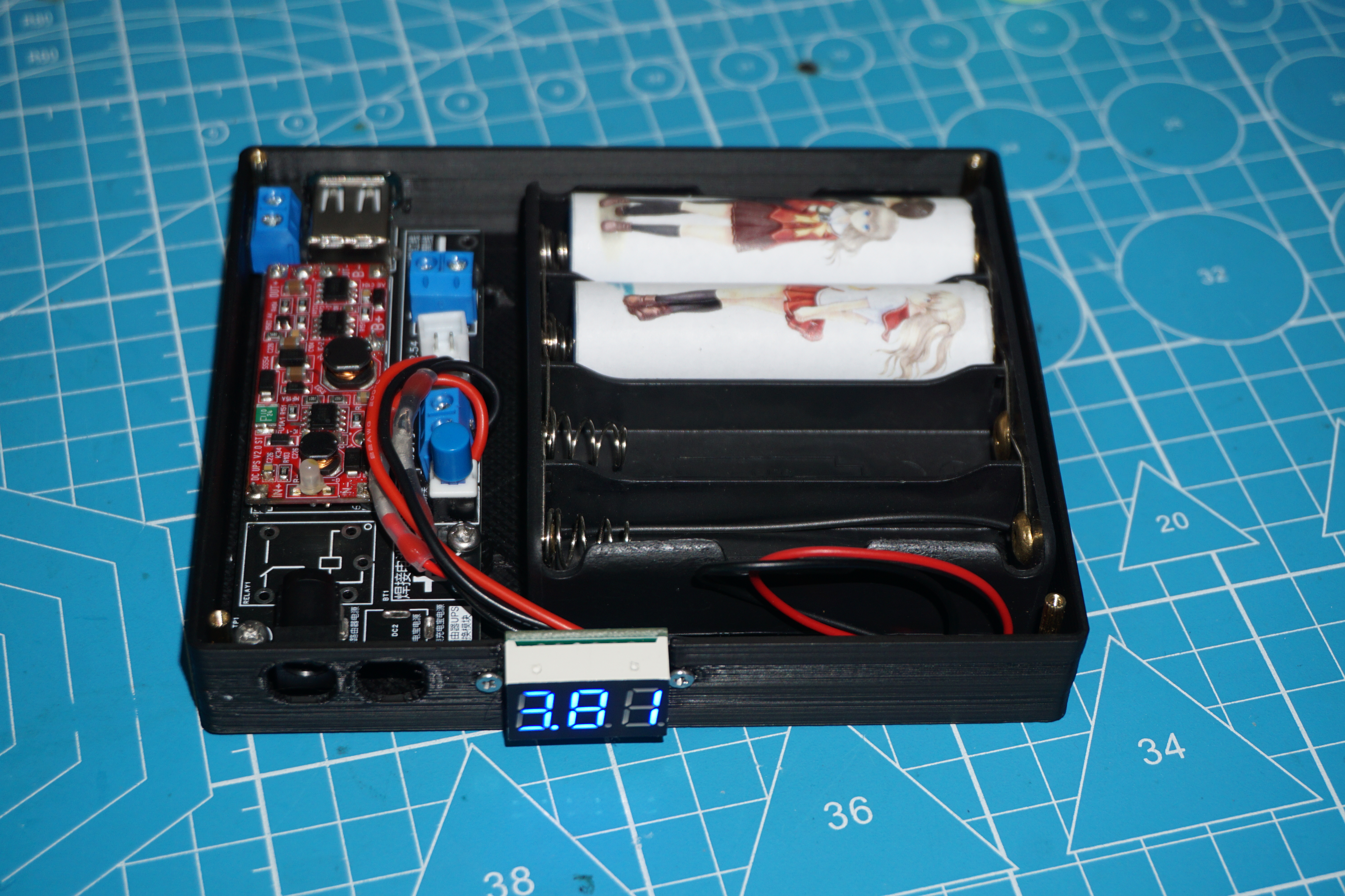

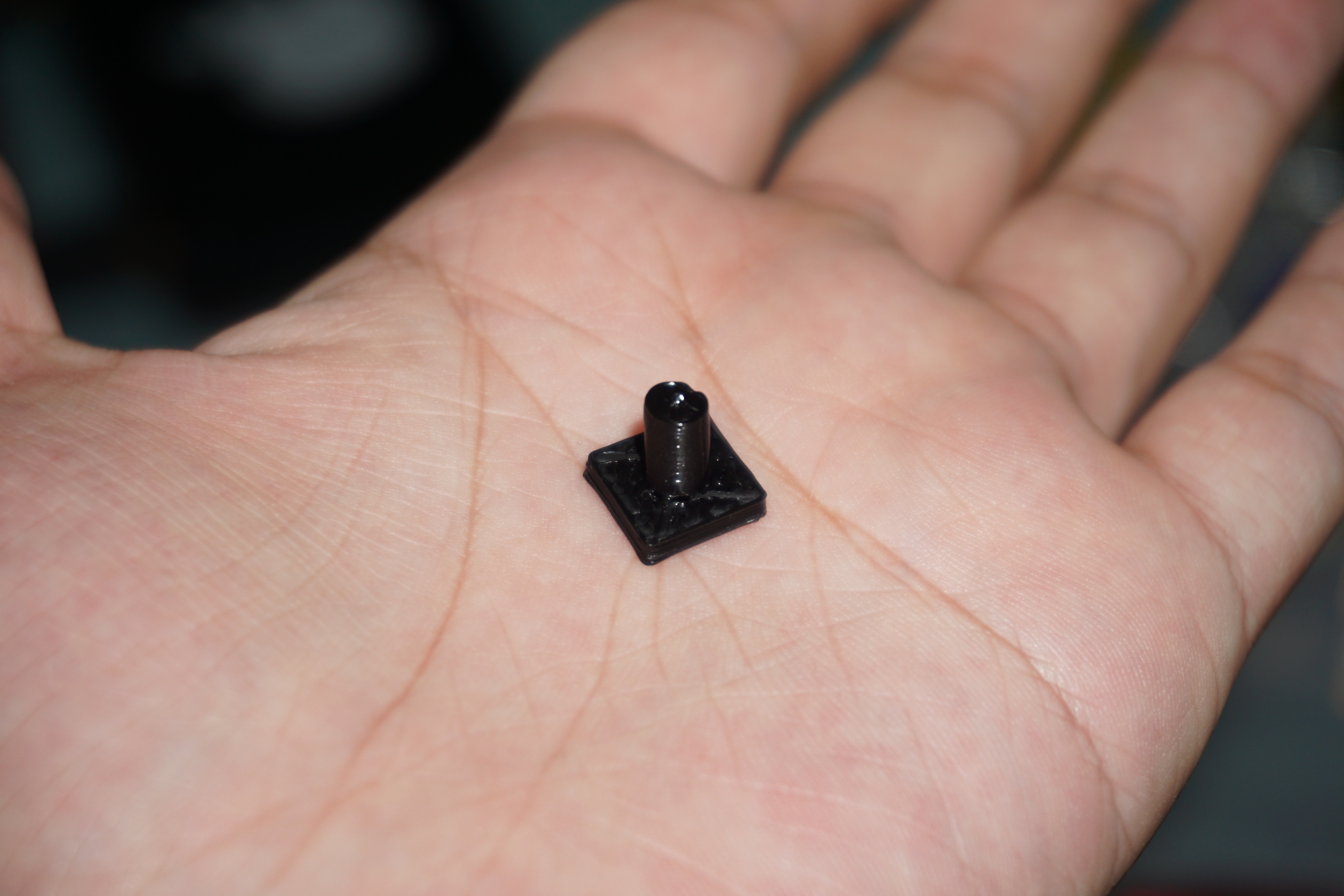

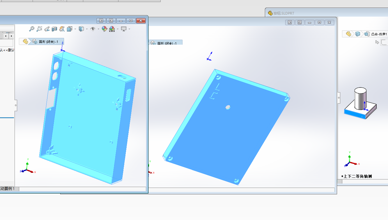

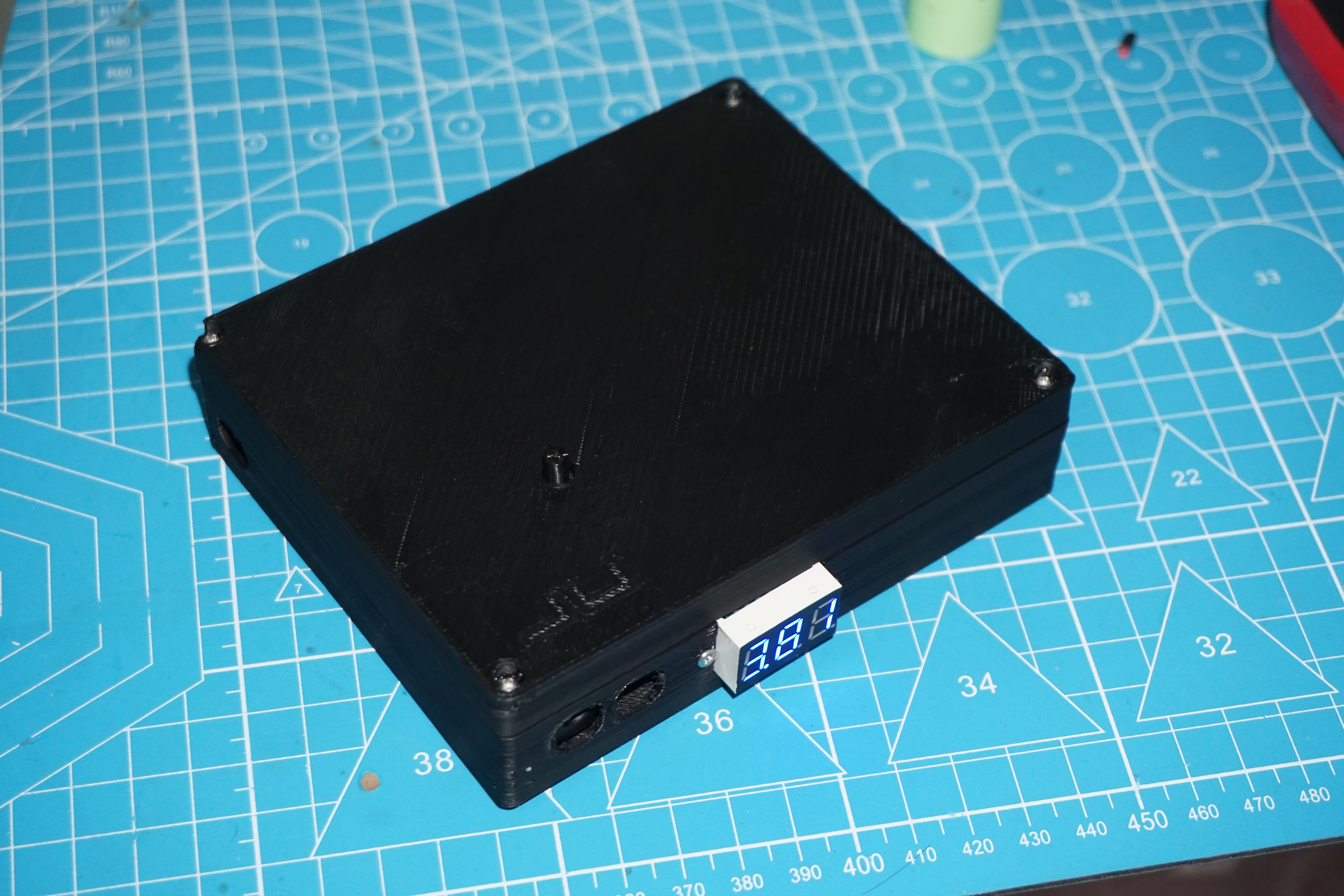

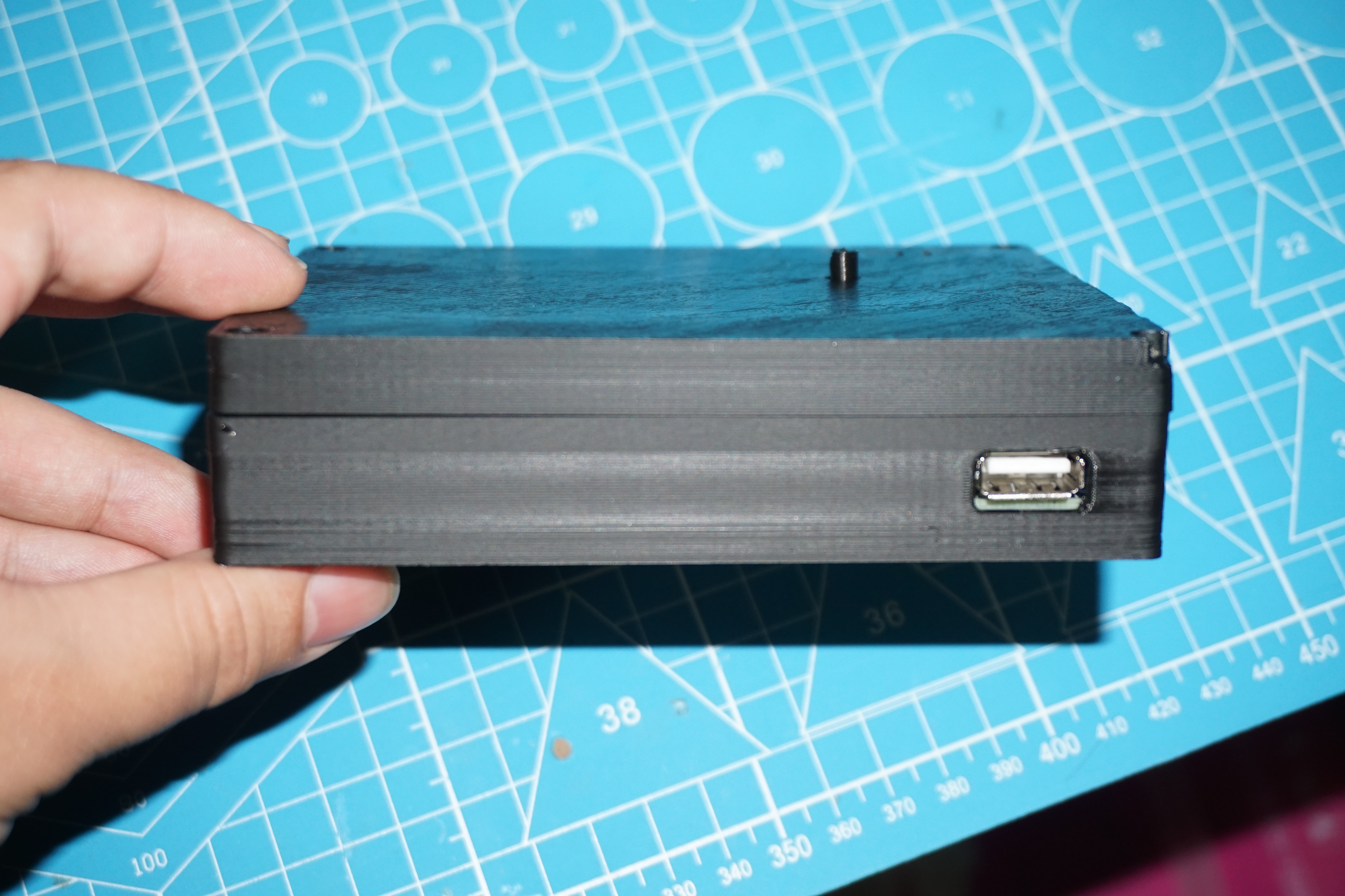

I didn't expect it to actually break 50,000! I gritted my teeth and finished the outer shell in one day. I had to model it and make a prototype for verification. It's usable, but definitely not aesthetically pleasing.
3D printed physical image:
Assembly:
Required screws and nuts:
[3] M3 screws 8mm
[3] M3 nuts
[2] M2 screws 6mm
[2] M2 nuts
[8] M2 screws 12mm
[4] M2 copper pillars 11mm
Finished product
