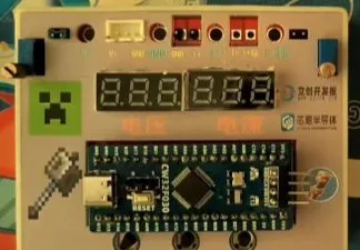

This project is a replica of the CW32 development board training camp project from LCSC. This was my first experience with LCSC's 3D printing and panel services. I also quickly learned how to draw panels using SolidWorks and LCSC EDA in a week. I feel that learning with a goal in mind is much more efficient. The specific selection and CW32 programming are covered in the official documentation, so I won't go into detail here. I'll mainly talk about what's not in the official documentation.

that the code uses a 1ms timer to refresh the digital tube periodically, and
the buttons use CW32's hardware debouncing and interrupts.

Use mean filtering and two-point voltage calibration to calibrate the ADC value.
Automatic switching between high and low ranges: greater than 4.8V switches to high range, less than 4.6V switches to low range. Calibration method:
Voltage calibration
: Press buttons 1 and 2 simultaneously to enter calibration mode. Press button 1 to switch the voltage and current to be calibrated. Insert the jumper cap, use a multimeter to measure the three round holes, adjust the adjustable resistor to 5V, and press the third button to complete one calibration. Similarly, perform 11V calibration.
Current calibration:
Insert a multimeter into holes 1 and
2, and connect the external current to be measured into holes 4 and 3. Adjust the current to 0.5A, and press the third button to complete one calibration. Similarly, perform 1.5A calibration.

Assembly method
: Use a countersunk head self-tapping M3*8.0 screw-in from the back of the panel to fix it.
The attached file includes the Solidworks assembly file and the exported STL 3D printing order file.
The following issues were noted:
The TL431's pinout was reversed, preventing the use of an external reference voltage. [Fixed]
The current sampling resistor lacked copper plating, resulting in insufficient current. [Fixed] The
copper plating method was not selected as fill, but rather the default divergent method, which may burn out under high current. [Fixed]
The Type-C port from the 3D casing appears to be unused; if Type-C power is needed, it's better to directly plug it into the core board.
The panel's slot size lacked sufficient margin, requiring manual enlargement. [Fixed]
The 3D casing's DC power connector slot size lacked sufficient margin. [Fixed]
