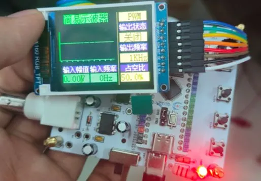

: Use a GD32E230 digital oscilloscope with basic oscilloscope functions to display the detected waveform on an LCD screen.
III. Design Summary:
We use the GD32E230 domestic microcontroller as the main control chip, employing ADC and other functions to process the acquired voltage and display it on an LCD screen.

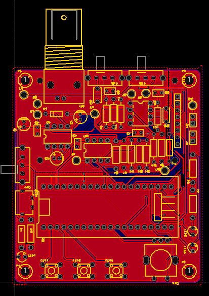

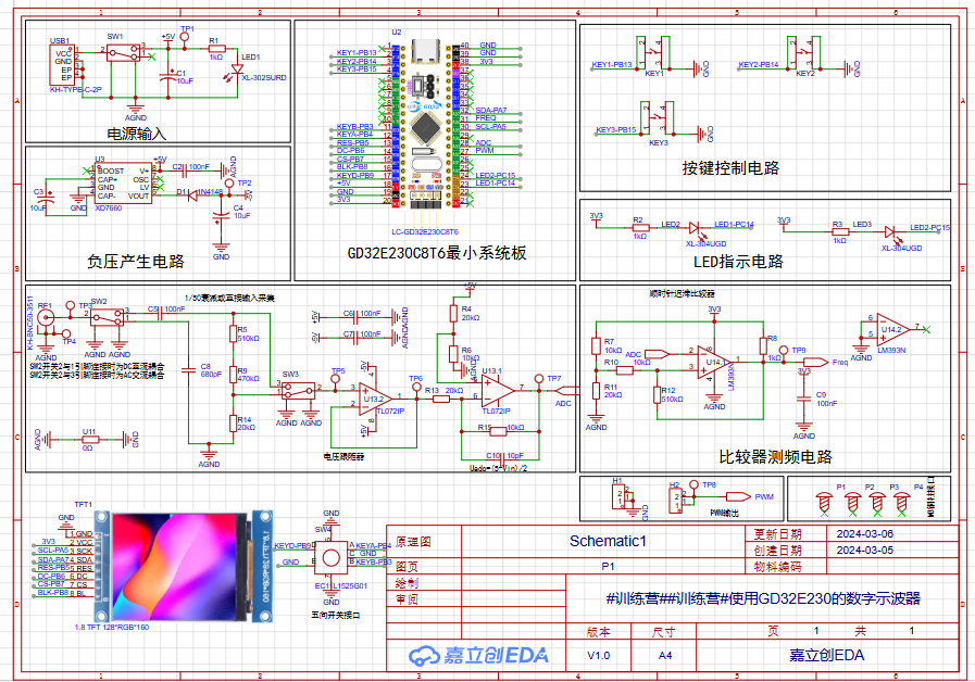

IV. Hardware Circuit Composition

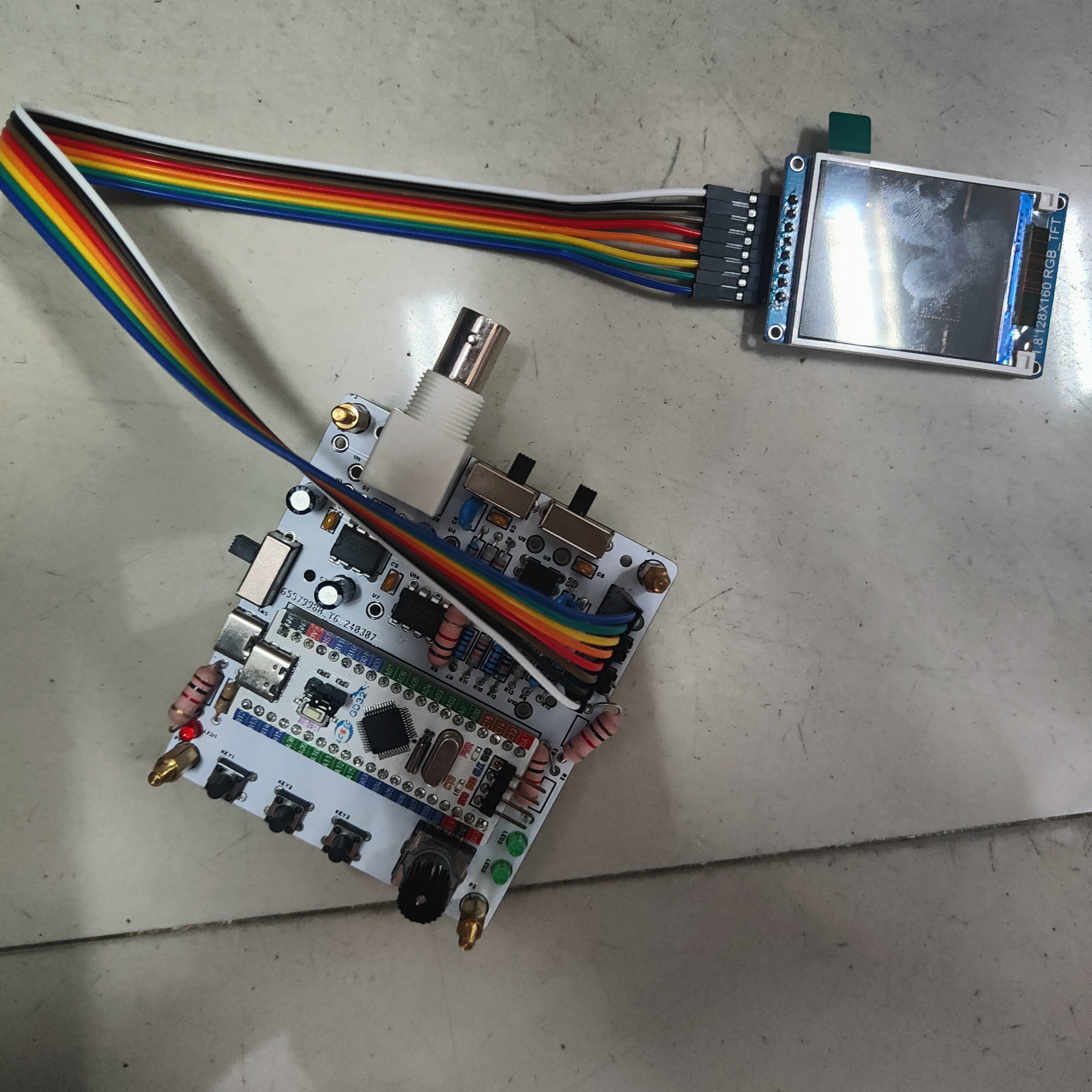

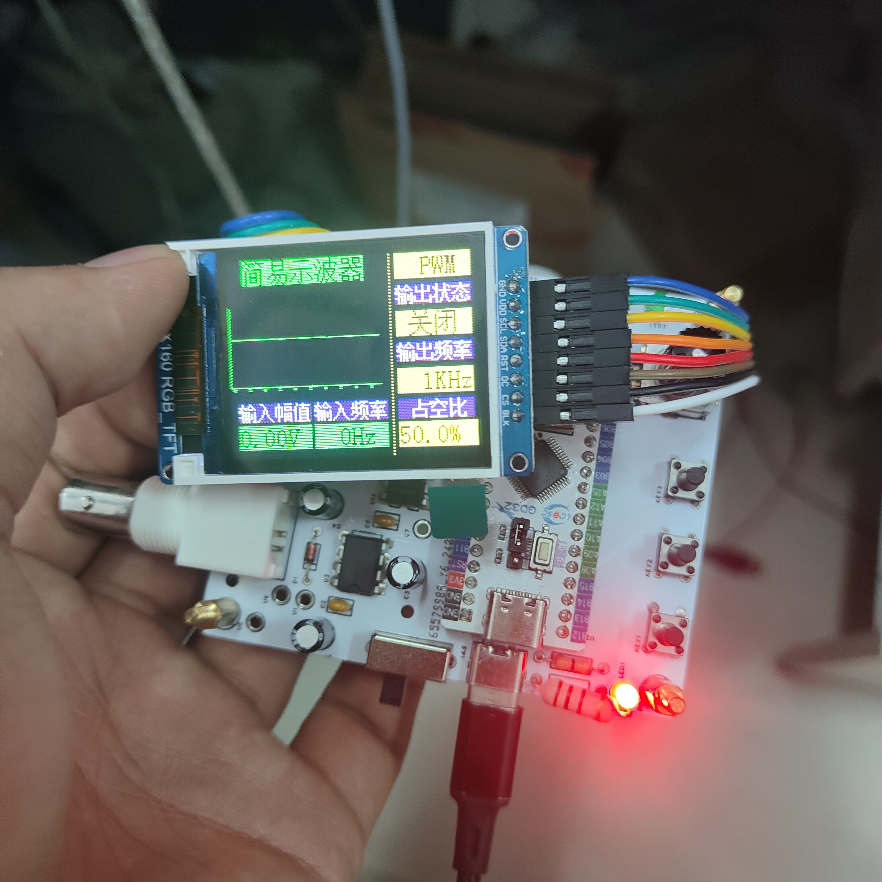

V. Physical Demonstration
VI. Precautions:
Pay attention to the package size of the connectors to avoid hindering soldering.
