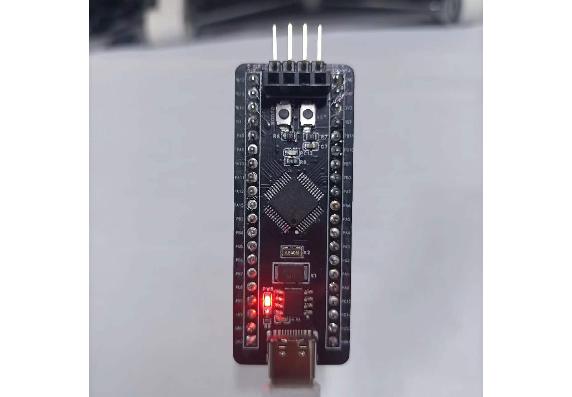

STM32 Minimum System Board
The designed STM32F10C8T6 minimum core board has been verified to achieve all functions. The onboard CH340N is used as a USB to TTL serial port downloader, and STlink can also be used to download programs. In addition, I have added an OLED screen to the board for easy code debugging. The step-down circuit uses the common AMS117 chip to reduce the 5V VBUS voltage of the Type-C to 3.3V for microcontroller power supply.
