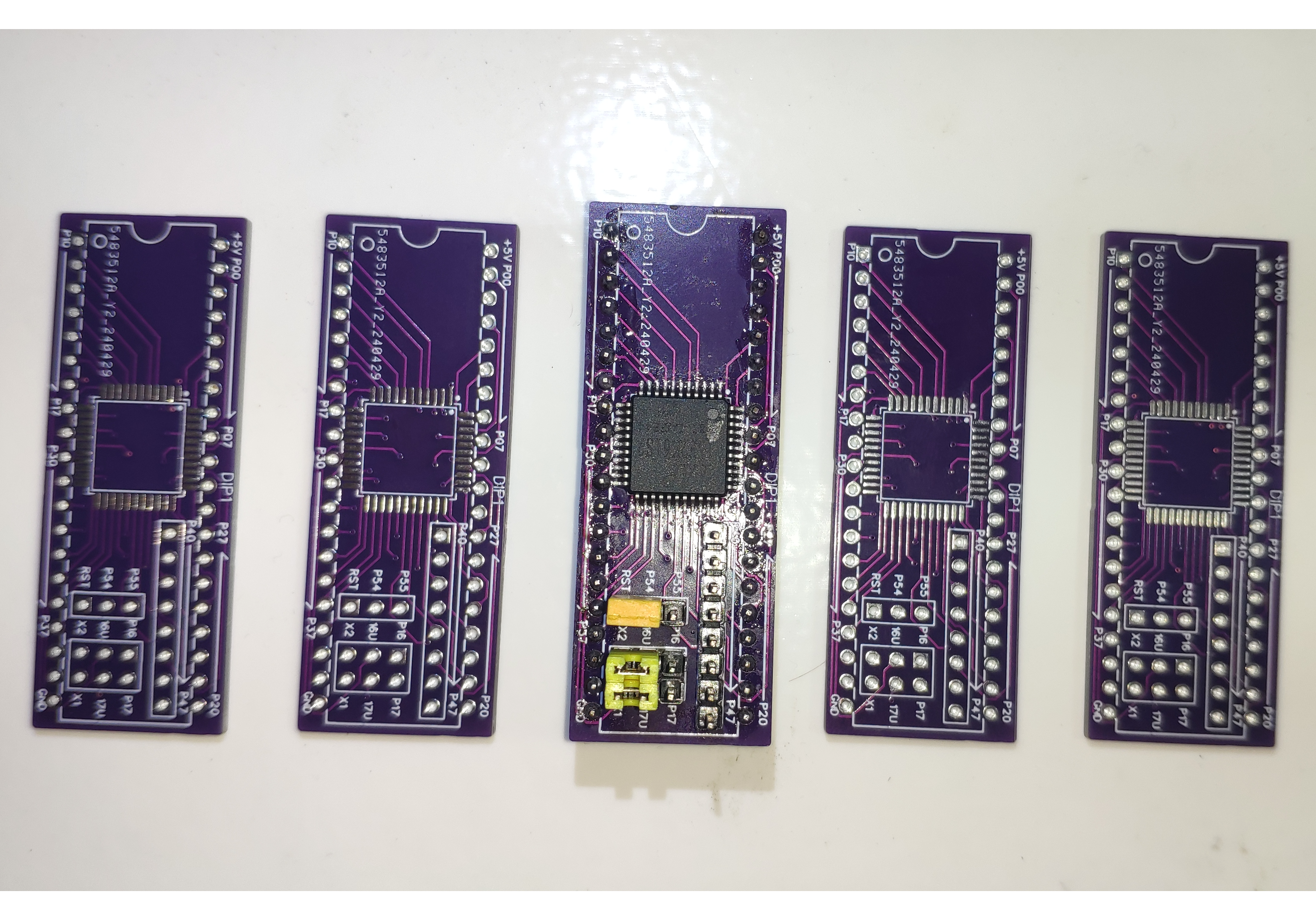

IAP15F2K61S2 LQFP44 to DIP40 Adapter Board
Version Notes - 2024.7.7
1. Added external crystal oscillator selection pins P1.6 and P1.7.
2. Added external reset selection pin P54.
3. DIP40 pins 29, 30, and 31 are left floating; jumpers can be soldered later if needed.
4. The pin definitions are the same for STC15F/STC15W series LQFP44 packages and should also be applicable.
5. V1 is my first board design with absolutely no prior experience; it features automatic routing, no copper plating, and is already fabricated.
6. V2 is a modified version of V1, optimized after watching EDA video tutorials; DRC checked and found no errors; no copper plating; not yet fabricated.
7. I only have a junior high school education, and my work has nothing to do with electronics; I designed this out of hobby in my spare time, hoping it will be helpful to others. Please correct any shortcomings yourself.
Version V1 is already fabricated, tested and downloadable; all I/O LEDs are working.
