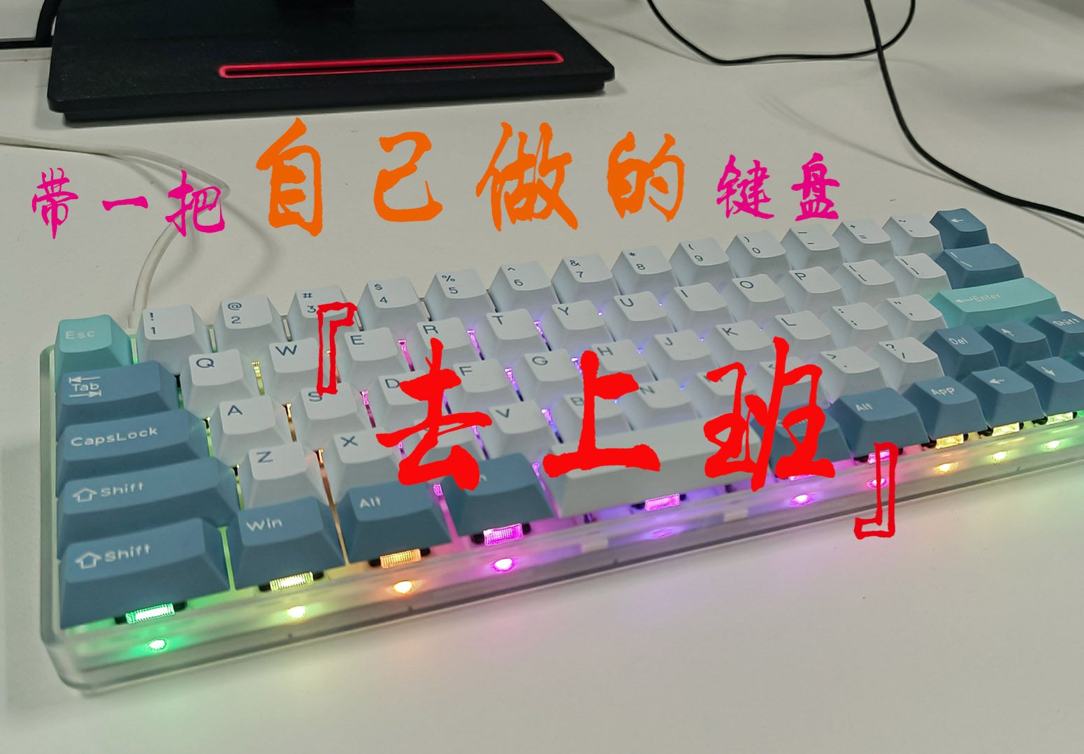

This document introduces
a wired single-mode keyboard based on the STM32F103RBT6, with 60% layout and lower LED positions, using the Vial firmware based on QMK.
For details, please see the Bilibili video: https://www.bilibili.com/video/BV1XH4y1d7i2/
Verification:
The keyboard has been tested and soldered, and has been used for over a month.
Firmware Description :
Bootloader
is attached (generic_boot20_pc13.bin
, downloaded from https://github.com/rogerclarkmelbourne/STM32duino-bootloader ) . Vial configuration
is attached (starlight_rev1_vial.bin)
. Basic Usage: The left and right sides of the large spacebar are layer toggles. After configuring the TAP_DANCE function, clicking triggers the spacebar, long-pressing switches to a layer, double-clicking switches to layer 2, and pressing simultaneously switches to layer 3. Layer 1 is the key combination and FN layer. The arrow keys control the mouse cursor; the left arrow key (Del) triggers a left mouse click, and the right arrow key (Shift) triggers a right mouse click. Layer 2 is the lighting control layer. Layer 3 is a custom macro layer. The buttons in the lower right and upper right corners are VIAL unlock buttons. Note that layer 0 is the default input layer, and the "|" key in layer 1 is the light switch; the light is off by default. The two spaces that appear after programming do not have key codes by default; it is recommended to configure TAP_DANCE or a simple layer switching function. The PCB is compatible with common plastic housings on the market, but due to interference from the bottom light position, part of the bottom support needs to be cut off with tools.
