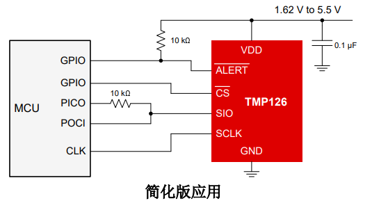

  The project utilizes the TMP126 digital temperature sensor chip. A module was designed based on the chip's datasheet, and its schematic is shown below.

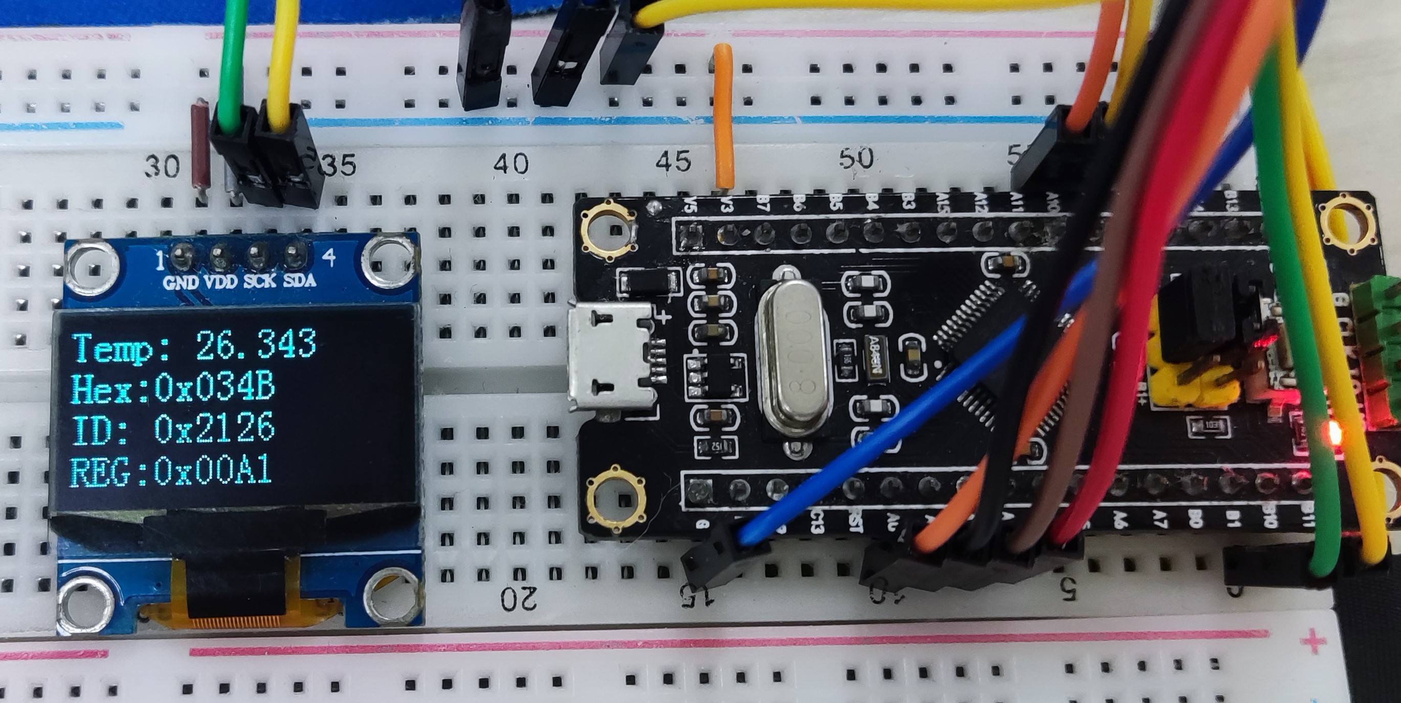

      Since readily available driver code for the TMP126 is scarce online, a driver program for the TMP126 was developed based on the STM32F103C8T6, and the measured temperature is displayed on an OLED screen. To facilitate future development by engineers, the driver code for this project is open-sourced. The wiring diagram for this project is as follows:
TMP126STM32:
       PA0->CS, PA1->CLK, PA2->MOSI, PA3->MISO.
OLEDSTM32:
       PB10->SCL, PB11->SDA.

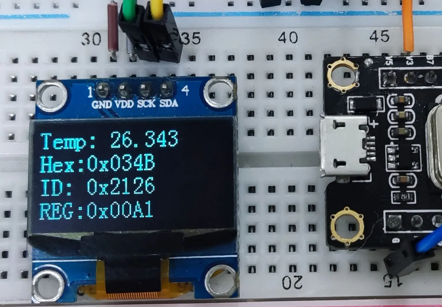

The temperature display effect is as follows:
The first line displays the actual measured temperature, the second line displays the hexadecimal value of the actual measured temperature, the third line displays the read device ID, and the last line displays the value of the TMP126 configuration register.
