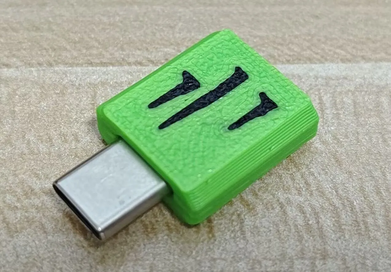

5V/3A Type-C female to male adapter supports USB 2.0
This 5V/3A Type-C female-to-male connector provides compatibility for low-power devices that omit the CC, Rp, and Rd resistors and do not support C2C data lines.
It also connects D+ and D- to support the USB 2.0 communication protocol, allowing some devices requiring communication to use it.
The principle is simple: adding Rp and Rd resistors replaces the low-power devices for communication with the other end.
The housing design and 3D printing files are attached. Note that a pause layer needs to be added when printing the housing for placement on the PCB.
