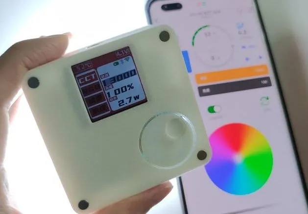

1). CCT Mode: Color temperature supports adjustment from 2700-13000K, brightness: 0-100%. Single-color temperature 3.25W, dual-color temperature 6.5W.
2) RGB Mode: Supports full-color RGB, HSL: 360°, brightness: 0-100%.
3) Simulated Scenes: 11 scenes: lightning, gradient color, candle, flame, police car, ambulance, high power, TV, club, flash, TV.
4) System: Viewable: maximum voltage, current, power, hardware and software version, serial number; adjustable: LED color temperature, screen off time, discharge voltage, maximum power, maximum current, overload protection.
5) Desktop network clock, automatically switches themes.
Actual product image below:

1. Note the soldering direction of the 2835 LED beads: horizontal for cool light and vertical for warm light.
2. Note the pin direction of the 2812; the direction alternates horizontally.
