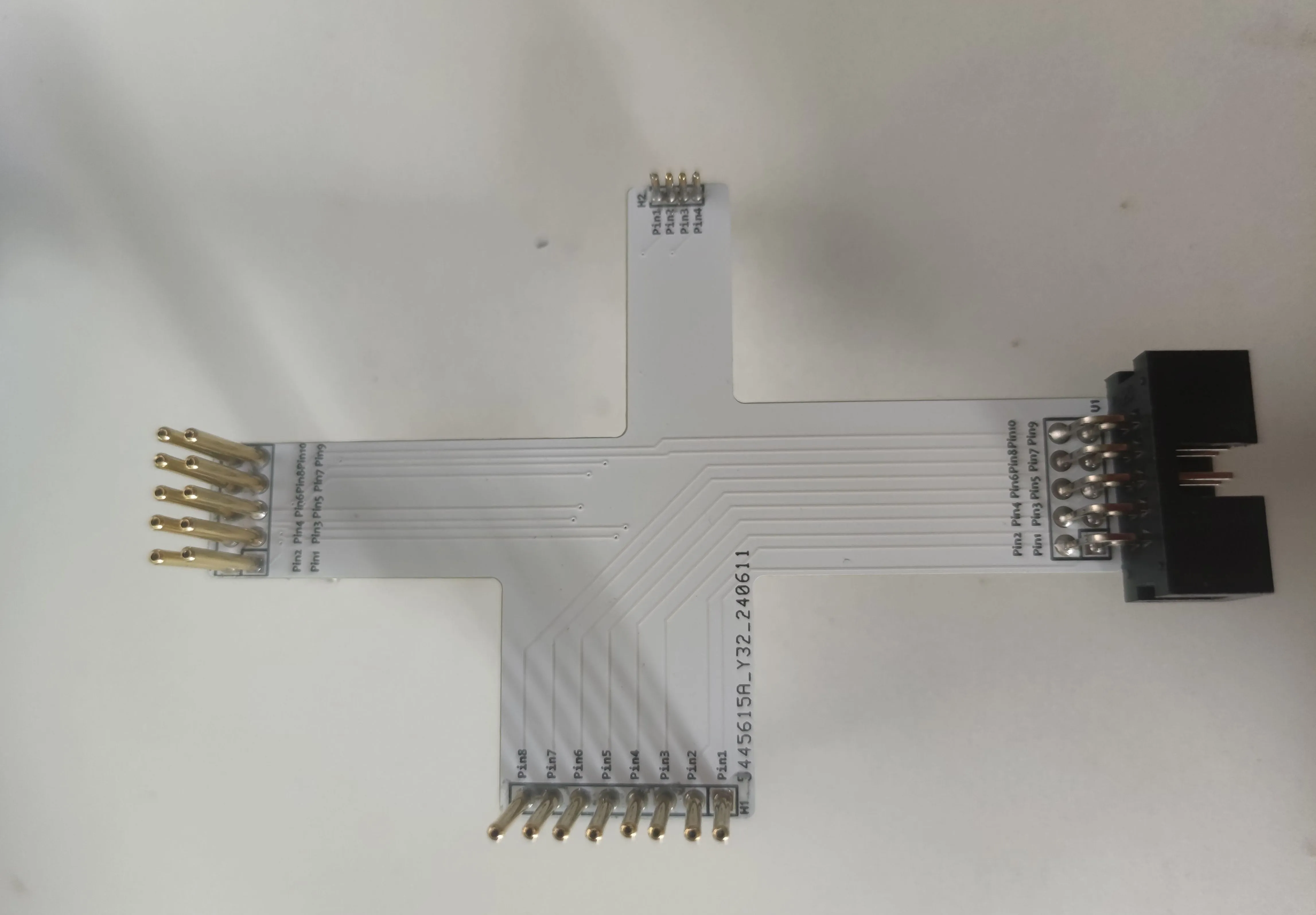

Programming probes - commonly used pitch 2.54mm and 1.27mm for 4-pin probes.
I modified the probe hole size to perfectly fit the
10-pin probe with a 2.54mm pitch,
the 4-pin probe with a 1.27mm pitch , and the 8-pin probe with a 2.54mm
pitch .
Materials (Youxin Electronics)
total price 8.55 yuan.
Buy 2 packs of P100-E2 probes (90-degree umbrella tip), you'll need 18.
Buy 1 pack of P50-B1 probes (0# pointed tip), you'll need 4. One
DC3-10PL bent pin is needed, 5 cents each.
Finished product display.
Other instructions:
Tried it and successfully burned the Skystar GD32.
