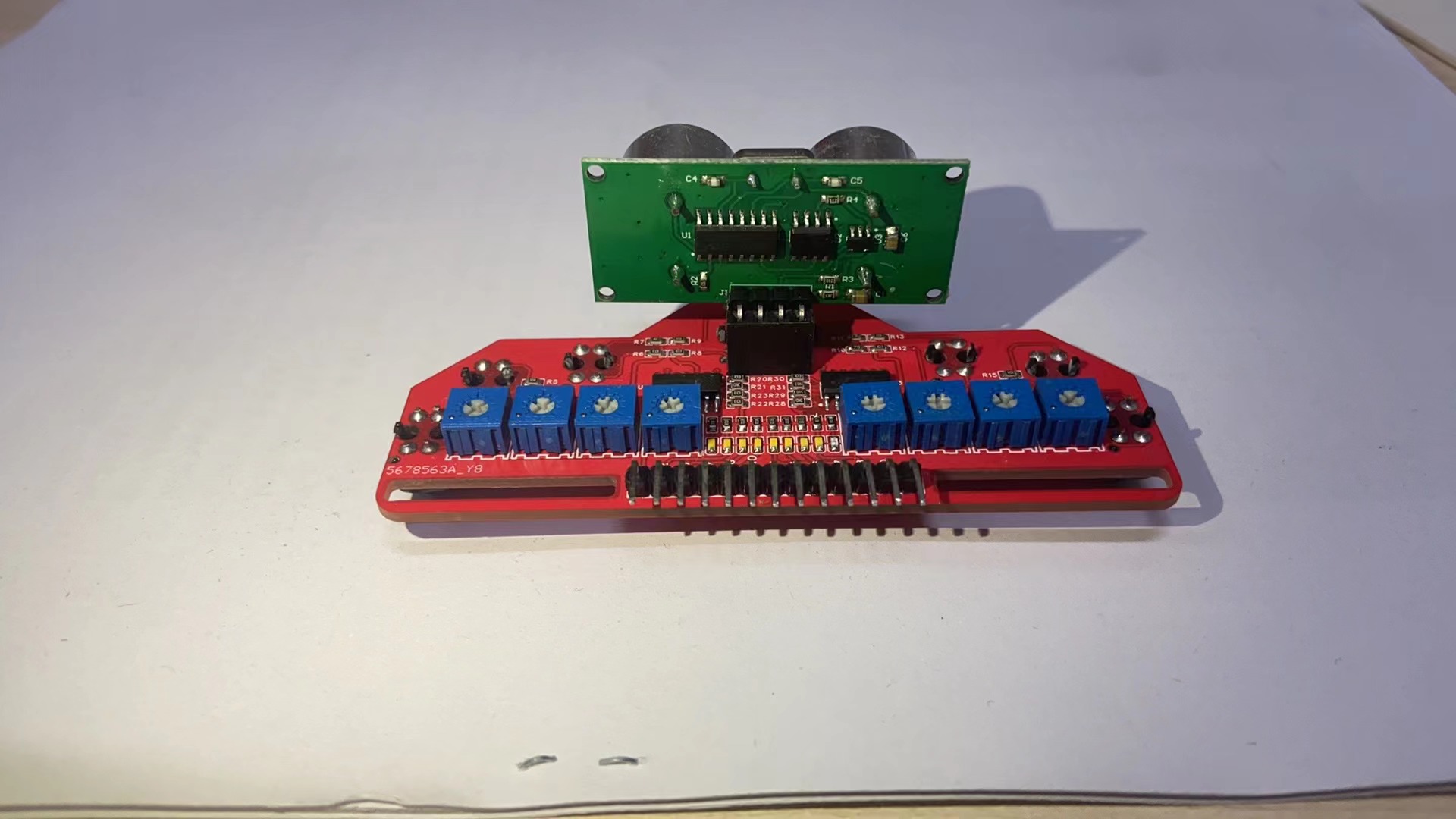

The eight-channel infrared tracking light is fully lit upon power-up, but turns off when the tracking sensor detects a black line. This differs from other products on the market. My suggestion is to change it so that the light illuminates when a black line is detected and turns off when detected. This is a hardware bug; please be aware of this if you adopt this project.
The potentiometer for adjusting the infrared light could be a rotary type, but it's more expensive; consider the application requirements.

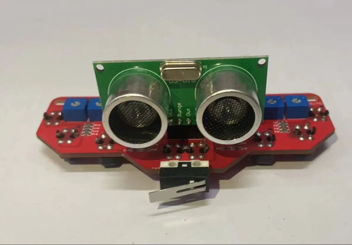

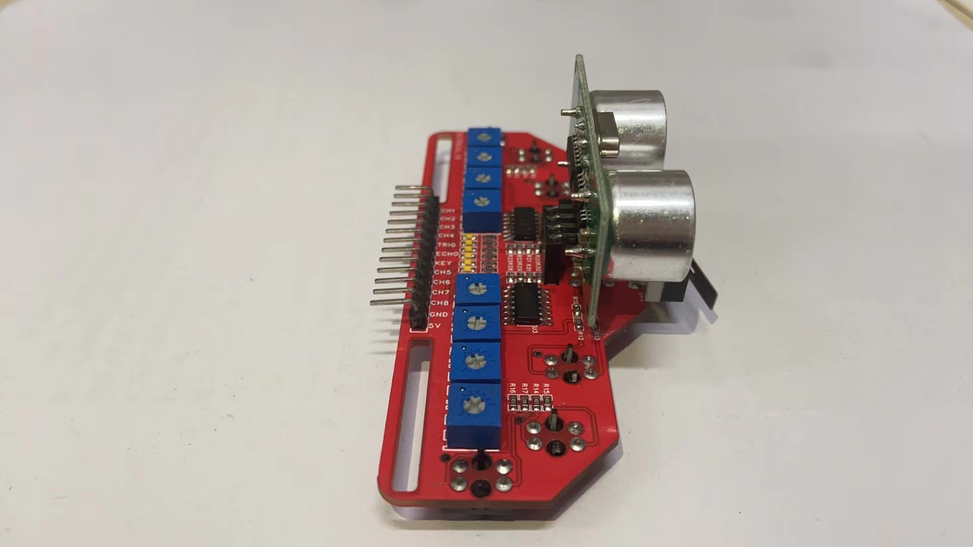

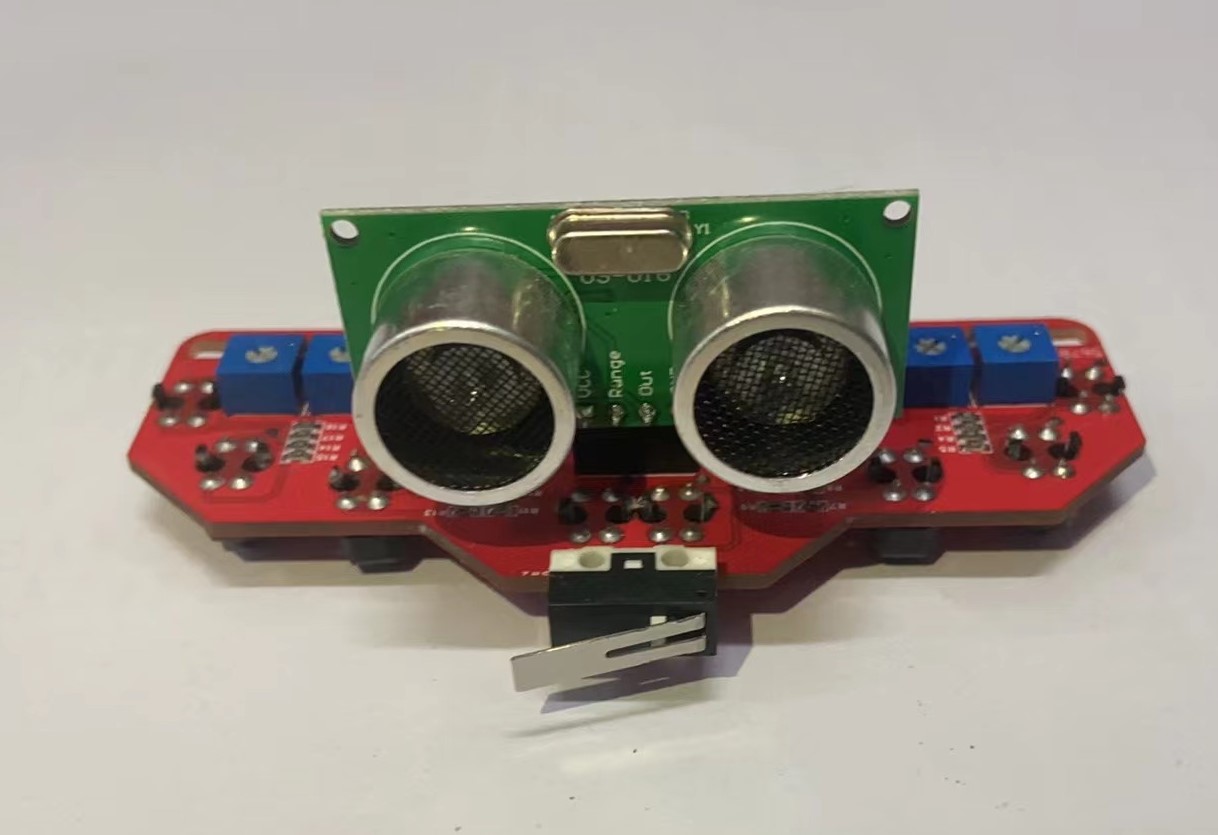

This is a multi-functional sensor expansion board with ultrasonic obstacle avoidance, infrared tracking, and impact detection. All pins are brought out, and it uses a 5V power supply.
Project Functions:

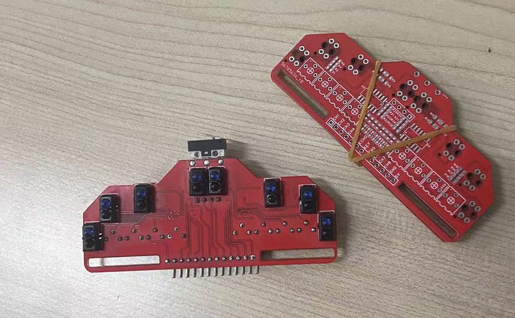

An eight-channel infrared tracking sensor, symmetrically designed for easy detection of black lines, is used for tracking
. An HC-SR04 ultrasonic interface can be plugged in to measure distance. This allows the car to follow people or avoid obstacles.
Impact detection can be used for limit functions; of course, I'm thinking of impact detection, but it could also be used for other functions.
