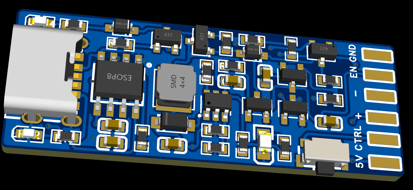

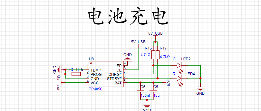

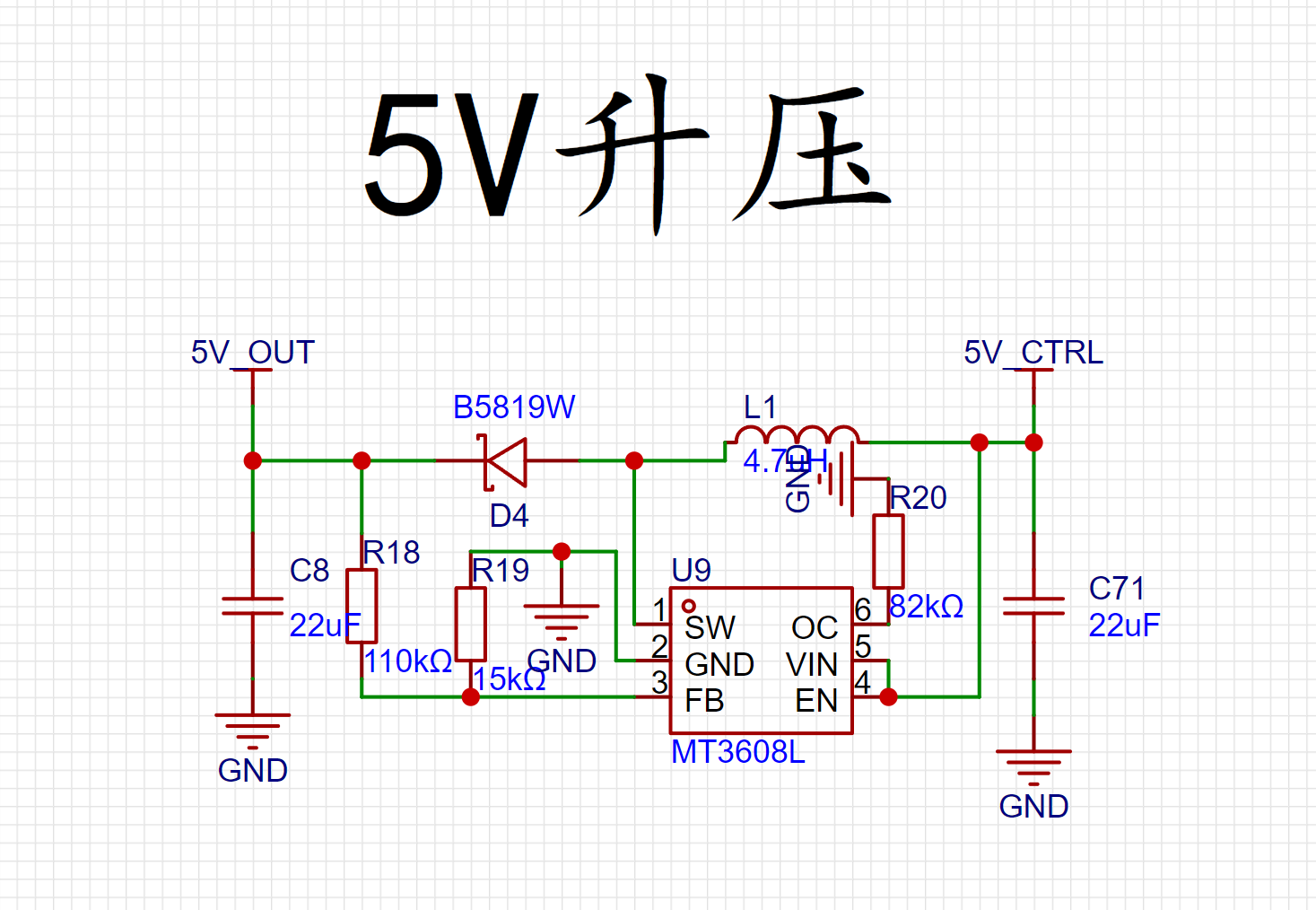

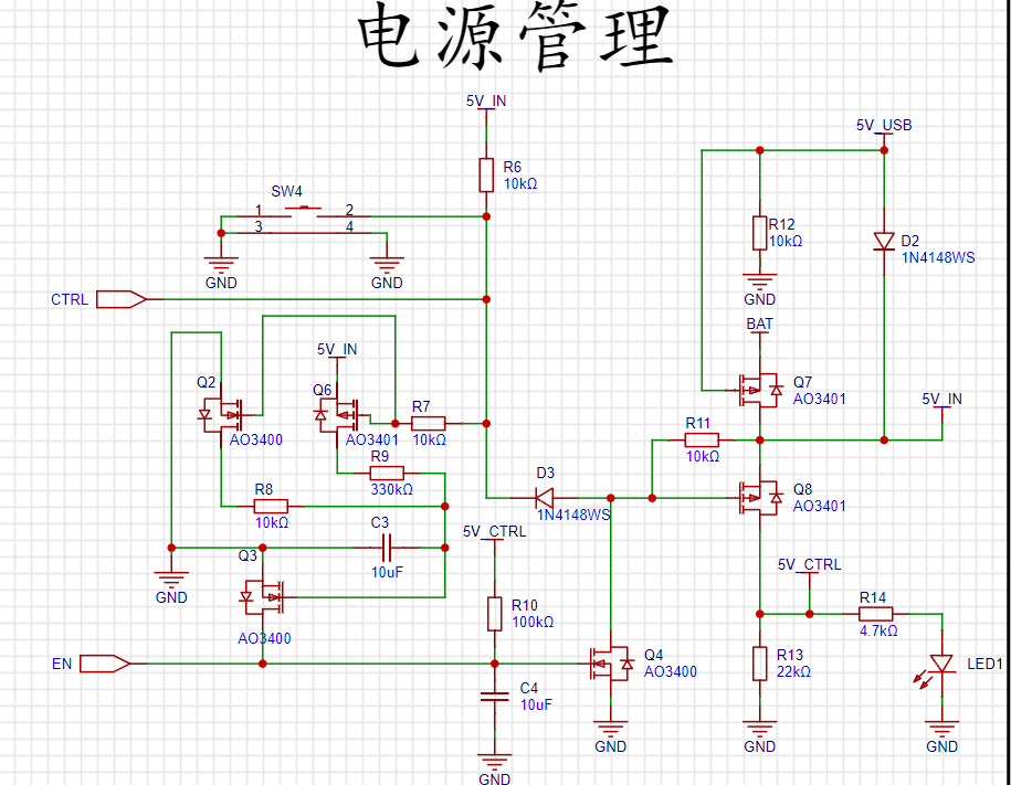

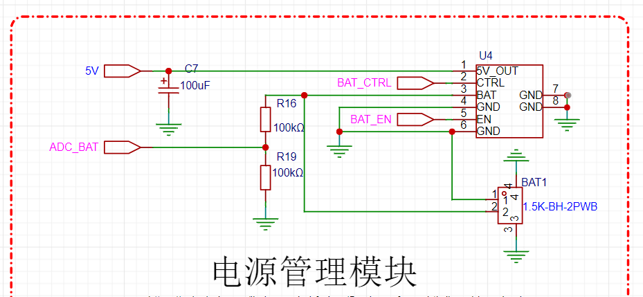

1. Power Supply Circuit Design
  : Consulting the microcontroller schematic and chip manual, the Liangshanpai microcontroller supports 5V power supply, while other chips and peripherals are compatible with both 5V and 3V3 power supplies. A single 3.7V 300mAh lithium battery is selected for power supply. A 5V boost circuit boosts the voltage to 5V, which is then supplied to the entire game console system via the battery management circuit and lithium battery charging circuit. Using a built-in battery makes the game console portable and usable anytime, anywhere. The MT3608L high-efficiency boost chip provides a stable 5V output.

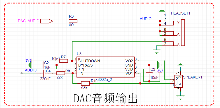

3. Audio Output Circuit Design:
  The design incorporates a headphone jack and speaker output, satisfying both external sound output needs and allowing for headphone insertion. It is quiet, simple, and allows for easy switching. The circuit uses a microcontroller DAC for analog output, making driving convenient and simple.

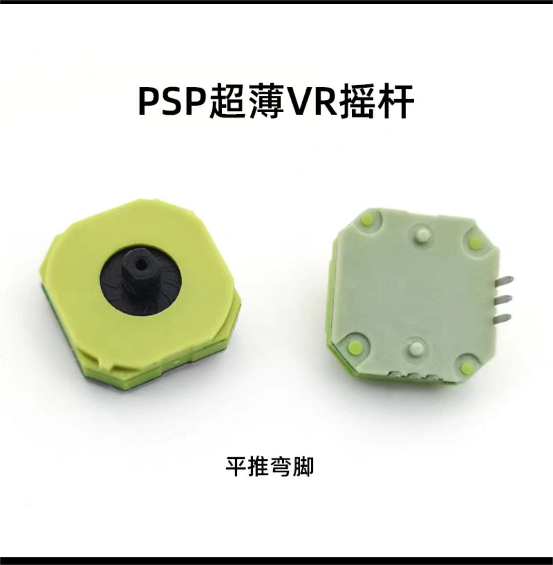

4. Directional control joystick circuit design.

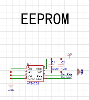

5. Storage circuit design:
  A good game console needs to support various types of games, requiring sufficient memory. EEPROM is chosen because it has large capacity, fast storage, and simple driver operation.

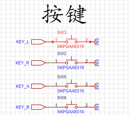

6. Button circuit design
  : Design buttons to simulate action buttons in various games and to switch functions of the game console.

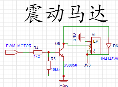

7. Vibration circuit design:
  Implement a vibration motor to achieve the feedback effect of the game console.
8. Battery detection circuit:
  The power supply is connected to the microcontroller pin through a resistor divider. The ADC function is used to monitor the battery level.

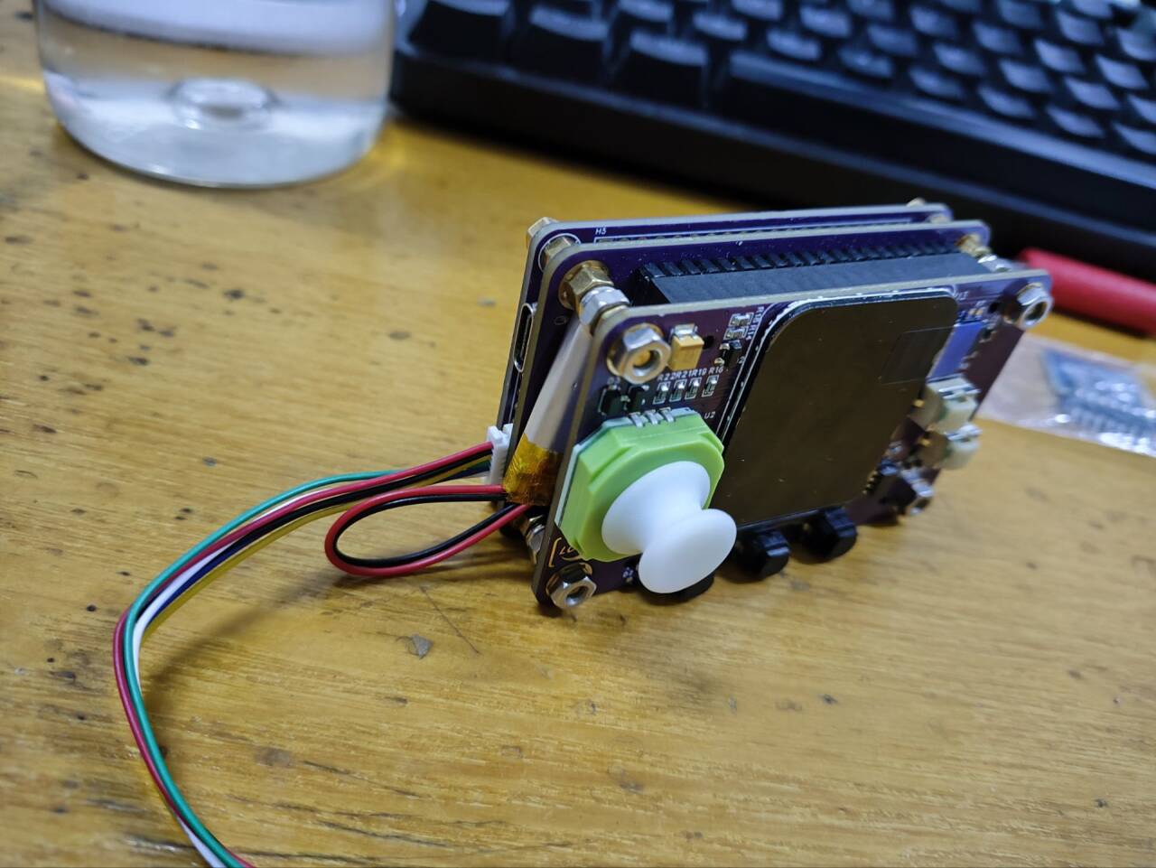

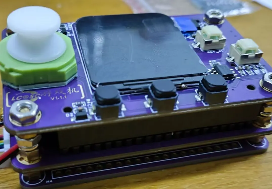

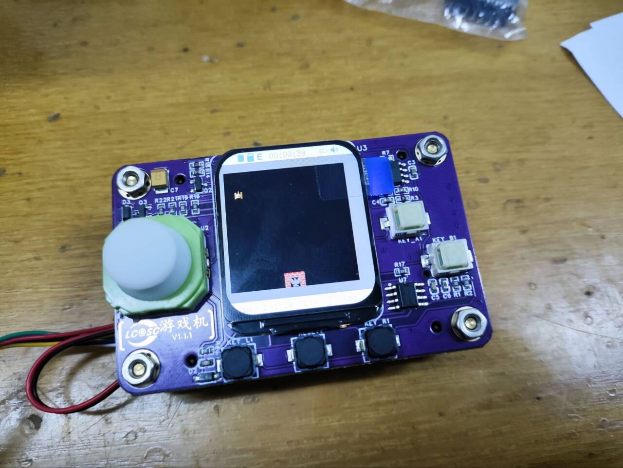

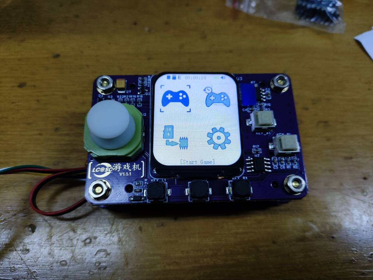

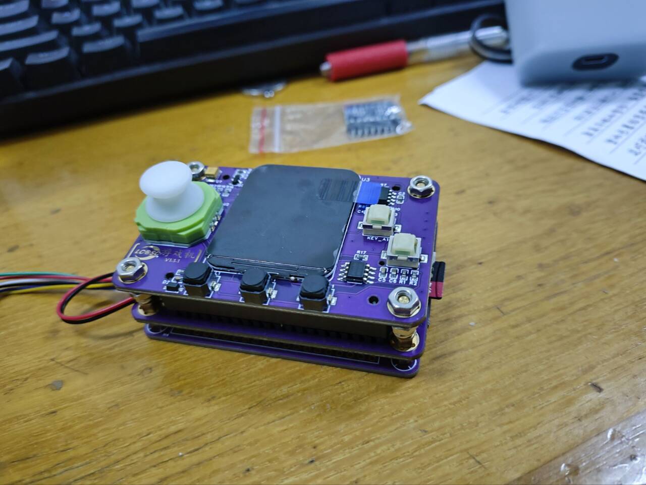

physical image.
1. Learning objectives: Familiarize yourself with the development process of embedded projects, and master the ability to design a game console hardware circuit, software programming, and system debugging.
2. Function Introduction:
Displays game content on LCD;
controls character movement using five buttons; allows
independent button control for character actions;
includes sound output;
saves game data via flash memory;
3.7V lithium battery charging and discharging management.

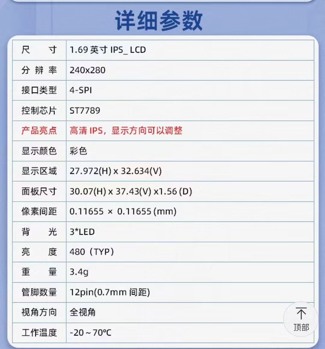

2.4 SPI Protocol and LCD Driver:
In-depth study of the SPI communication protocol and its application in LCD drivers. 2.5 Image Extraction and UI Interface Creation: Learn image extraction methods and convert images to a format displayable on the LCD. Use graphic design software (such as Photoshop, GIMP, etc.) to create the
