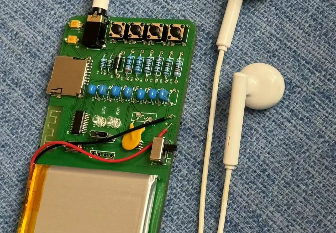

Hand-welded MP3 Bluetooth music player
This is a multimedia player developed based on the JL AC6955F, supporting Bluetooth 5.1 and SD card playback.
It utilizes as many plugins as possible for easier hand soldering.
Based on this user's schematic, here's a link: Bluetooth 5.1 Lossless Audio Player
The JL AC6955F was purchased from Taobao and already includes the program. The matching crystal oscillator is a 49SMD, also sold in the same store.
The battery measures 34 x 50 mm and is attached to the left side of the board with double-sided tape.
The four function buttons are: 1. Switch between Bluetooth/TF card, 2. Next track/Long press volume up, 3. Play/Pause, 4. Previous track/Long press volume down.
The headphone jack, capacitors, and other components can also be replaced with plugins for easier hand soldering. Since I already had these in stock, I didn't modify them.
