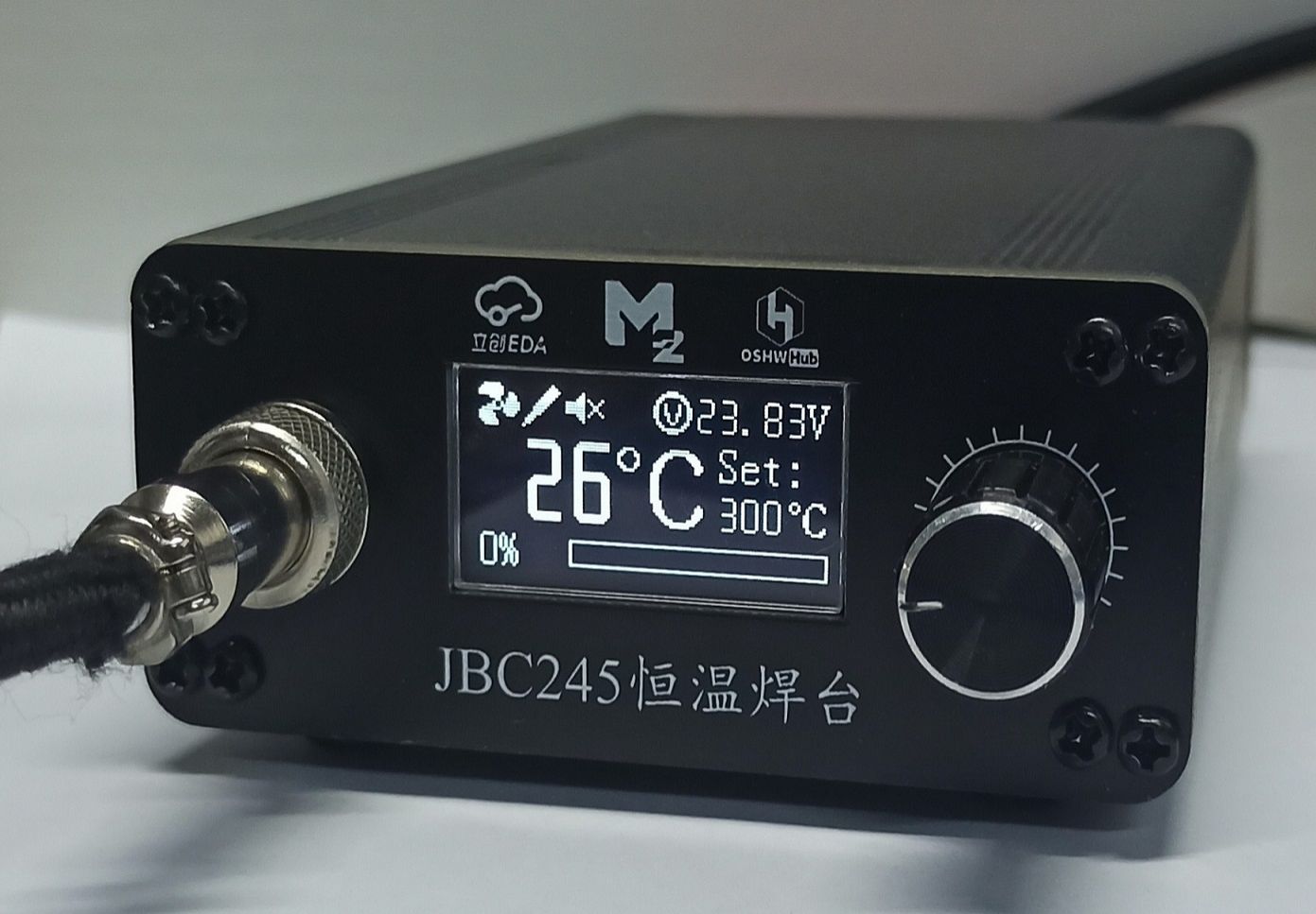

3. Main control board assembly
Use M3*4 screws and M3*5 double-pass copper pillars to fix the OLED screen, and then solder the OLED pins;
At this time, power on and test to see if the screen can light up. If not, please check the welding. If it lights up, please continue;
Take out the front panel and use 502 to glue a 33mmX17mm transparent acrylic on the middle opening. You can fix the acrylic with high-temperature tape first and then stick it. When fixing, only leave the seam. The rest of the acrylic and panel are glued with high-temperature tape to protect it. Acrylic and panel; (If you don’t have acrylic, you can skip this step)
Fix the GX12-5 and rotary encoder on the front panel, pay attention to the bulge inside the GX12-5 male socket, facing downward;
Use M3*6 screws and M3*9 double-pass copper posts to connect the front panel and main control board;
Solder the pins of GX12-5 and rotary encoder.

4. Physical display
4.1 Picture of soldering station
