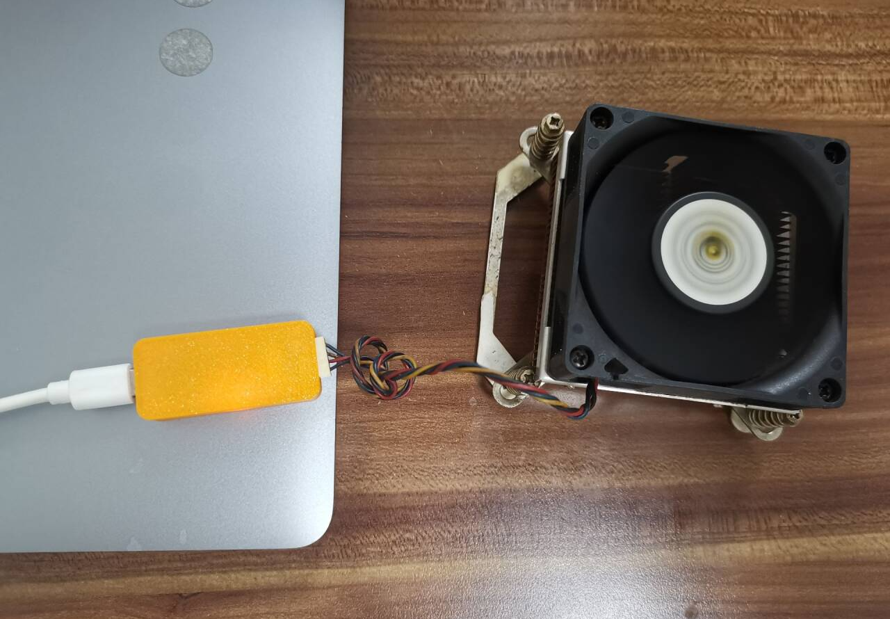

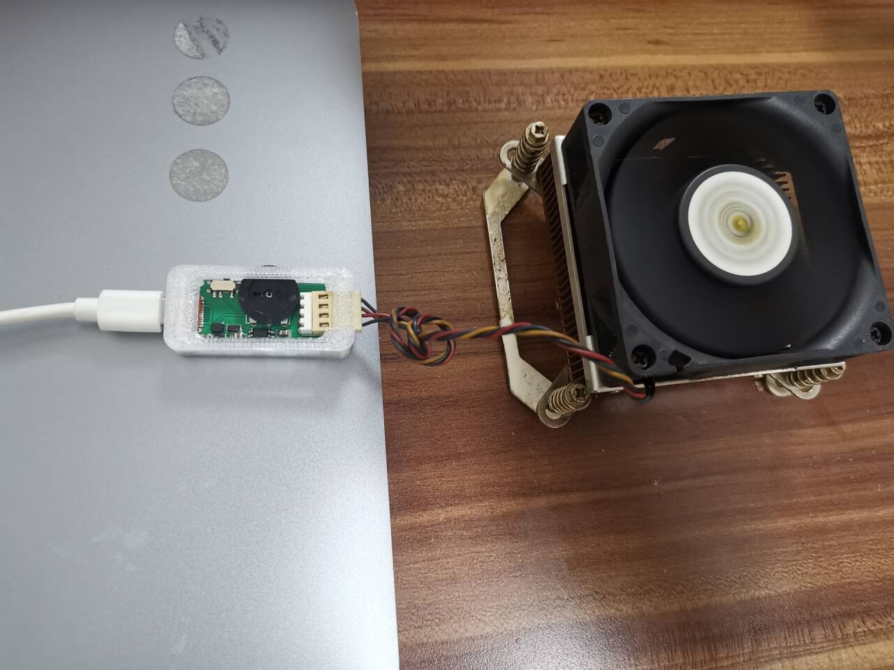

Design Rationale:

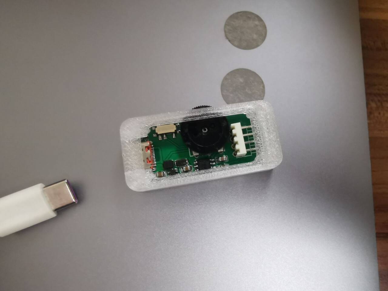

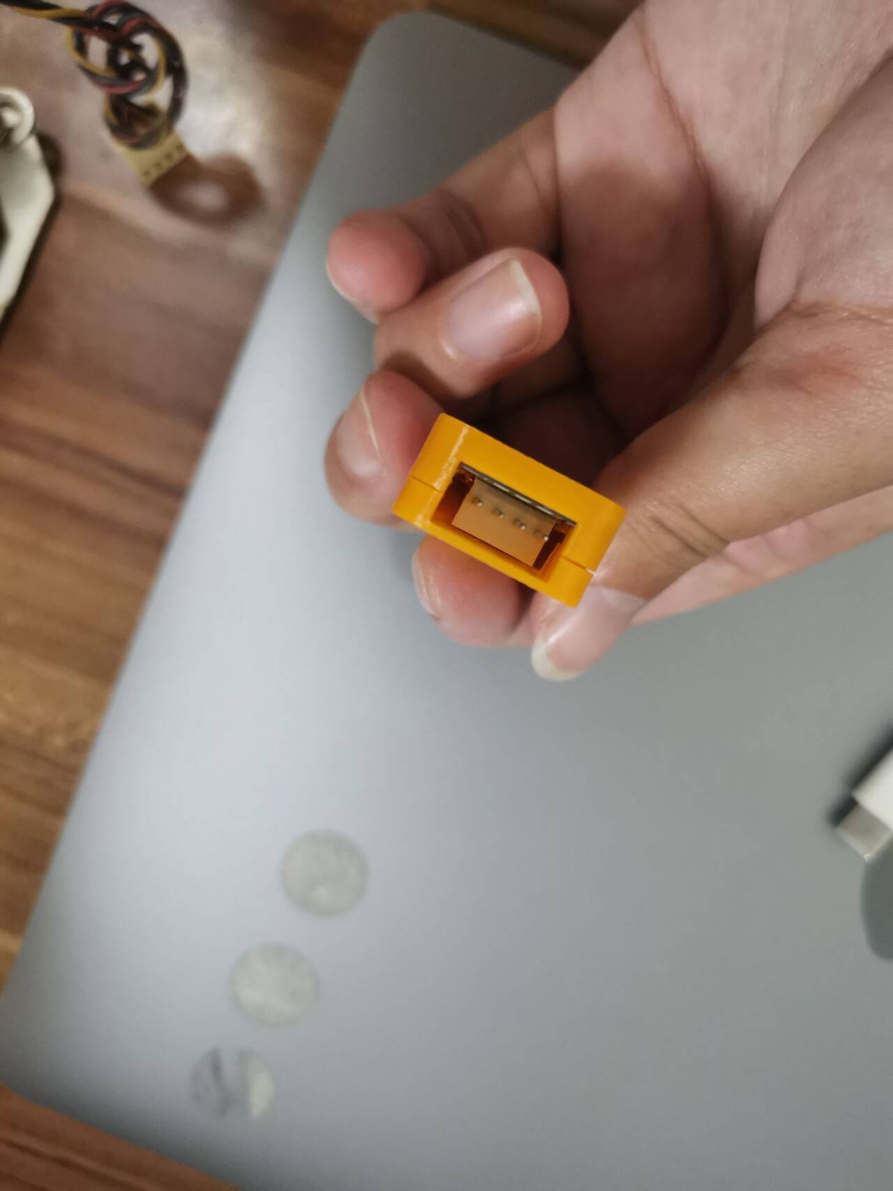

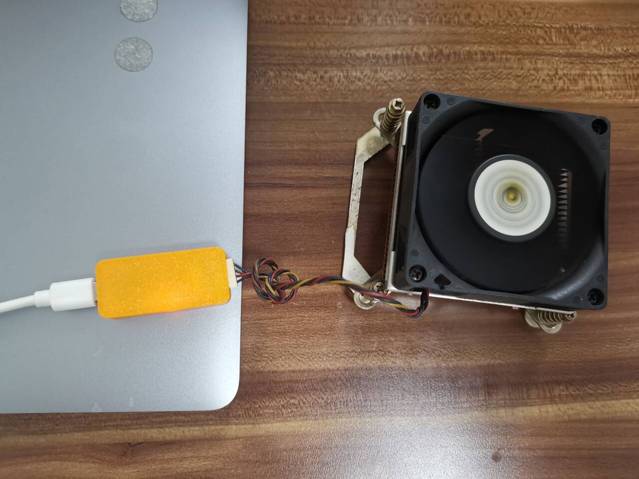

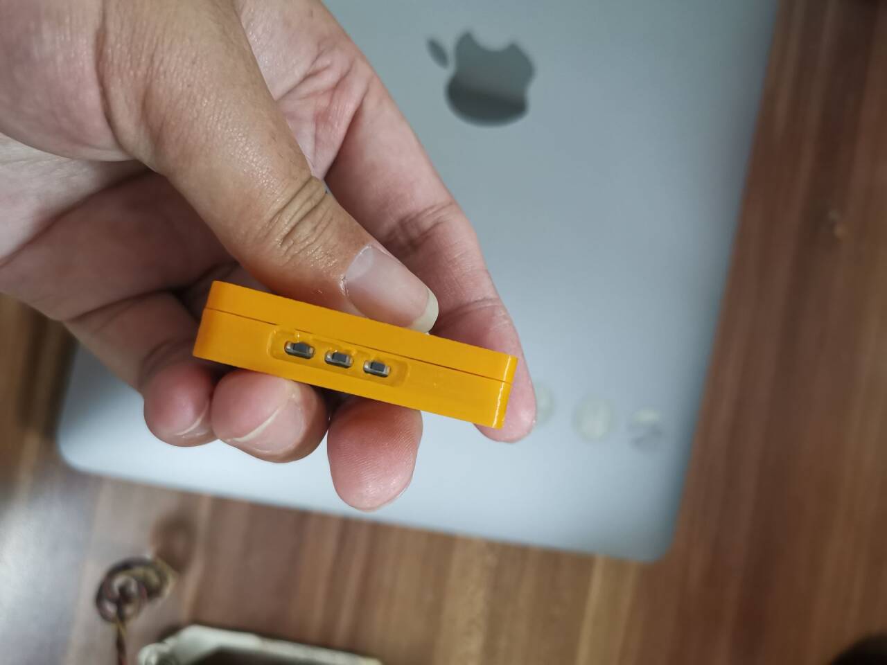

Originally, I wanted to utilize an idle fan to create a miniature version for easy assembly with fan blades. However, considering the potential for battery drain with an embedded battery, I opted for a Type-C input for power, compatible with power banks. Two versions were designed: a simplified version without an MCU and requiring no programming, and an optimized version using an Air001 to generate PWM for driving and adding other peripheral functions, allowing for more comprehensive functionality. Both versions support adjustable fan speed and can be used for tasks like welding smoke extraction, cooling in summer, etc. The Air001 version can power LEDs for illumination or UV curing (the UV LEDs are external and not yet implemented; only control code is added). The
simplified version works as follows:
First, a 5V voltage is connected and boosted to 12V via an MT3608 to power the fan. Simultaneously, the 5V voltage powers a GP9101. A variable resistor is used to change the PWM duty cycle of the GP9101, thus adjusting the fan speed. The fan is a 4-wire PWM fan,
version Air001.
The 5V is stepped down to 3.3V via an LDO to power the Air001, and simultaneously boosted to 12V to power the fan. The Air001 emits PWM to control the fan speed. Each button press increases the duty cycle by 20%,
returning it to 0% after reaching 100%. The indicator light brightness changes with the duty cycle to indicate fan speed. A WST3400 is used to control the external UV lamp (which is not soldered).
Attached are demonstration videos for both versions, as well as the code for the Air001 version.

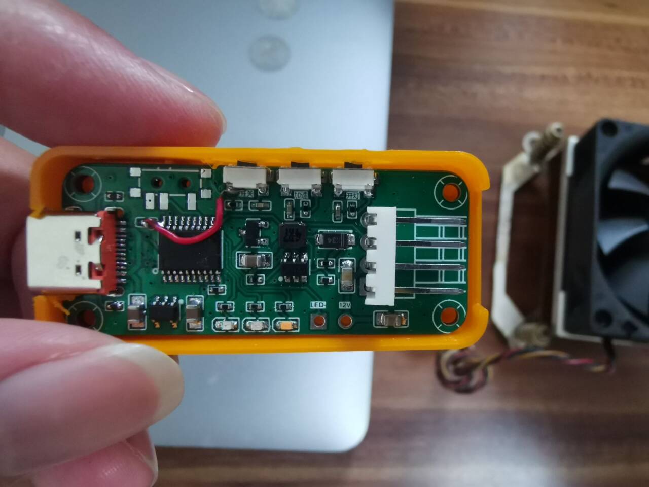

Several problems were encountered during the construction process. It was discovered that the 100k resistor in the package purchased online was incorrect; it was labeled 100k but was actually 100R, which could not be used for proper voltage boosting. A 0603-sized resistor was found and reinstalled. However, the GP9101 chip in the simplified version was faulty and could not adjust the speed. After purchasing a new one, it finally worked. However, due to repeated soldering and my desire for simplicity, the soldering time on the heating plate was too long. Several potentiometers were damaged (melted). There was also another issue: initially, I didn't understand fan rotation direction control and mistakenly thought adjusting the PWM duty cycle to be complementary would suffice. In reality, a 4-wire PWM fan cannot easily change direction; only a 2-wire fan can change direction by swapping VCC and GND. Therefore, the initial direction-changing function was removed from the project. I didn't even solder the direction-switching switch on my board.

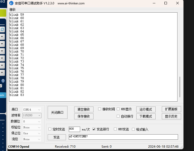

The Air version also encountered many difficulties.
After soldering, I discovered the circuit was drawn incorrectly, and the main controller lacked 3.3V power, requiring jumper wires to solve the problem (the schematic and PCB have been corrected in the project). With the hardware issues resolved, the software was also stuck for a long time. I studied the PWM code extensively and felt it was correct. The only problem was the LEDs not lighting up (during development, I used LED brightness as a duty cycle indicator). After investigation, I found that the LEDs wouldn't light up when the brake was activated. Therefore, I disabled the brake function. The PWM successfully drove the fan. I also added a breathing light effect, etc., all in the code project.
[Image of the simplified version] [
Image of the Air001 version]

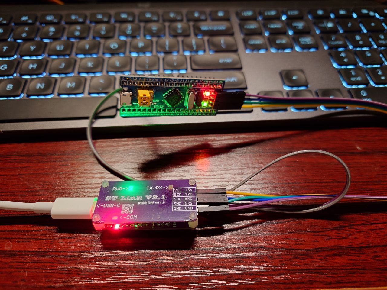

DIY STLinkV2.1

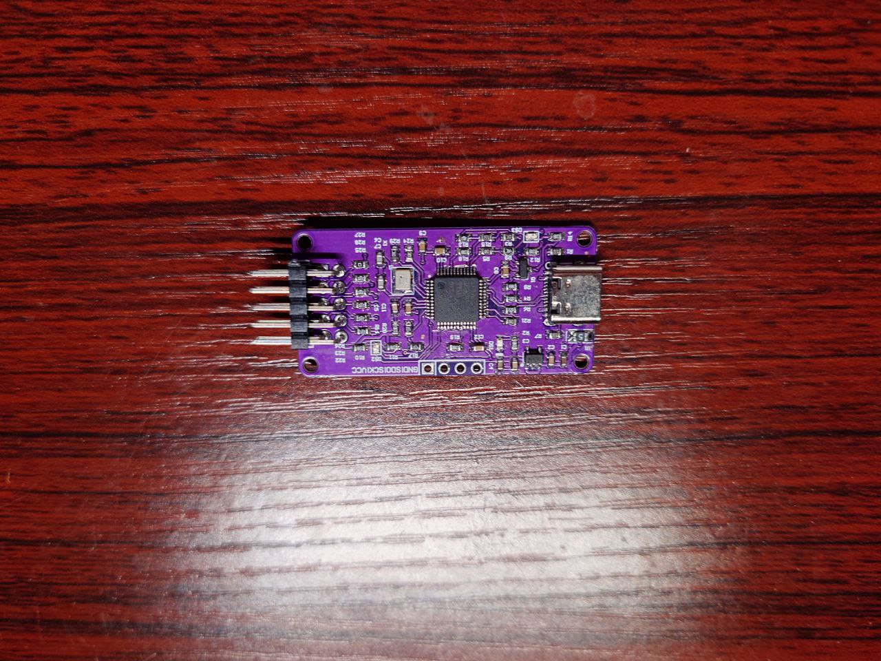

A self-made ST-Link V2.1 development tool for ST microcontroller development, debugging, and serial port connection.
Project Description:
This project is a self-made ST-Link V2.1 project, primarily designed to address the developer's (my) needs for ST-Link tools. Key development goals included:
ensuring the debug output interface arrangement conformed to the developer's (my) preferred configuration;
enabling connection to a PC via the USB-C port
; and providing a serial port to minimize the need for additional serial port connections.

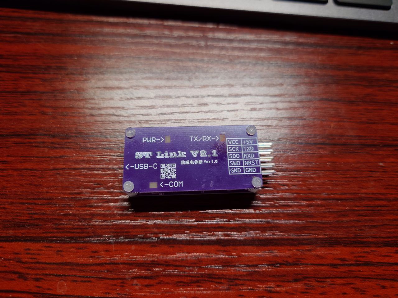

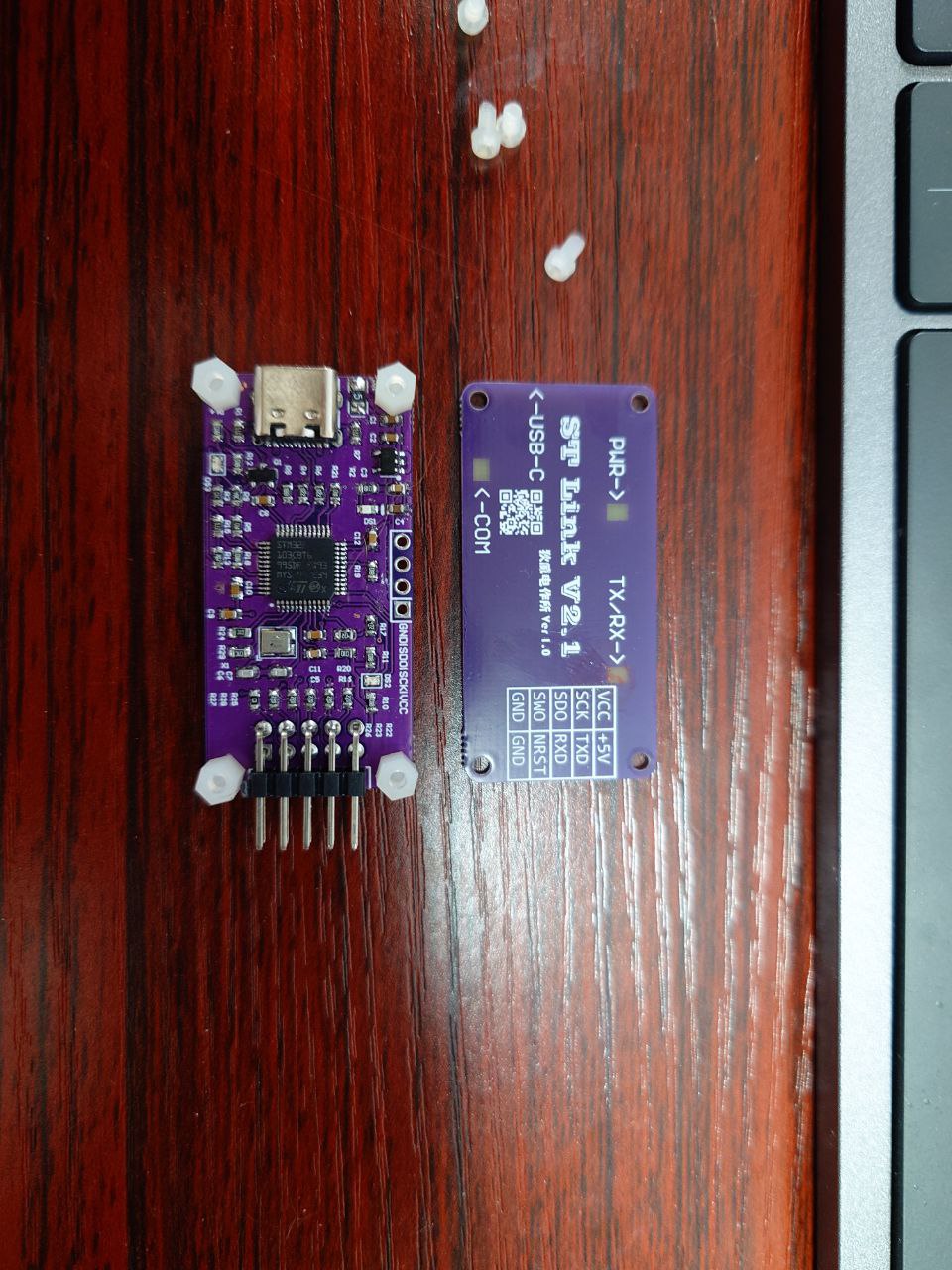

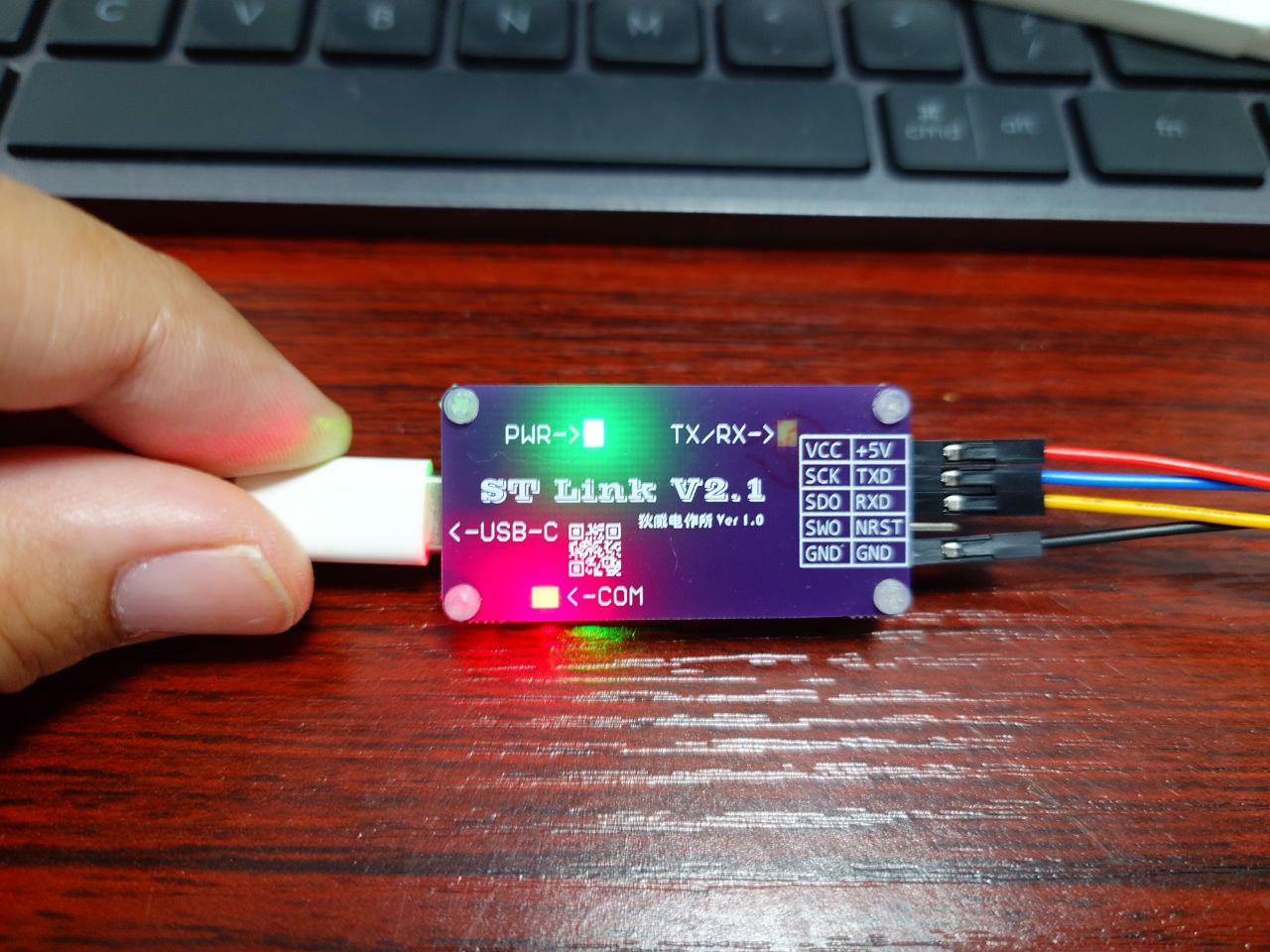

Based on these requirements, the developer (myself) decided to redesign the circuitry based on the ST-Link V2.1 hardware design to create a custom ST-Link device. Project Demonstration:
The schematics and PCB layout for this project have been uploaded to LCSC and can be viewed directly.

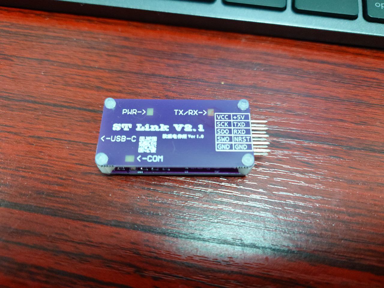

The above shows the assembled state. The
above also shows the intended state in use. The LED design has slight flaws
. The above shows the board and internal components.

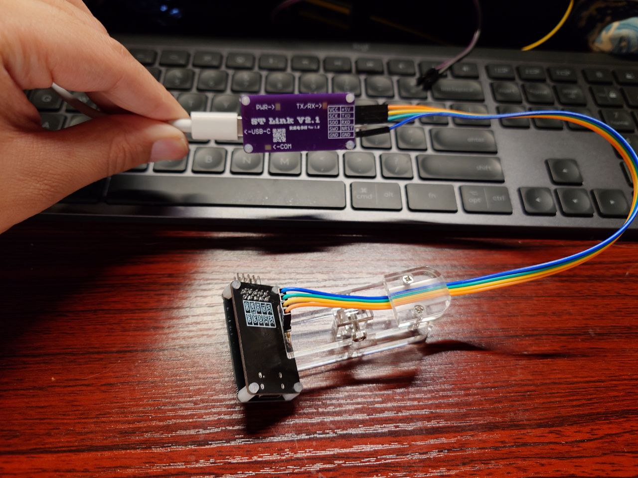

The diagram also connects to the STM32's SWD debugging and serial port, reducing wiring complexity.

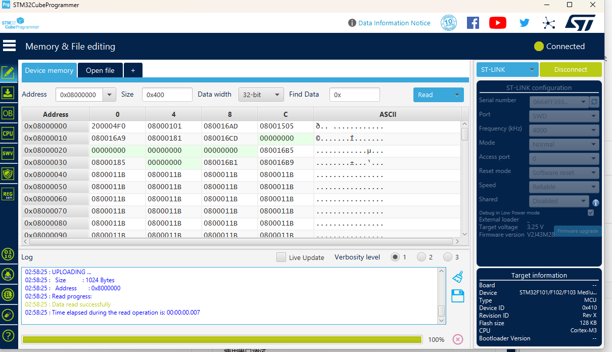

Serial port debugging is used
via the cube programmer.

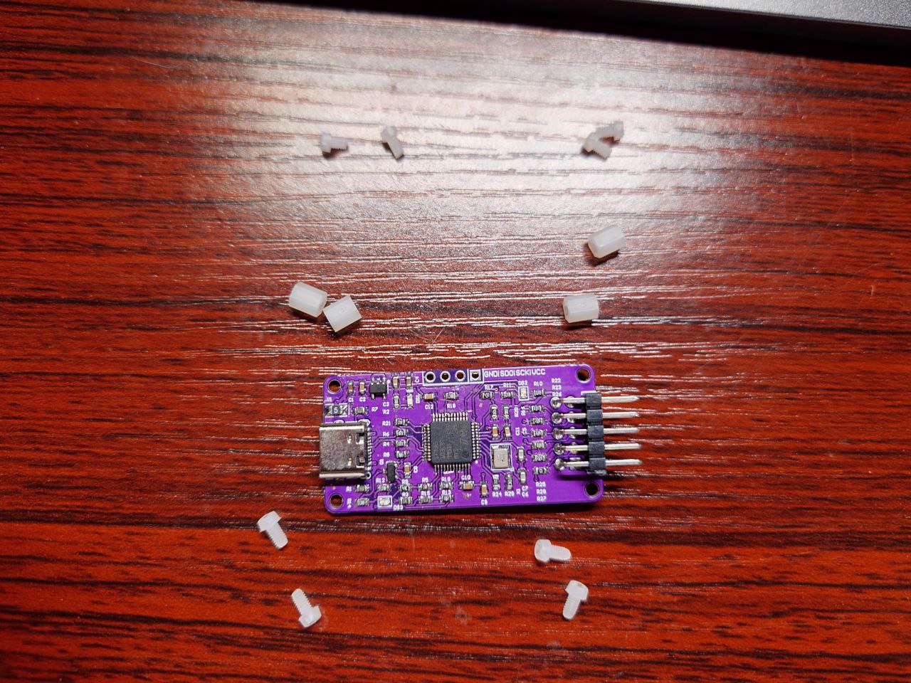

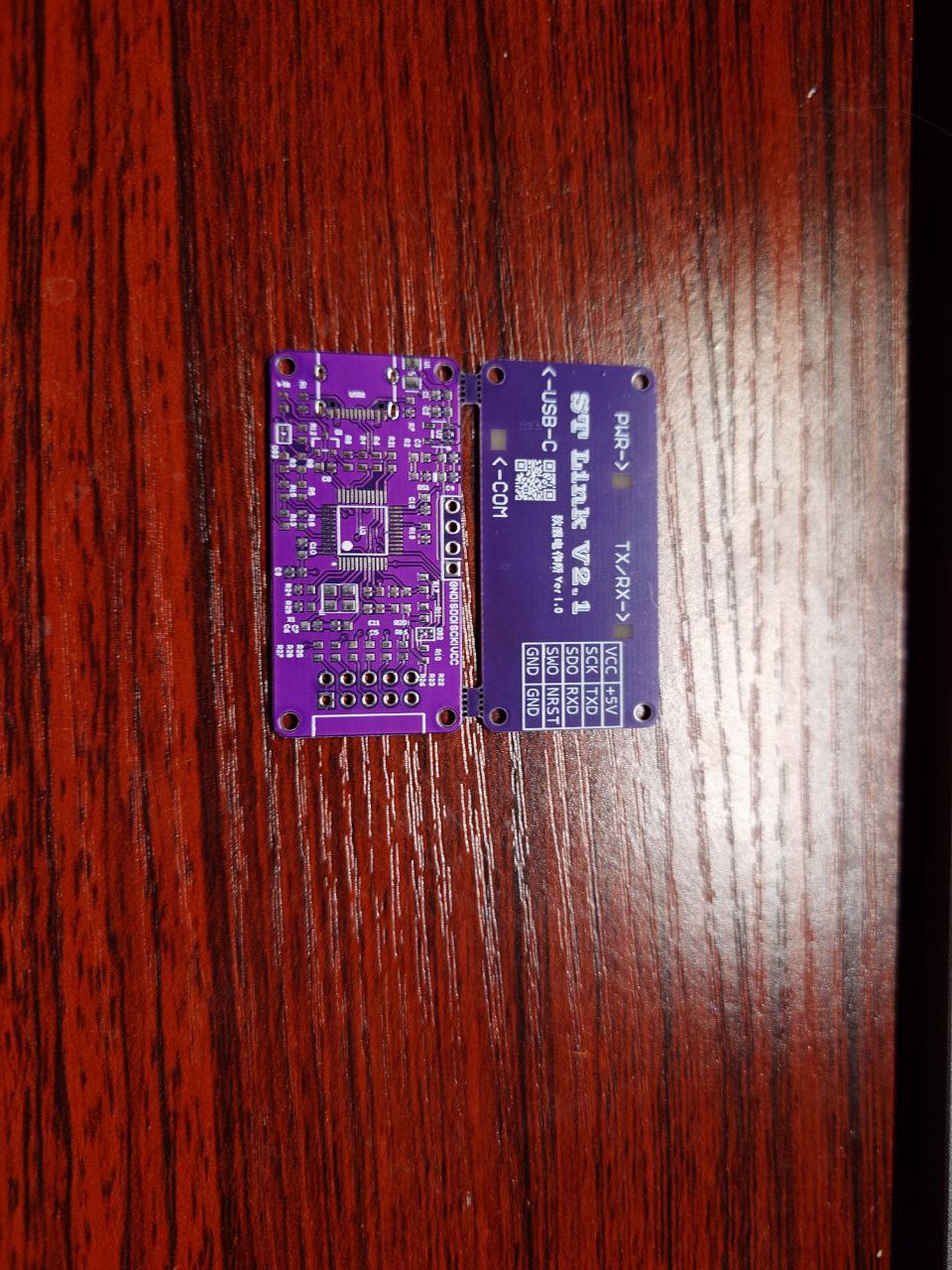

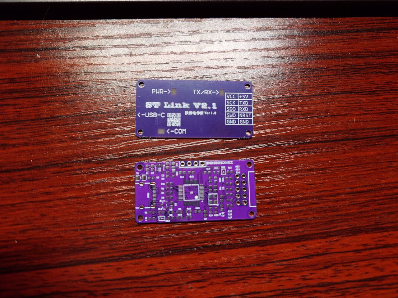

Project creation (Simplified)
was done by obtaining the pre-made PCB from JLCPCB.
The PCB was disassembled and
components were soldered.
Eight M24 nylon screws and four M26 nylon studs were prepared and
assembled .
The firmware in the attachment was burned using an existing ST-Link. The author's evaluation : After board testing, all hardware functions were normal (SWD debugging and virtual serial port). The
corresponding firmware allows for drag-and-drop burning from a USB flash drive, basically meeting the designer's (my) requirements. The firmware used is in the attachment and needs to be burned via an existing SL-Link or other methods through the SWD interface.

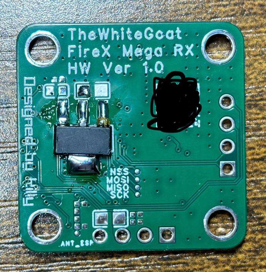

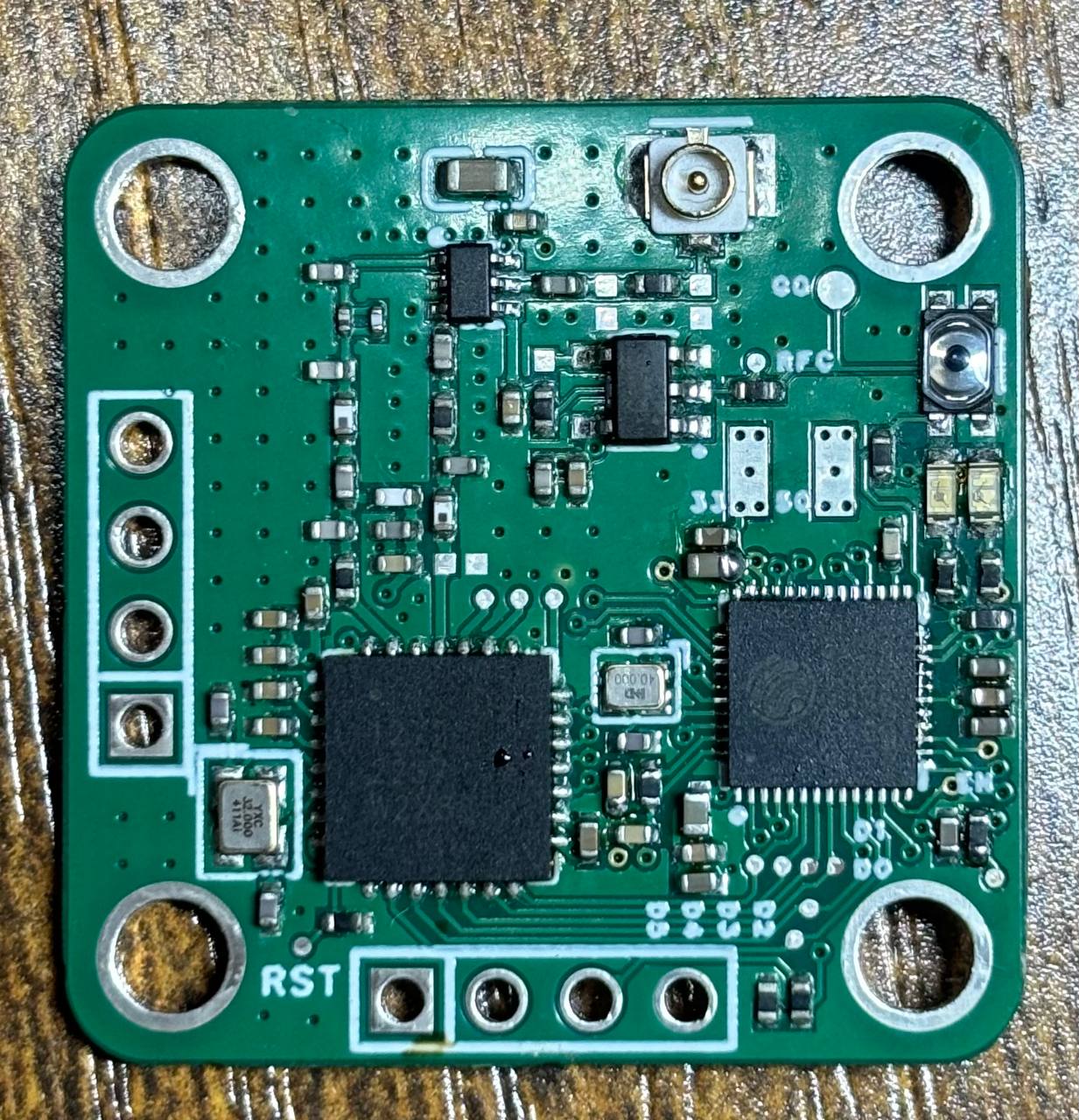

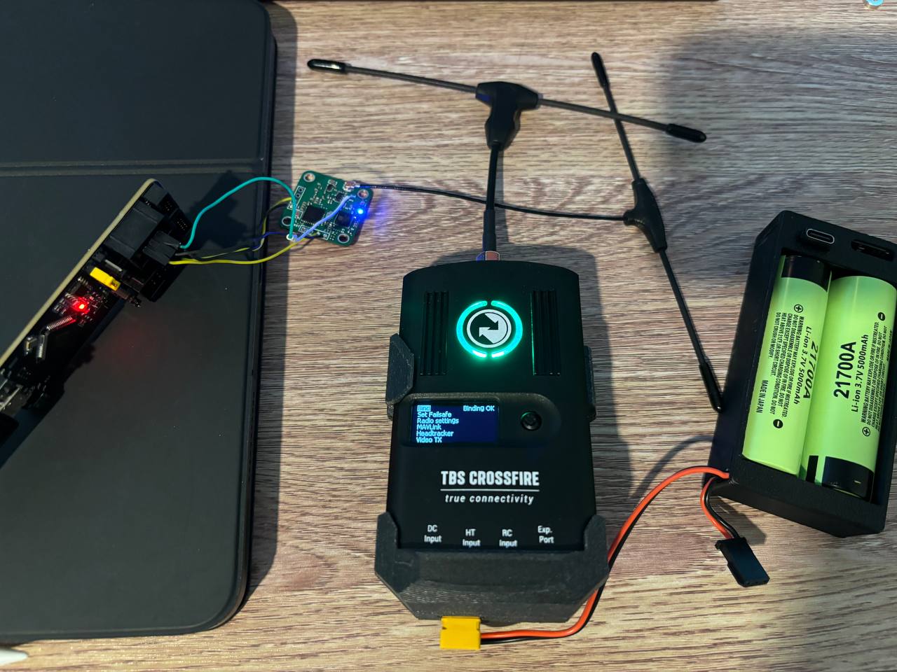

ESP32+SX1272 915MHz LoRa ELRS Development Board
This is a LoRa RF development board based on ESP32 and SX1272 , operating at 915MHz and compatible with the ELRS protocol. It has no connection to BlackShell TBS Crossfire.
This is an RF LoRa development board based on ESP32 and SX1272. It has no connection to the BlackShell TBS Crossfire and
is theoretically compatible with ELRS, but requires custom firmware compilation and configuration modifications. The design purpose is solely for learning RF circuits and microcontroller development; only the hardware is open-source, not the software.
The protocol is based on the Public Domain; feel free to modify it as you see fit, and the author assumes no responsibility.
Accordingly, for legal reasons, the author will not provide any BlackShell software or firmware, although reverse engineering is not difficult. The specific process cannot be provided due to legal reasons, nor can I provide the key or related procedures, but there are methods for decryption that are relatively simple. Readers can extract the firmware themselves from various resources, including the ESP32 datasheet and reference materials.
In short, the new BlackShell receiver uses an ESP32 for control and an SX1272 for the RF front-end, handling 915MHz band transmission and reception activities. The hardware is very similar to the ELRS 915 series.
Devboard based on ESP32 & SX1272, HAVE ABSOLUTELY NO CONNECTION WITH TBS CROSSFIRE.
The design purpose is only for learning RF circuity and MCU development, only hardware is open-sourced, and no software will be provided.
The agreement is based on Public Domain. Please feel free to modify and play with it. The author does not take any responsibility for any form of the project.
Accordingly, the author will not provide any form of software and firmware support, but it is not difficult to figure out or write your own.
Successfully tested and flashed, updated firmware.
