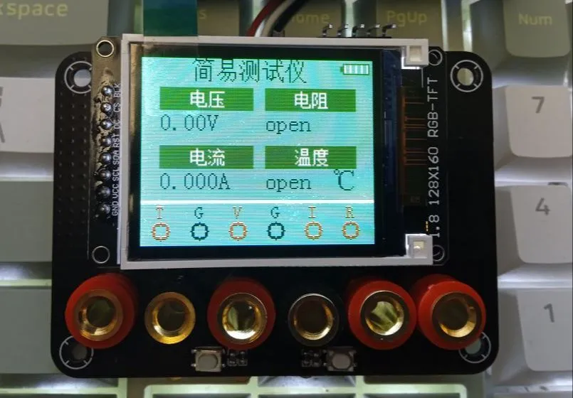

Multifunctional Tester Based on STM32
The schematic design describes
the acquisition of voltage and current signals using an INA226 microcontroller.
Temperature is acquired using a MAX6675 microcontroller and a K-type thermocouple.
The software
cyclically prints the acquired parameters, and users can select data to upload to the serial port via buttons.

Physical demonstration instructions
and precautions
: Note that the battery is a single lithium battery.
