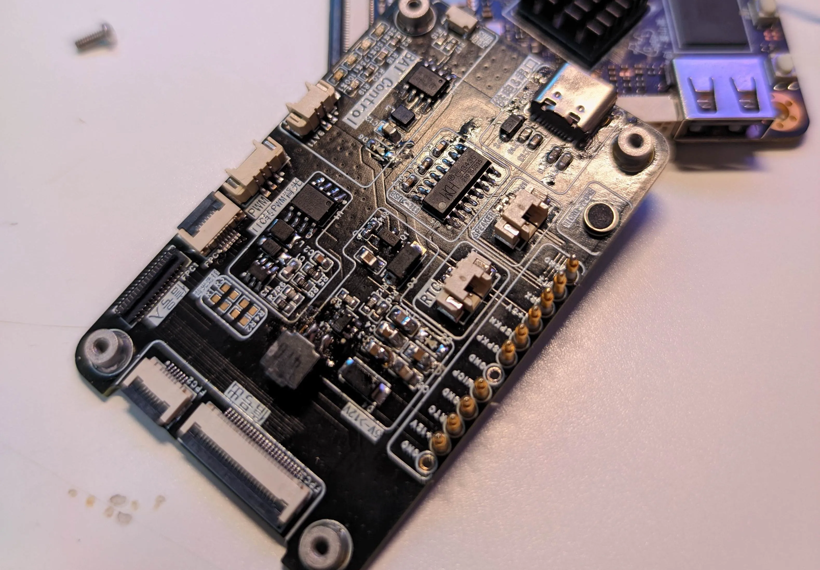

Smart small mobile phone
The IIC-to-PWM control of the screen backlight
extends from the touch IIC pin of the Taishanpai device, using a GP7101-F1K-L1H1-SW chip.
A SY7201ABC constant current source chip then converts the PWM signal into a constant current to drive the screen backlight.
The Taishanpai device also has TTL contacts, enabling direct data communication with the computer via a USB-to-TTL converter.
The lithium battery management circuit
uses an IP5407 chip to build a lithium battery charging circuit,
converting 5V USB voltage or 4.2V battery voltage to 12V to power the Taishanpai device.
A BOOST boost circuit using an MT3608 chip provides the 12V output. (Actual
product demonstration shown. )
