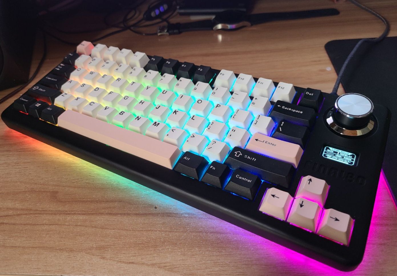

This time the configuration has been improved, and the threshold has been raised to a certain extent compared to V1, but it is also more complete.
Please see the attachment for all relevant documents. Here are some brief instructions:
Firmware: QMK open source firmware (the firmware and reference source code are attached), does not support VIA, and you need to build your own development environment to modify all functions.
MCU: STM32F303CCT6 (I chose this just because QMK official RPOTON C uses this master, which is relatively simple)
OLED: 0.96-inch I2C OLED↵↵RGB: Exactly 100 WS2812 are used (axis light: reverse 3528 or front 3535 stacked tin, around the knob and bottom light are 5050 front.)
Shell: Acrylic stacked CAD drawings are provided, as well as 3D printing STL.
For information about QMK, please refer to: https://docs.qmk.fm/#/
First picture: PCB: WeChat picture_20200918155354.jpg
3D printing shell rendering: Rendering.png 3D printing shell actual picture: WeChat picture_20200918155257.jpg↵Assembly completed:↵WeChat picture_20200918155121.jpgWeChat picture_20200918160148.jpg
OLED content (the code is borrowed and modified from the QMK open source project./myskeeb/oled.c ) : QQ screenshot 20200918155924.png After 20 seconds of no input, the OLED switches to a magical standby screen saver animation, and turns off the screen after 60 seconds.
KEYMAP I use: final80v2.png

layer 2: RGB brightness adjustment. ↵↵There are 4 WS2812s under the transparent knob cap used as status indicators: CAPSLOCK (red), AUTOSHIFT (green), game layer/LAYER 1 (blue), priority from left to right.
See the attached video for RGB lighting effect demonstration. Please check the source code for other functions. Details will not be explained here.
