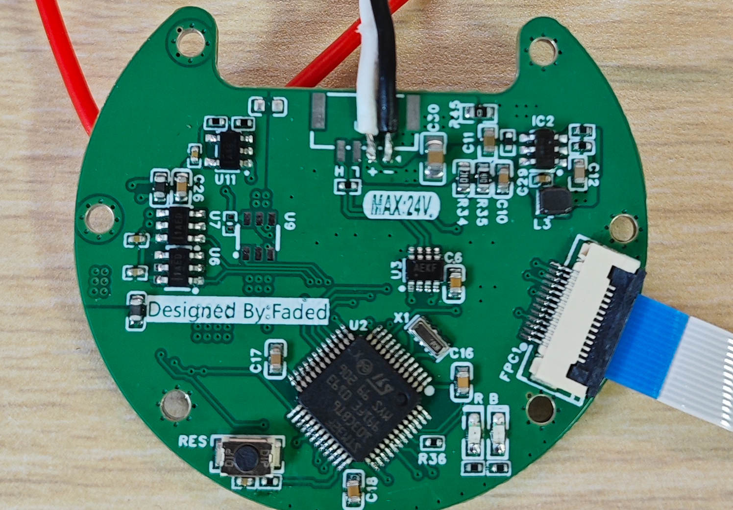

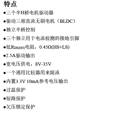

This FOC driver board, based on the DRV8313,

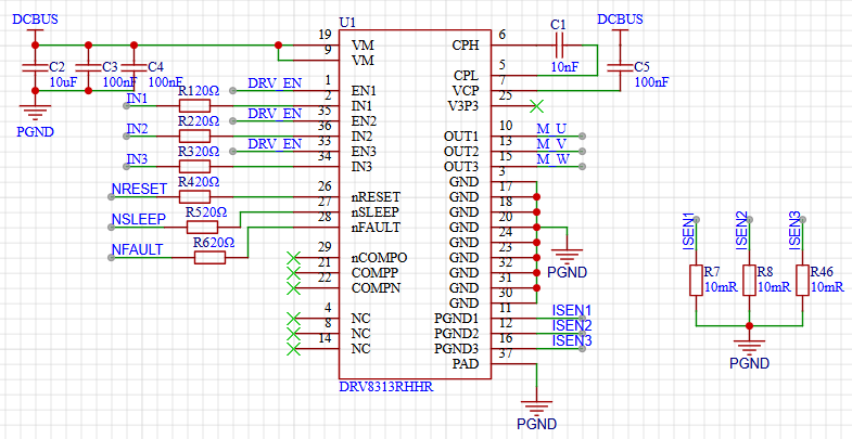

is suitable for 4008/4010 gimbal brushless motors and operates on a voltage not exceeding 16V. The main controller is an STM32F103C8T6, and the driver chip is the DRV8313/AT8313, with a maximum current of 2.5A. It uses low-side current sampling and integrates a CAN transceiver for CAN communication control.
This project is adapted from an open-source project by Bilibili UP user: 会飞的车_S, with the following hardware modifications:

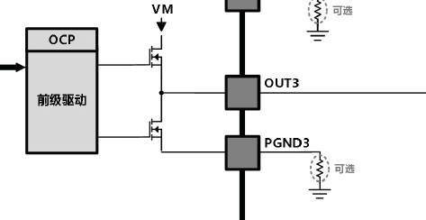

The original bus current sampling was changed to low-side current sampling. Bus current sampling places higher demands on the op-amp, requiring a high-precision bidirectional op-amp with better PWM suppression than conventional amplifiers. The original design used the INA240, which is relatively expensive. Low-side sampling has fewer requirements for the op-amp, so the INA181 is used here.

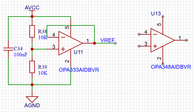

The op-amp reference voltage uses a resistor divider and a voltage follower to reduce impedance. The reference voltage is 1.65V, which meets the voltage bias requirements for bidirectional current sampling. OPA333 or OPA348 can be used; OPA348 is cheaper.

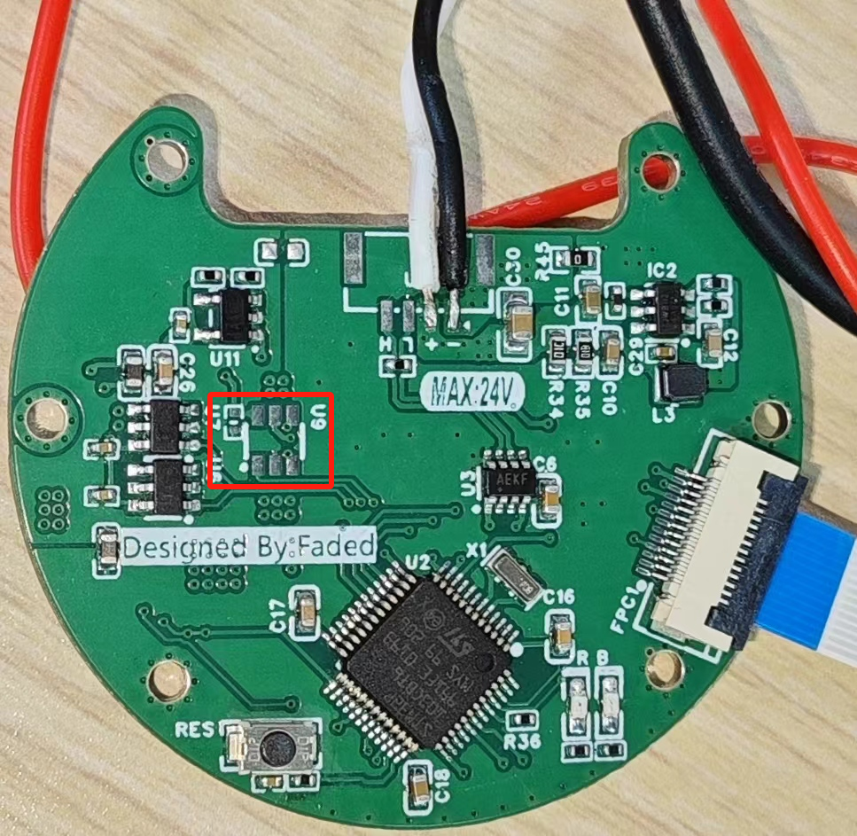

Originally designed on a square board, it was later changed to a round board, and many layouts were directly copied without modification, so it looks a bit strange, but it works.
Only two op-amps need to be soldered: the U-phase and V-phase; the W-phase (within the red box) can be left unsoldered.
