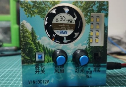

Fan with atomizing light and adjustable speed

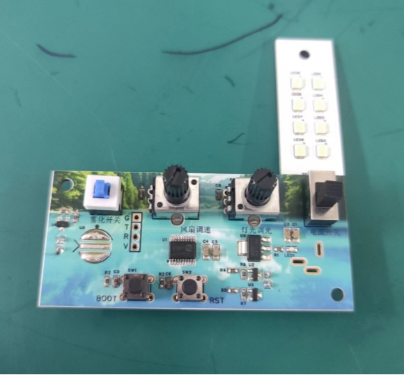

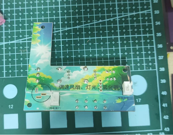

This is a small, speed-adjustable fan with an atomizing humidifier and a dimmable light, built using the air001 chip and Arduino IDE programming.
It can achieve the following functions:
1. Free control of any module, allowing individual operation of one or two modules, or all modules to be on.
2. Individual potentiometers for controlling the brightness and speed of the light and fan.
Power Supply:

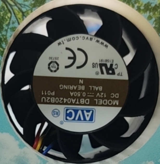

It uses DC 12V power (mainly because a suitable 5V fan is unavailable), and an internal LDO step-down regulator chip provides 5.0V power to the microcontroller and atomizer.
Application Scenarios:
1. Dimmable night light
2. Speed-adjustable fan
3. Humidifier.
Construction Process:

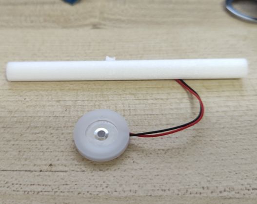

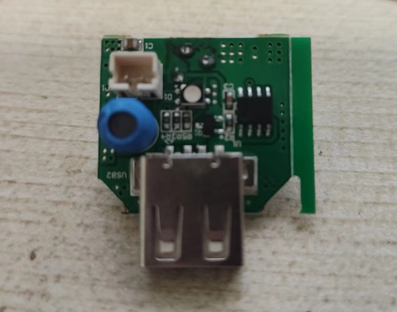

Circuitry: Originally, the plan was to directly use the MCU to output a 108kHz pulse to drive the humidifier, but it seems the MCU doesn't support this, causing a conflict with the PA5 pin and resulting in a blown tube. Therefore, the inductor was shorted, and the original atomizer interface was converted to a 5V power interface to power the external humidifier driver module.
Hardware: 12V fan, atomizing plate, and absorbent cotton swab.
